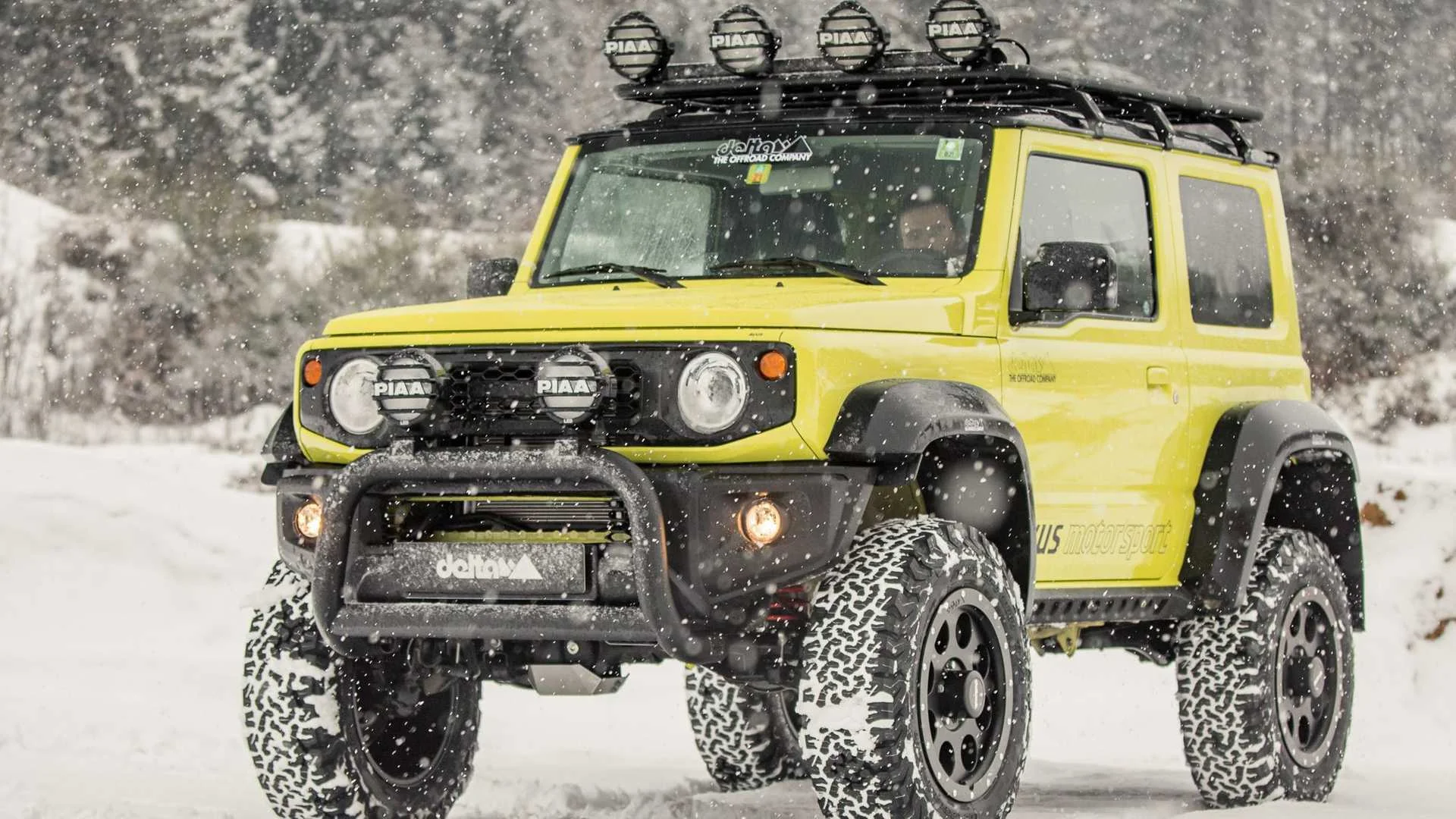

Also - the full size portals are wildly expensive vs the side by side versions. My next build I'd like to do once I'm back in civilization with a shop is a 5 door Jimny on portals. Probably UTV portals with a set of UTV tracks for winter. It weighs almost the same as a Ranger 1000 crew with the cab on and less than a Canam Defender fully kitted out. And all-in I think I'd be into it less than just the portal conversion for an LX. The LX would make a very nice tow vehicle to the trails for it.
