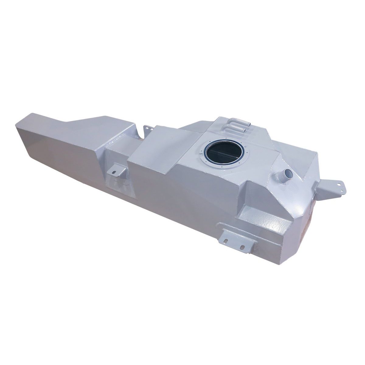

I would have already pulled the trigger on one of these tanks if they weren't so damn big. I wish they made a smaller version that tucked up better under the frame rails like the stock tanks.

There is a company here in usa that makes. perhaps a collaboration with them to make auxillary tank here for LX600 and LX700?
I believe that is actually an Australian company with a US affiliate or subsidiary that imports their Australian-made products.

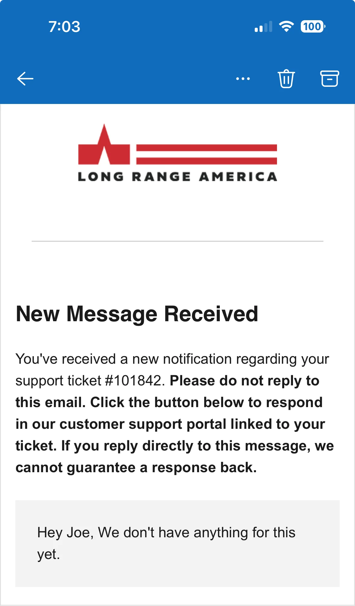

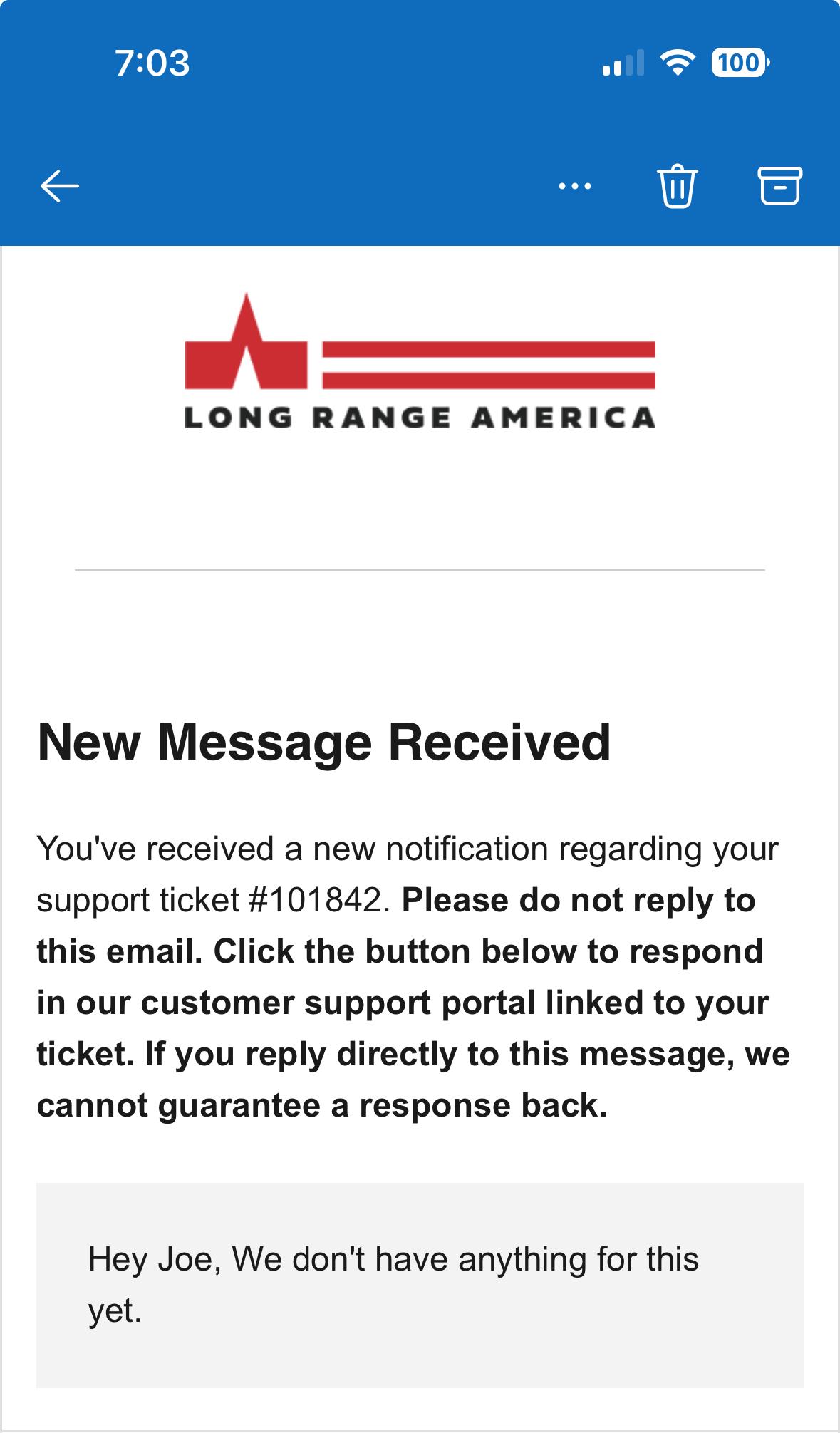

They do not have anything for this vehicle yet.
