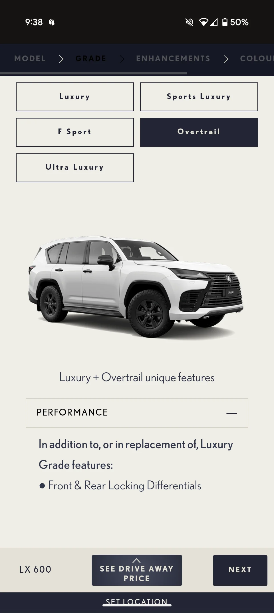

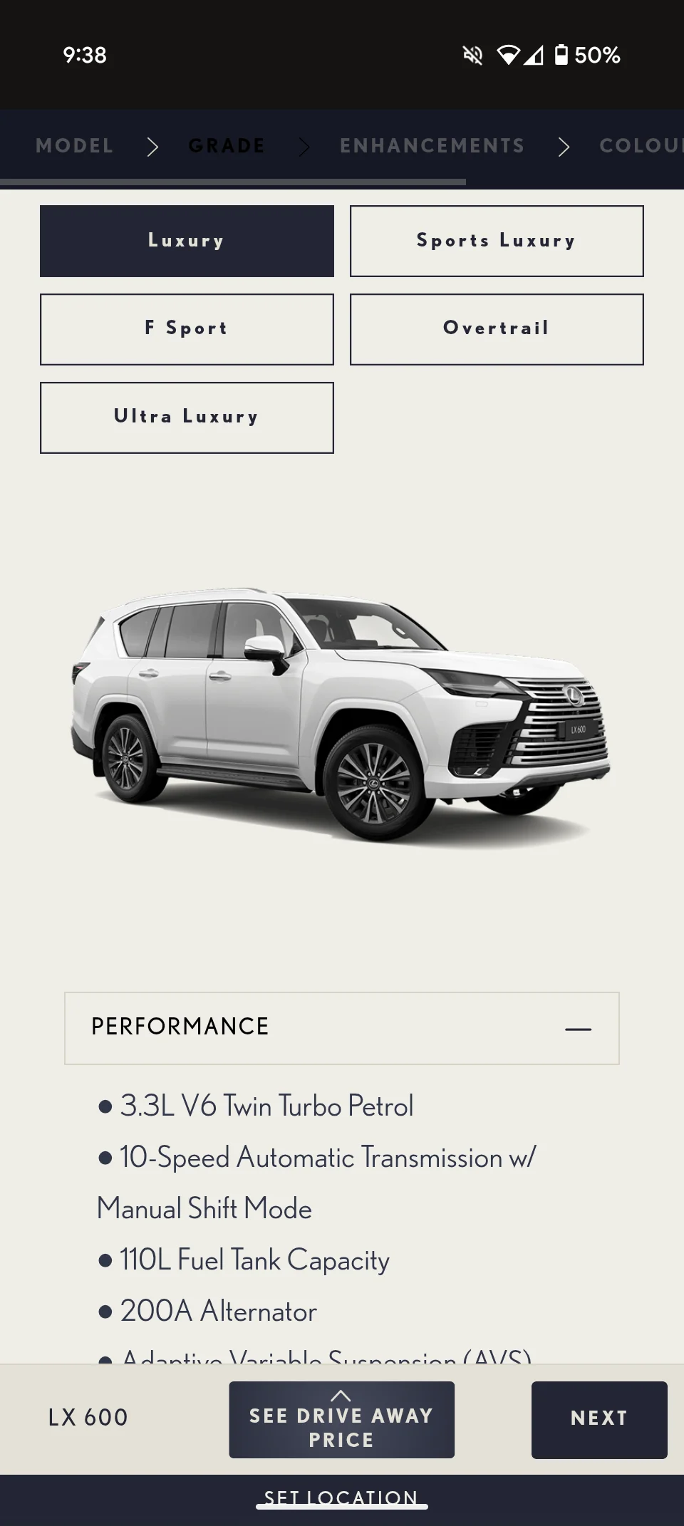

Seems like Australia gets the auxillary fuel tank as standard on their lx600 (110 L = 29 gal), and a triple locked overtrail version of the 600 to boot...

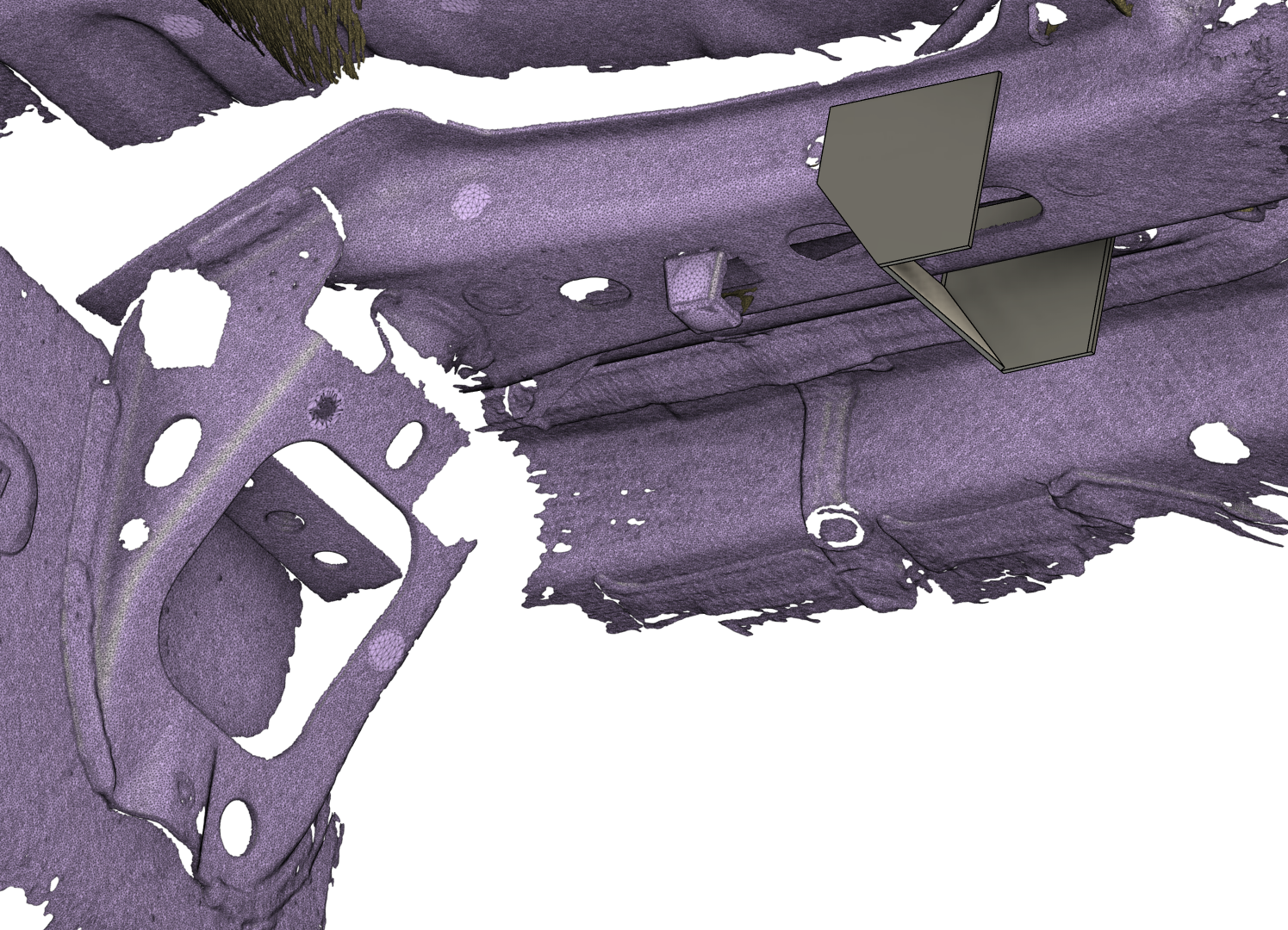

Update:
  • Scanning of undercarriage is complete.
  • I'll be working on finishing the BOM and designing the mounting brackets next.
  • Three of the four mounting weldments for the OEM sub-tank are not installed on the USDM LX.

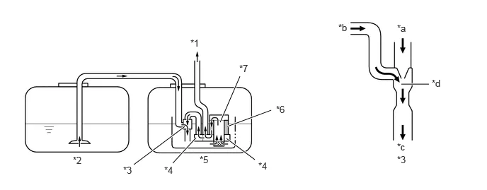

Regarding all mechanical, how do you plan to hookup and operate what looks like a fuel pump mounted in the additional tank? Seems from factory this would be automated vs the LRA switch in the dash. I guess also fuel level in the aux tank is something to consider. Your thoughts?
As of today following this thread. Thanks much to @Oakleyguy for trying to figure this out, awesome!
This is the cool part: you just need to replace the main fuel pump assembly as the dual tank models use a Venturi pump to siphon fuel from the sub tank to the main tank; its completely passive.
I haven't found yet if I'll be able to integrate the secondary fuel level sender unit, but worst case, the gauge stays at FULL on the dash until you start using up fuel in the primary tank.
Ok, great, that is how the factory setup for the 200 series works as well. Excellent!
In progress teaser:
