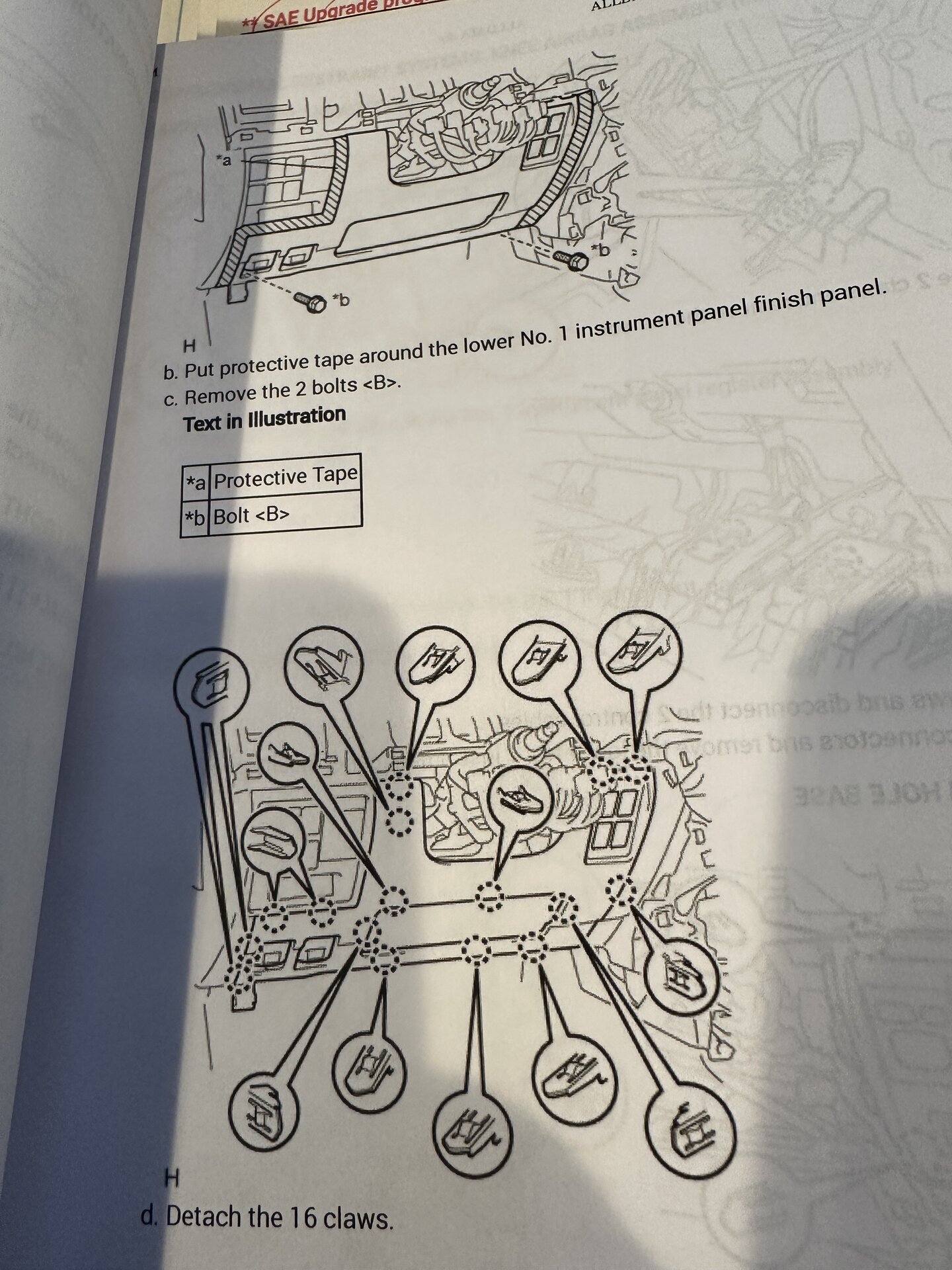

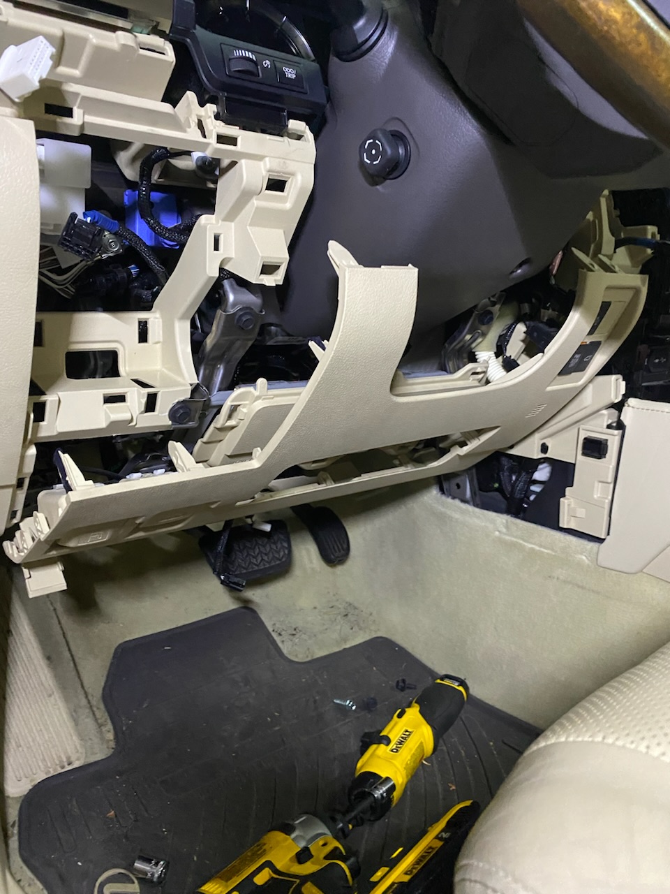

Um guys, this is starting to be a bit of a project...
Ive taken out the two 10mm bolts from the bottom of the knee apron, as well as several surround pieces but i guess im worried about the airbag?
Seems like the '16+ is one piece and the left panel bank is too small to work through. The card holder is also a pop out cubby and one piece with the apron.
Battery is disconnected but should i try and disconnect the airbag before i start yanking on the apron from under the steering wheel gaps?
I DO NOT want to get my face obliterated by an airbag while my head is down there. Any precautions i can take aside from the above?

You do not need to remove or disconnect the airbag. The surrounding panels come out easily, i.e. the undrtray with two screws and two wires to disconnect and then the lower dash panel with two bolts and a number of snap connectors and AC temp sensor tube and connector.. This leaves the rectangular airbag cover untouched. Hood & fuel release can likely be keep in place unless you want to take the panel out of truck for other reasons.

Ill be putting all my pics up shortly. Suffice to say the newer lx is pretty different but luckily that airbag cover is clipped internally to a framing piece and i did not disturb it at all while yanking on things. That part seems to be the same as your diagram.
I took my time and did things professionally, specifically in securing the tow controller and managing all the cables. I pulled maybe two extra pieces but the rest were all necessary. Unless you really just stuffed the cabling in. I also had double the cables withe the throttle control!

Any tips for detaching the "claws"? I do not have any trim tools and need to get his done tonight for emergency trip in the am!:doh:
