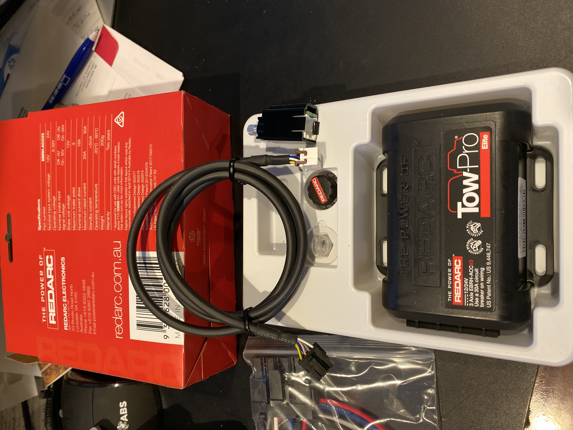

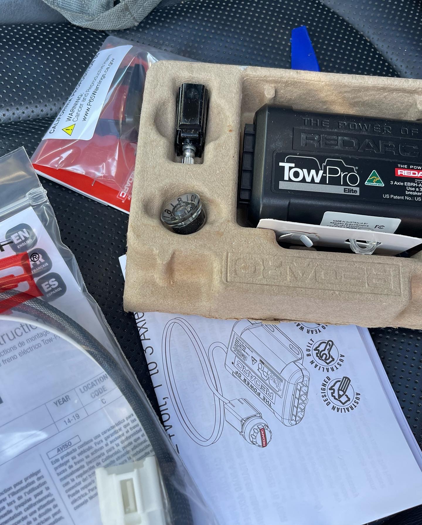

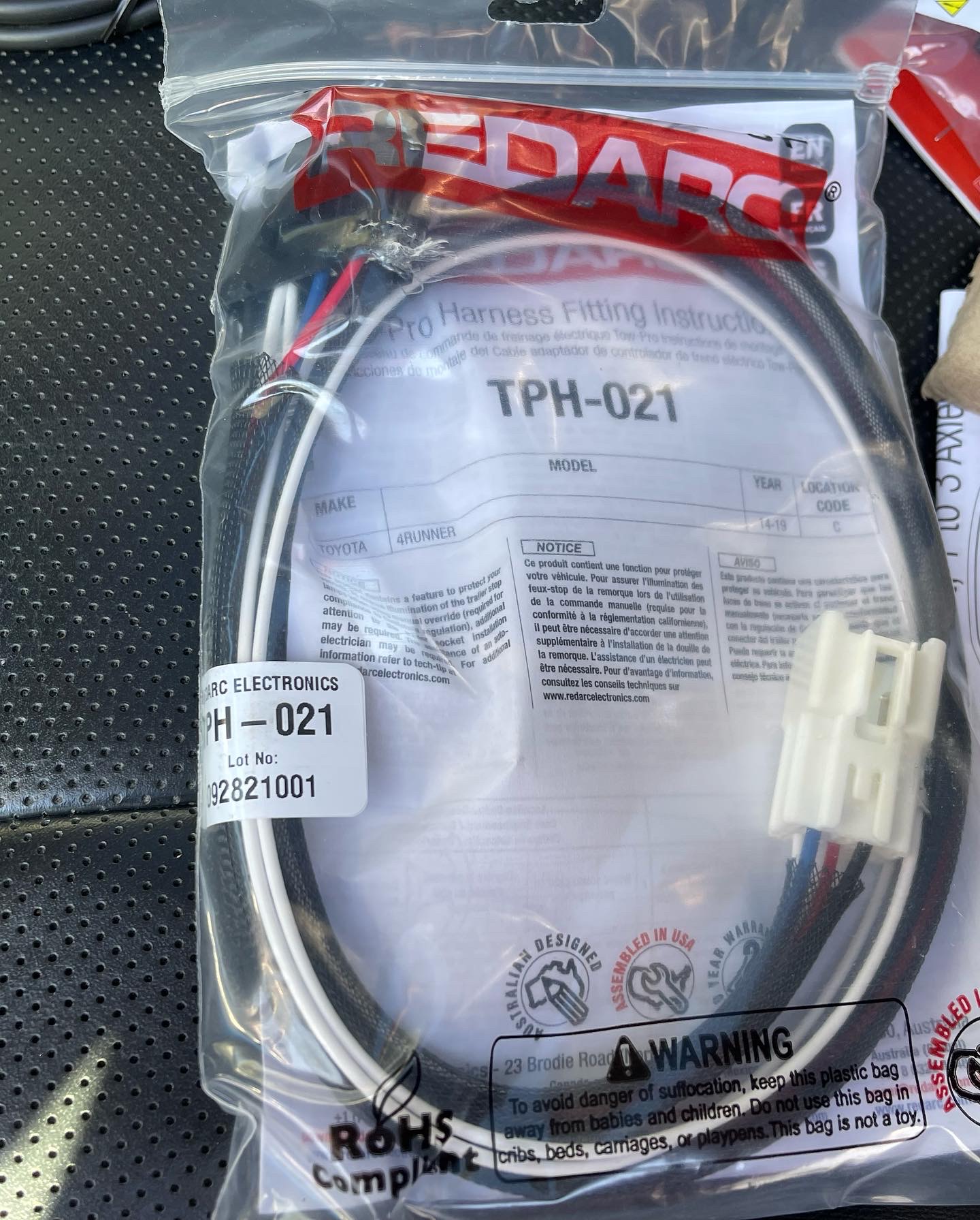

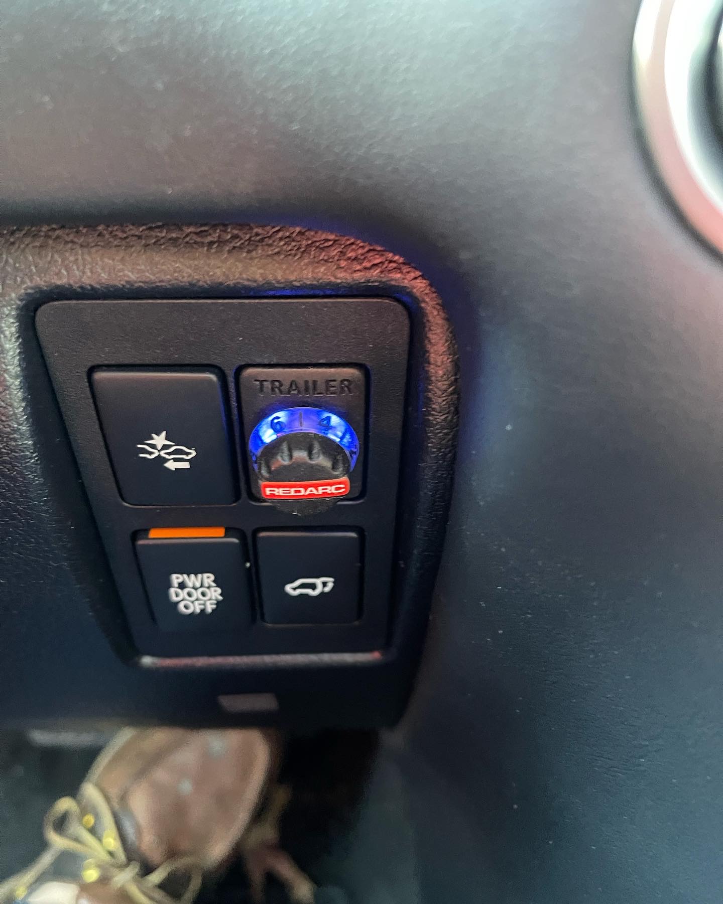

Upgraded the 2019 LX570 with a brake controller. I have a little M416 trailer with an upgraded Dexter axle with electric brakes. Yes I know a bit of over kill. I added the Tow Pro Elite brake controller using the plug-play harness and the switch blank plug. Wicked easy the hardest part was looking up other videos on how to pop apart the dash and finding the factory controller plug hiding behind the dash. Parts included the EBRH-ACCV3-NA controller, TPH-021 plug/play wire harness TPH-021, and the plug blank TPSI-002. Husky not included. I grounded the unit via a bolt framing the dash metal work.

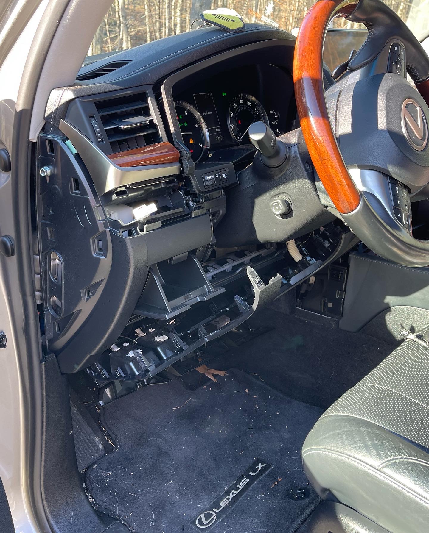

Nicely done. Do you have to pop up the leather panel with the start engine button? In some videos they also remove the plastic panels close to the floor mat. It seems that those panels are not removed on the first pic. Thanks.
Nicely done - i did remove the leather panel with the push start when i did mine. Super easy - 30 min. job.
JMZ I found popping the instrument panel surround out then releases the leather from the top and it pops out easily. Here is a photo from when I installed the apple car play system which shows the surround popped out.
Thanks everyone for the information. Planning to add the same one for my 2017 LX next spring. It’s too cold outside. Just don’t want to break any clips.

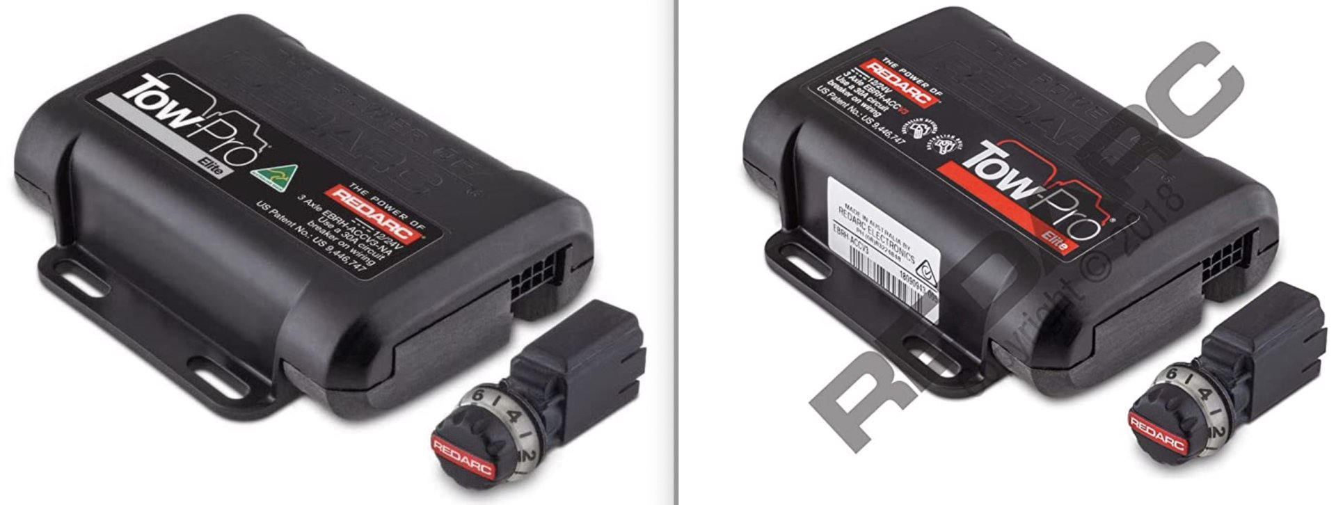

I’ve had the Tow Pro Elite V2 in the Cruiser for over a year now without issue. I use it often with the utility trailer, very satisfied and highly recommend.
I took a look around after a fee people asked the question about what the difference is between the v2 vs V3.
I found a few articles one from etrailer, one from Outdoors an Australian group. They all seem to tag of this release from Redarc Electronics

Which button did you remove in order to fit the redarc plate?
I'm considering moving or replacing my Easy Access Mode button, but I'm not sure if it will piss off the rig if I unplug it.

Hey brother, and others here, where is this mythical plug and play harness?
Is it one cable to pre wired harness one to control knob? And that’s it?

Um guys, this is starting to be a bit of a project...
Ive taken out the two 10mm bolts from the bottom of the knee apron, as well as several surround pieces but i guess im worried about the airbag?
Seems like the '16+ is one piece and the left panel bank is too small to work through. The card holder is also a pop out cubby and one piece with the apron.
Battery is disconnected but should i try and disconnect the airbag before i start yanking on the apron from under the steering wheel gaps?
I DO NOT want to get my face obliterated by an airbag while my head is down there. Any precautions i can take aside from the above?
