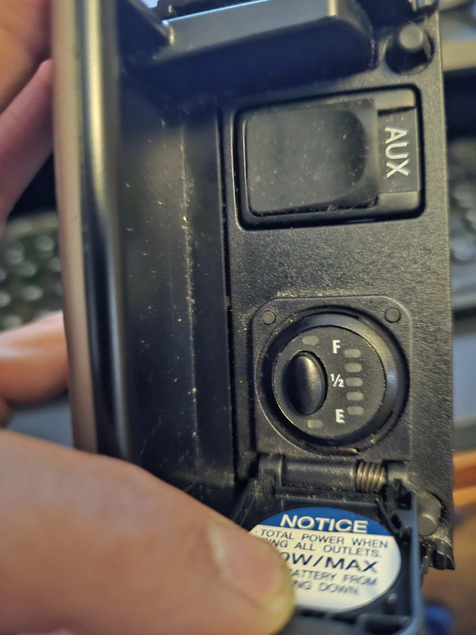

Well, if you are willing to sacrifice a 12 volt socket, the switch is nearly a perfect fit. I put an oring on the top and bottom of the switch to snug it in.
You need to remove the centre console, then remove the lighter/aux port, then remove the metal sleeve (which requires depressing internal and external plastic tabs). Once the sleeve is removed, you can remove the plastic cylinder that will hold the switch. An oring near the top of the switch and one near the bottom keep it snug. I also removed the flip up door that says "12v/120W", to avoid accidental button engagement.
