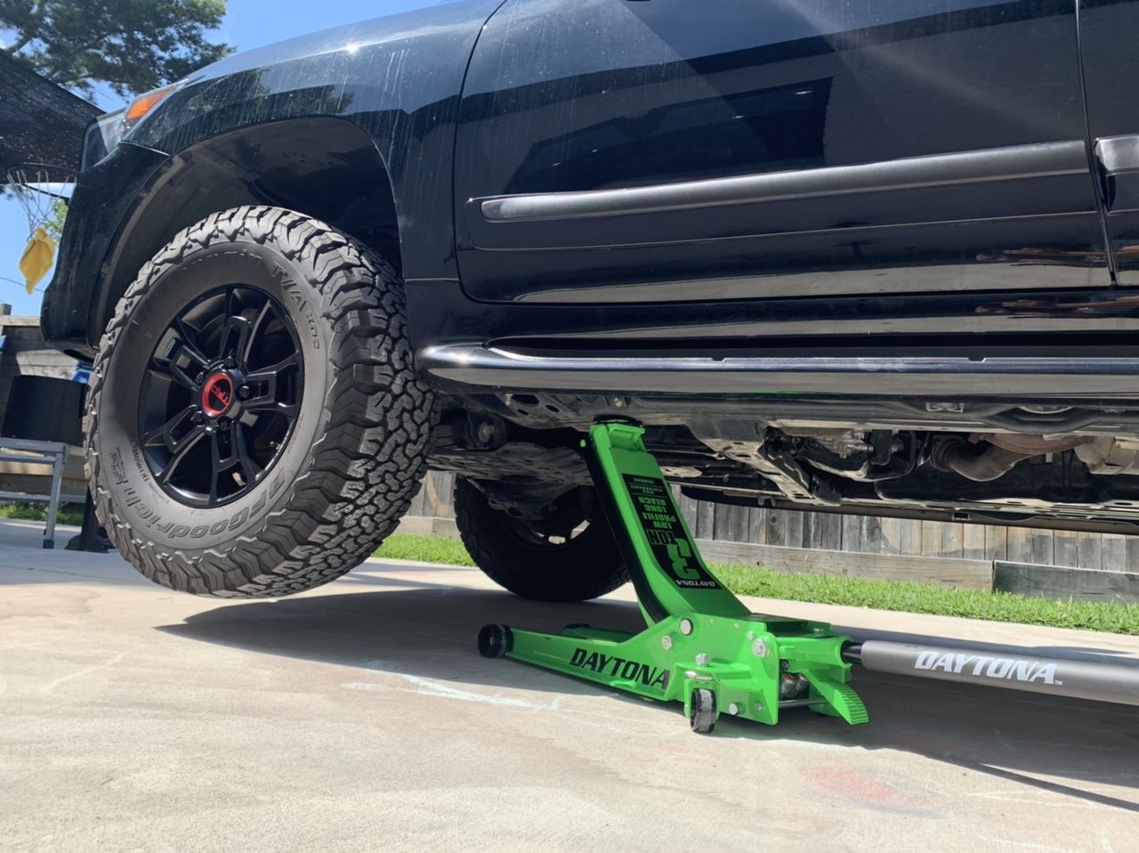

I just got this jack today, and I didn't know what i was missing. It's the Long Reach version with 24" of lift and it was on "sale" for $169. The regular version goes up to 20", but I didn't think it would be enough to lift my fronts. I'm not even sure if this is at max height...
