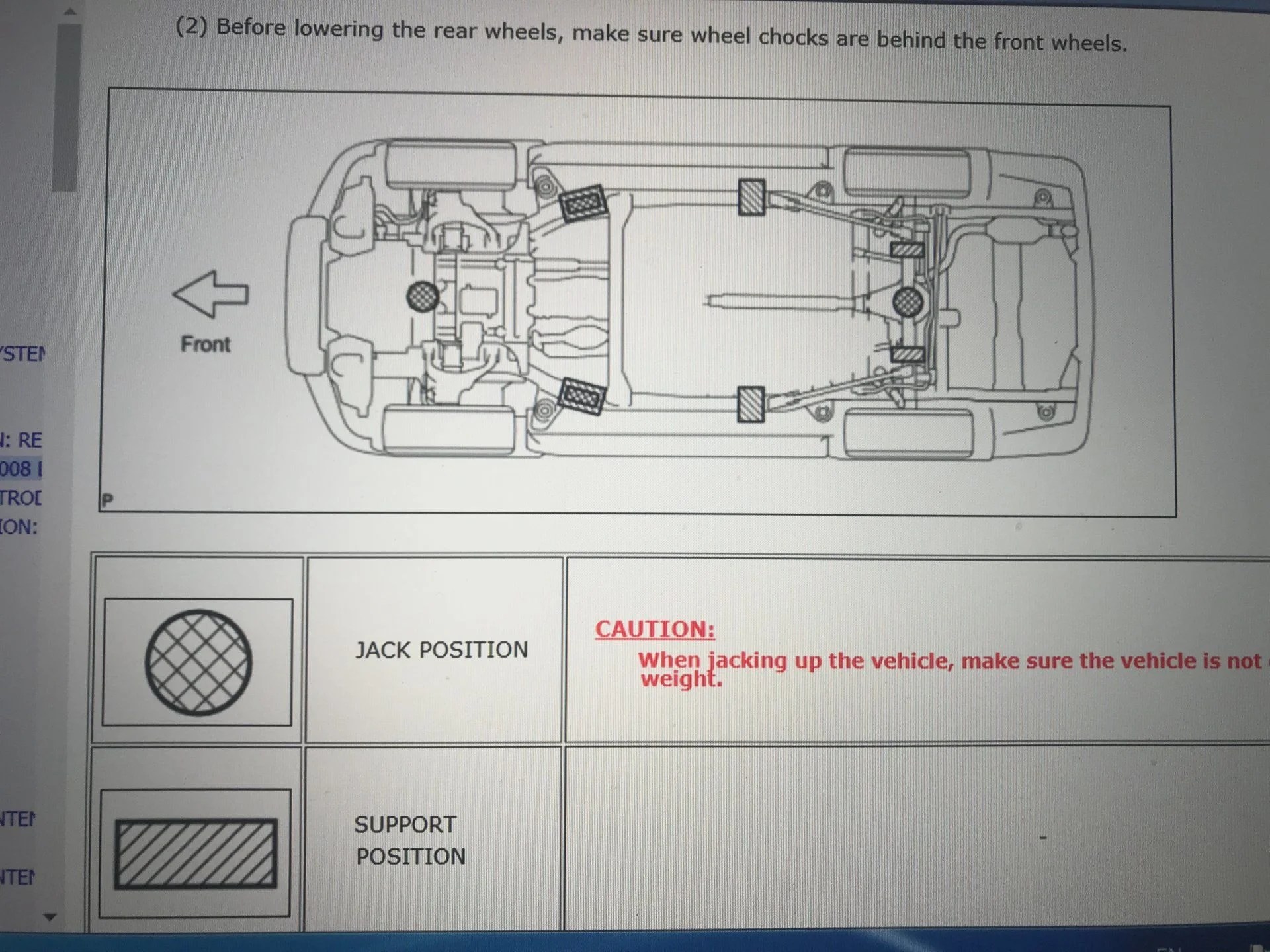

other than the obvious rails on the ladder frame - is the item highlighted in pink a lifting point? Can't confirm in the manual. I'll be using a 3 ton jack with stands. Pic is taken from the front looking back in between the front wheels. I need to lift all 4 wheels off the ground.

found this in the service manual
So, this does look like the spot you pointed out in your original post is a jack position. I haven't looked under there but perhaps there is a spot where the skid plates are directly against the frame under the engine, just in front of the front axles?
That area goes straight to the cross member, I’m surprised it’s a jacking point, but I guess it makes sense
I know toyota says to use it but I’ve jacked from that spot and the central rib that supports the skid plates and transmits the load to the main crossmember didn’t seem to like it. No obvious permanent deformation but it felt “squishy” for lack of a better term. Like a stiff spring was between the jack plate and the crossmember.
After noticing that I just used the frame rails.
Yeah, when I looked under mine, I couldn't really determine exactly where that cross member was because of the skid plates. So, instead of going through the effort of taking them off just so I could avoid having to use the jack twice, I just used the frame rails as well.
