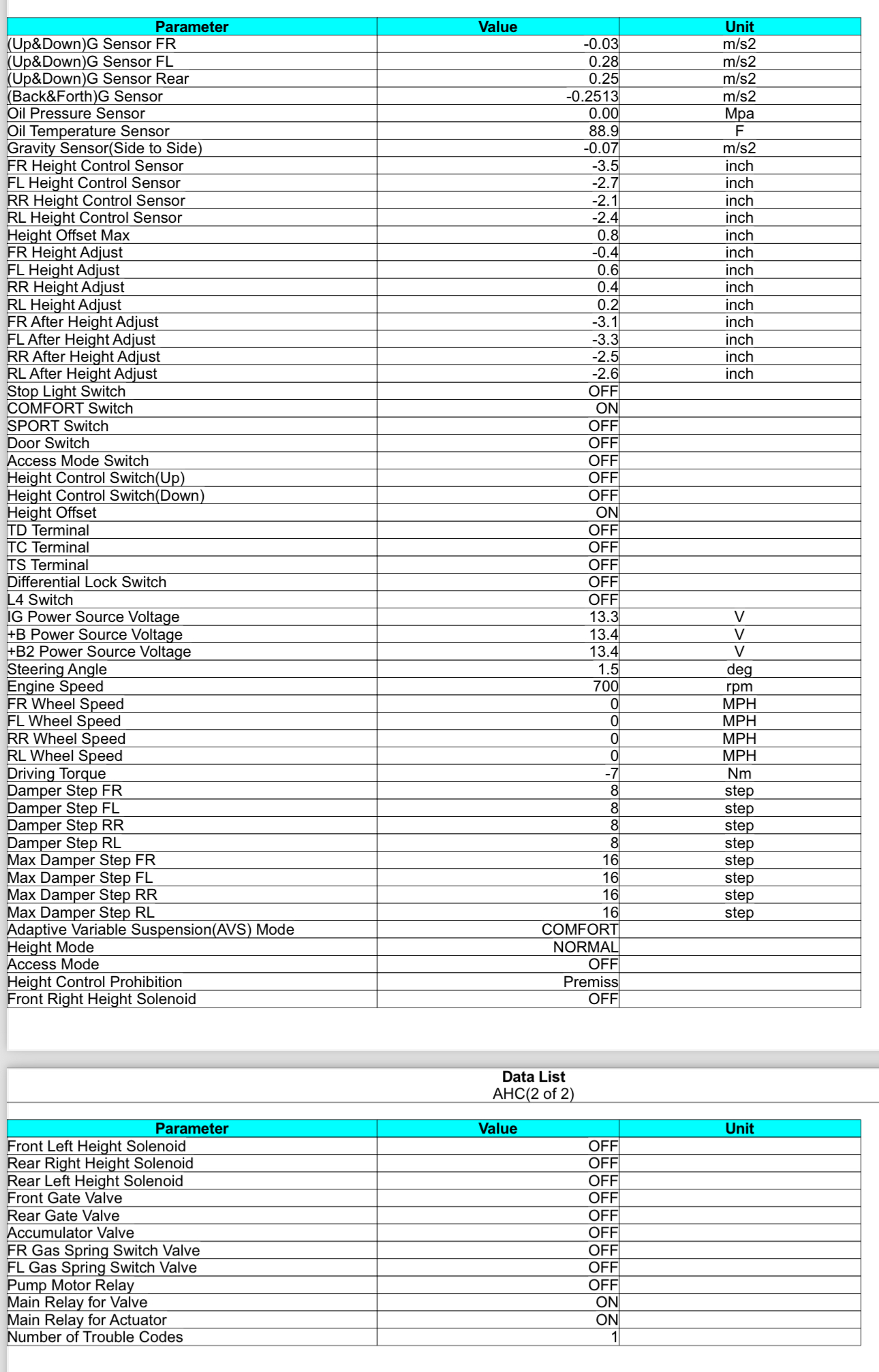

Attached is a data list of values in current condition. I see oil pressure sensor is 0.00. Could this be pump motor?
Advice please

The truck was stuck in low, couldn't hear the pump come one. From what I read about the error it was the always the pump. If the globes go bad it would be slow lifting and a bumpy ride. I brought to the Lexus dealer who diagnosed the pump and ECU. The pump will need to be replaced. I don't have the tools or know how to do myself so I shopped around and had the dealer do it after much negation.
