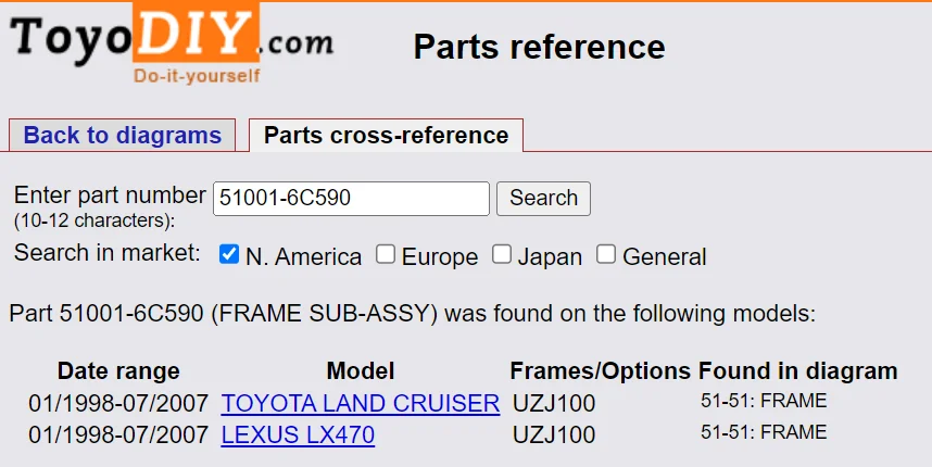

Literally the exact same part number for the later years.
This is not the correct interpretation of the parts catalog. There are many different frames. But as with regards to the question, I believe non-AHC sliders can work on AHC vehicles (sans AHC) or they can be made to work quite easily.
