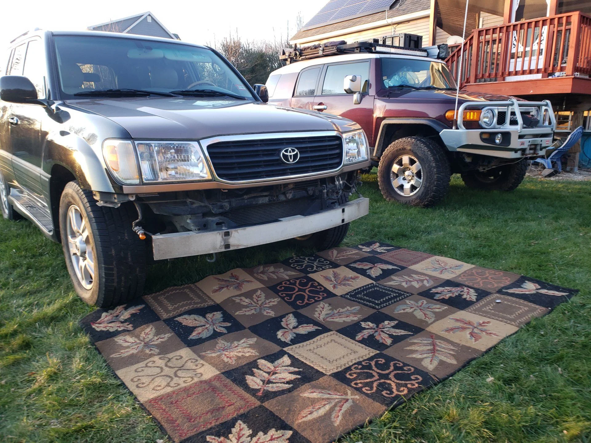

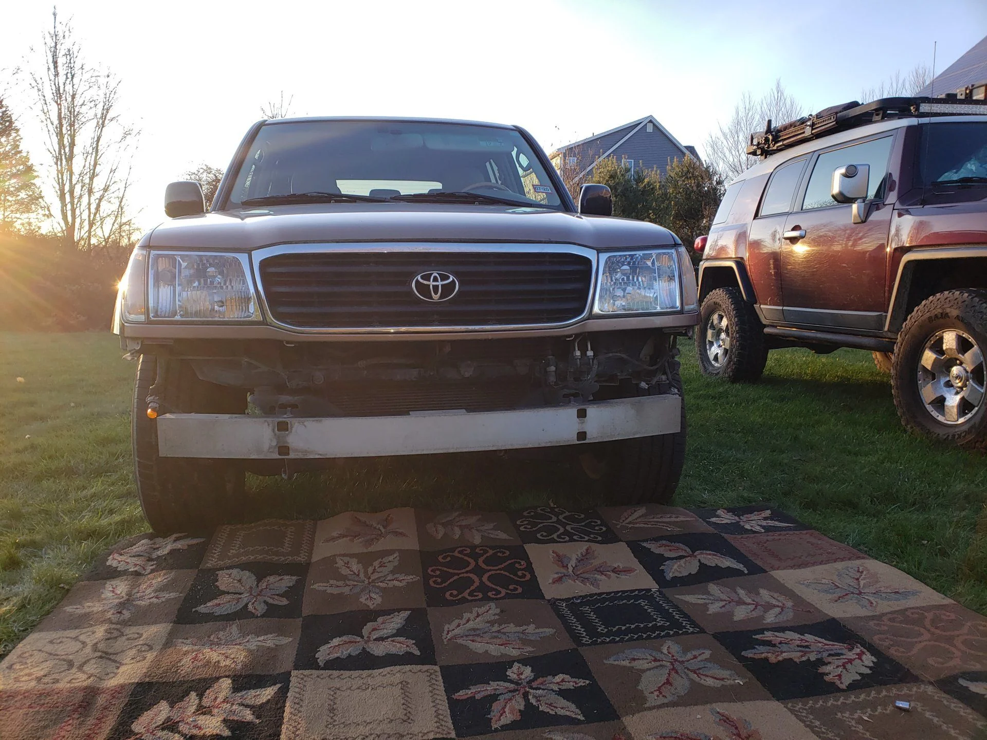

started the conversion. Looks like everything will physically fit. Wiring is another issue

the LC's headlights are in better condition than my lexus headlights

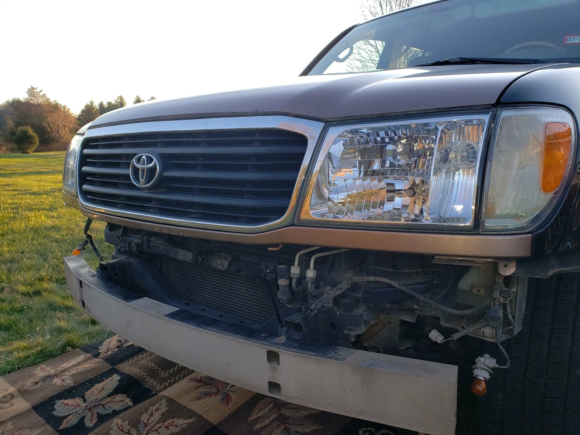

Looking good, how did you do the hood latch part? Also those corner lights seen better days, i'd get the 1 piece Depot lights and it'll look really good.

Corner lights just gained moisture from sitting outside. They should dry out nice and fine. We just transferred the safety latch from the LC to LX. 2 bolts and it went right on.
Ok... so all told, how many :banana: is this job? Cost?
For us, free since we had a part truck. Pricing could vary depending on sources. Overall, maybe a 3 banana job. Just a lot of bolts and a few pop rivets. Wiring is another issue that we haven't tacked yet though.
