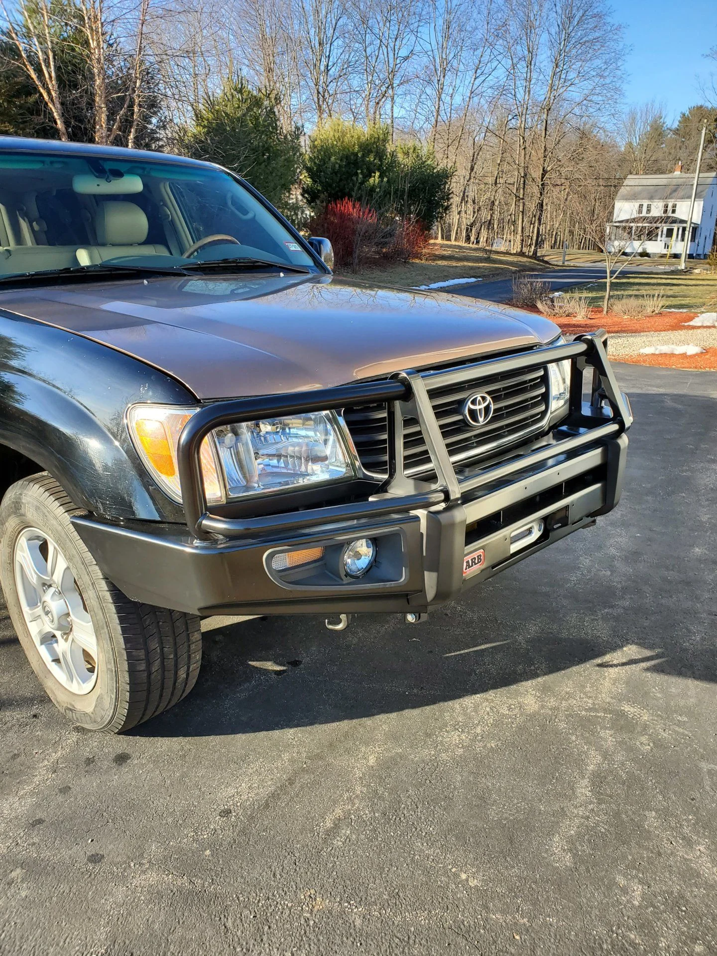

We started a project of swapping over the front end of my LX a month ago because of how bad our LX headlight are. Everything swaps over and the wires swap so the connectors work.
It looks great.

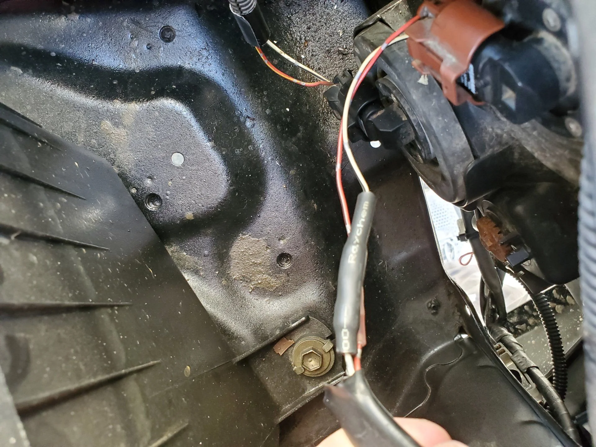

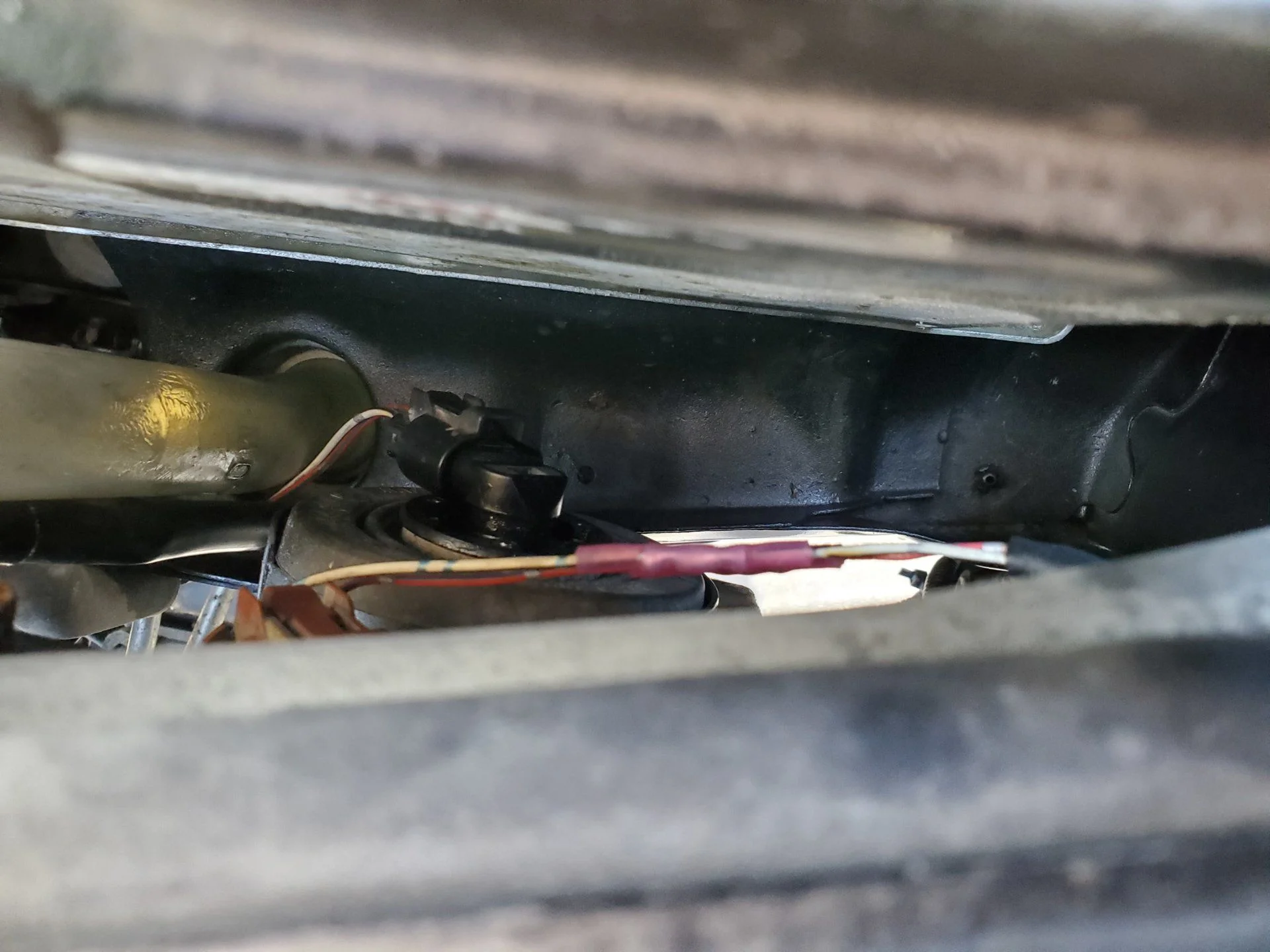

The wiring is tricky with the corner lights. The headlight connectors for the high and low beams will swap right over. The Lexus corner light will insert into the LC parking light. We then split the Turn signal to the corner light and to the ARB turn signal.

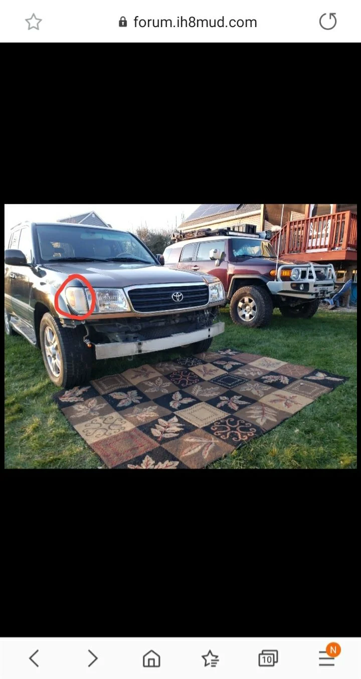

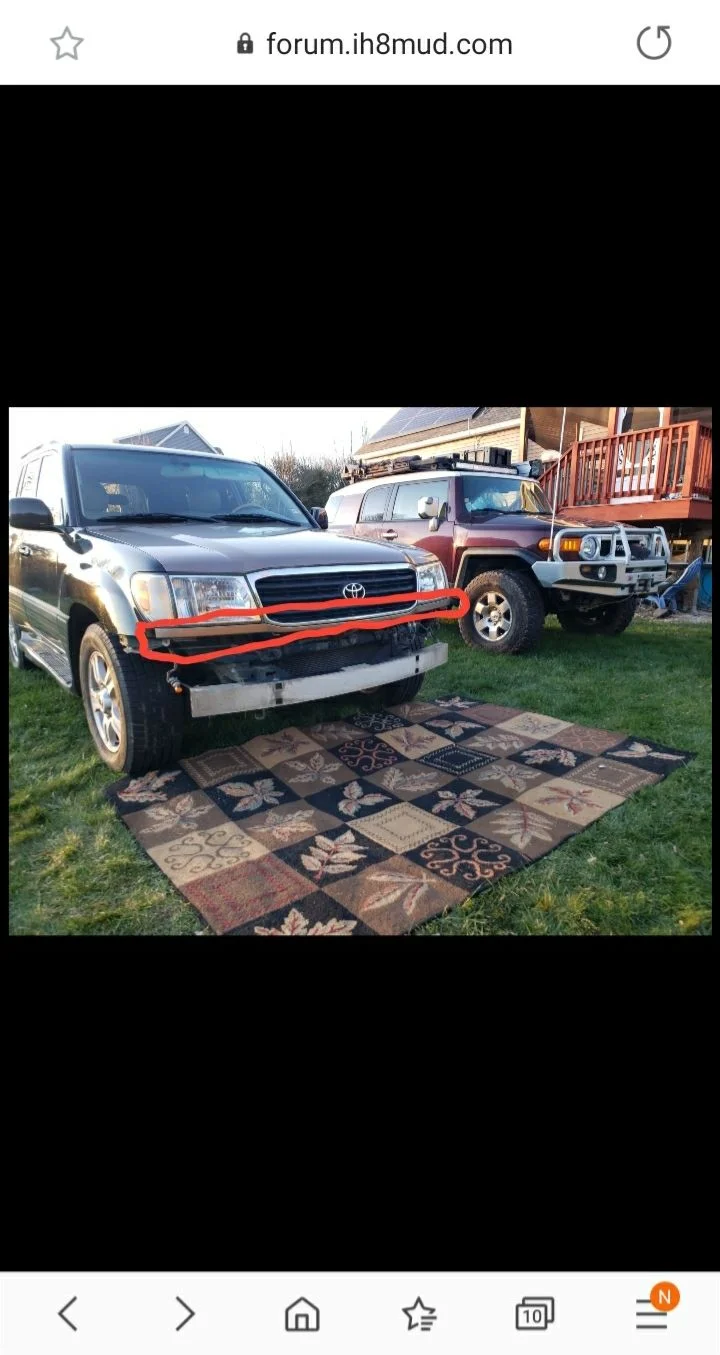

Hi it's a super job congrats!!! And thanks a lot for sharing the data. This is the only thread available in internet on this topic. If you don't mind, could you please post the parts list for this swap ? I am also thinking about such a project. Is that bottom trim is custom made or its available to buy ? Have you done a youtube video on this ? Are these indicators are of LX or LC ?
Bottom trim piece is OEM off a '99 Land Cruiser. Indicators are off of the Land Cruiser as well. Connectors had to be swapped, and some wiring was extended for the bumper turn signals. It will certainly be difficult without having a parts vehicle, but I can try and get a list of everything you need this week
