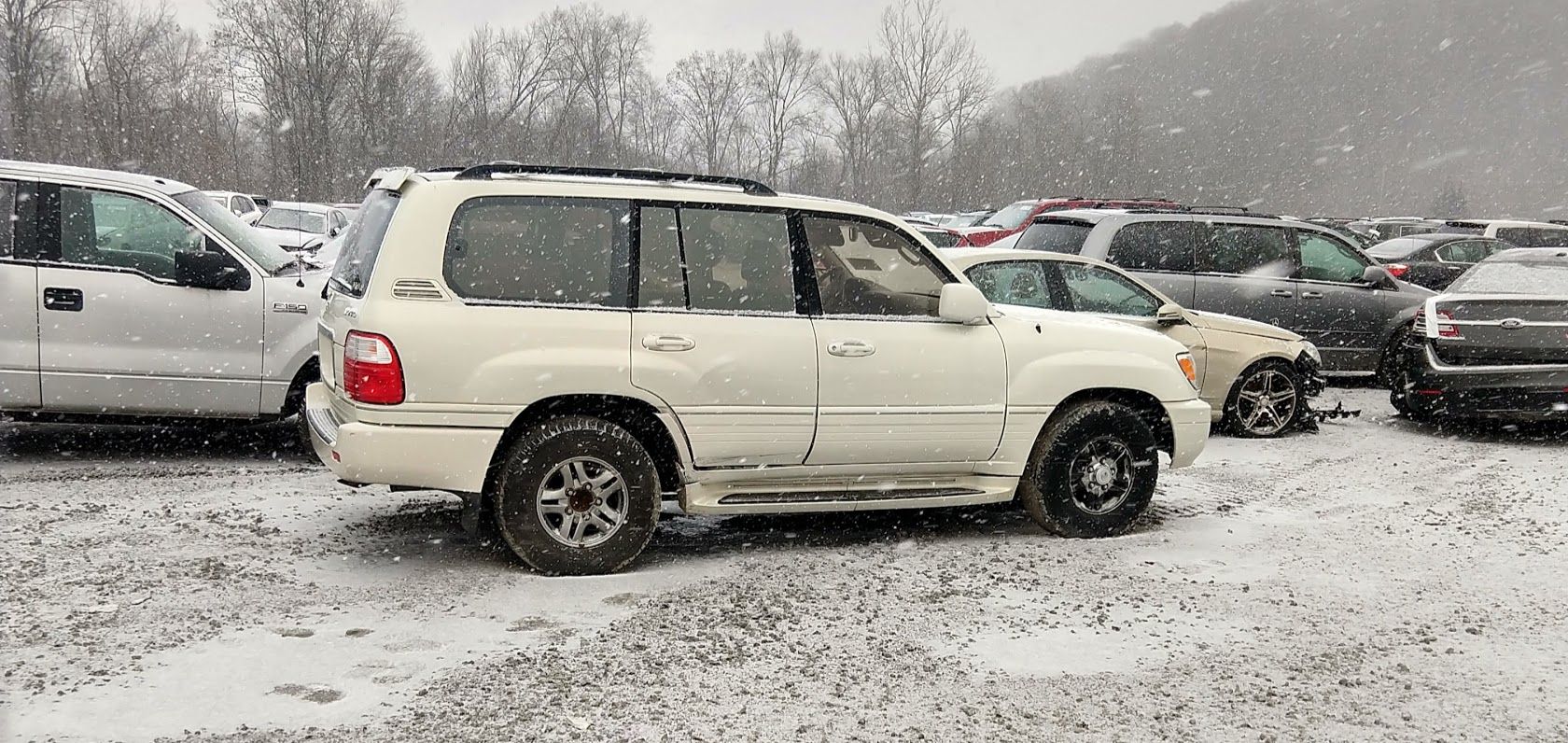

I just bought a lightly wrecked 02 LX470 for what I think is a nice price. The impact occurred under the right rear door (which still closes and seals) and it pushed the wheel/tire back about an inch due to the collision angle.
The axle and wheel are running smooth and true and there isn't any leaks or seepage from anywhere in the rear. The control arm, lateral arm, and panhard bars are all straight, as well as their mounts.

It hasn't made it to a frame shop as of yet, I'm just seeing if I can do anything before it gets to that point. I just figured it has to be the housing at this point. LR wheel is straight and centered, RR is toed out and pushed back about an inch.

This is the RR side. Looks to be angled back.
Compared to the LR side, which is straight.
