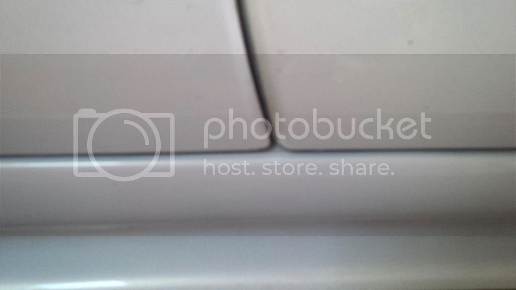

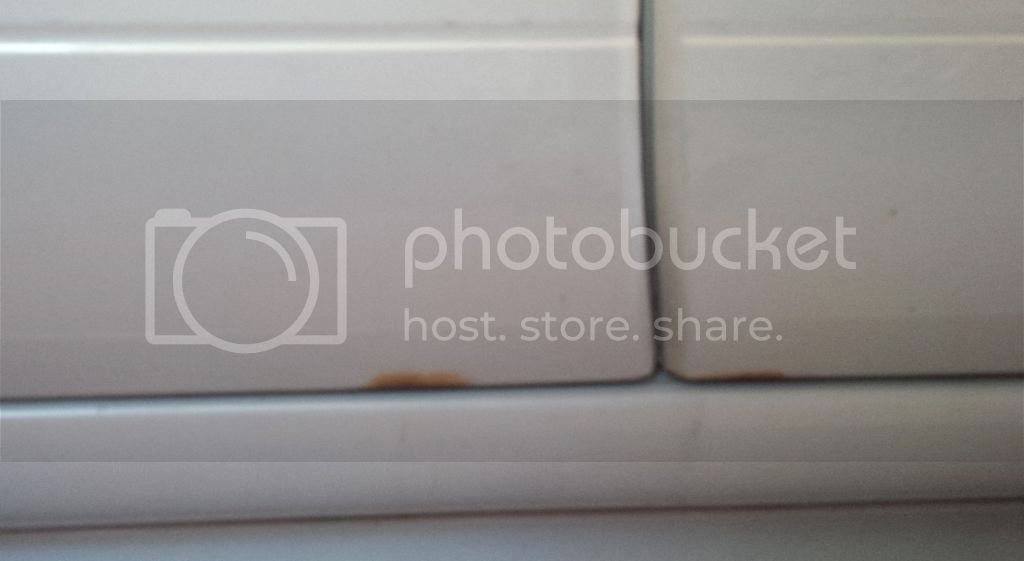

Maybe others knew this but I started noticing these spots on the bottom of the doors, especially noticeable on white. Asked shop what it was when I was in there and they said metal inside the moldings rusts and the rust goes through the plastic, paint etc and touching up was their suggestion. I looked at it closer later today and that didnt seem to make sense as there was no rust behind panel just what looked like rust run off from the door drains. Took some polishing compound to it and to my surprise it all came off.
Glad I didnt do any unnecessary touch up work.
