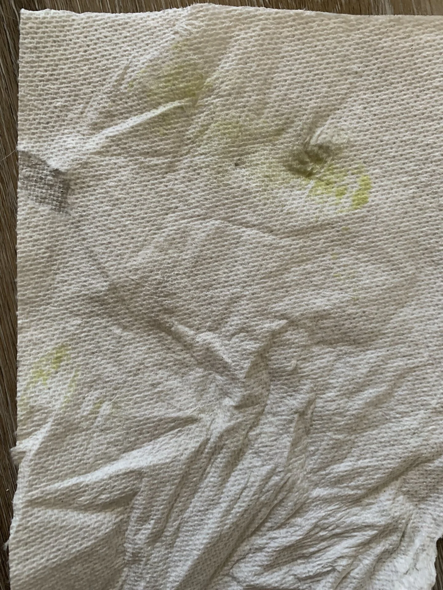

Not sure if you can actually see. I shouldn’t have but I did clean everything up prior. Then I took it out for a drive, about 10 miles total. Half of it was on highway. Looks like the weep in mainly on the back side of the shock. Looks like it’s seeping from one spot, and just weeping/trickling down the shock.
Color of the fluid seeping out looks kinda funky or different from the fluids I used….but I’m color blind….

Hmm. Interesting. That pressure is fine.
What color is your coolant? Green or yellow by chance?
That doesn't look like AHC fluid I normally see, but it does have that neon coolant look to it.
If that is AHC fluid, that's not enough leak to concern me for a trip right now (I might be a risk taker, lol), but I would probably replace that shock when you get a chance - again if it is in fact AHC fluid.
I've had multiple trips sidetracked by alternator issues in the 100. Two different 100 series, at that. And currently have a starter problem that's got my LX stuck in place at home right now. I guess my point is that if your goal is to eliminate all possibilities of a road trip gone wrong, that's a hard thing to do in a 20 year old car - even if it's a Land Cruiser.

well. the coolant I use is the toyota red, and have to dilute it with distilled water half and half. So probably not that.
I see. I'm definitely contemplating if I should still go or just stay put and use this time to get the shock replaced.
I totally understand, there will always be something to fix or work on with this 2000 LX.
