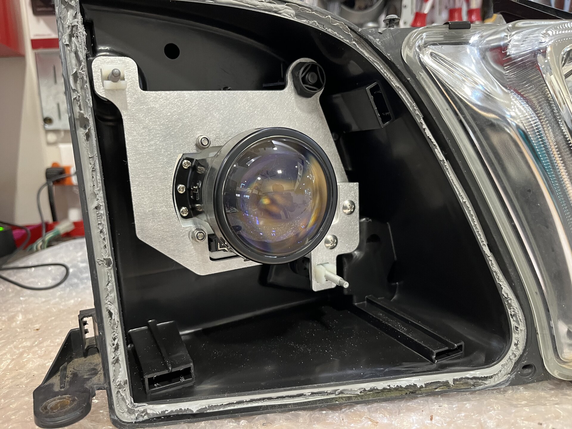

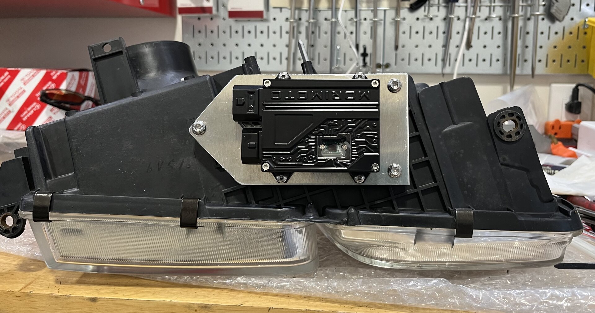

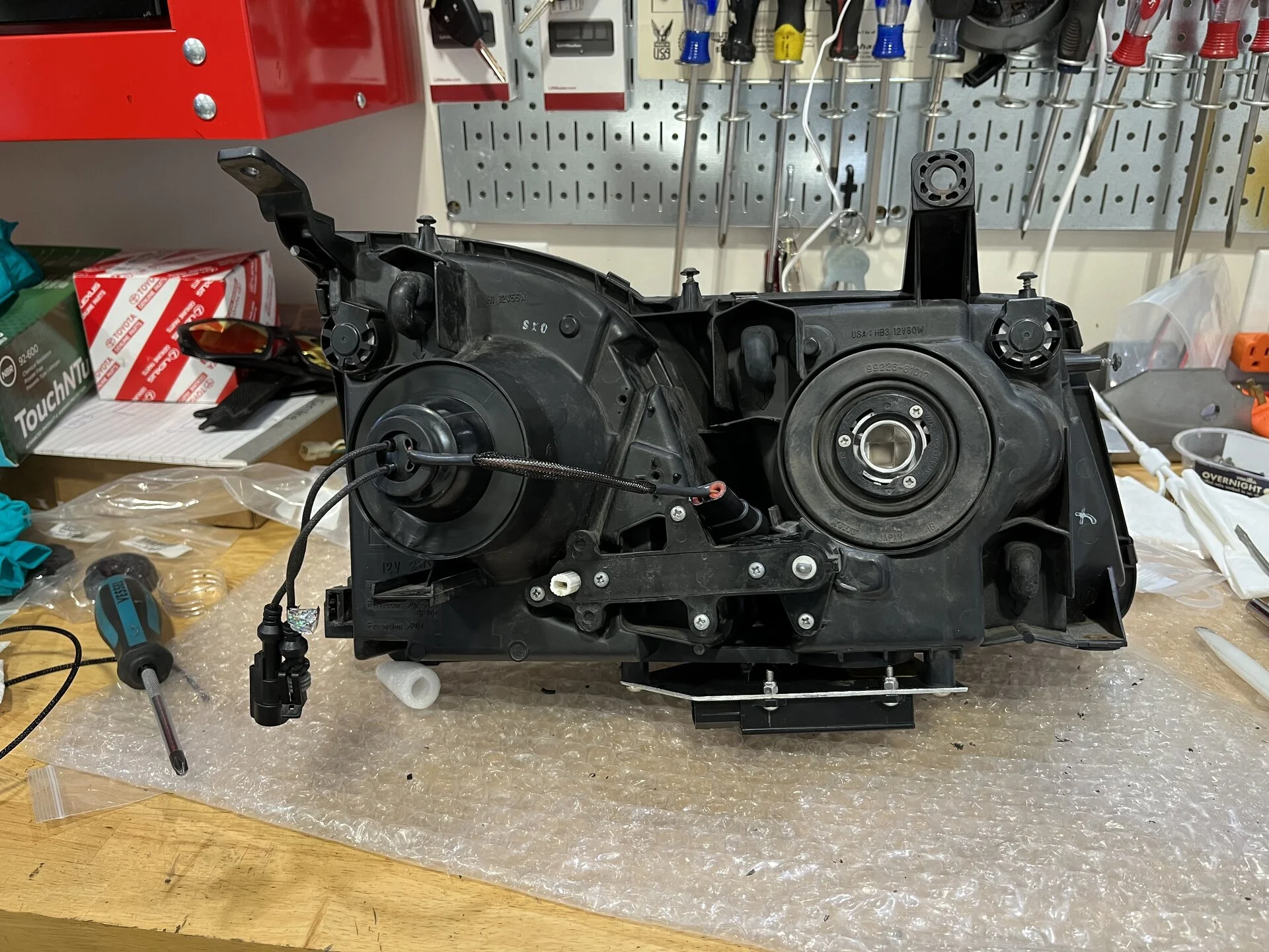

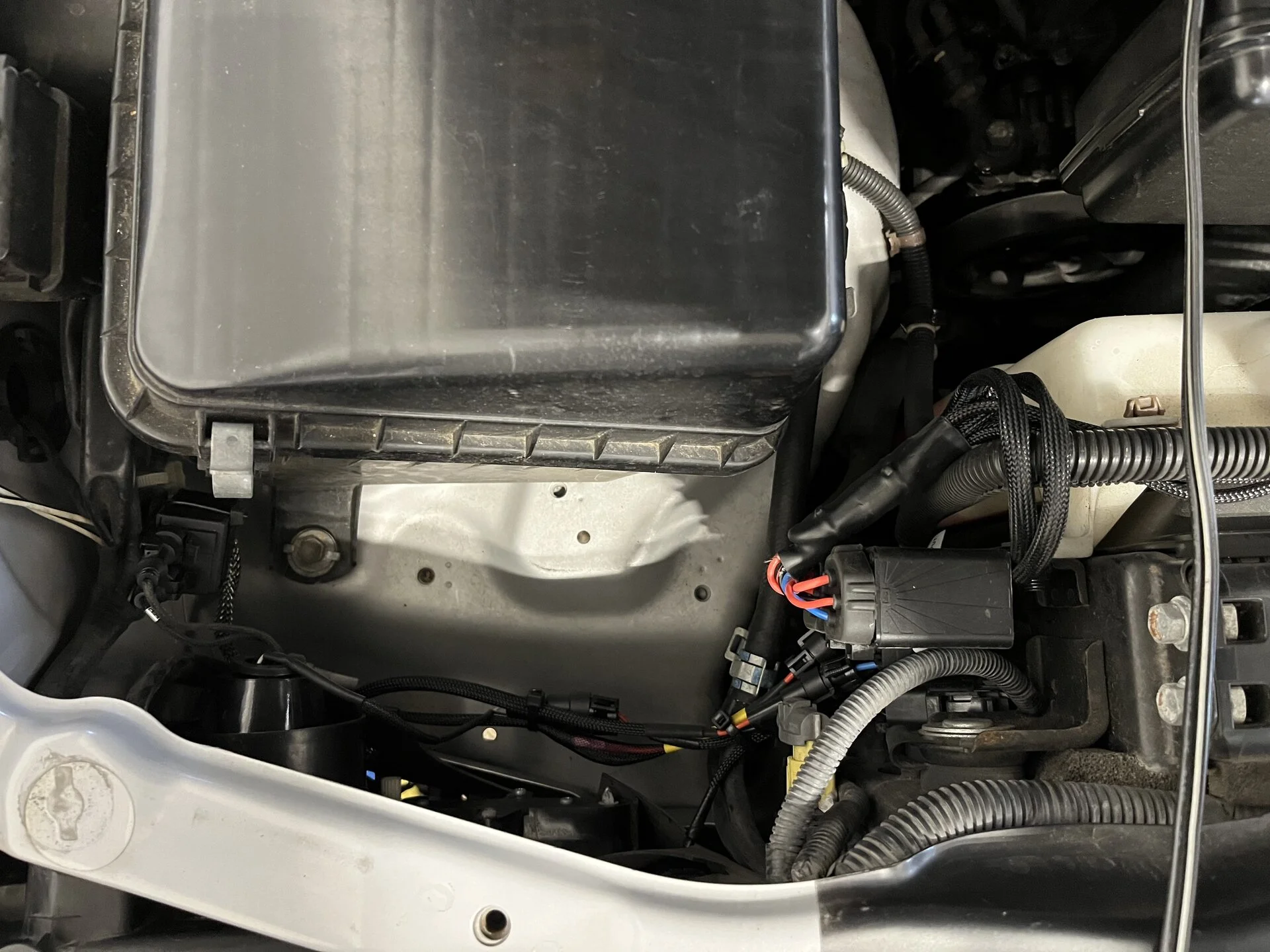

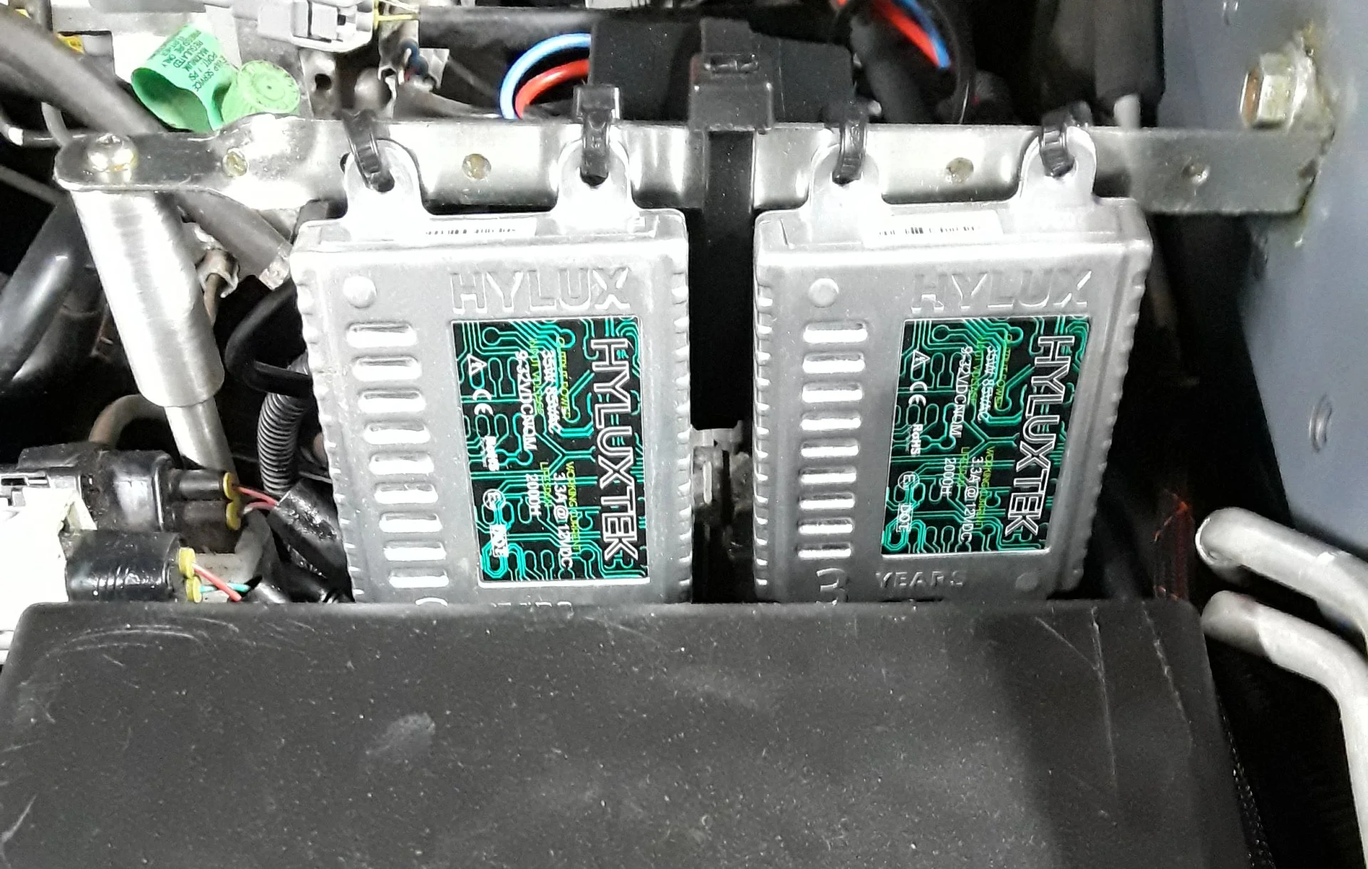

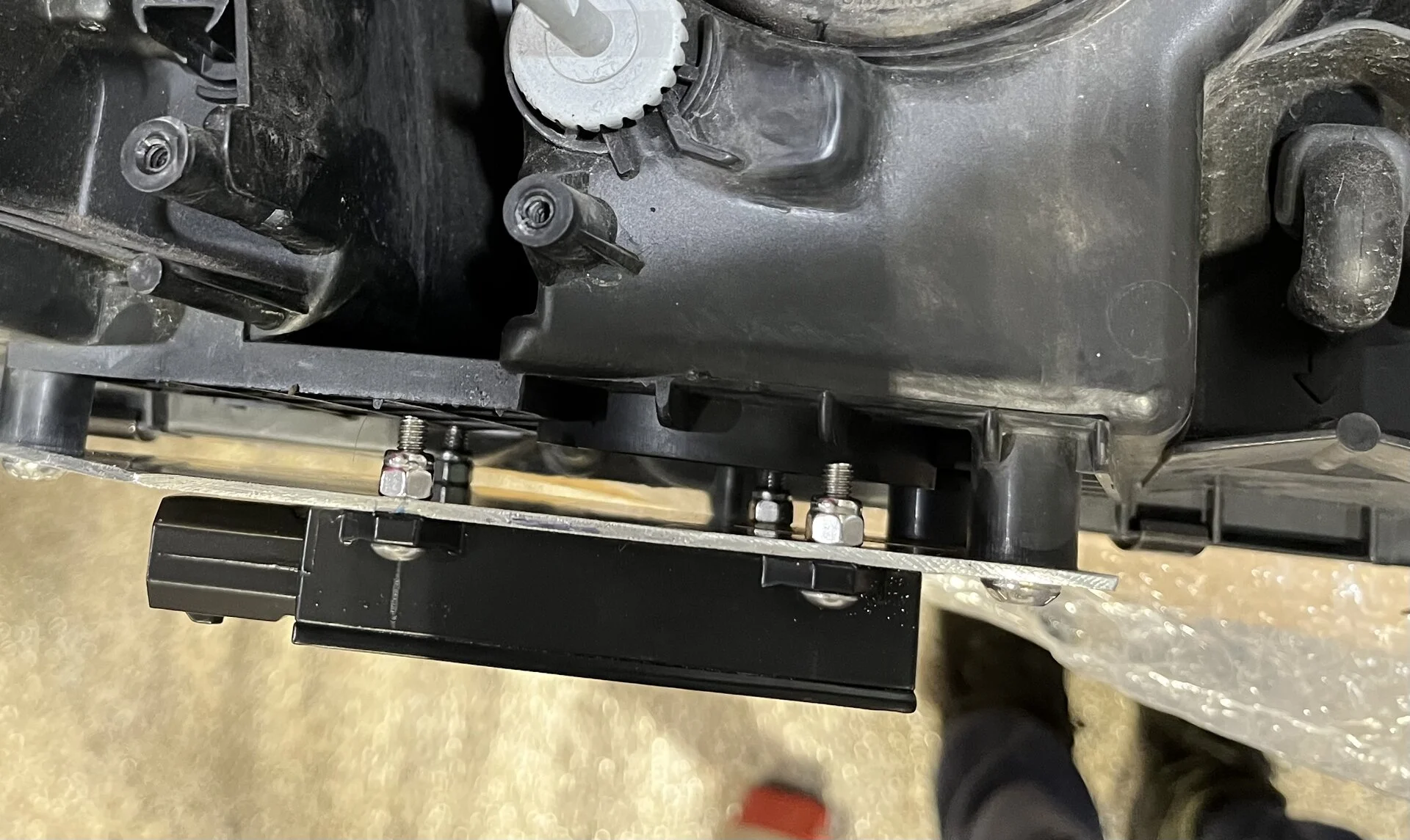

some more pics. clearance to the winshield washer fluid filler tube is good. driver's side ballasts mounted behind the fuse box. i haven't sorted the passenger side yet.

Just wanted to chime in and say the bracket made it absolutely easy to retrofit. Easy to aim and they are dead even afterwards.
I did not use any sealant when I resealed them headlights, I just heated up whatever was used in the stock housing and pressed them lens and housing together and haven’t had any moisture issue in 3 years. I also hooked the HID connector directly to the oem harness. No issues there either, I had flickering issues when I used a relay so I ditched that and connected directly to the stock connector.

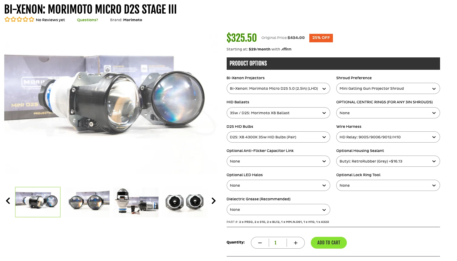

I'll be buying some brackets from @Luke111, and it looks like rather than get the Morimoto Mini H1 Stage III kit, I could instead get the new Micro D2S Stage III kit which is currently on sale, plus takes the D2S bulbs: https://www.theretrofitsource.com/bixenon-morimoto-micro-d2s-stage-3

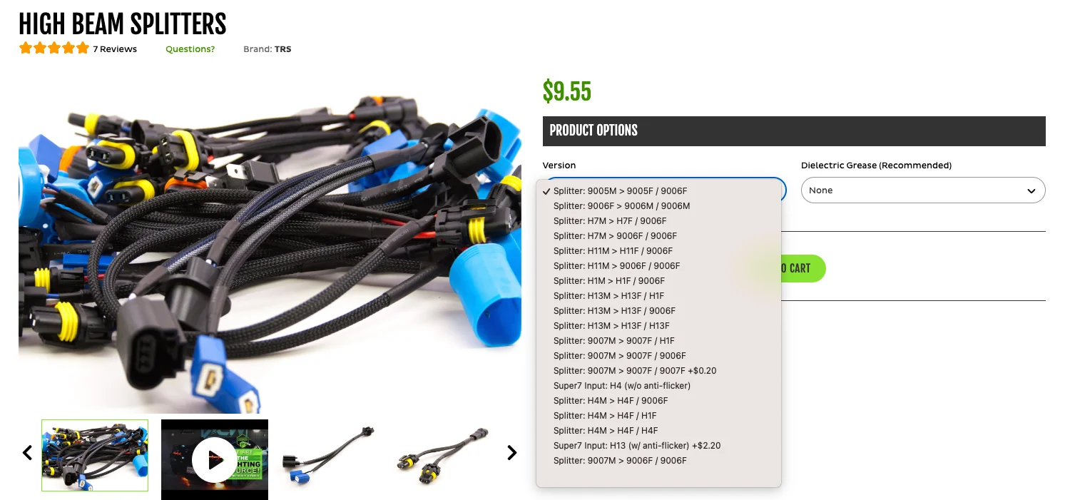

It looks like since I'm ordering directly from TRS instead of Lou, I need to order the kit, plus the high-beam-splitter and the extension cords.
There's a bunch of options on the ordering pages, are these correct for what I need?
The kit:
The splitters - is the top one the correct splitter?
The extension cords:

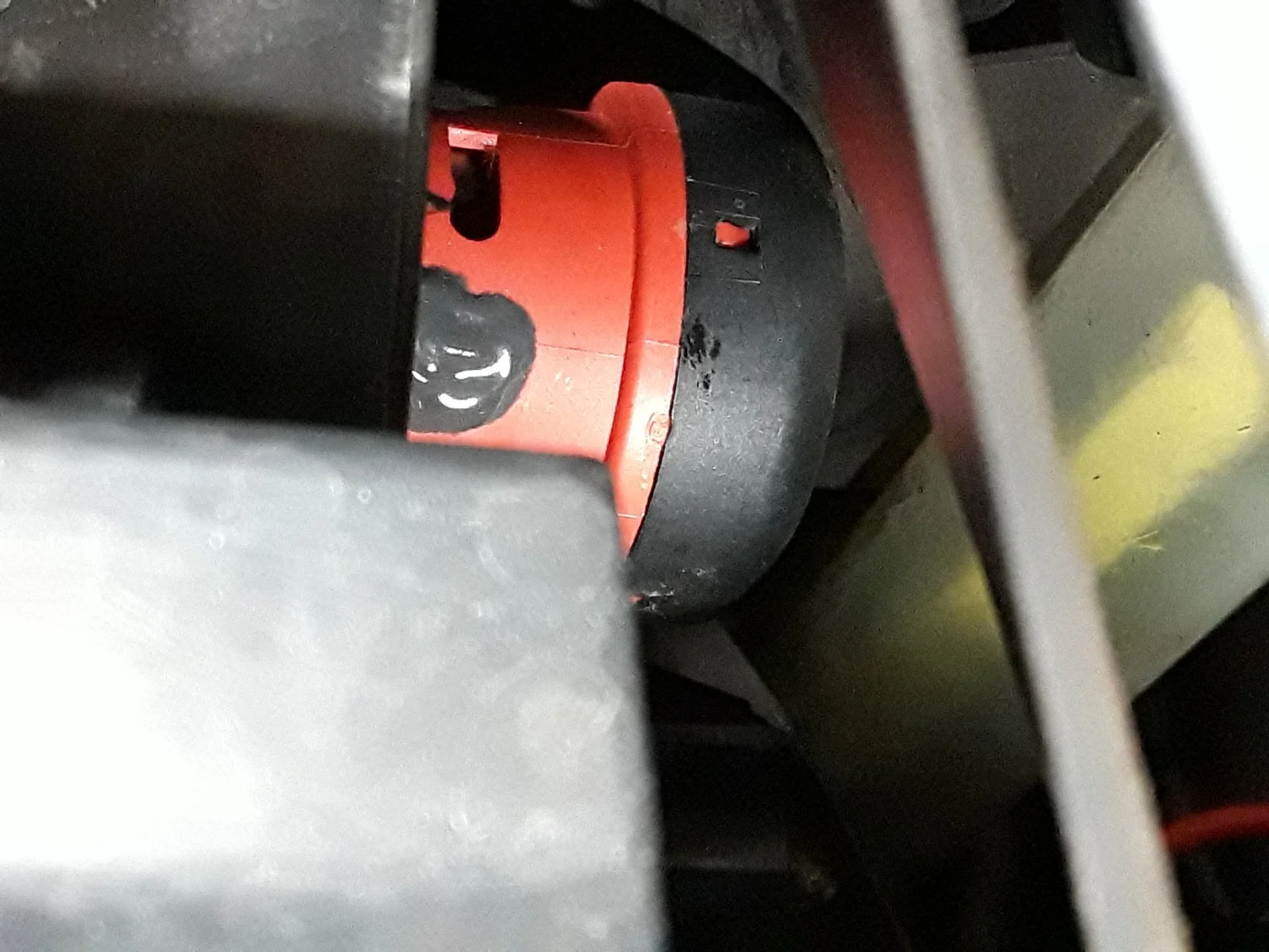

Looks like I'll also need a housing cap, but the one mentioned previously isn't available through Amazon anymore... @777300er any suggestions for replacements? When I search Amazon for "Headlight covers 80mm" there's a ton of options in all different shapes!:
Also, for D2S users I found a good sealing cap that also has a hole in it specifically for the bulb connection. Again, only for D2S users. Mini H1 need not apply. You have to cut the center hole in the cover shorter, then put the grommet over the D2S connector and plug the bulb in.
Headlight Covers 80mm
