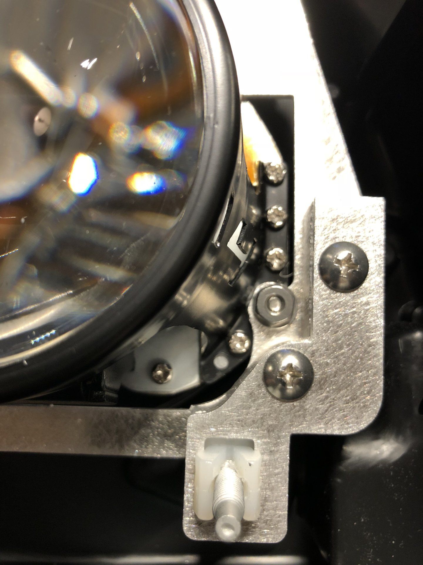

A few close up shots of the tight tolerances the D2S bracket requires

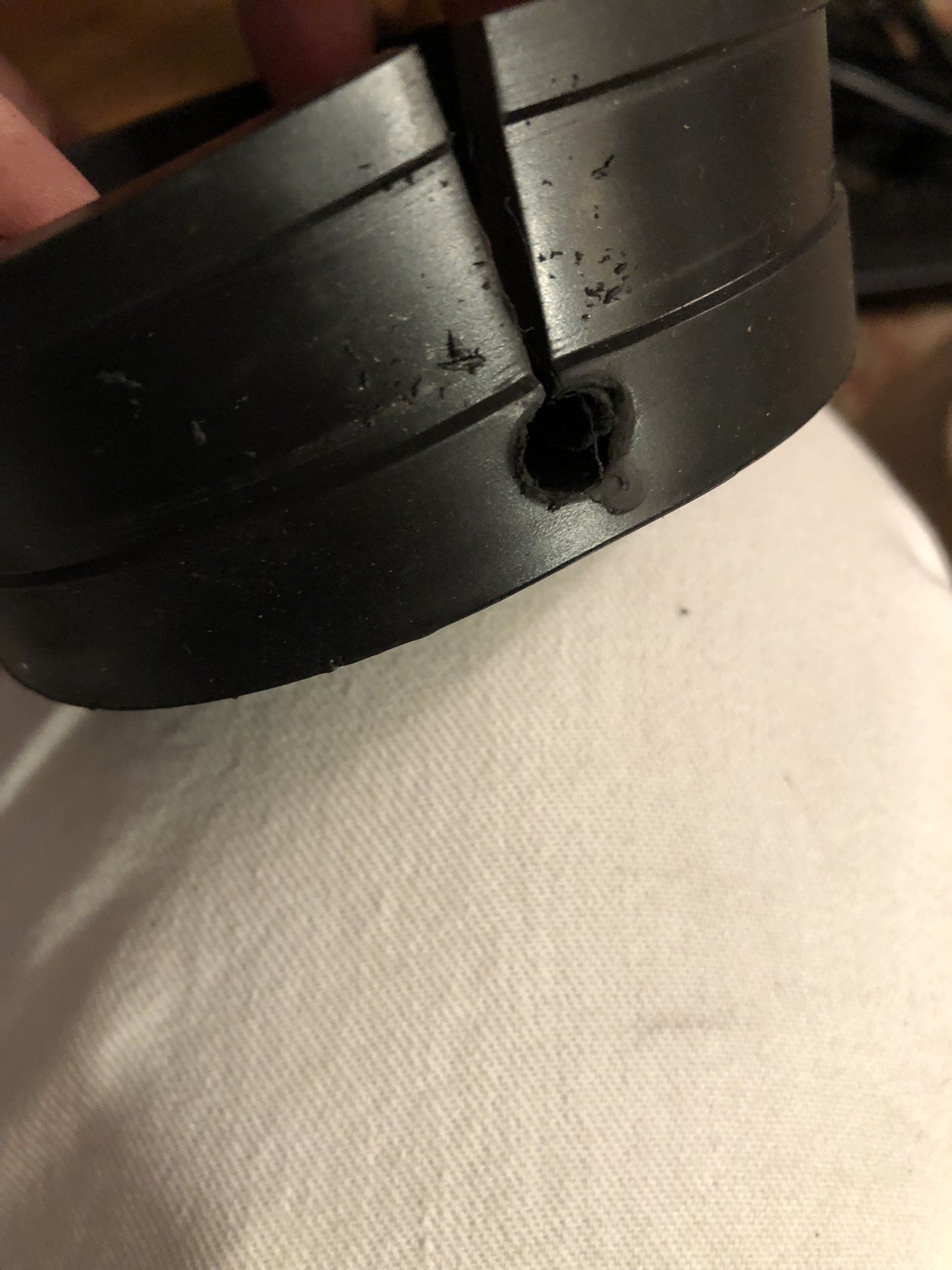

In my quest to come up with solution I headed over to Home Depot‘s plumbing department and found this pretty slick rubber cap with a stainless steel clamp.... I drilled a hole for the igniter wire ... cut a slice to the hole and it works perfect ...well may look a little strange it’s very functionable and I’m pretty excited about it.. and working on a variation that slightly extended

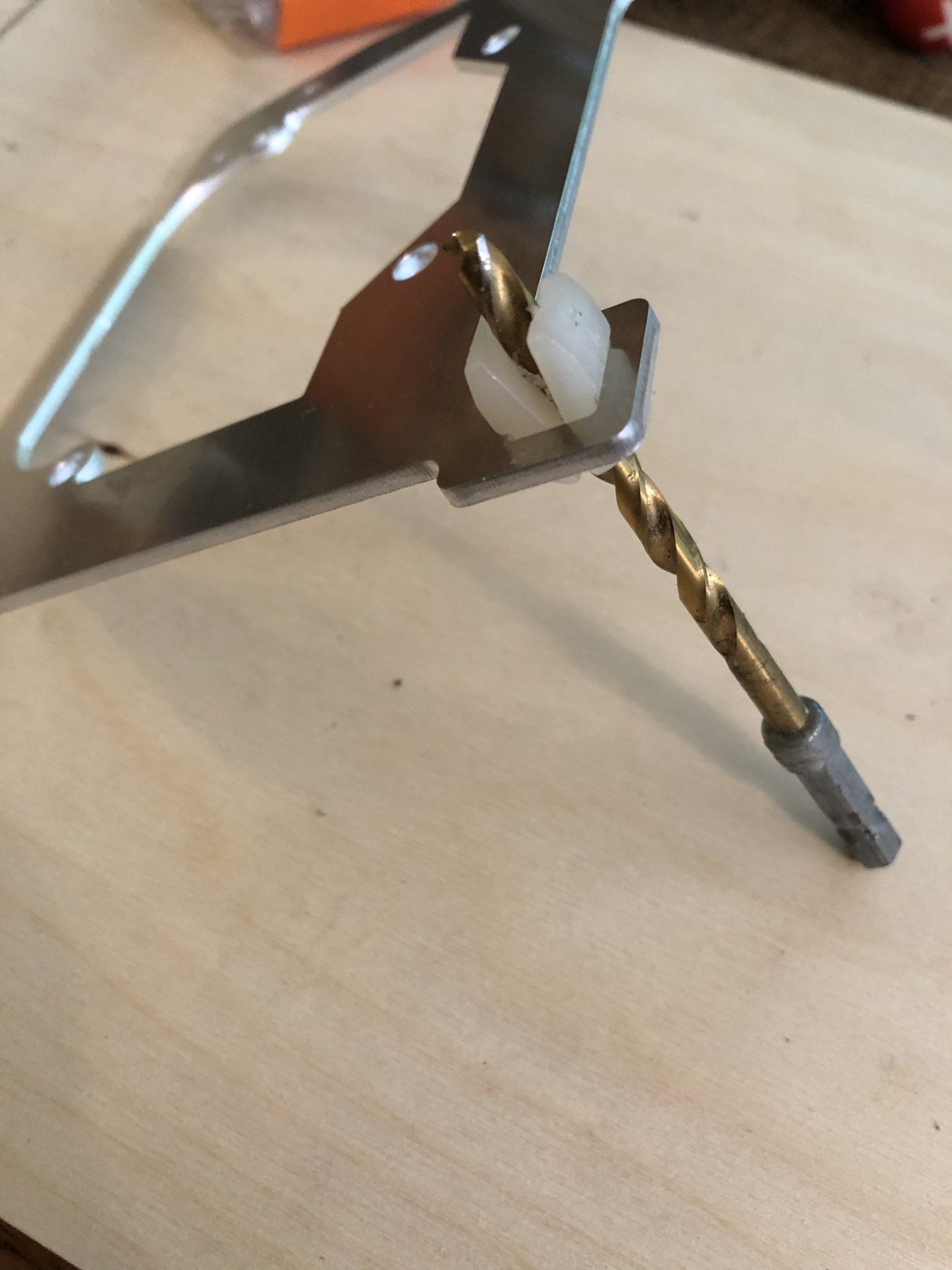

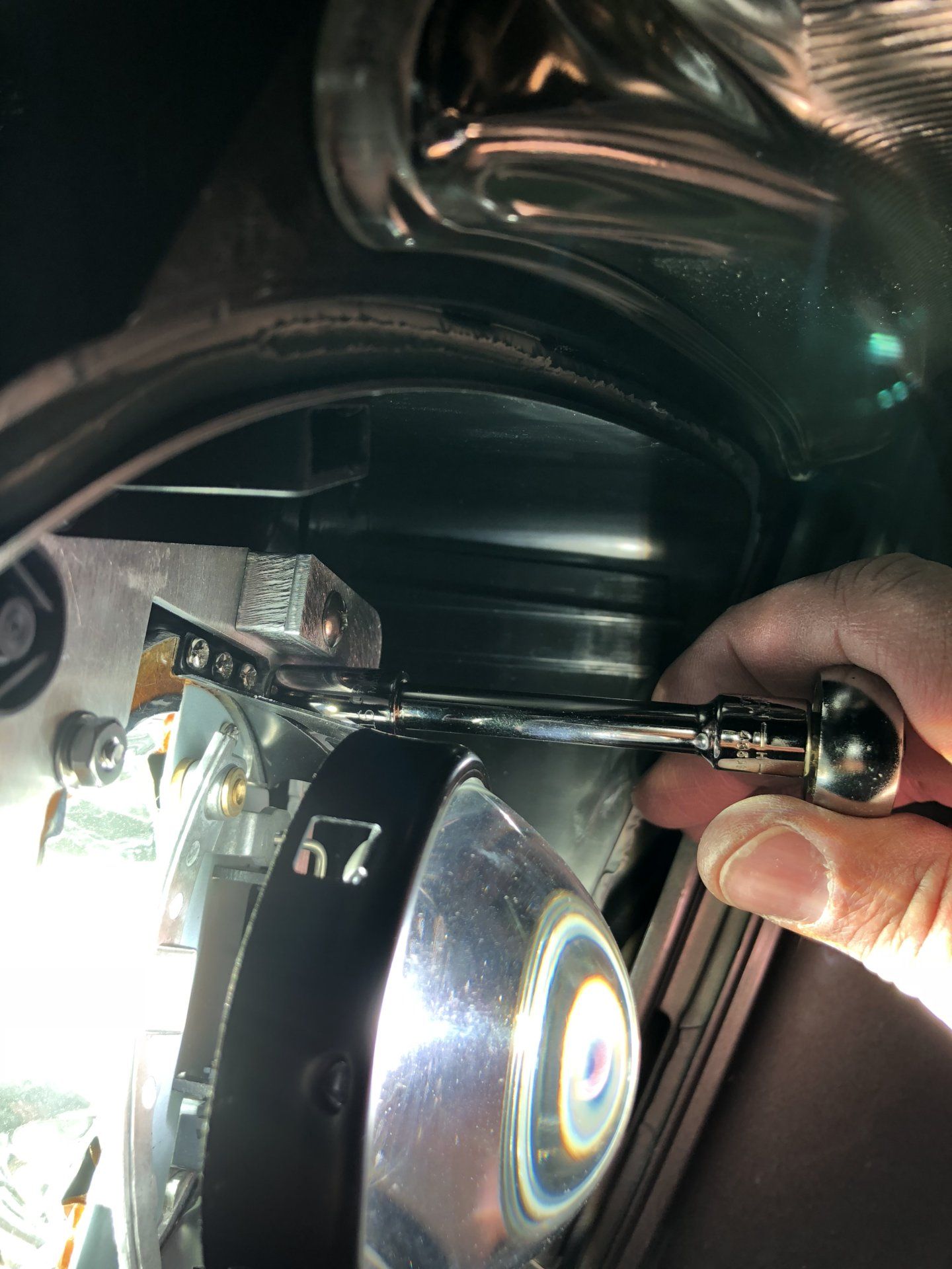

First up the new clips from TRS while they are very tight the hole is quite a bit smaller so you need to open that up with the 3/16 drill bit.

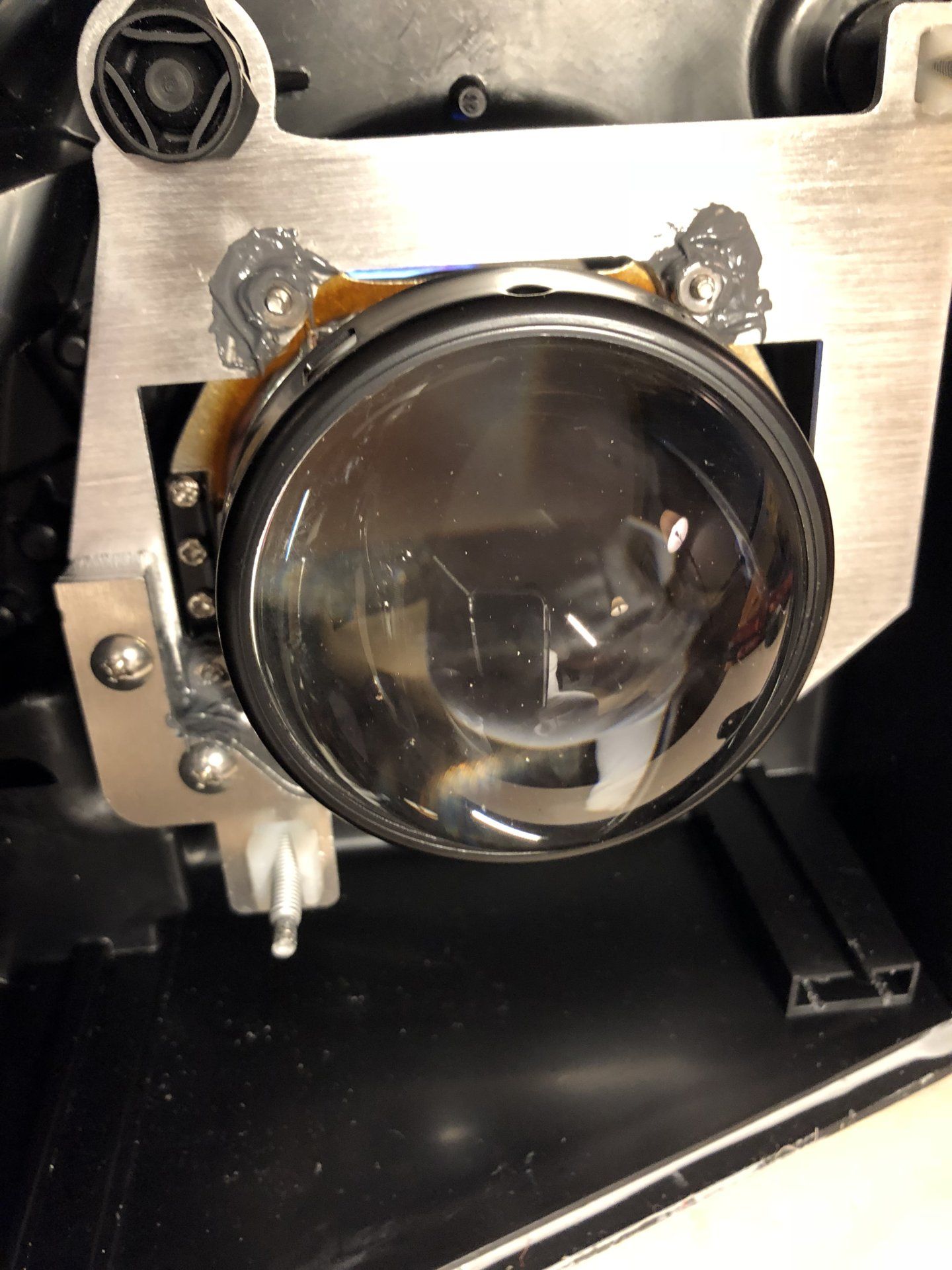

The newer brackets have larger mounting holes so you can fine-tune the rotation but it also create a tightening problem....once you get the rotation adjusted you can’t really access the back of the bolt with the projector mounted in the housing so here’s the trick ....JB Weld your bolts to the projector...I actually attached the nut to keep them secure and square....let them sit overnight. Once they’re mounted to the bracket and the brackets in the housing you go out for your adjustment and simply tighten the nut from the front. I also used JB Weld on the nut just for a little added assurance .

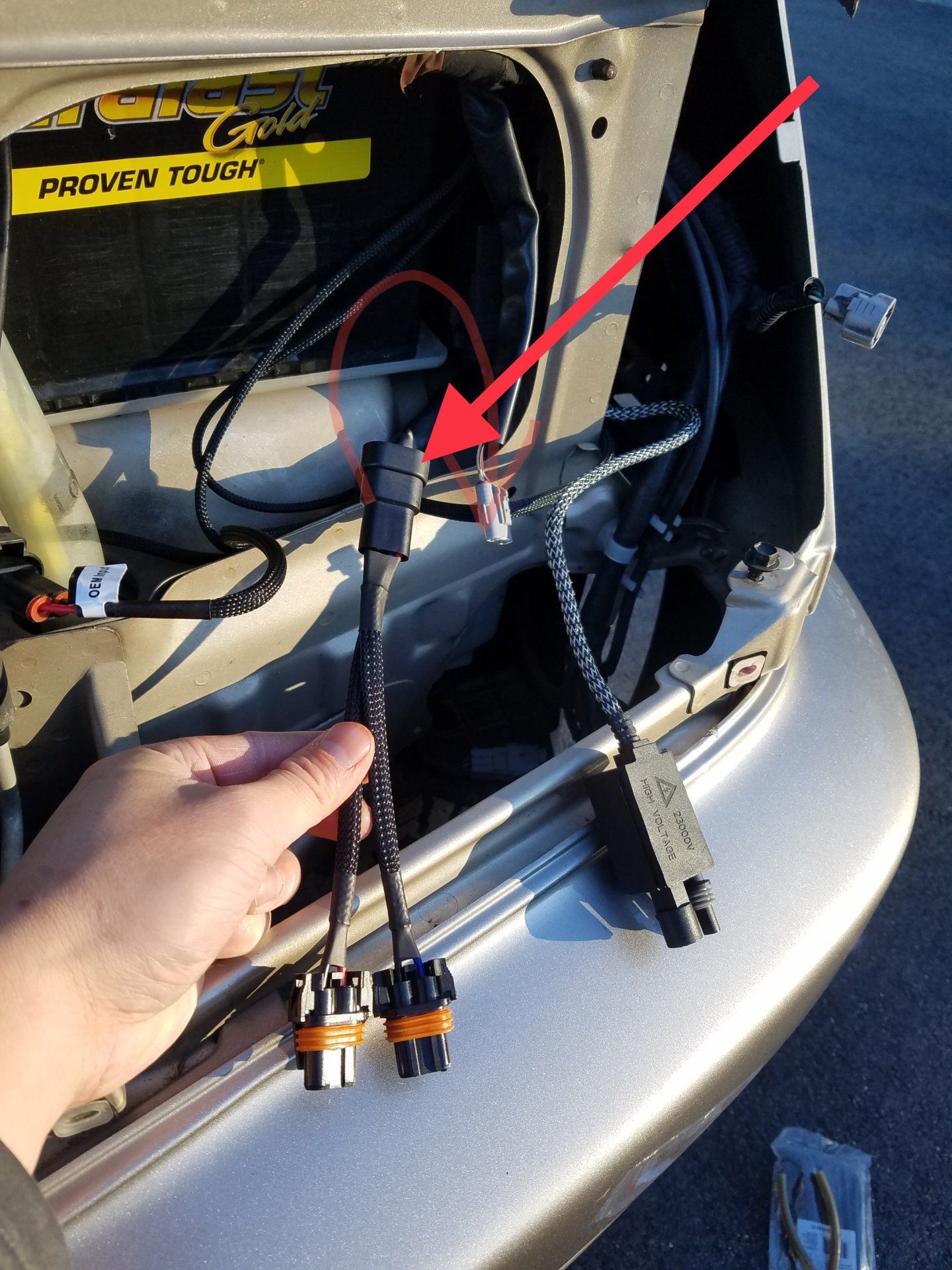

Hey guys, I just started my H1 project and I'm staging the wiring first but got a little confused. Wondering if you guys can help me out.
Am I understanding this correctly, for the high beam splitter: one tail will connect to the OEM high beam bulb and the other will connect to the Moriomoto projector. So the male end of the splitter is suppose to connect to the cars original connector? Am I missing an adapter?
And the OEM input wire coming from the HD relay, that connects to the original low beam harness? And this is only done on the drivers side?
Thanks in advance!
Plug the single connector of the splitter into the OEM high beam connector to trigger the high beam of both. You’ll need a splitter on both sides.

I have a second car so I'm taking my time doing this project. Staged all the wiring, just finished JB Welding bolts to the projector and baking my second headlight now using the 240 degrees F for 20 min and it came off just fine. So far so good, will probably have this all finished by tomorrow. So far so good.
