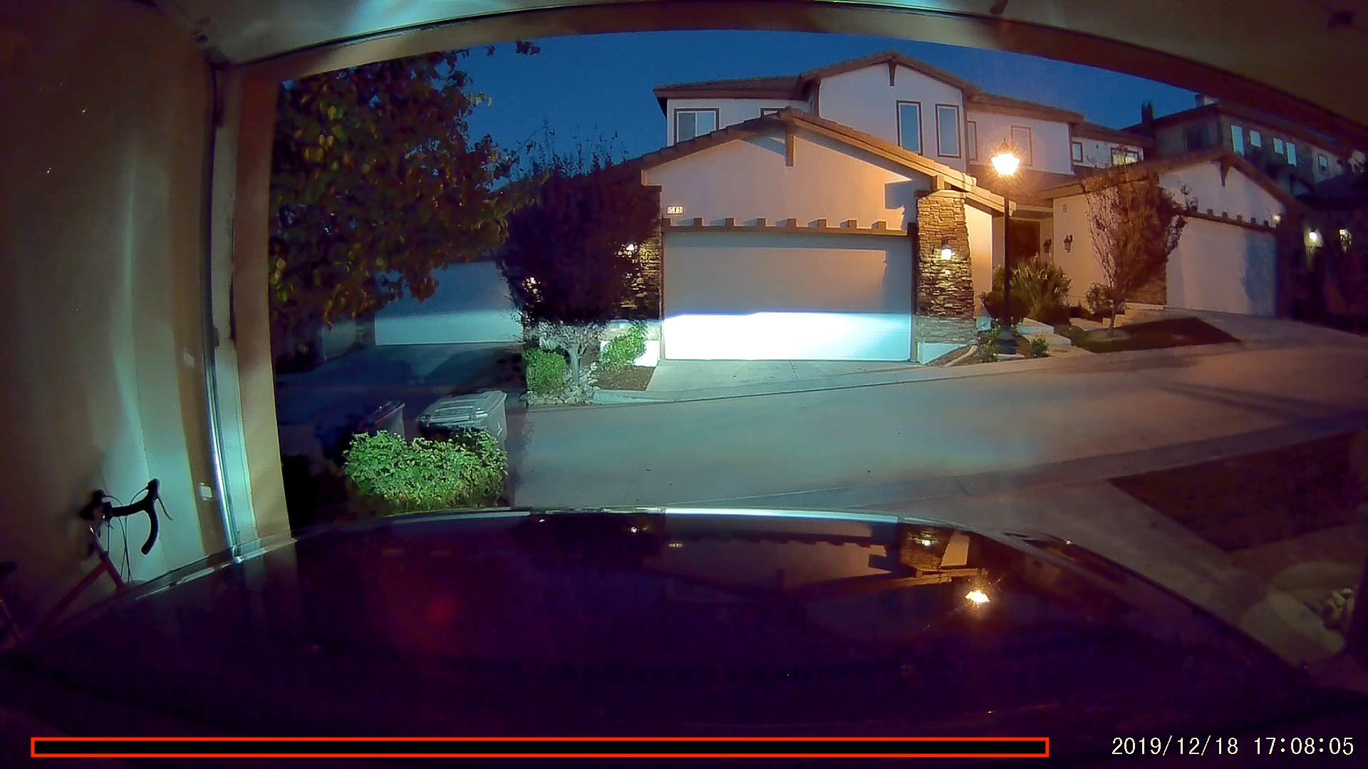

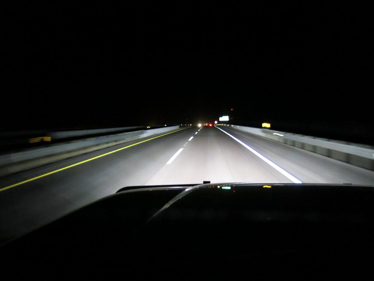

95% of the output shots on my site are the Mini H... the one below is the old Mini H1 4.0 in my 80 and that’s the low beam output. How much better do you need.

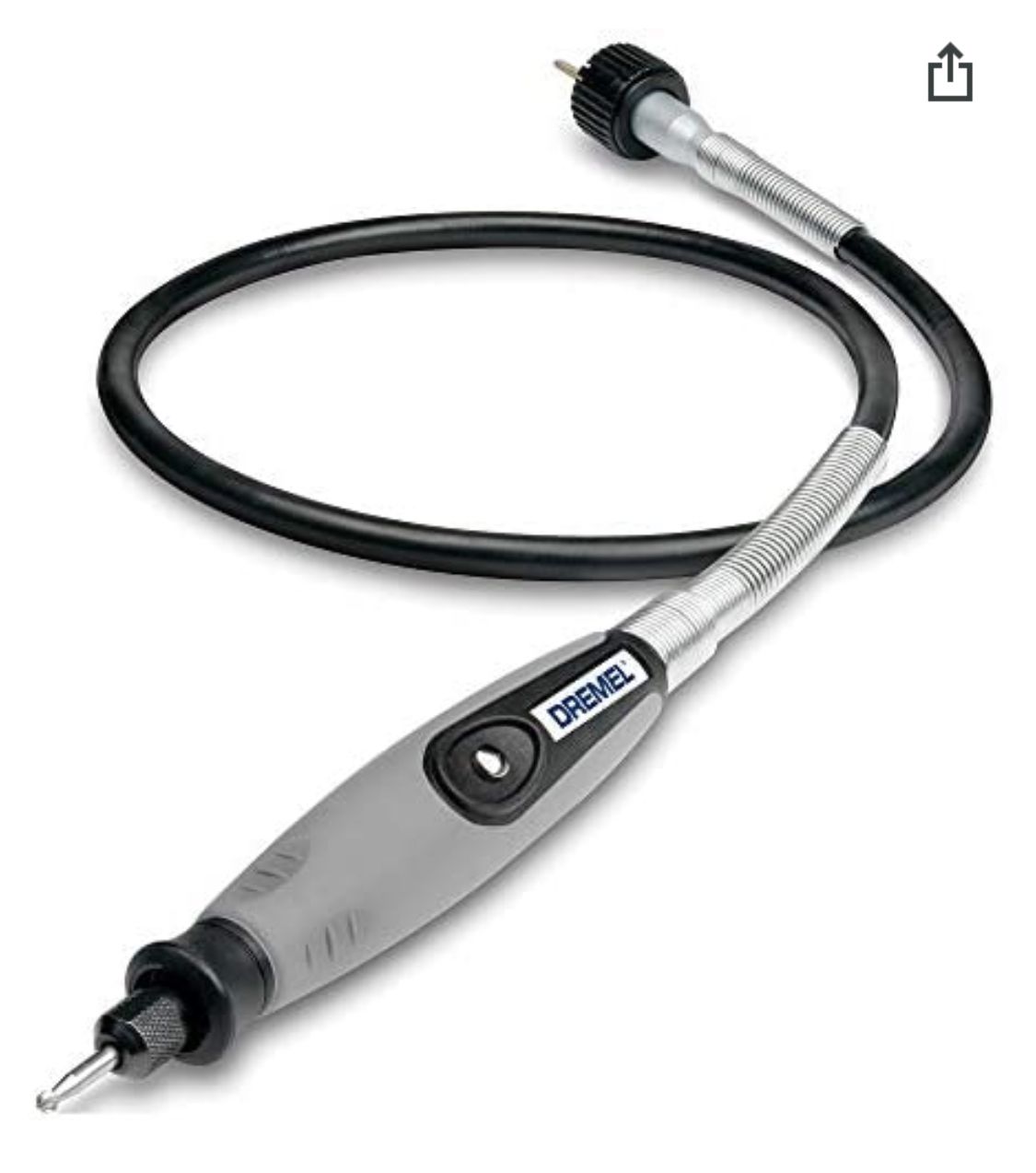

That 3 inch wheel will not work..... the OEM shroud opening Is 2 1/2 .... I use the small sanding drums for the dremel attached to the dremel flex shaft

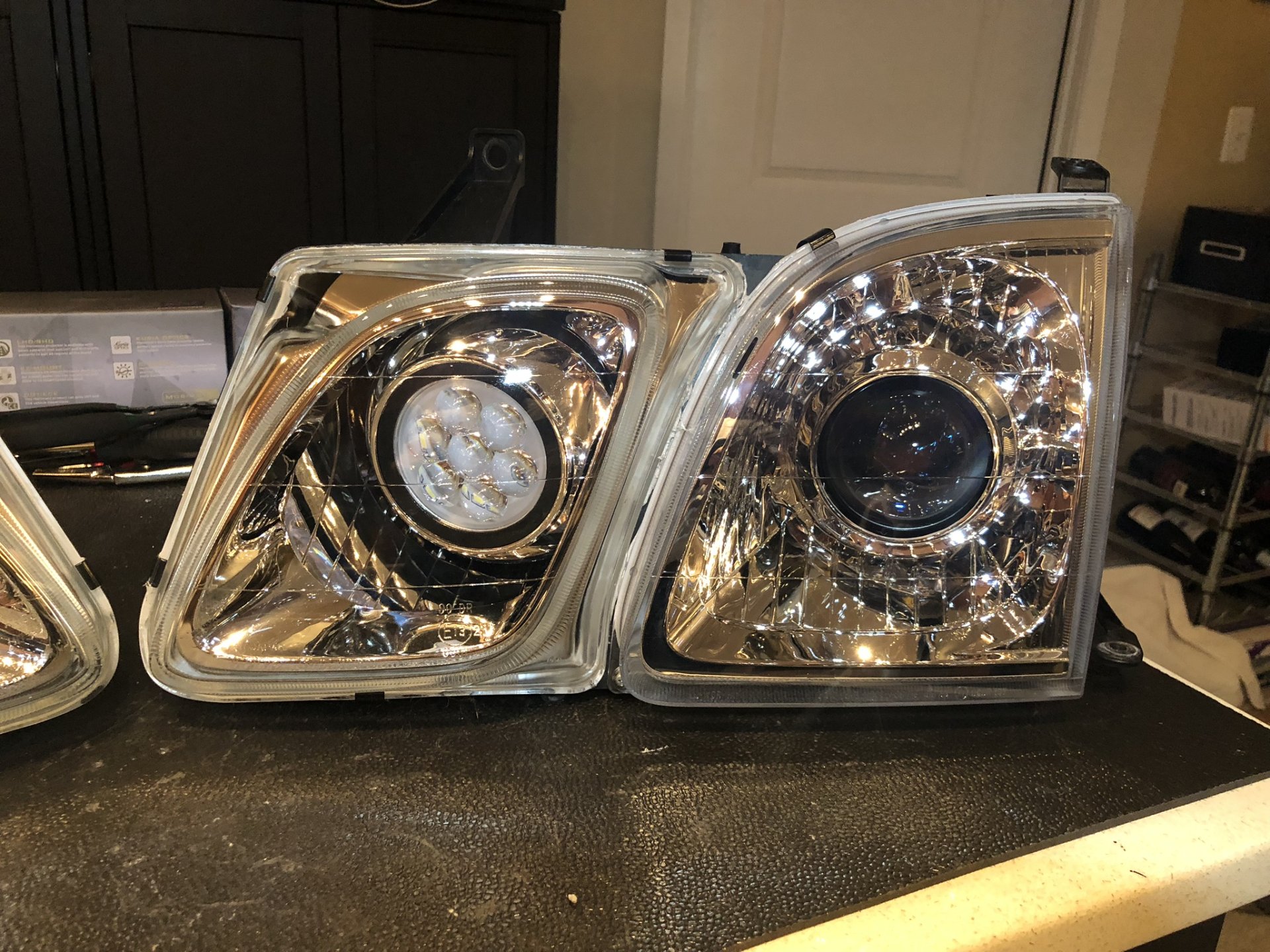

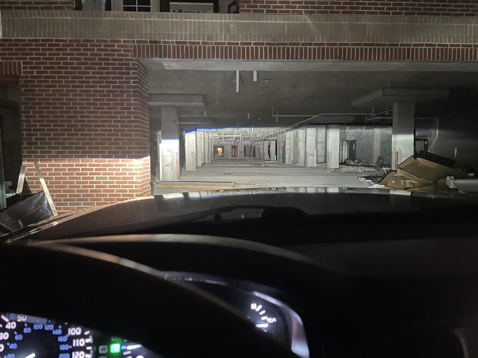

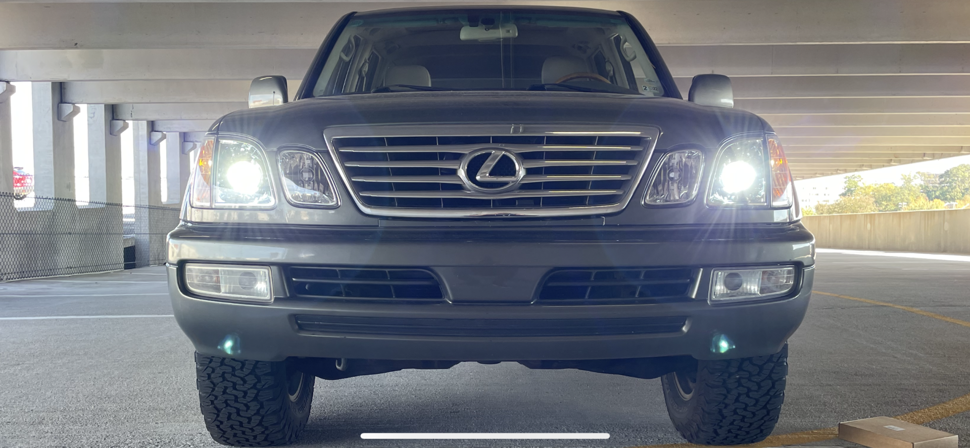

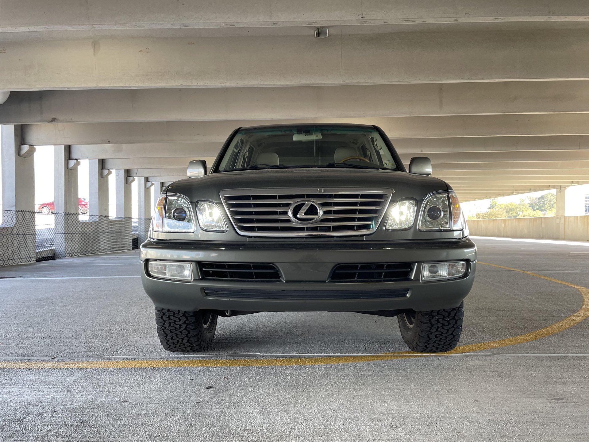

Hi everyone,
I want to provide my input as I recently purchased these lights and have had an amazing experience thus far. First off, I live near Lou. I mention it because he went above and beyond! Thank you Lou for taking the time out of your day to help install these lights, I'm grateful as you didn’t have to. I had fun and it was great to meet you. Now on to the review. It is truly a night and day difference from the stock headlights. Mine were quite worn already and even with brand new bulbs, it was hard to see at night and even worse, when driving in the rain. I can see maybe a quarter mile ahead of me now. There is a clear cutoff of the beams, nice dispersion of light, and they are beautiful. I also want to point out the look of the lights also makes the truck look modern. The high beams are bright and crisp, so you won’t miss a thing when they are activated. I’ve posted pics so you can see the finished product for yourselves. I have no complaints about the lights or output. They are perfect! If anyone is on the fence about purchasing a set, you won’t be disappointed. You use your lights every day, and this is absolutely worth the investment!
Thanks Lou! Nice Truck by the way! :)

Hi everyone,
Springfield town center parking garage?

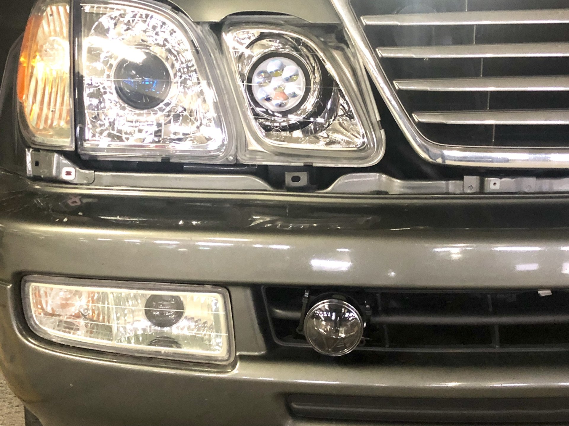

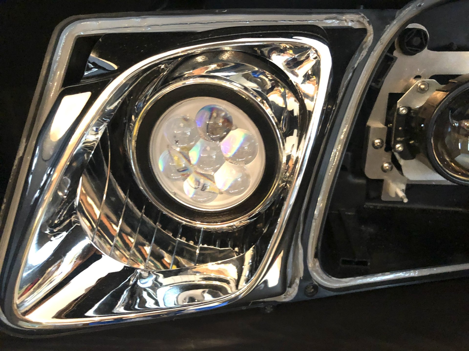

There’s not much information because I can’t recommend the quad setup. I built 4 sets and 3 ending up discounting the inside projector. Way to much light on the road and a total PITA. If you elect to go that route you’re on your own. Don’t mean to be harsh but if you F-up your HB reflectors I don’t want my name connected.
If you like the quad look install the LED HB Projector using the threaded shaft.. easy to install no cutoff to level and excepts a shroud.

Trimming the back of the reflector bowl is key. It’s necessary to attach the nut on the threaded shaft and has to have a slight angle which will reduce the adjustment needed to match the cutoff and step down of the outside projector. If you’re experienced at the nut and bolt technique which I tried and was not very successful
you could eliminate the need to trim the back. As for custom fog lights using the H1 projector, it will not fit in the housing, it’s to big. Check out Diode Dynamic’s SSC2 PODs …. I’m sure you could make them fit and they come in a wide range of beam patterns.
I was very much like you when I started building LX lights but at the end of the day a single projector puts out more light down the road than any modern car today. If you add a LED projector or bulb in the HB location ( I have a kit for that application) you will have more output then you need.
I currently run a single projector and a LED HB and I have 4 SSC2 Pods I’m looking to install just inside of the fog lights in the bumper. Keep in mind running Multiple HID applications requires harness and ballast installations for each application.

Is it worth it for the HB LED? My plans for the HB cavity didn't work out, so I'm either going to do quads with all the parts I have, or go with the LED HB above. Not really keen on spending another 150nif I have the projectors for quads. I could always pull the cutoff out of the projectors and just run them as high beams. Still requires a ton of work. I should add I have a spare set of HB reflectors.
Ideas? I appreciate the help! Rest of the retrofit is going great, brackets worked a treat. I'm waiting for paint to dry now before everything gets reassembled.
Yes it’s worth it …. simple easy solution. Your idea of pulling the cutoff and firing as high beam only doesn’t make sense…. Remember HID’s take 20-40 seconds to reach max output… the LED is instant on and requires no ballast or harness
