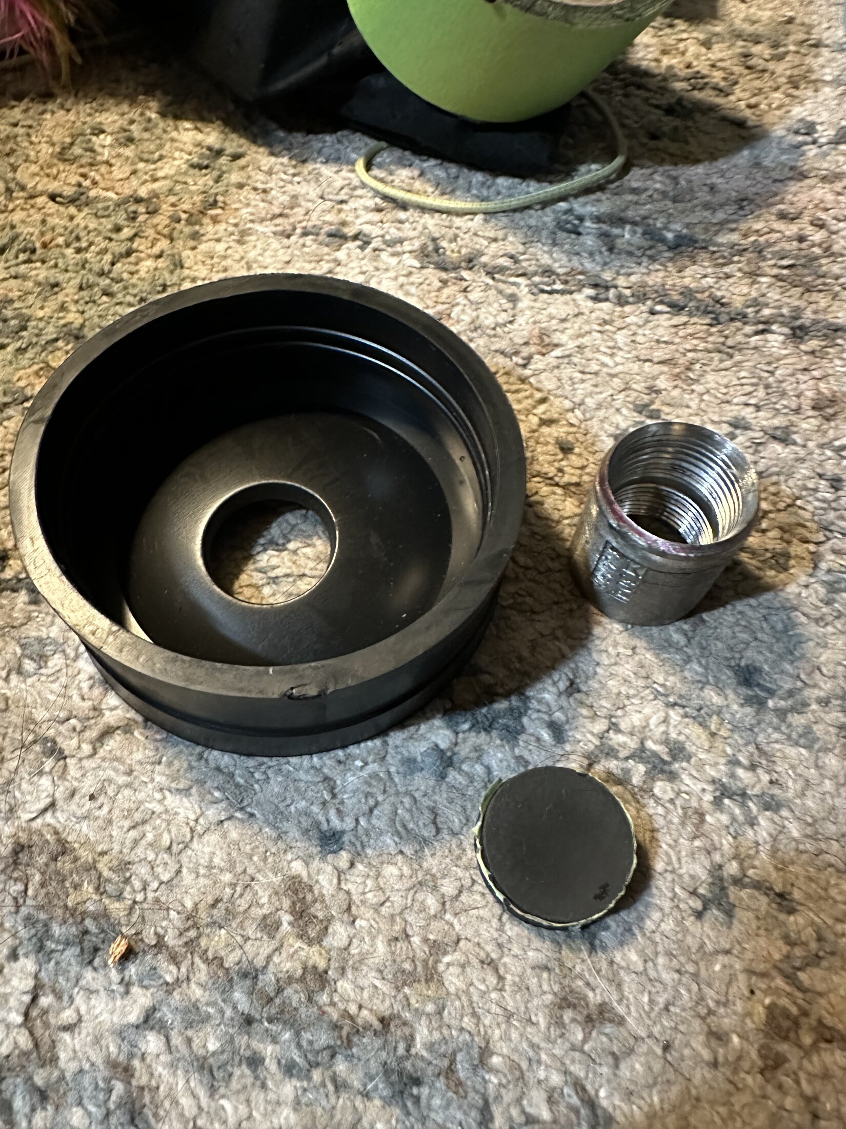

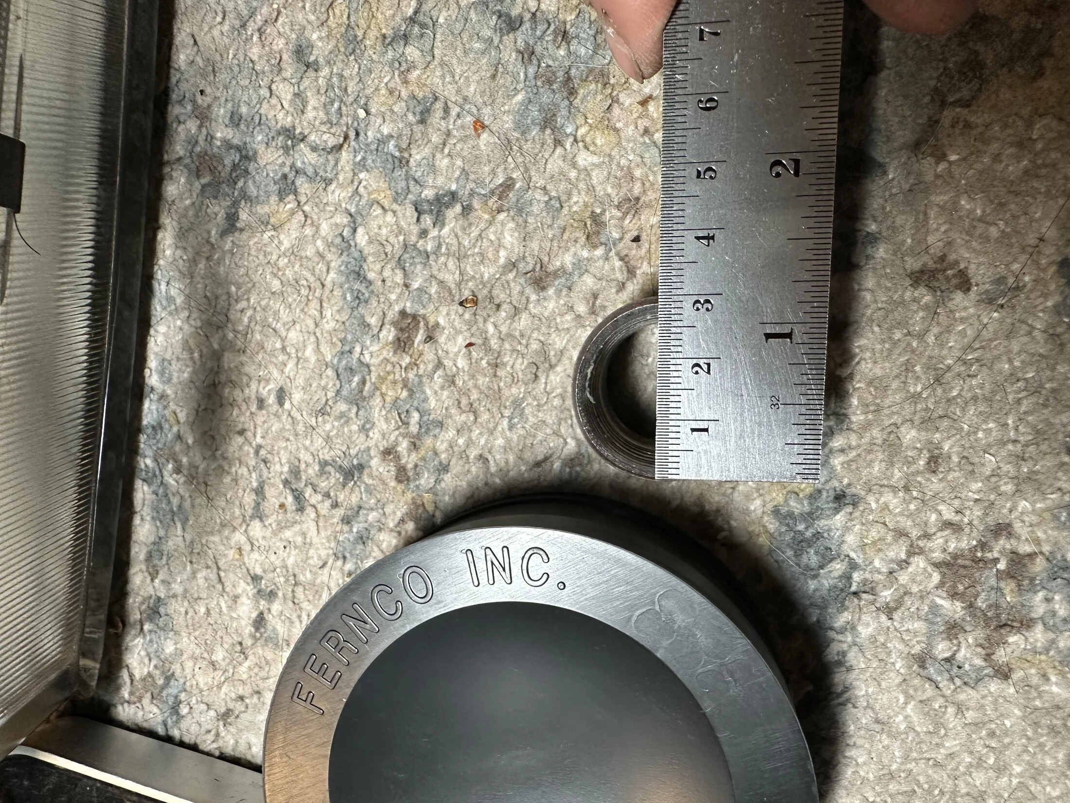

In case anyone has issues sealing the housing with the new projectors. I used e39 ballast and a 3inch pipe cap from Home Depot. Pressed out a hole with a homemade tool and voila no more headlight fluid.
Oh and don’t forget to aim your lights first before cutting out the holes. Ask me how I know..

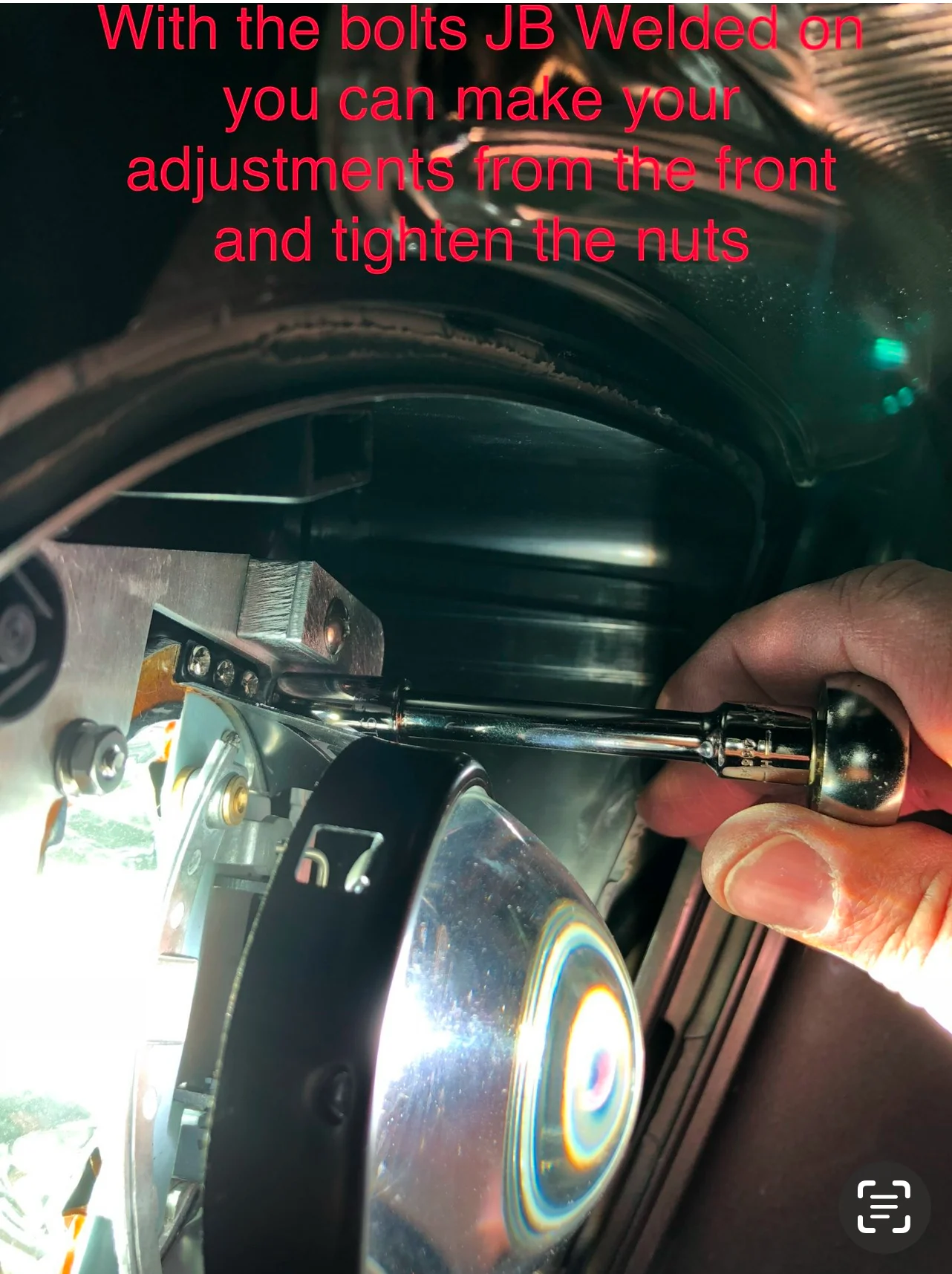

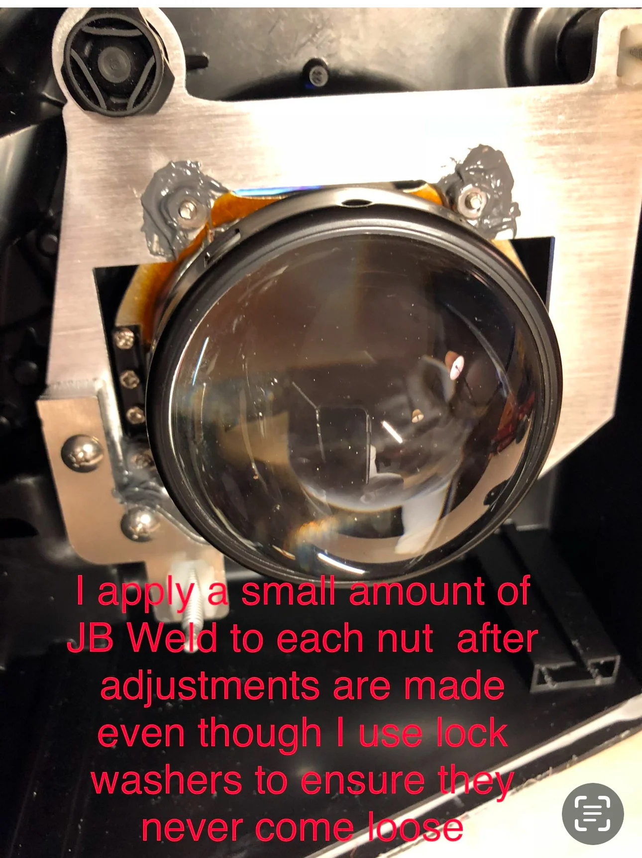

That cap works well, I've used that same cap. You should have use JB Weld on the bolt heads prior to installing, which will allow you to tighten the nuts from the front when making your adjustments and leveling the cut off. After adjusting, remove the headlights and seal them up . Small observation.
This is the brilliant kind of fix that I'd only think of after doing it the hard way once or twice.

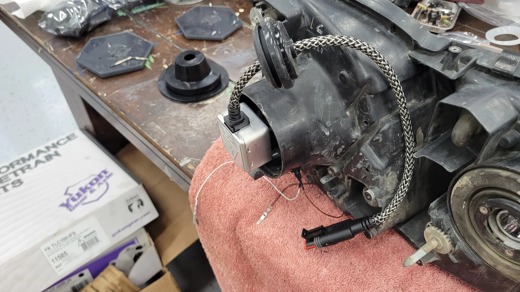

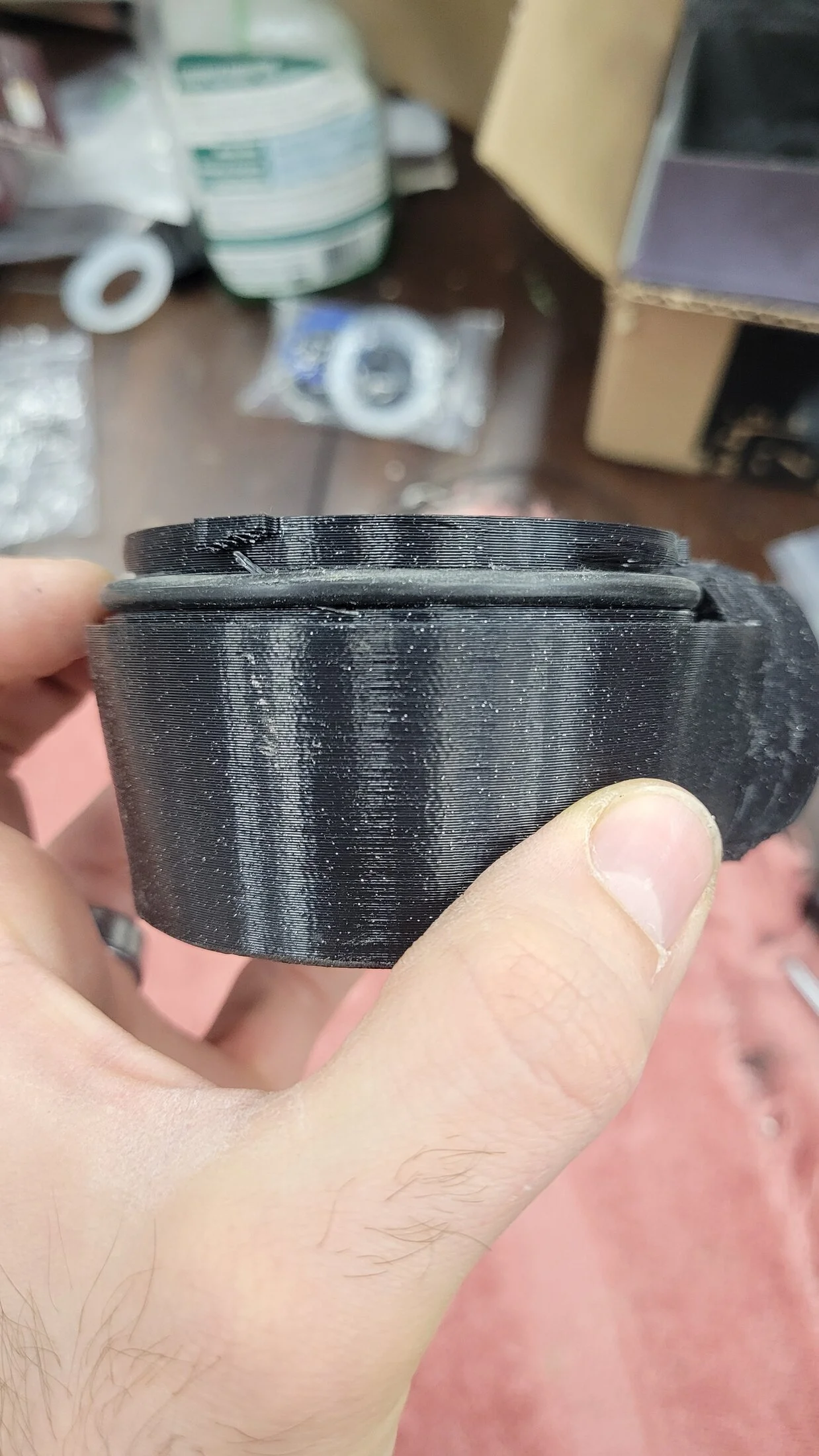

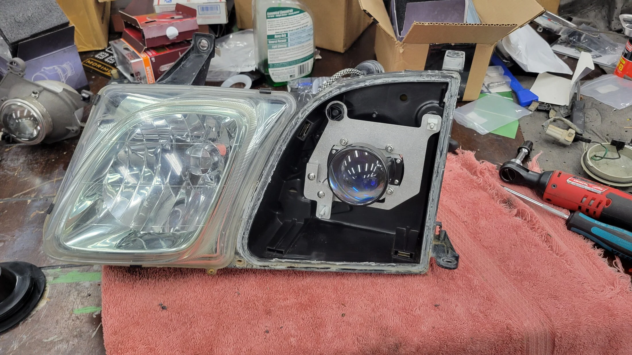

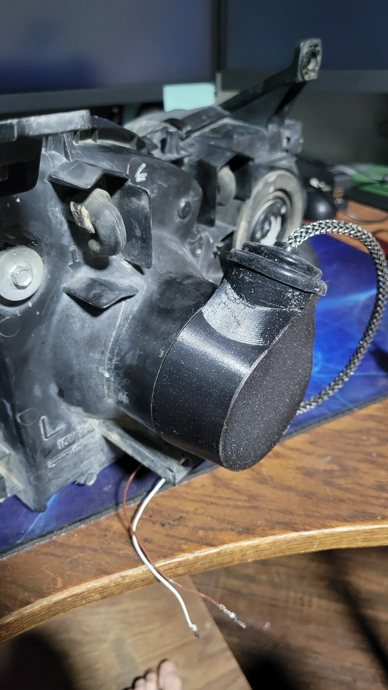

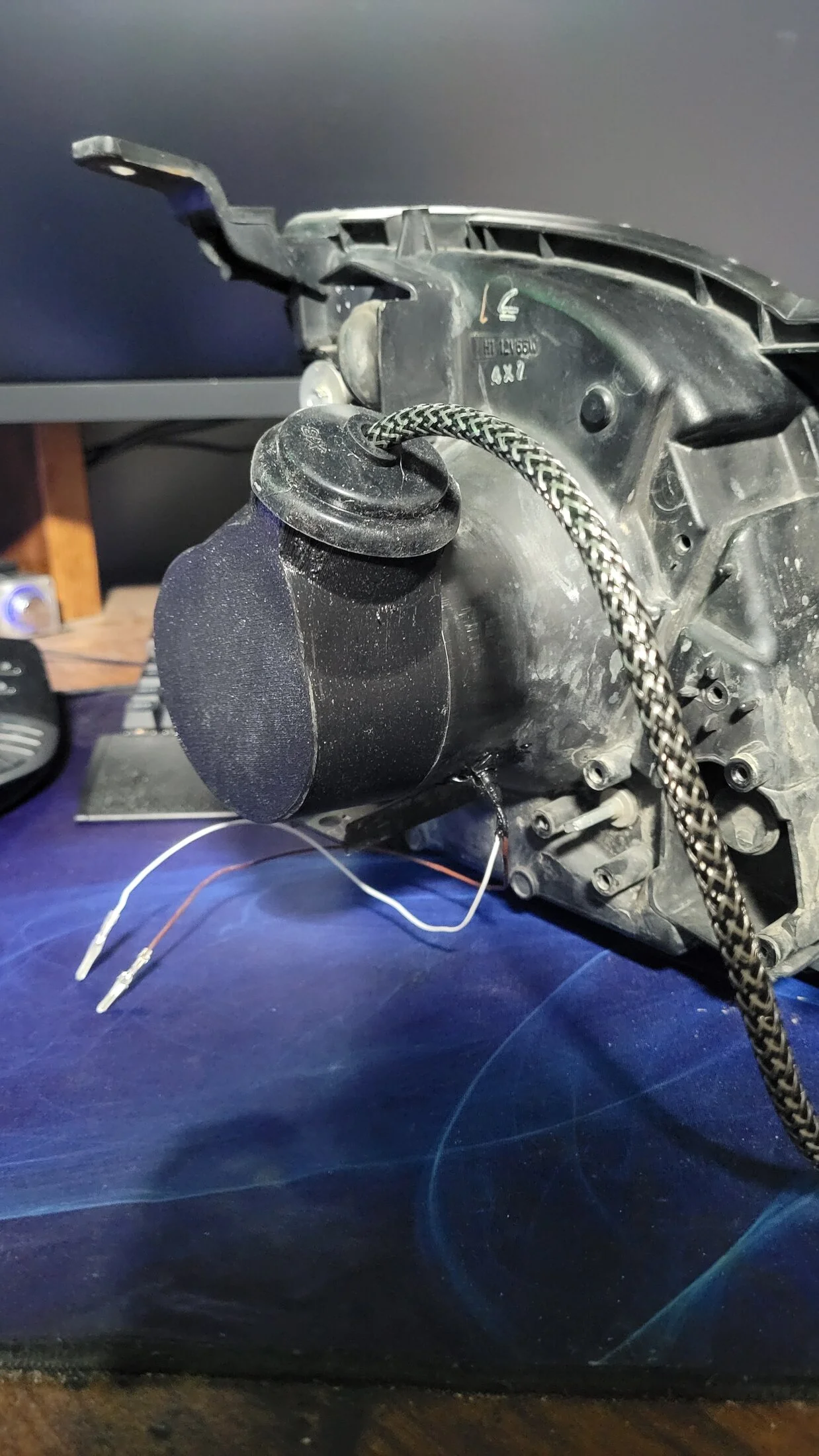

Working through a MicroD2S install right now - the Morimoto XB35 igniter hangs out the back by about an inch. In order to retain a water proof/resistant housing, I designed and 3D printed some custom tail caps out of ABS. These twist-lock and use the factory o-ring, and are designed to work perfectly with the grommet that comes on the XB35 wiring. Super happy with how they came out!
