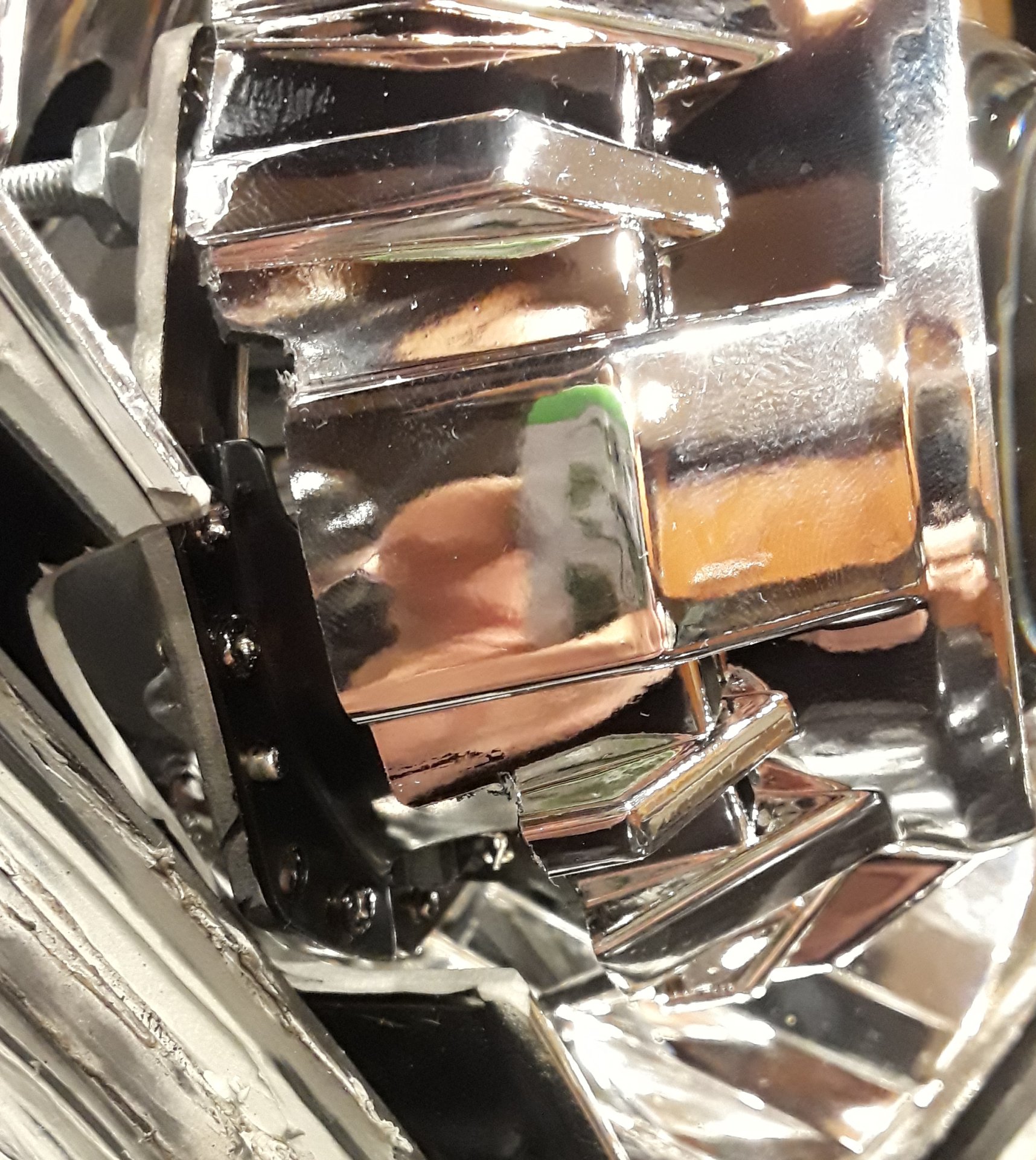

...my upcoming quad d2s 5.0 retrofit using luke111's d2s brackets. the high beam bowl, oem shrouds, and new retrofit shrouds require modification with quad 5.0 projectors. the brackets are a time saver! my lx is on jack stands while i work on it- it's delaying my retrofit. everything is still loosely in place since i'm unable to verify level prior to jb welding the projectors in place while my lx is on stands. only 3 bolts are possible with the nut and bolt method due to the 5.0's fitment in the high beam bowl. i used 8/32" nuts/bolts here. these pics were taken during the fitting stage...nothing is finalized, polished, aimed, sealed, at this point. i relieved the inside of the new shrouds to ease fitment and allow room for some jb. i don't trust the snap on "feature." i expect i will wire the second set of projectors to an auxillary switch. -fewer headaches around town.
it's been my experience that the added weight of a projector into a reflector bowl can introduce vibration which is noticeable with the sharpness of the cutoff. you can minimize this by running in externally adjustable bolts through the housing itself to make contact with the back of the reflector bowl (from two points- bottom and backside). the much softer butyl rubber rolls used for sound deadening can also help deal with vibration, but you need your aim needs to be near final before putting this to use- it can limit your range of adjustment depending on how you use it- the sound deadening butyl. i mention this, as i did quads in a 04 4th gen 4r...the high/low reflectors were one unit...without these steps, the slightest bump in the road would introduce a vibration in the cutoff- drove me nuts. with these modifications, i'd only see vibration with gnarly potholes and ruts. i haven't retrofitted an lx previously, so i can't say if this is a concern on this vehicle. but i'll likely take steps to mitigate any problems while i have the lights unsealed.

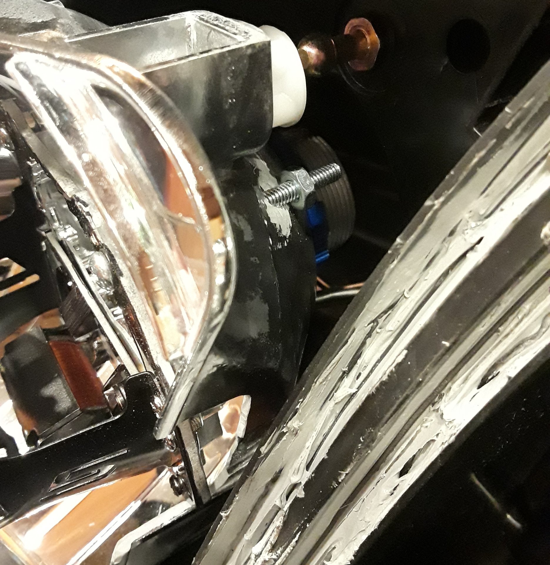

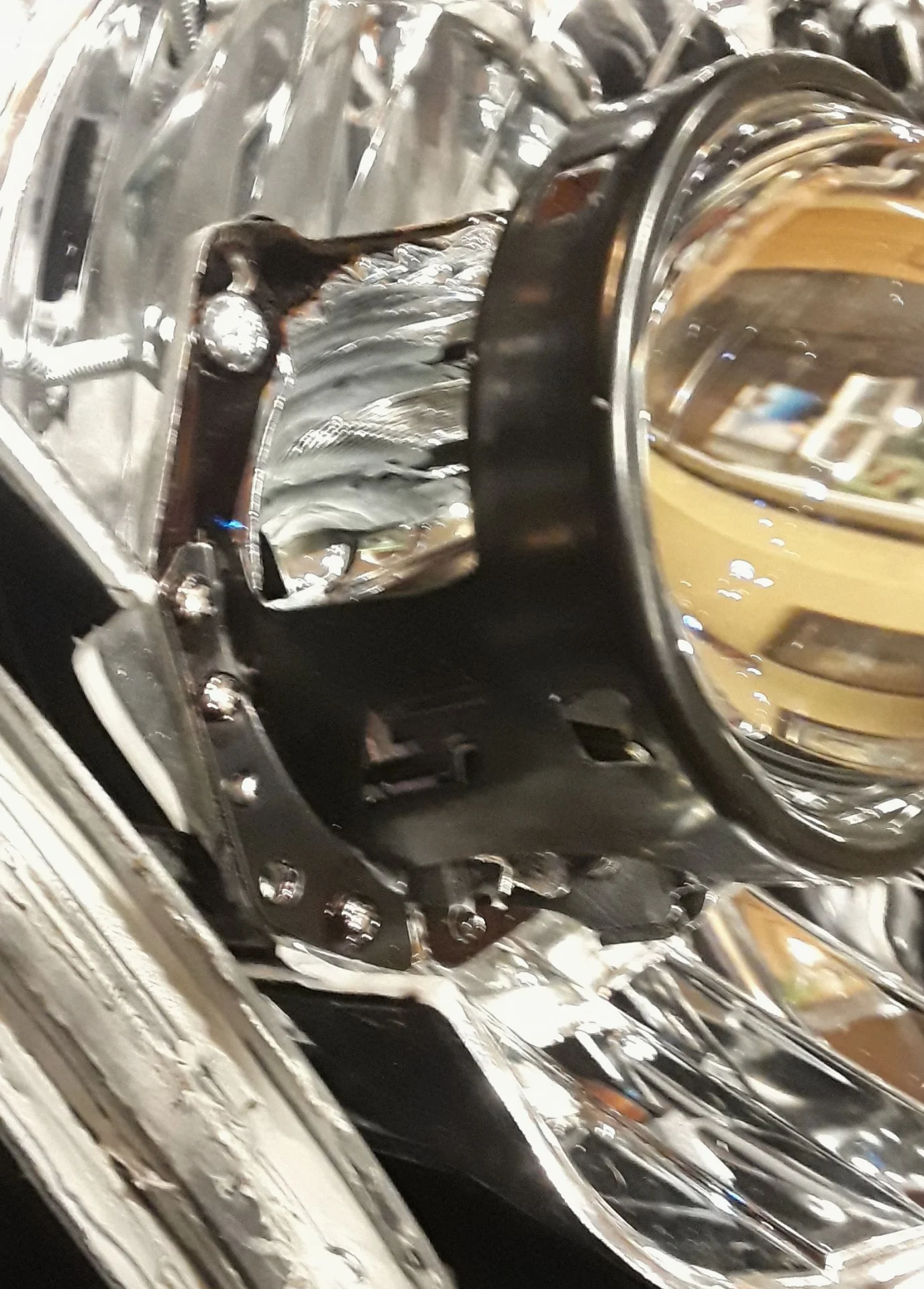

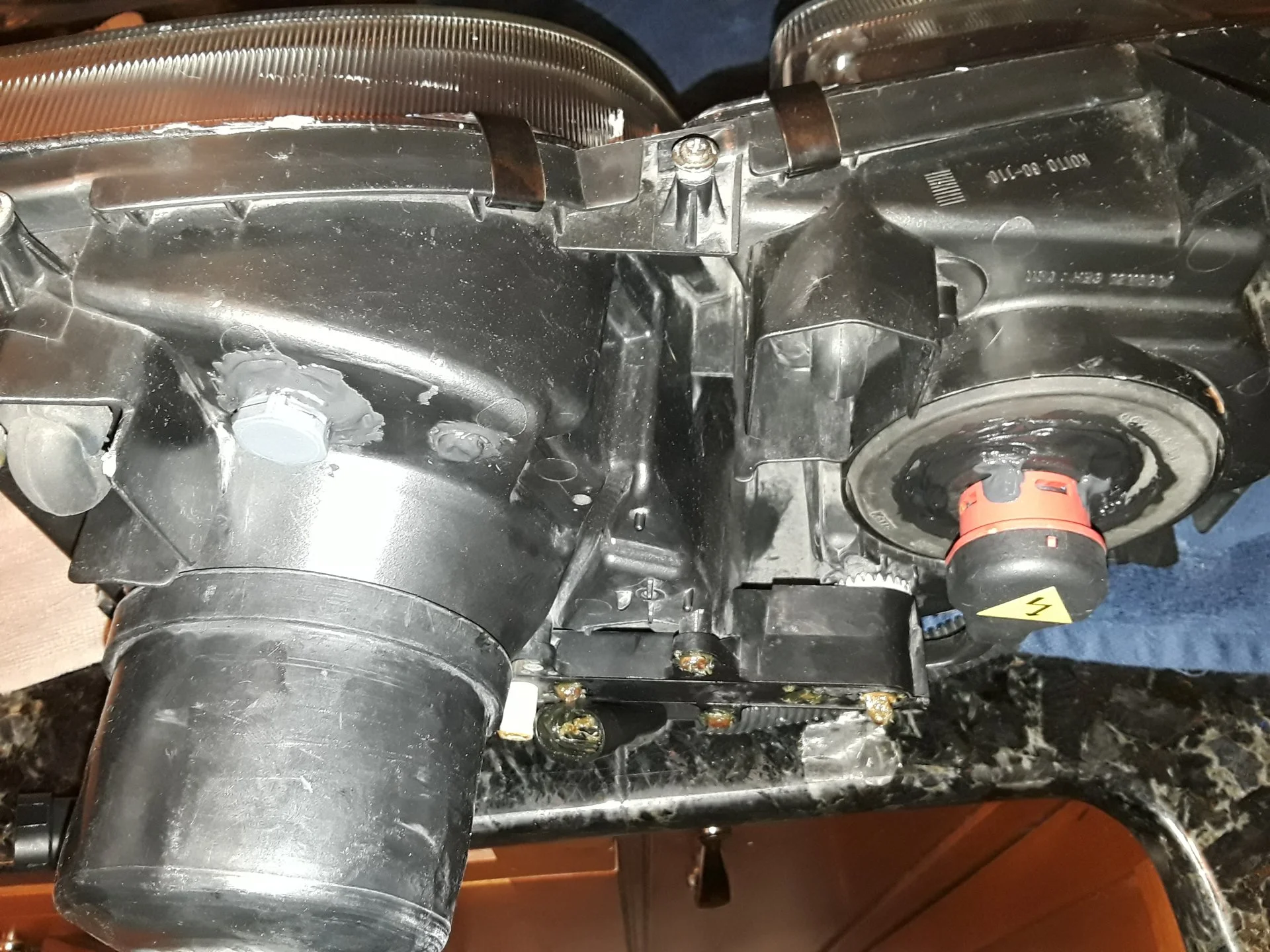

Very nice job getting that D2S stuffed into the High beam location. I’m curious about the back of the high-beam location ..is the threaded shaft sticking out from the housing.
If it is sticking out from the rear of the housing make sure you test fit with whatever cap and igniter you decide to use because the AC lines on the passenger side run right behind that projector. You’ll be somewhat limited to your choice of cap because there’s really no lip for a cap to attach to. Again very nice work.
this is a concern. it's too early to say. i haven't snapped the ball into the socket yet and threaded the adjusters in very far. i think i can keep it so the bulb holder is the only portion extending beyond the housing. if i get creative i can move it foreward to stay inside the housing. i cut the reflector bowl tight to the tail of the projector so i can use a spare blue mounting ring as a stop to experiment with positioning fore and aft- with a second ring on the backside holding the projector. if all else fails, i have a pair of micro d2s projectors on standby. my initial plan was to use the micro's since i know from your work, the mini 8's fit.

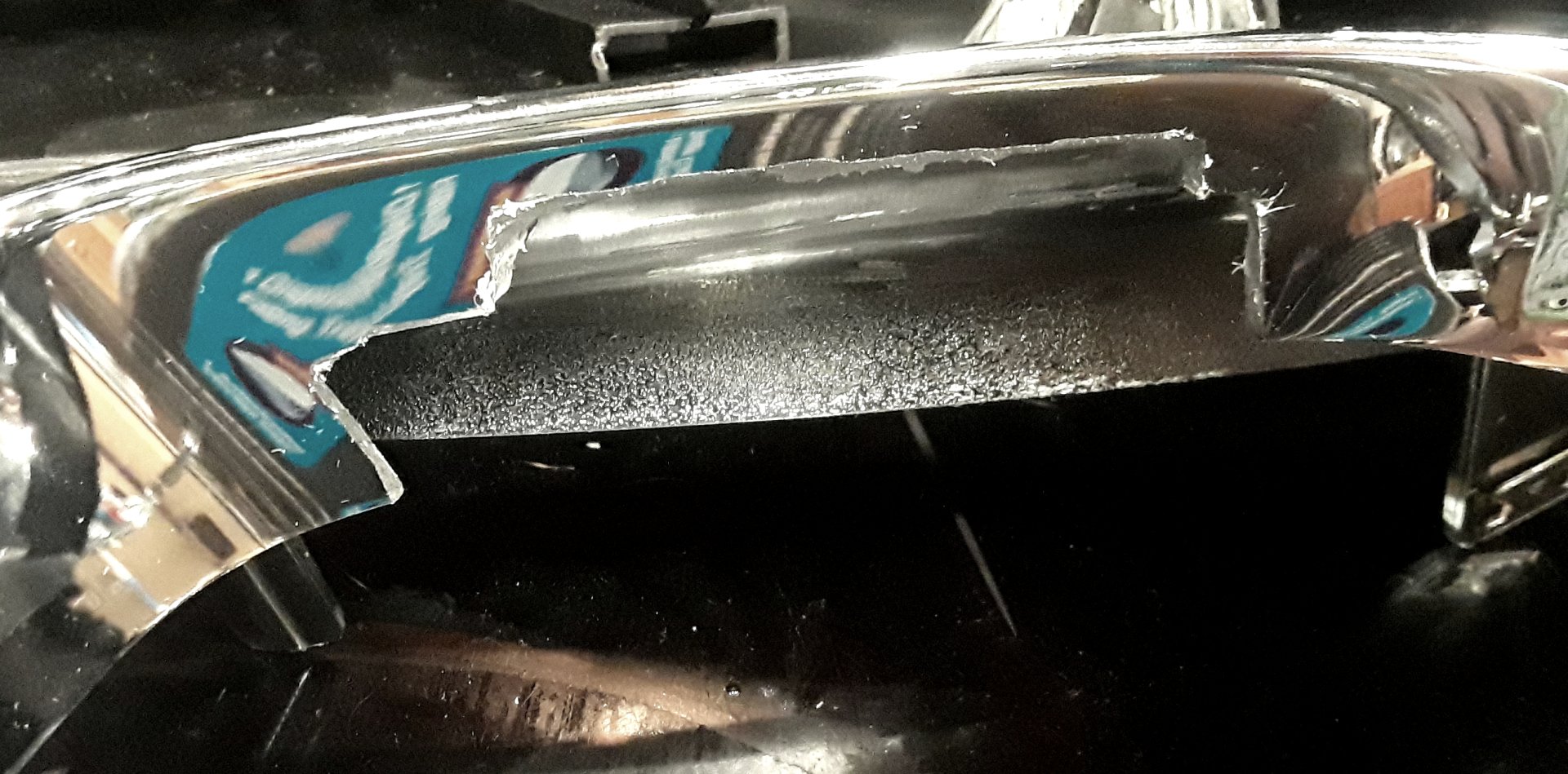

Looking closer at your picture I did notice how much of the reflector bowl you cut out just to get the projector and shroud to fit so my next concern can you even put the chrome frame that covers the edges of the reflector bowl back on and is the projector, shroud or frame touching the glass/ polycarbonate lens? Besides everything fitting under the lens and figuring out the rear cap, igniter and A/C clearance dealing with trying to get things level with matching cutoffs and step downs you are about to understand why I no longer have any interest in the quad setup. The gain in usable output is just not worth it.
Personally I would work with what fits and what fits is still a difficult process. As for soldering wires directly to the bulbs I have no idea.
the projector won't make contact with the lens and i will be able to utilize the oem shroud to the reflector bowl. that's not an issue. the concern is clearance to the a/c lines like you've mentioned, but i believe it can be done. as to pairing the projectors, once i've confirmed level, the paring will go very quickly. i don't often have the opportunity to run for long stretches with the high beams on, so from my perspective messing with led's and getting the daytime running lights running isn't worth it. quads are more useful and worth the effort. the lx is the easiest vehicle on which to install a quad that i've personally encountered. for most people, retrofitting a single pair of projectors is the way to go. and i understand respect your perspective, especially with the projectors currently available.

i had the lights on the vehicle to check clearances. the a/c lines' clearance isn't an issue. it's tighter on the driver's side, but the 5.0's will fit with my setup. by tight, i expect an 1/8 or 1/4 inch clearance between the lines and igniters i tested. the lines on the driver's side can be scooted over a bit if needed. or the projector can be mounted 1/4" forward. i don't expect to move the projector forward. either way, this will work. the washer fluid reservoir filler tube isn't an issue. this is my fourth quad retrofit, so i knew what to expect going in and i no longer sweat the aiming process. when it's finished i'll post the results in a new thread as you suggested.

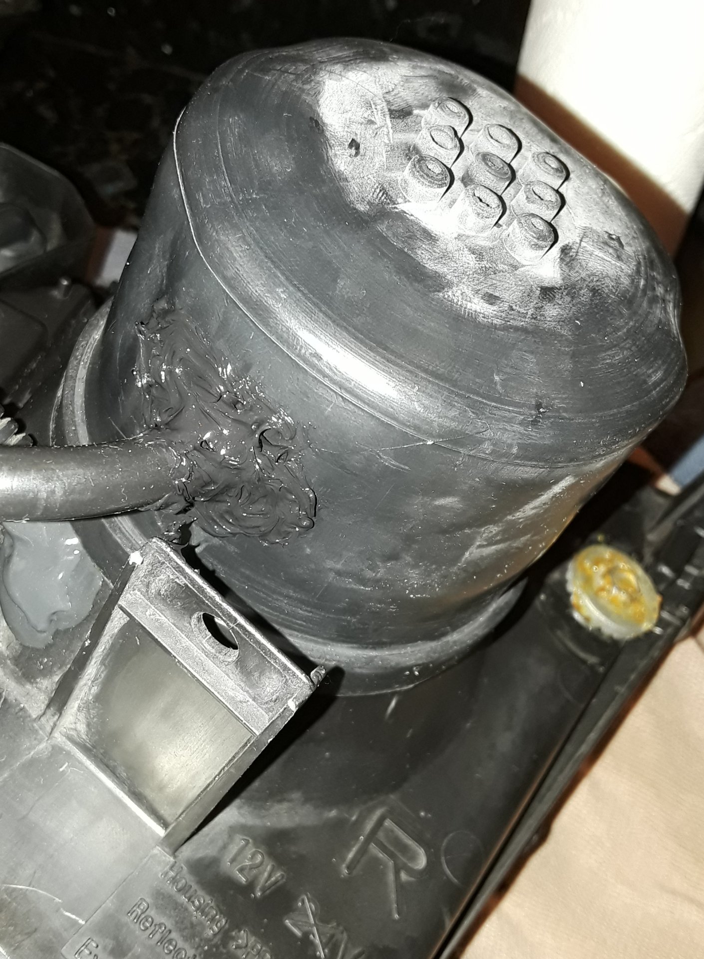

Just finished my setup, micro d2s does fit, rotation adjustment of the projector is tight. But it all works, need to find a different dust cap though that's open back. Will post output shots tonight.

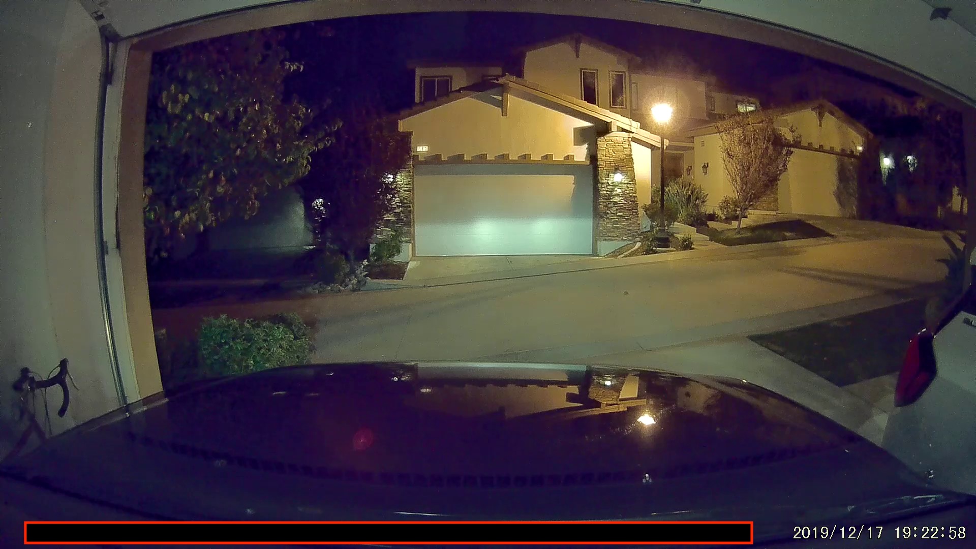

First shot it the old Mini H1 4.0
Second and third is a low and high beam shot of the Mini 7.0 the new Mini 8.0 is even better.
Fourth and fifth is a low and high beam shot of the D2S 5.0

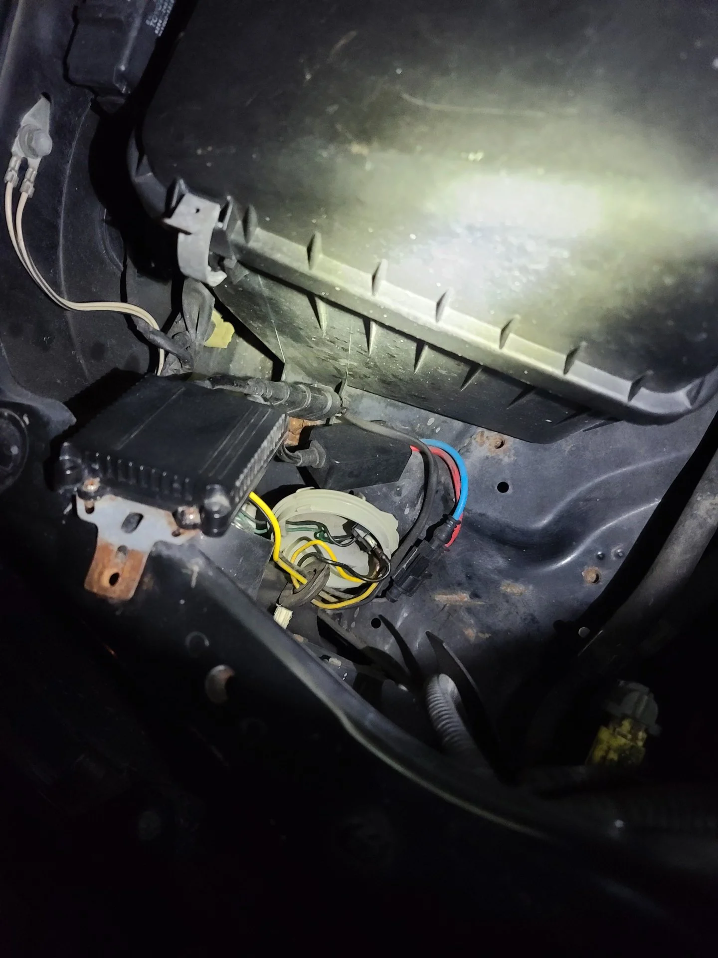

My confusion comes into what I need to do/buy. My car seems to have HIDs and a ballast which I'll share pictures of. Granted I can find no info on the part so they are getting tossed and replaced.
Based on the photos do I need to rewire anything or this going to be just plug and play because previous owner already went down the HID route.

Not knowing what the current setup is I would replace everything.. the Mini H1 kit will come with new ballast, bulbs and harness.

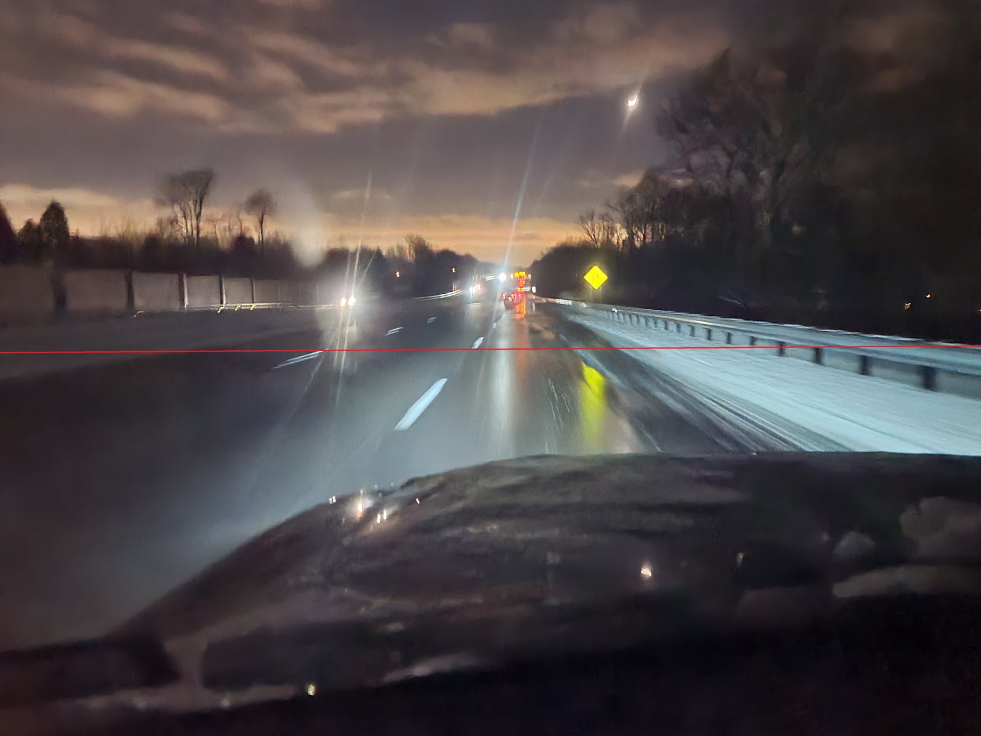

Without high beams:
With high beams:

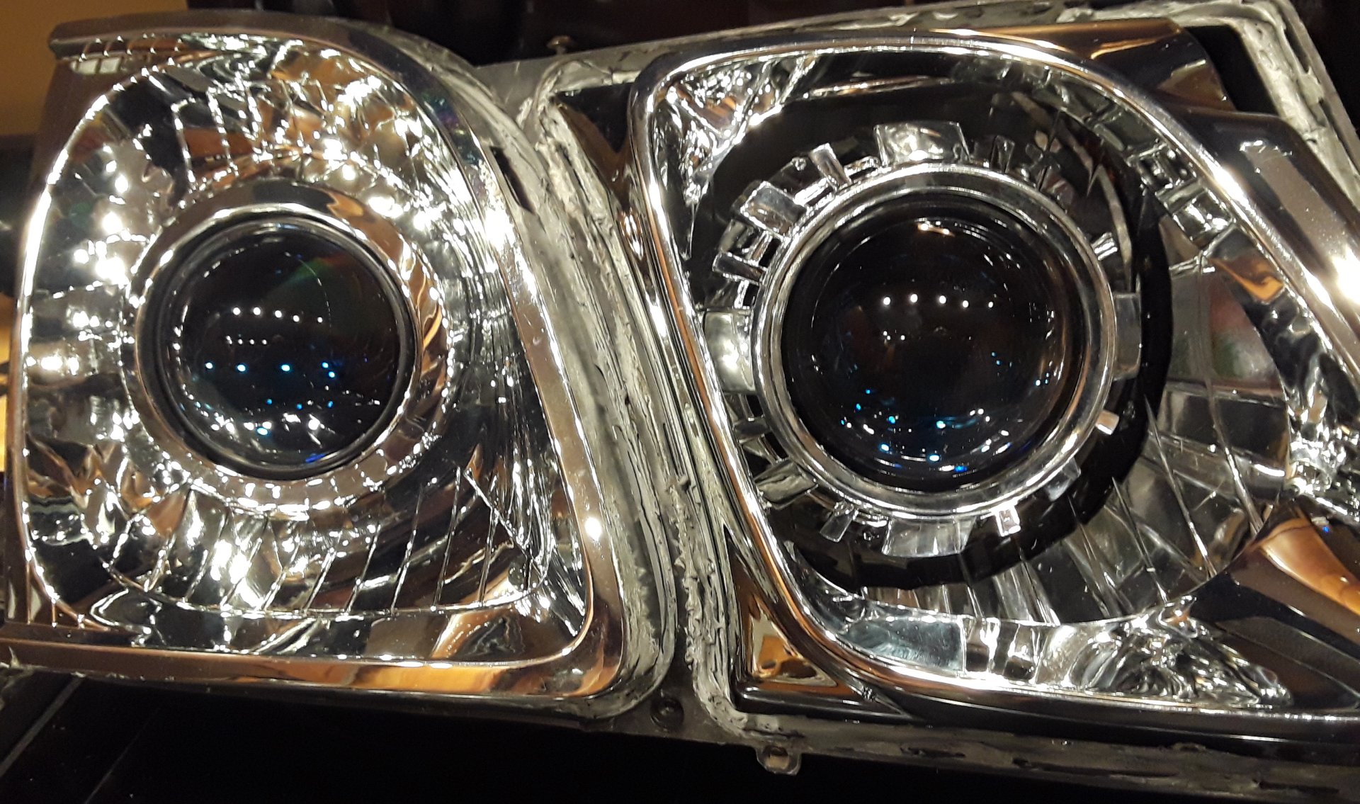

quad d2s 5.0 sealed up and on the lx. no output shots yet...need to confirm the source of a p0240 code- hopefully just an o2 sensor. yes, they're level. haven't gotten to the fogs yet. i used meguire's cleaner wax to buff out the hazing that was present in the corner of my low beam lenses. i blacked out everything facing forward on the projectors with a black industrial sharpie. one large zip tie is required to nudge the two lines over on the driver's side, so there's no risk of contact with the igniter. a/c lines weren't an issue for me. clearance between the projector lens and the lx's high beam lens is indeed tight. if i had to guess, there might be 5 to 7 mm of clearance. so you need to have the projector set all the way back to the reflector bowl, and do the aiming with the nut and bolt method with the reflector threaded back a minimum of halfway. i used the oem high beam seals with black rtv to seal the gap. i wasn't happy with the positive snap of the 90 degree amp-d2s adapters i had on hand, hence the presense of a few dabs of jb quick. morimoto igniters may be too large for the high beam location- haven't used these for years, so not sure what the current design is like. fyi, i ran quads on a 4th gen 4r using the oem seals wth black rtv like this and did not have any issue with moisture ingress- of course, my 4r didn't require a snorkel. i used no ox i.d. on my electrical connections. i added bolt on vent breathers.
don't use rubbing alcohol to clean the reflector bowls- the high beam reflectors did not take well to it, and it almost got me in trouble. stick with water and a light touch. clean once.
