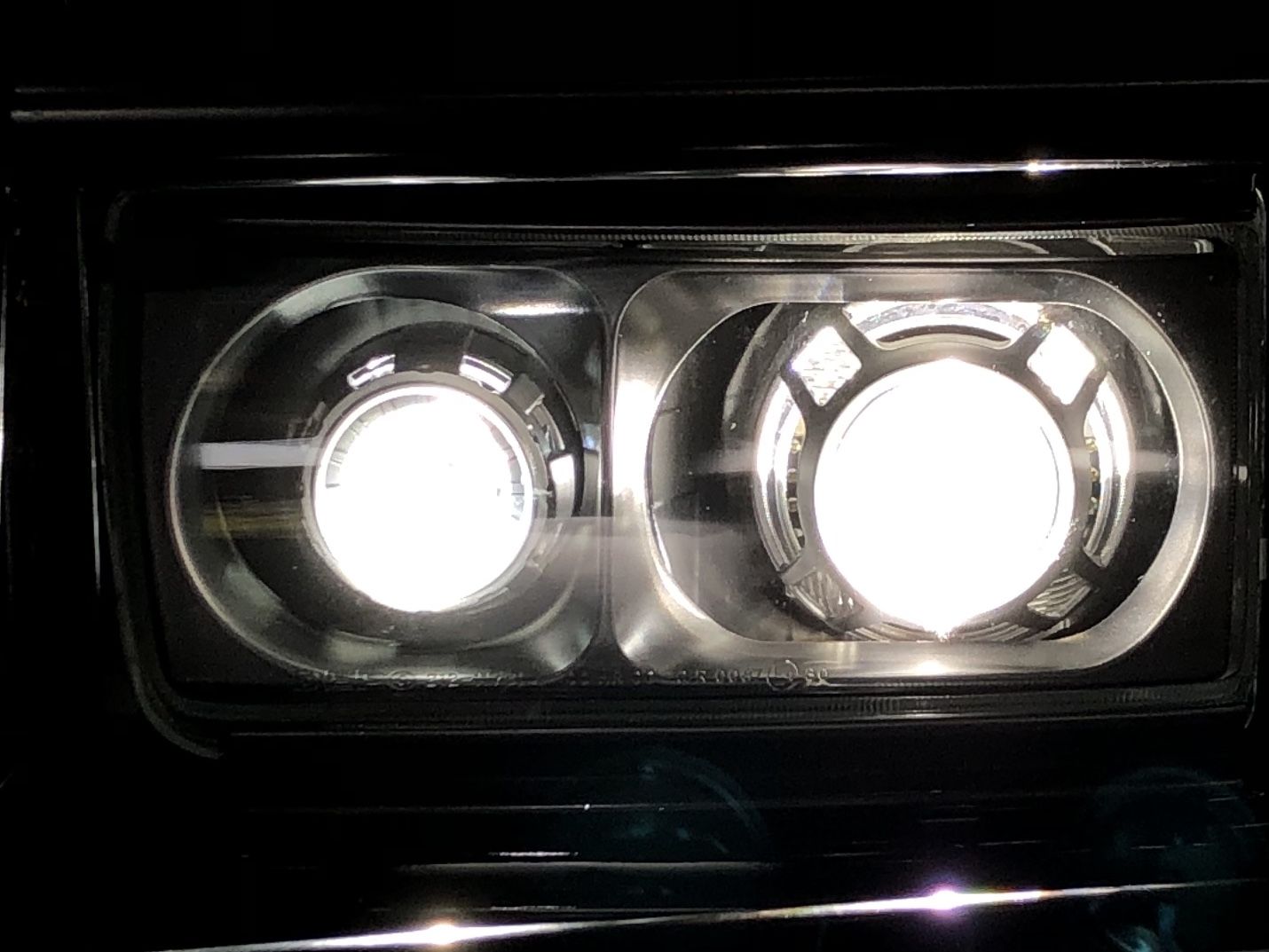

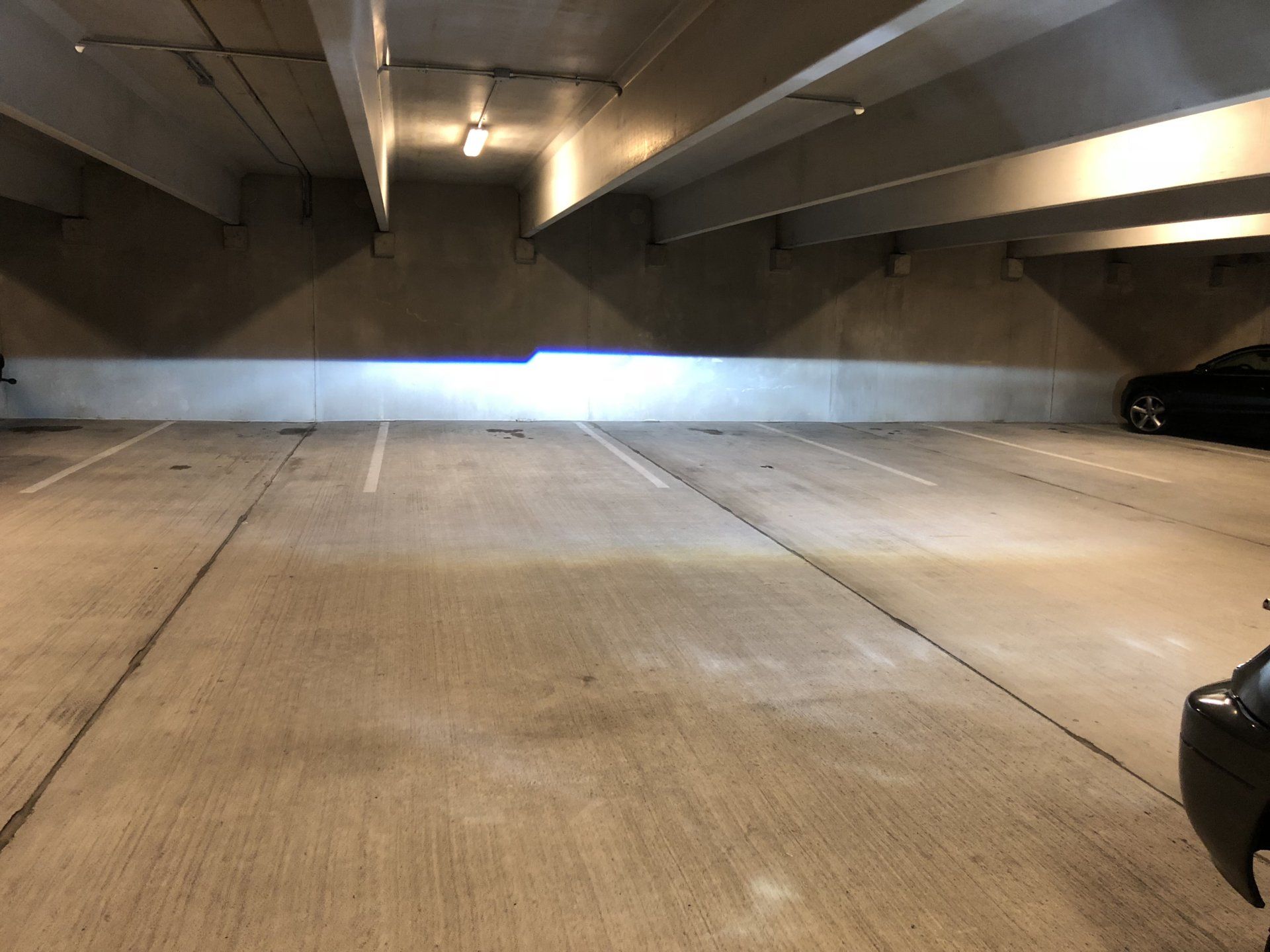

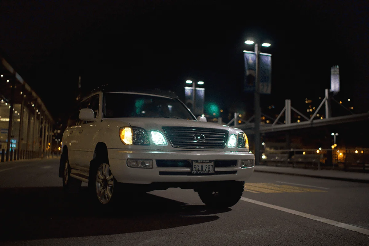

I love the sharp cut-off, and the fact that I can see it even during the day time (so much nicer than the OEM projectors...)
They look great... you need to raise the drivers side or lower the passenger side. You only want one step up then you'll have it perfect
Like the shot below

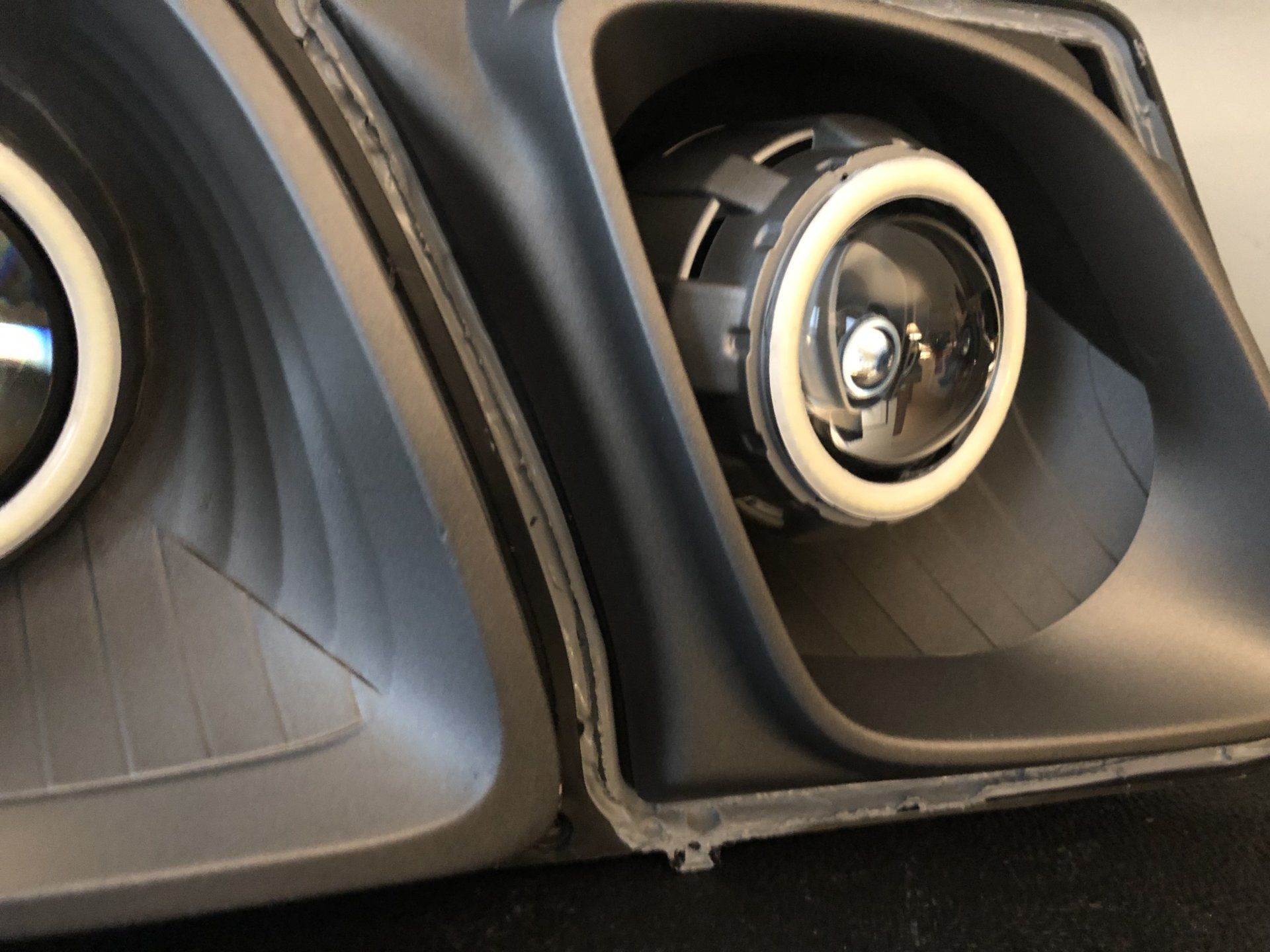

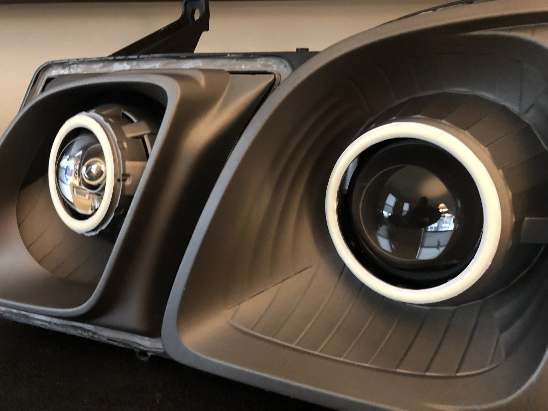

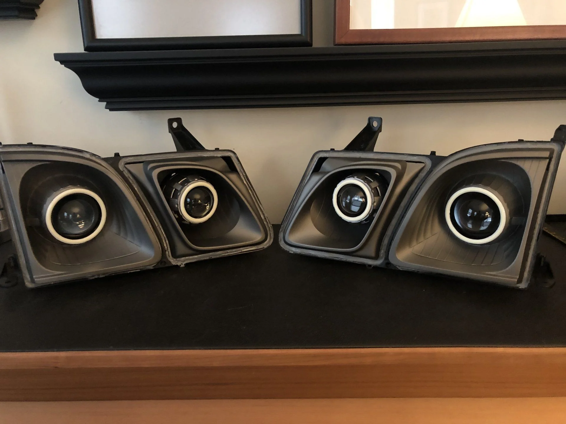

I took these lights out of my truck a few weeks ago. The new OEM housings and projectors were installed Sept of 2017 and some will remember these shrouds I painted. These will be sold with new bulbs, ballast and igniters and the drivers to run the halos. Priced at $1550.00 slightly used... New quad sets run $2250.00
They still need adjusting and I’ll close them up.

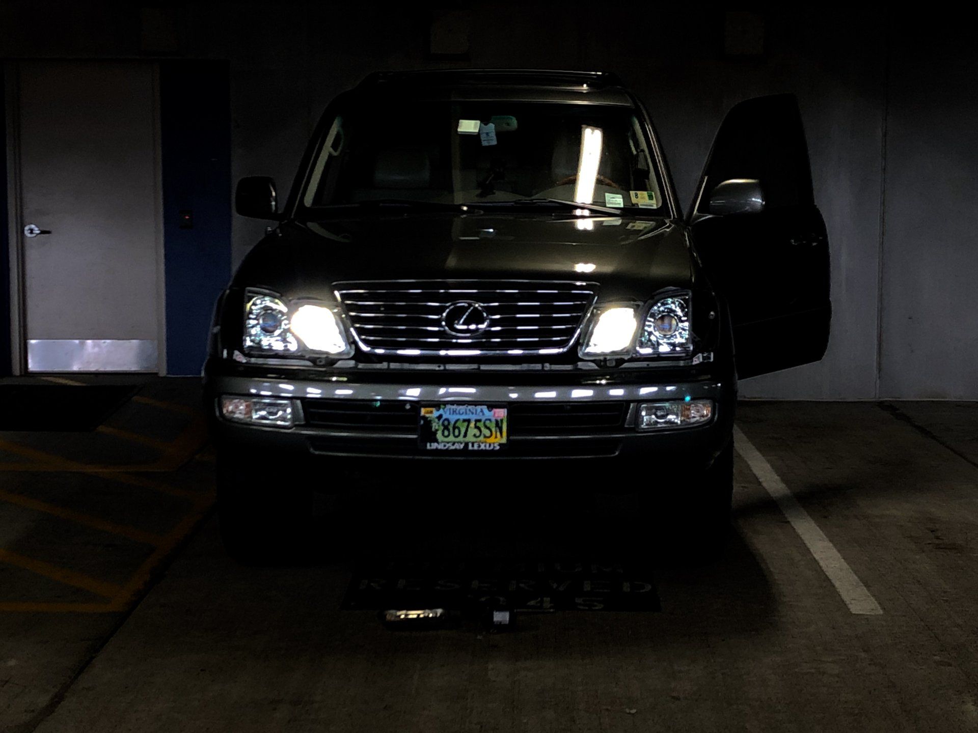

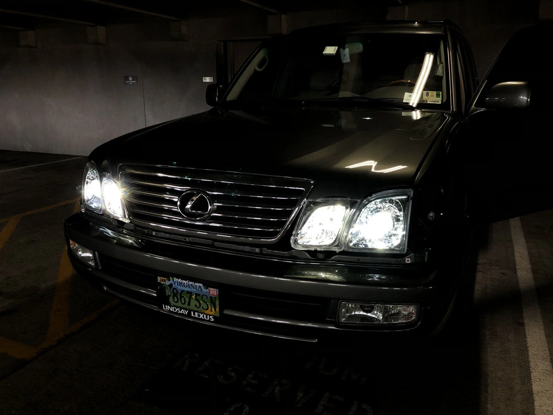

@Luke111 recently built me a set of D2S lights and I just installed them 2 days ago. Could not be happier with the results. As has been documented repeatedly here the output is exponentially better than stock. Installation was much smoother than I thought. To be honest I was intimidated by the wiring aspect because I didn't have a good feel about what I was getting into but once the harness arrived it made more sense. The fact that you only have to splice one set of wires (one positive and one negative) was a huge relief. I don't mess with electrical stuff typically. If you don't want to bake your lights and cut your shroud etc, just have Lou build you some. Super fast turn-around time and he was very responsive to my dumb questions. Thanks Lou!

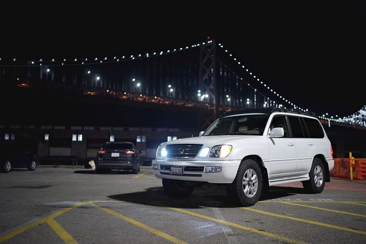

Nate, thanks for the note and to anyone on the fence HID retrofitted lights are game changers for night driving
Coming home last night on the Greenway near Dullas Airport turned out to be the perfect road to display the output of the D2S 5.0 and the addition of the LED Profile Hi-Lens in the high beam location.. I’ve run the D2S since June of 2017 and I’m still shocked by the light output.

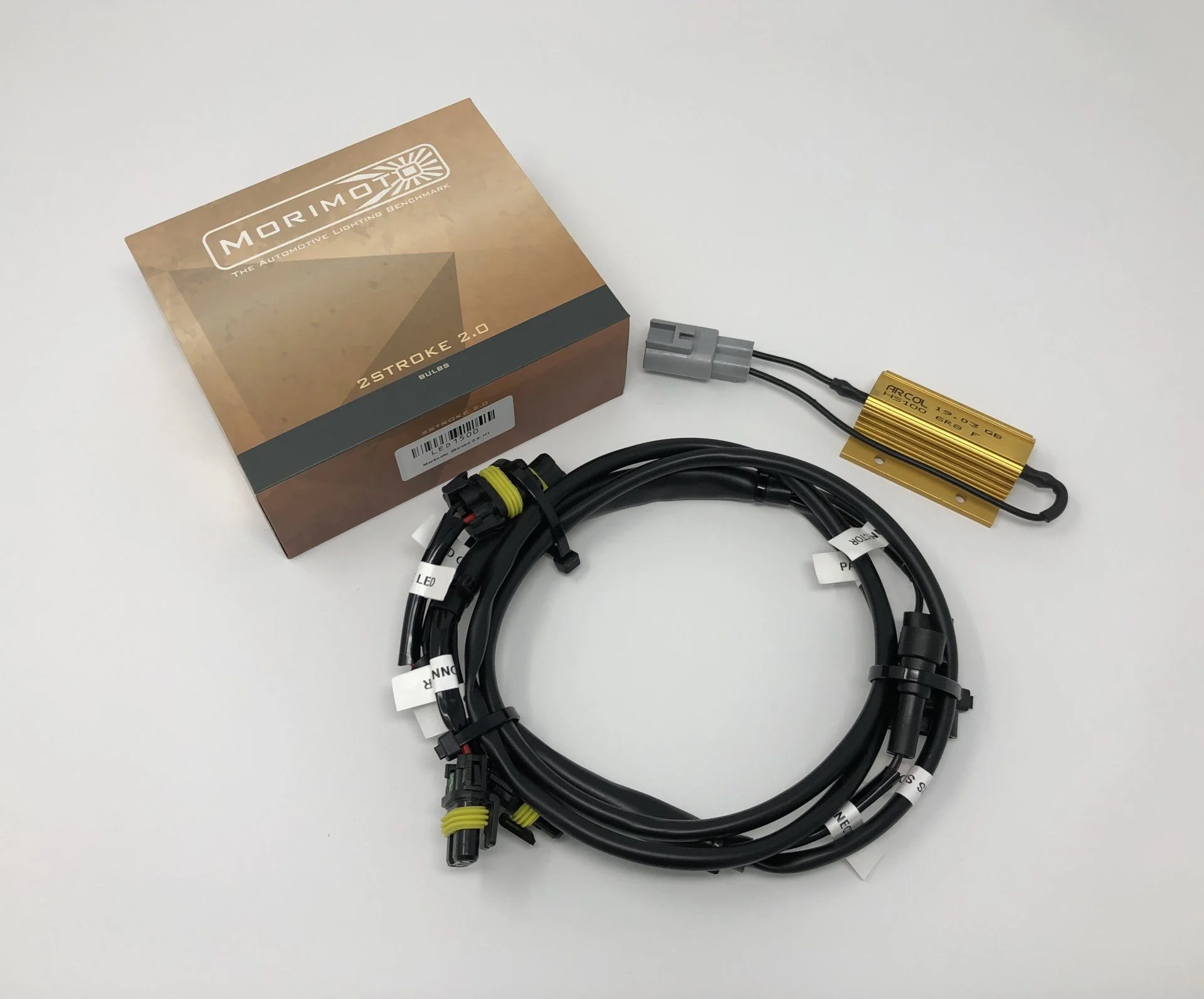

I’m working on a similar setup for a Mudder in Ca but with the 2Stroke LED that will also run at a lower output DRL. The 2Stroke LED,
new harness and resistor will be on my site very soon as a plug and play High Beam/DRL for both LC and LX470 with or without a HID in the low beam location.
Some of you already know this but I thought I’d mention that with the help of @jerryb and for those the a 03-07 LX and a LC that have a DRL resistor you can run the 2Stroke LED in the High Beam location and it will operate as a DRL and High Beam. The kit is on my site which includes a harness, resistor and the bulbs .. it’s plug and play
Can you elaborate on how this harness works. I.e. does ones need a Bi-xenon projector for this harness to work?
For example, I have a pair of non-bi-xenon SC430 projectors and Halogen hi beams.
Yes the harness will work ... you would buy the harness for those running Halogens in the low beam... I didn’t think about those running non bi-xenon.. but that harness will work as long as your truck is a 03-2007

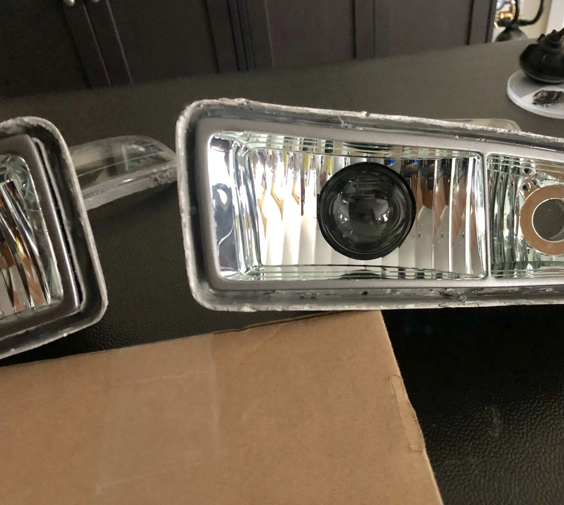

... speaking of fog lights.. I just received a set I ordered from China and unlike the knock off head lights these appear to match the OEM foglights including the mounting bracket projector inside the housing..

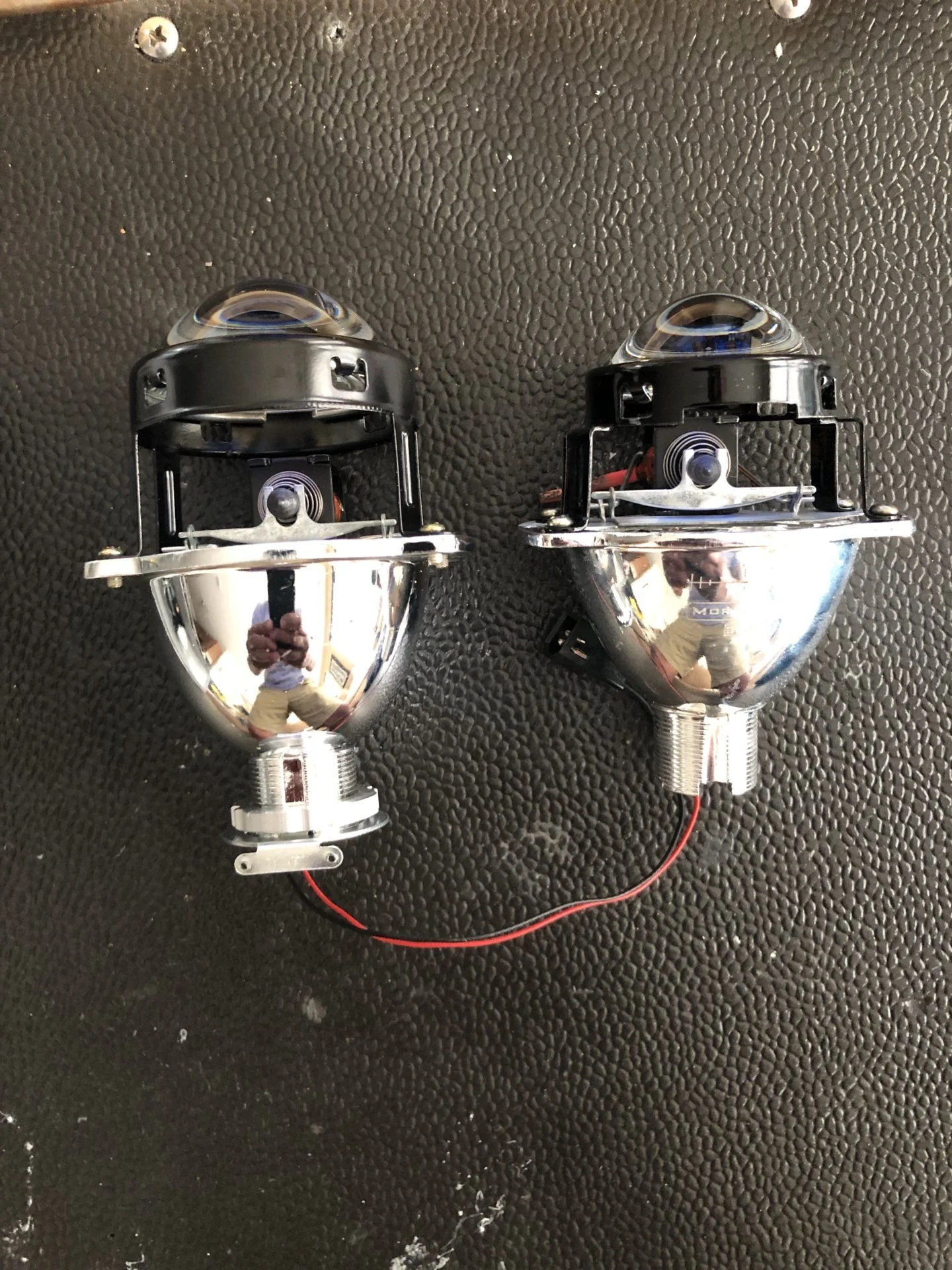

I just finished a quad set for my 80 using Depo light housing and I’m running the D2S and a small 2.0 projector I bought from LightWerkz... I’m also running a 6500k bulb a 35w ballast and it color matches the D2S

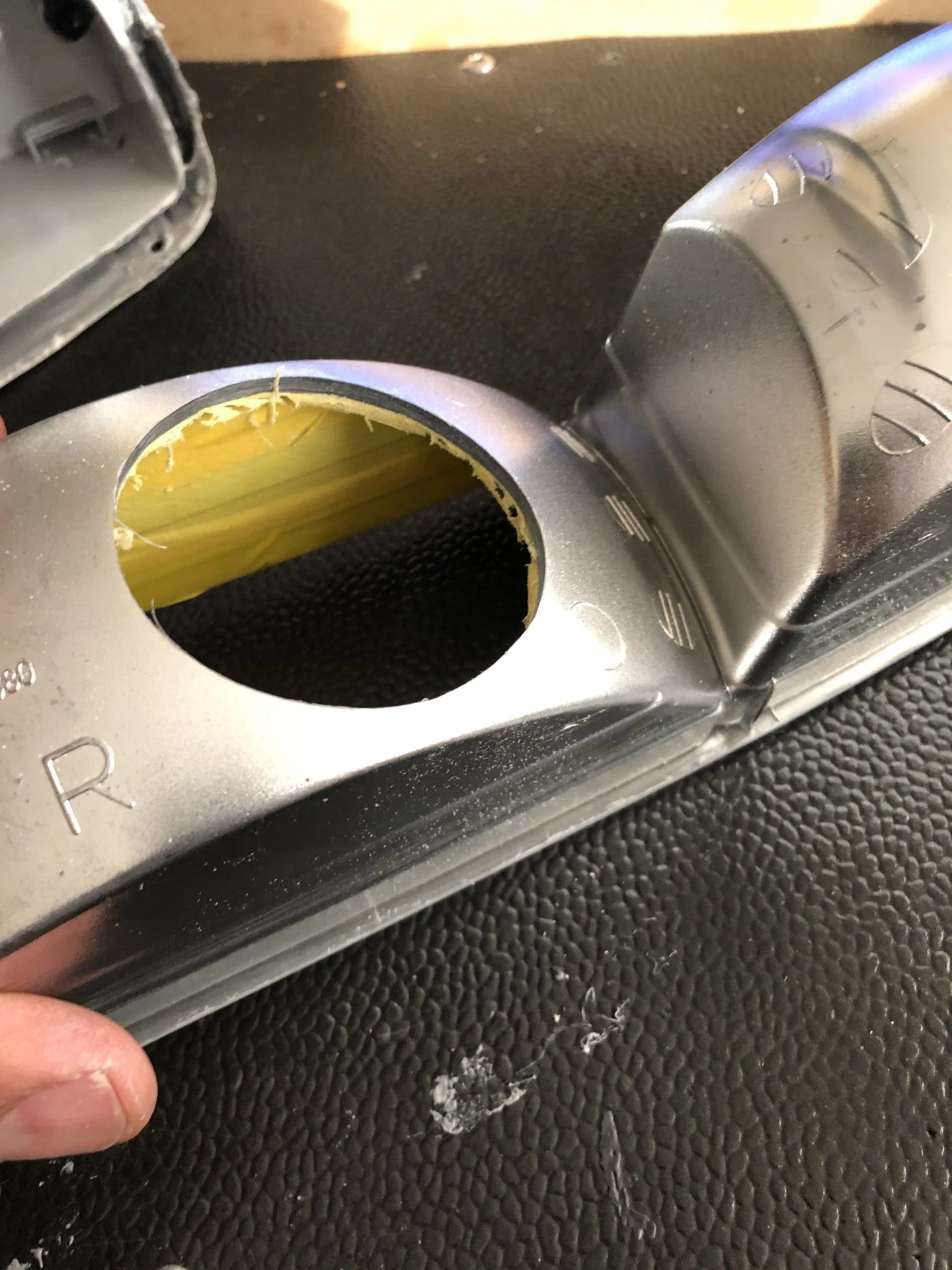

I’m currently modifying my LX fog lights with that 2.0 projector wiring them to my A-Pillar switch pad and running a 3 way splitter to have 6 lights firing as high beams.
First picture shows the color match of running 6500k and 35w ballast in the 2.0 and 5800K and 50w ballast in the D2S
Second is a size comparison of the 2.0 to the smaller Morimoto Matchbox. The 2.0 is smaller then the Mini H1
Opening the shroud for clearance.... not perfectly round but once they are installed you'll never see it and as I stated above the plan is to wire them to also fire as a high beam along with the 4 other lights.

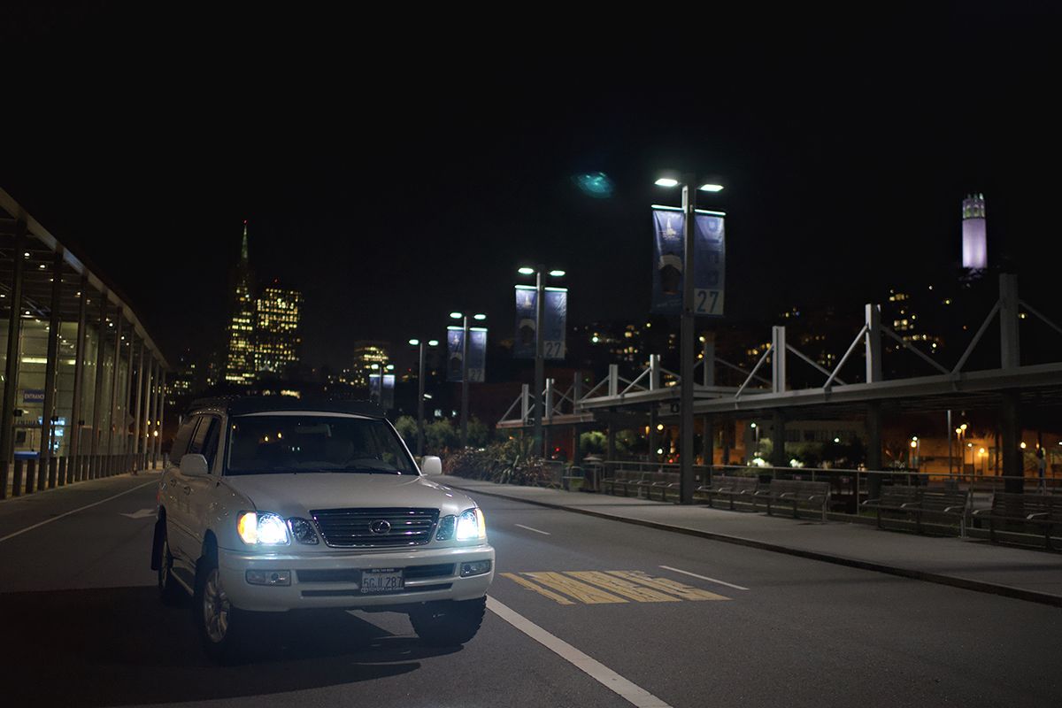

Hey everyone I just wanted to post up and how awesome these lights are. I have the DS2Ss and the new led high beams that Luke is putting together. I have had them installed for about a month and I am very impressed. I don’t have any pictures that do the brightness justice
