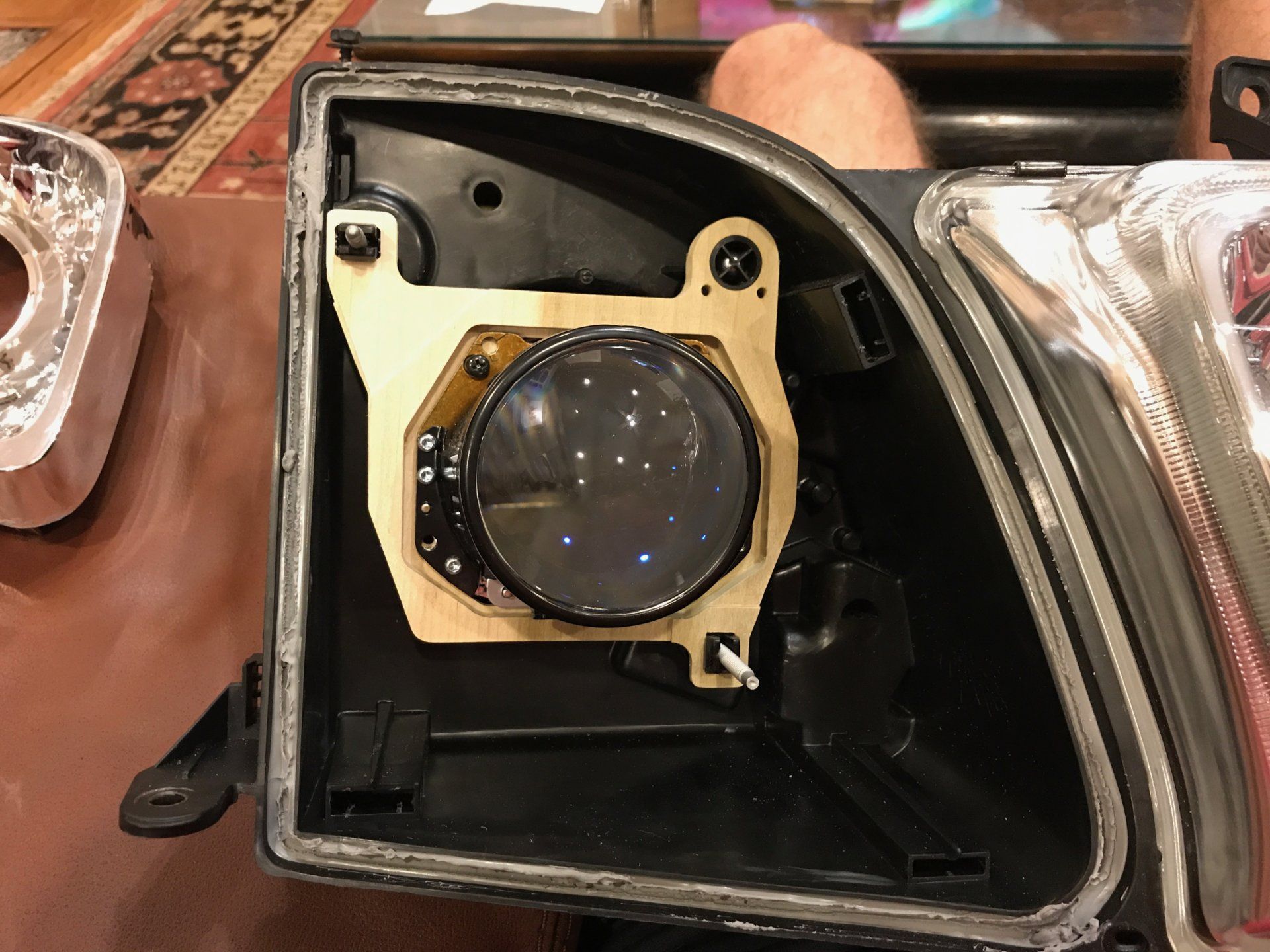

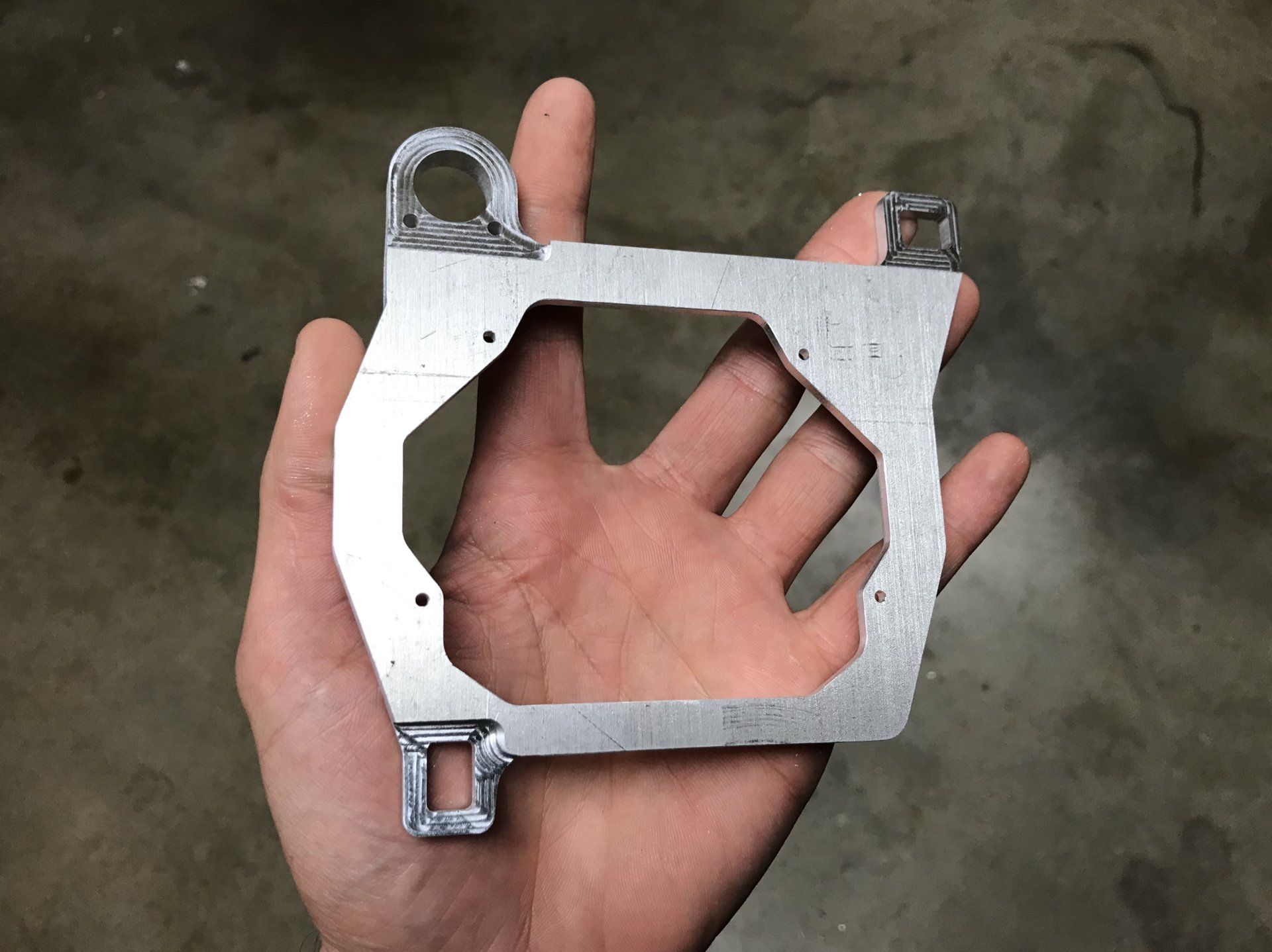

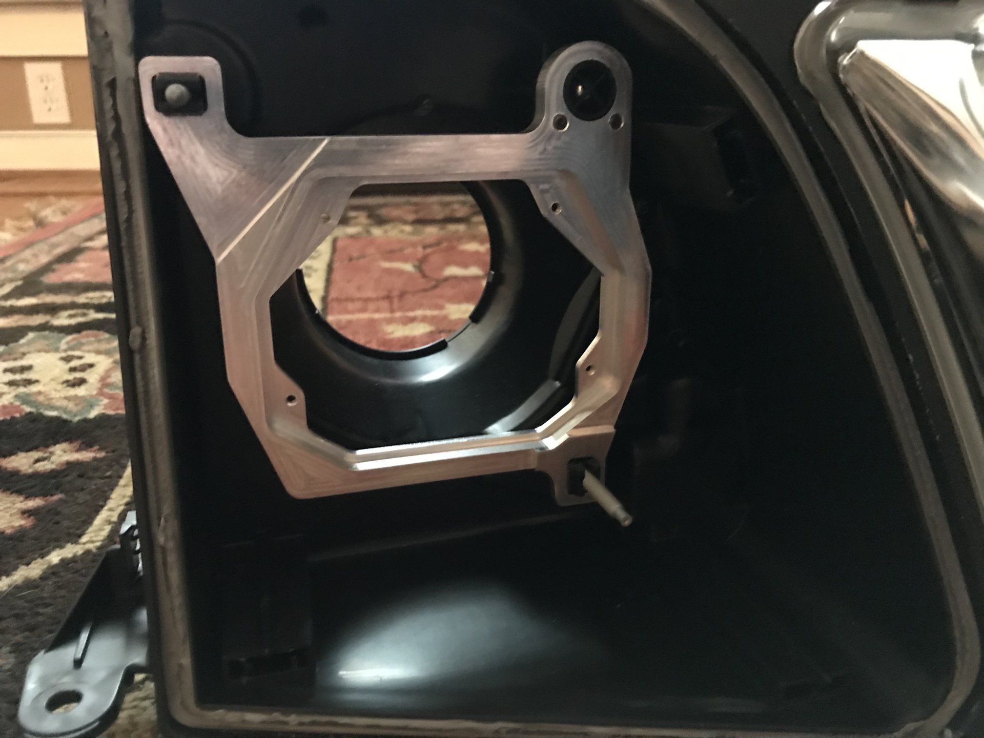

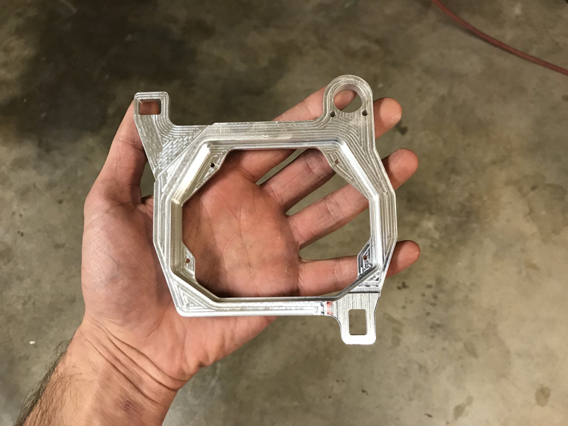

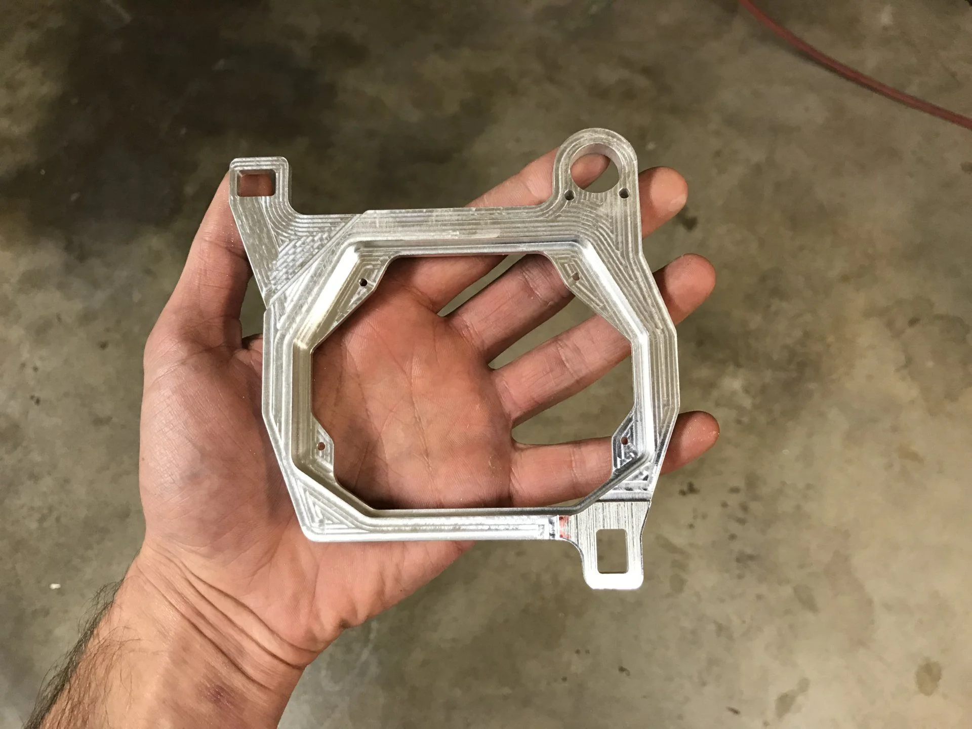

When you have knowledge, skills and a CNC you build your own. @xirforever who has mad skills CNC’d a bracket for the D2S that maintains all the factory mounting points and fits without opening up the shroud. Don’t ask how much they cost... they are not for sale.
must be made of unobtanium.... looks nice
Nice job xirforever! One would hope more brackets could be made. They would sell out in a heartbeat!
I asked him to check pricing ... we are both thinking $150.00 to $200.00 per bracket ... and they won't sell out in a heart beat..I have more than 160 brackets in stock at $95 a pair .....I'm selling more Plug and Play new OEM housing retrofitted with the D2S projector then brackets

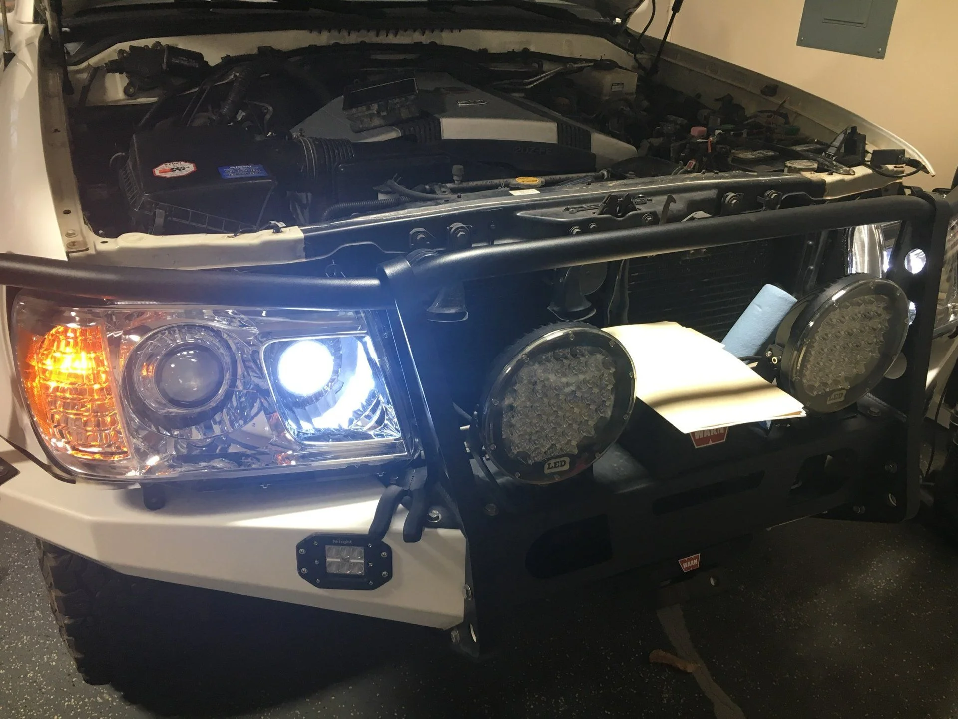

So daylight running lights are LED, but have to be triggered by one click on light switch and then the LEDs are brights. Ds2s are normal low and hi.
I can't wait until dark. Fortunately I did a rough aiming this morning before the sun was up.
Jerry, does great work and we’ve talked daily about wiring those LED’s to work.
As you’ve experienced tonight you’re lights are pretty sick...

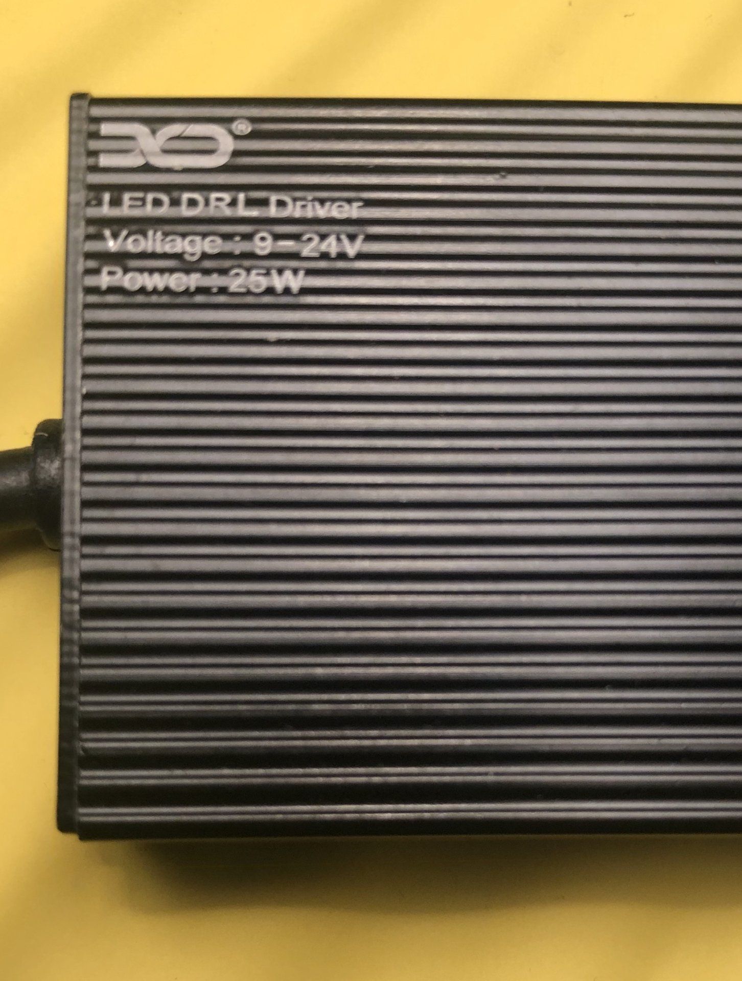

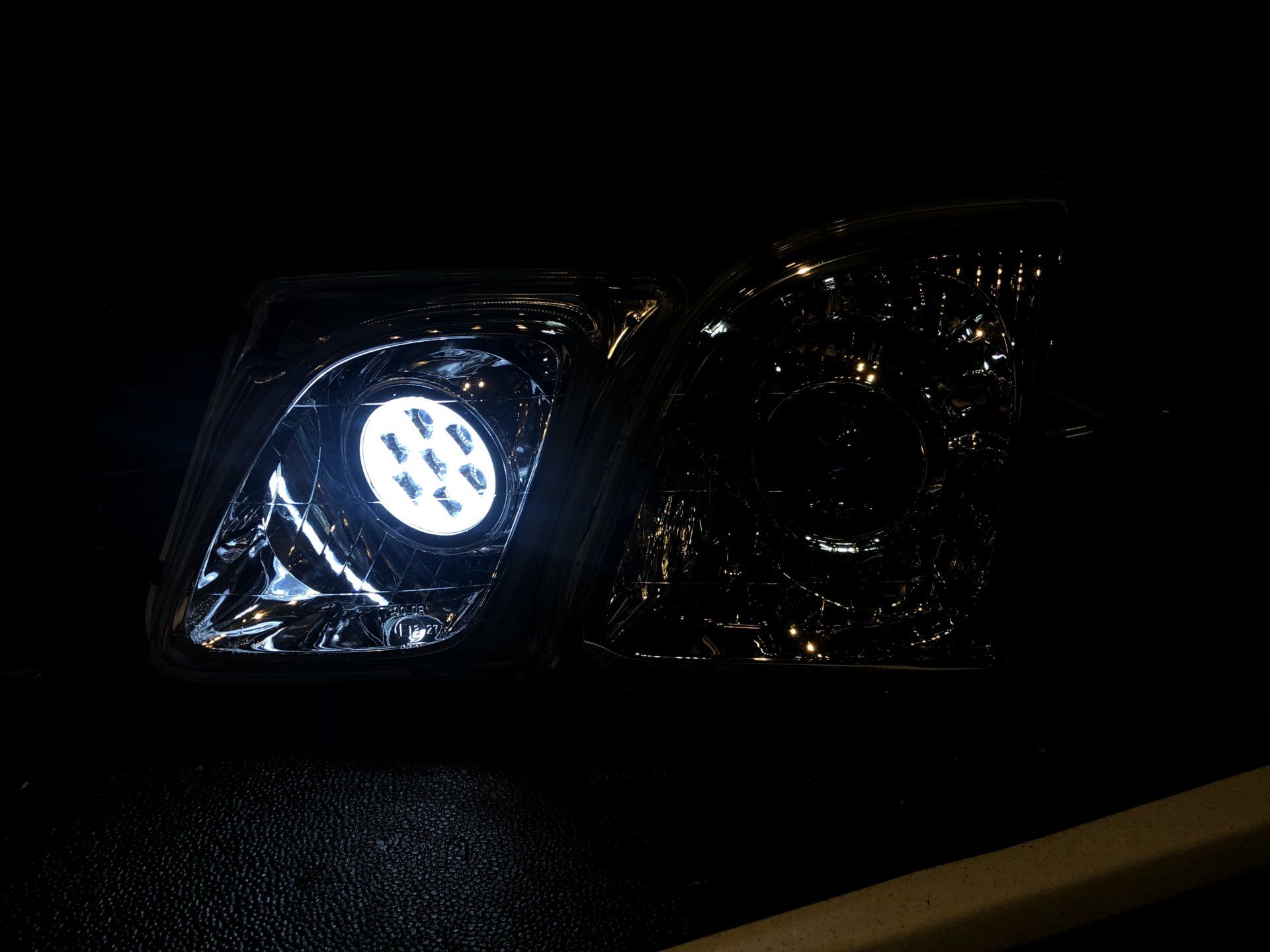

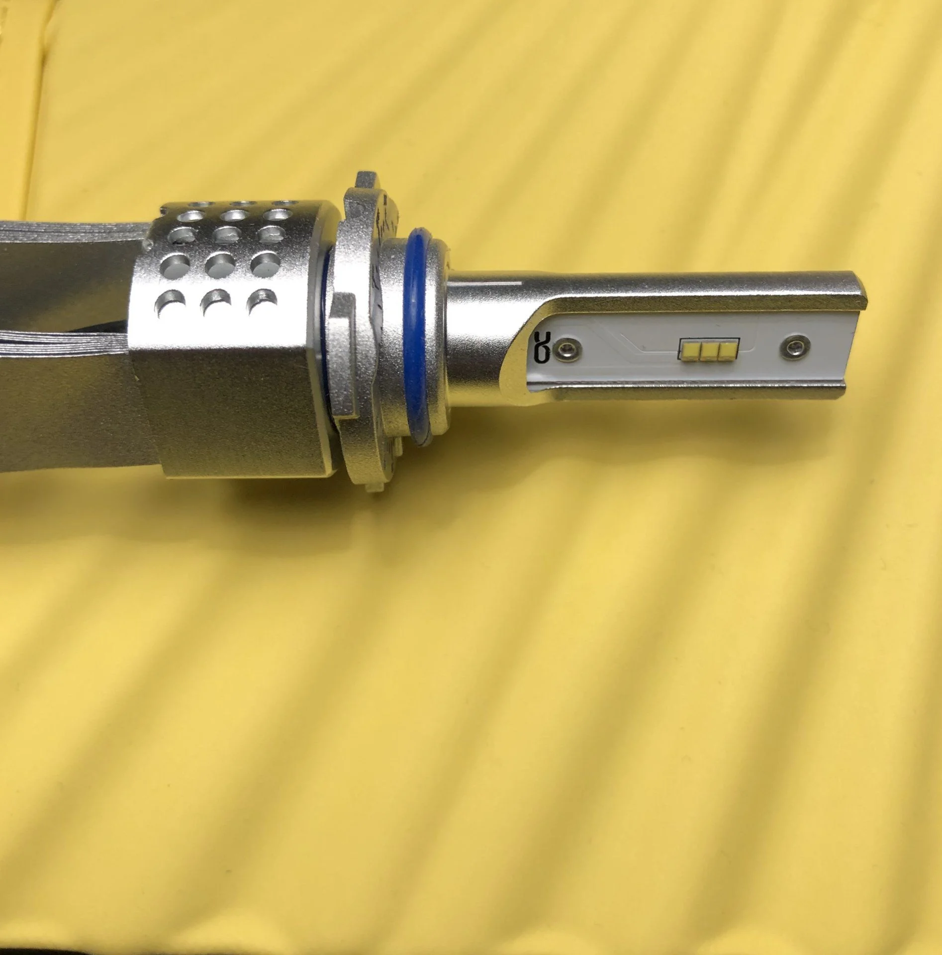

The XenonDepot LED that works as a DRL&High Beam in the 4Runner does not work in the LX/LC and the same could be said for the Morimoto 2Stroke. We did get the 2Stroke to work as a DRL/high beam when connected to one side but will not work with both sides connected so I just shipped them to @jerryb...the resident guru... he thinks he can make some changes inside the driver to get them to work.... we will get this done.

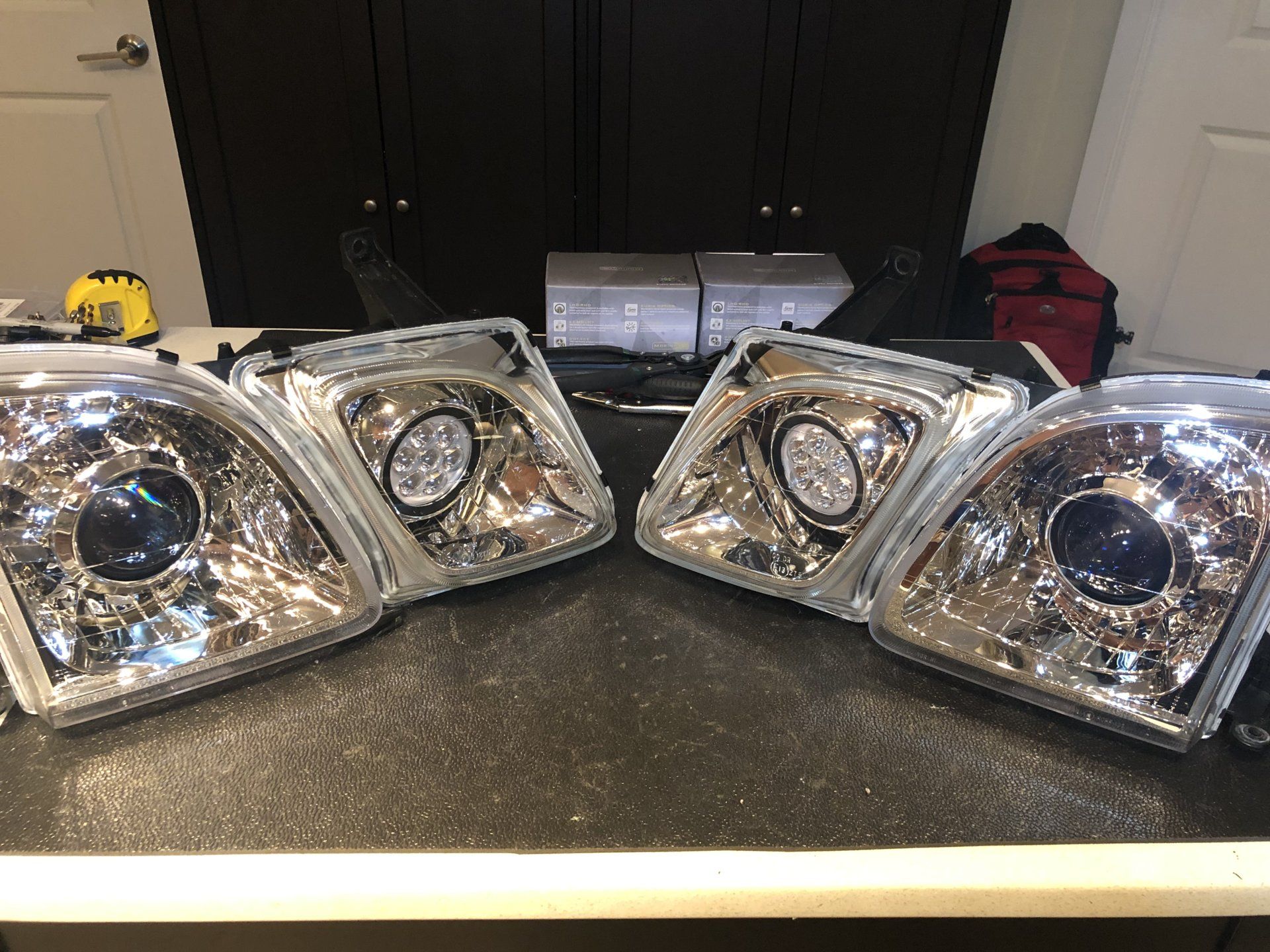

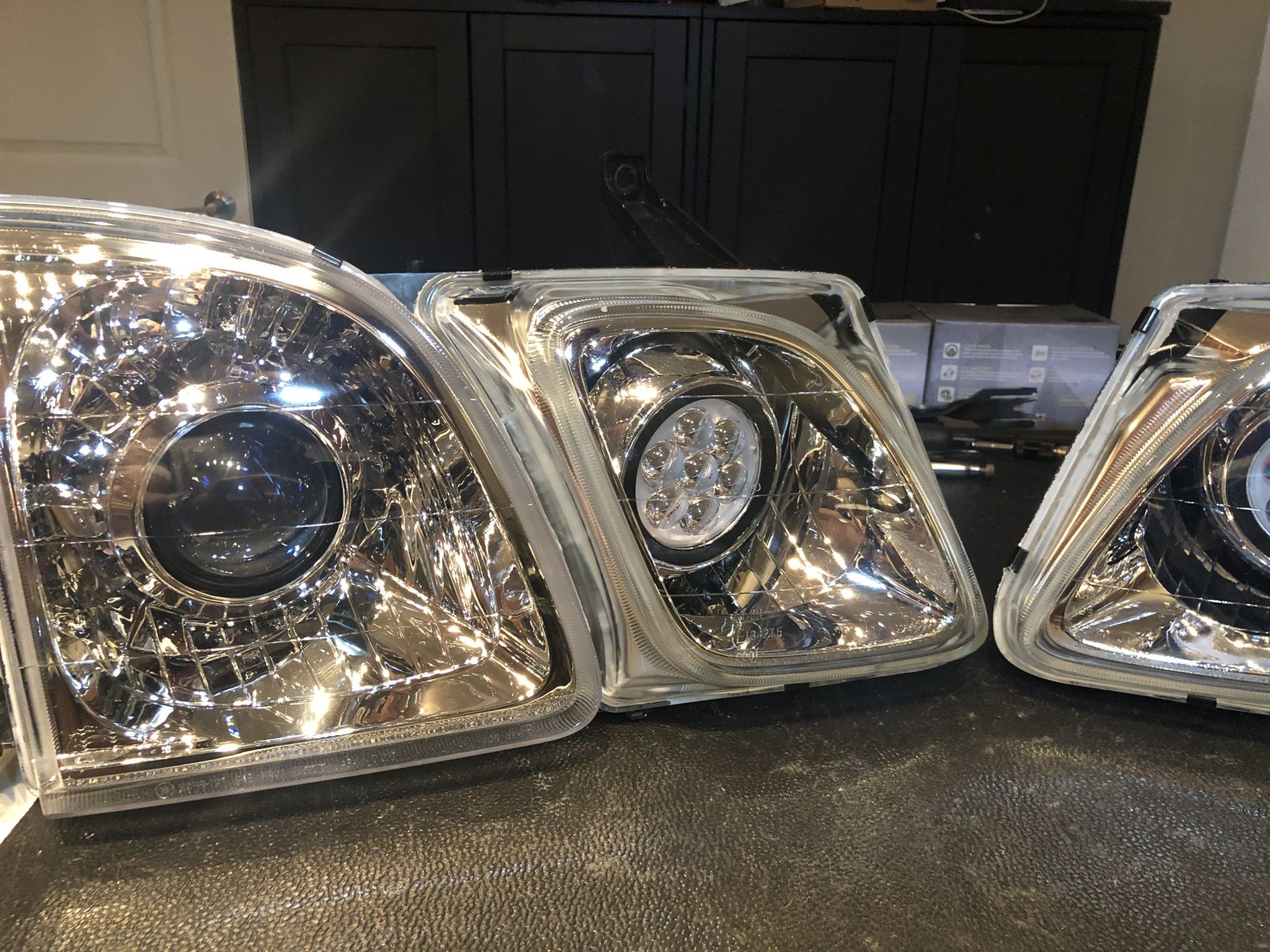

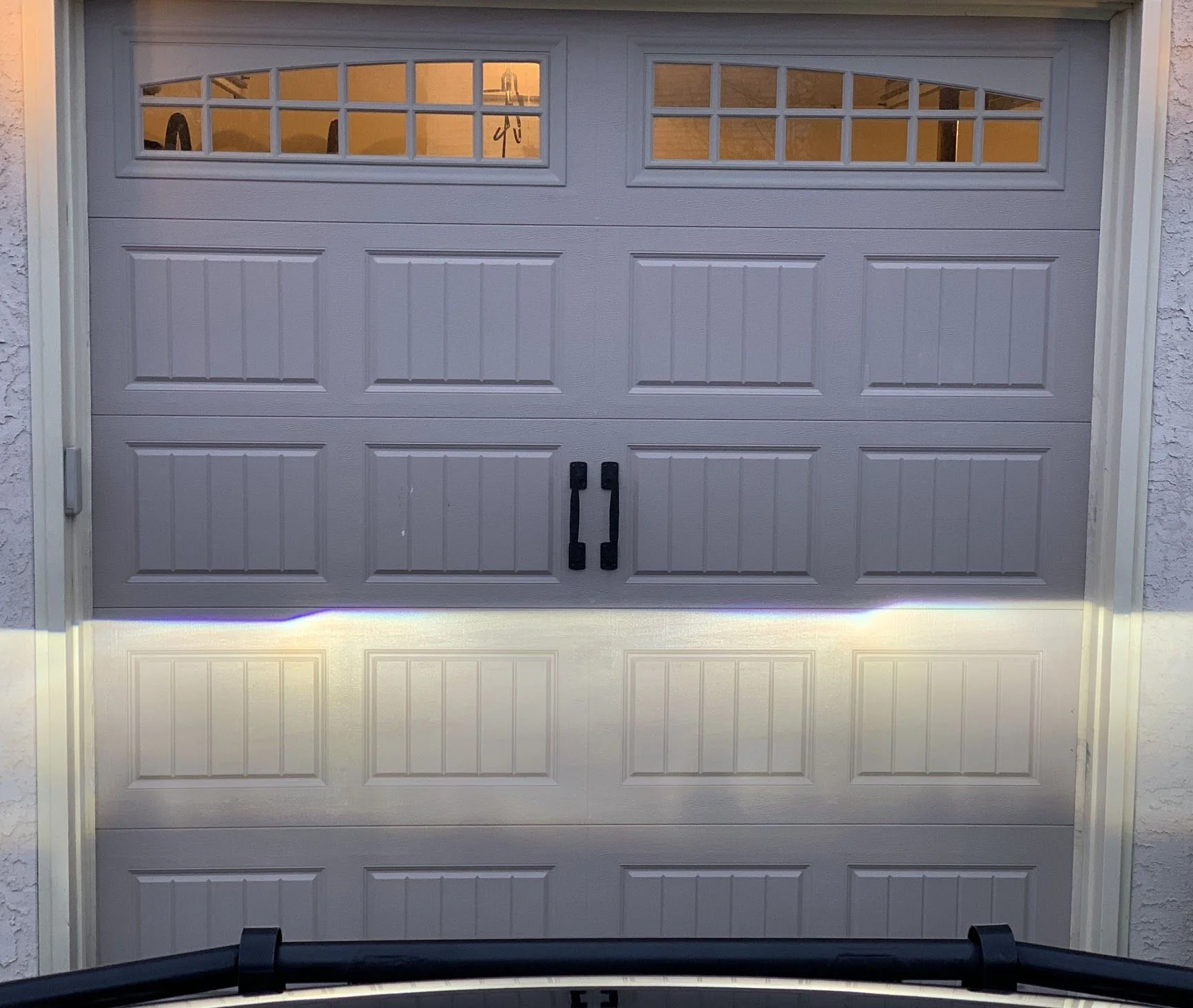

I finally built myself a new set of lights ... with the D2S 5.0 Projector and the Profile Hi-lens as a DRL and additional High Beam..... 50w ballast and the Osram CBB 7000k bulb The new 5.0 has a blue tint in the lens which shows up in these pictures
I’m also working to have at least one finished set of D2S lights that can be shipped right away so there’s no delay

So sick! Will the built DS2s you’ll be selling include the profile high lens?
I can build them anyway you'd like but will probably stock ready retrofits with just the D2S simple to keep the price down but I've built quite a few custom Quad projector sets so when you're ready let me know what you'd like
We are really hoping to get TRS to make an LED Bulb that works as a DRL and high beam which actually has a better high beam output then the Hi-Lens and plugs right in.
I love the sharp cut-off, and the fact that I can see it even during the day time (so much nicer than the OEM projectors...)
