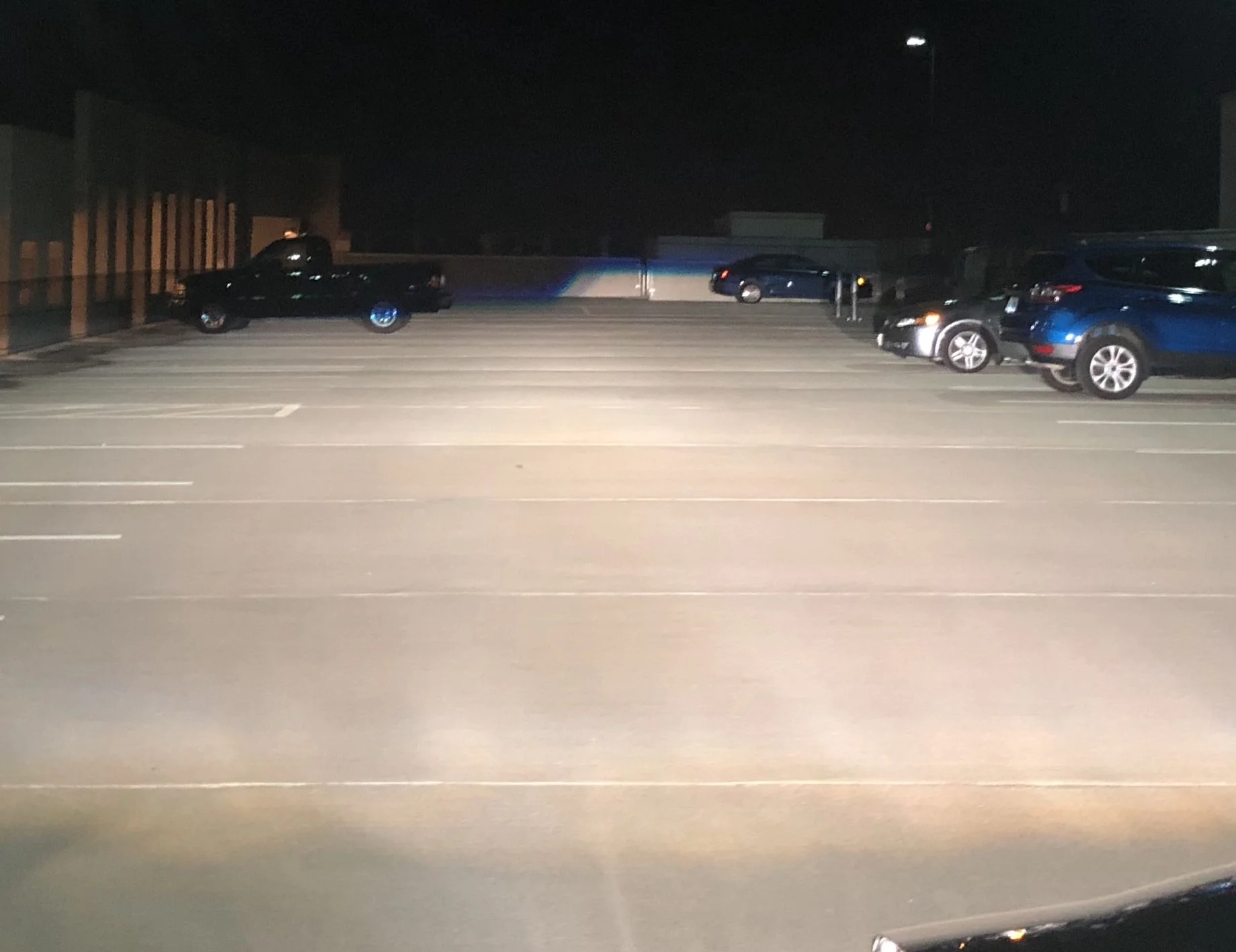

How much light do you really need?
D2S low and high beam output shot
Client ask to upgrade to the Osram CBB 7000k

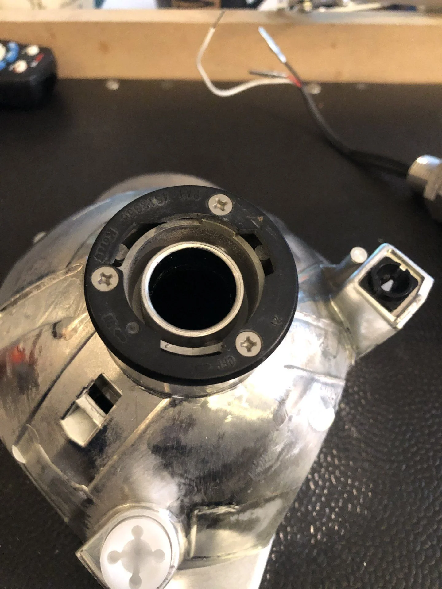

Lou, does that LED high beam slide through a 9005 hole? like say a LC headlight high beam. No fuss? wired straight to the same splitter that one uses with D2s to trigger high beam?
I see it says 19mm bore and the hole on a 9005 os 20.5-21mm. So there isn't anything more to it?
Excuse my ignorance but if a 9005 hole is the same one that’s on the LX it just about slides through. I used a sanding drum on a Dremel and hit it lightly and it slid through....in the picture below that’s a factory shroud that has not been hit with a Dremel and I can screw it in but it was a little tight so that’s why I use the sanding drum
Obviously I’m sliding it through the wrong direction but you get the picture
Here the extended threaded shaft I ordered
https://www.amazon.com/gp/product/B00S8Q7T66/?tag=ihco-20
