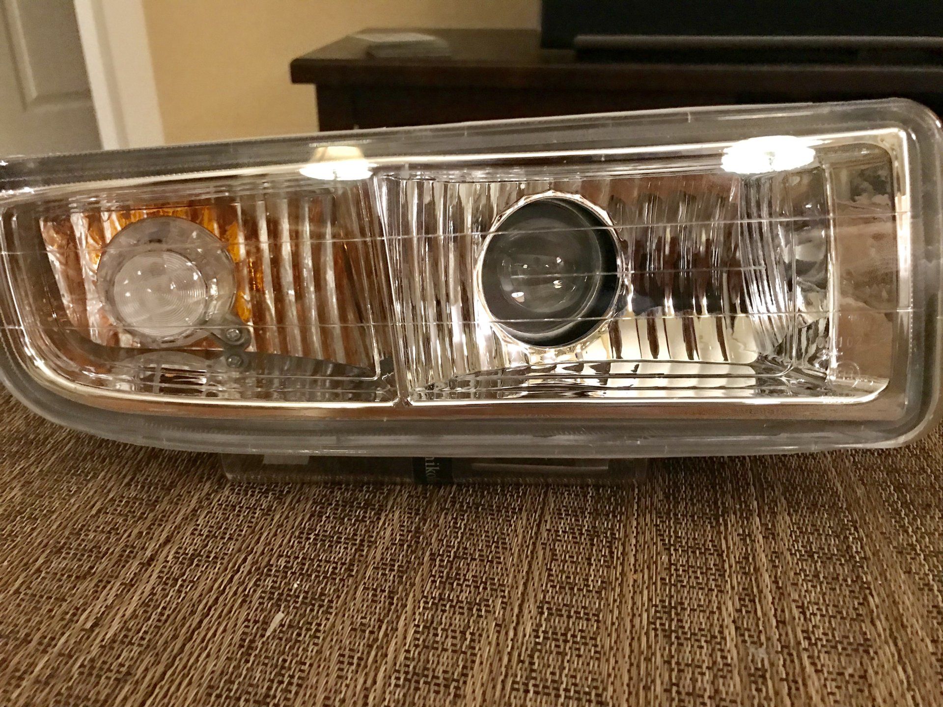

... speaking of fog lights.. I just received a set I ordered from China and unlike the knock off head lights these appear to match the OEM foglights including the mounting bracket projector inside the housing..
