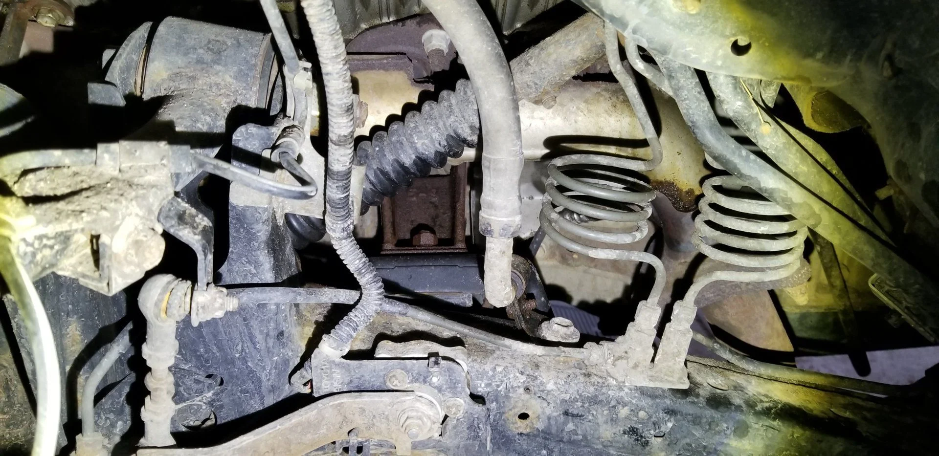

Here is a pic from the wheel well on the drivers side with the plastic removed.
Going from the top side is impossible because of the steering wheel shaft and other garbage.
Going from underneath is impossible because the nut is on top.
Deal wants $90 in labor and Haynes manual says "remove the nut", so it must be a straight forward process. I just can't figure out what tool to use to access this. I'll go at it tomorrow with a regular socket and a long rachet.
The bolt is dead center in the picture. It's in the Rusty Cavern that has been PB blasted to hell and back.

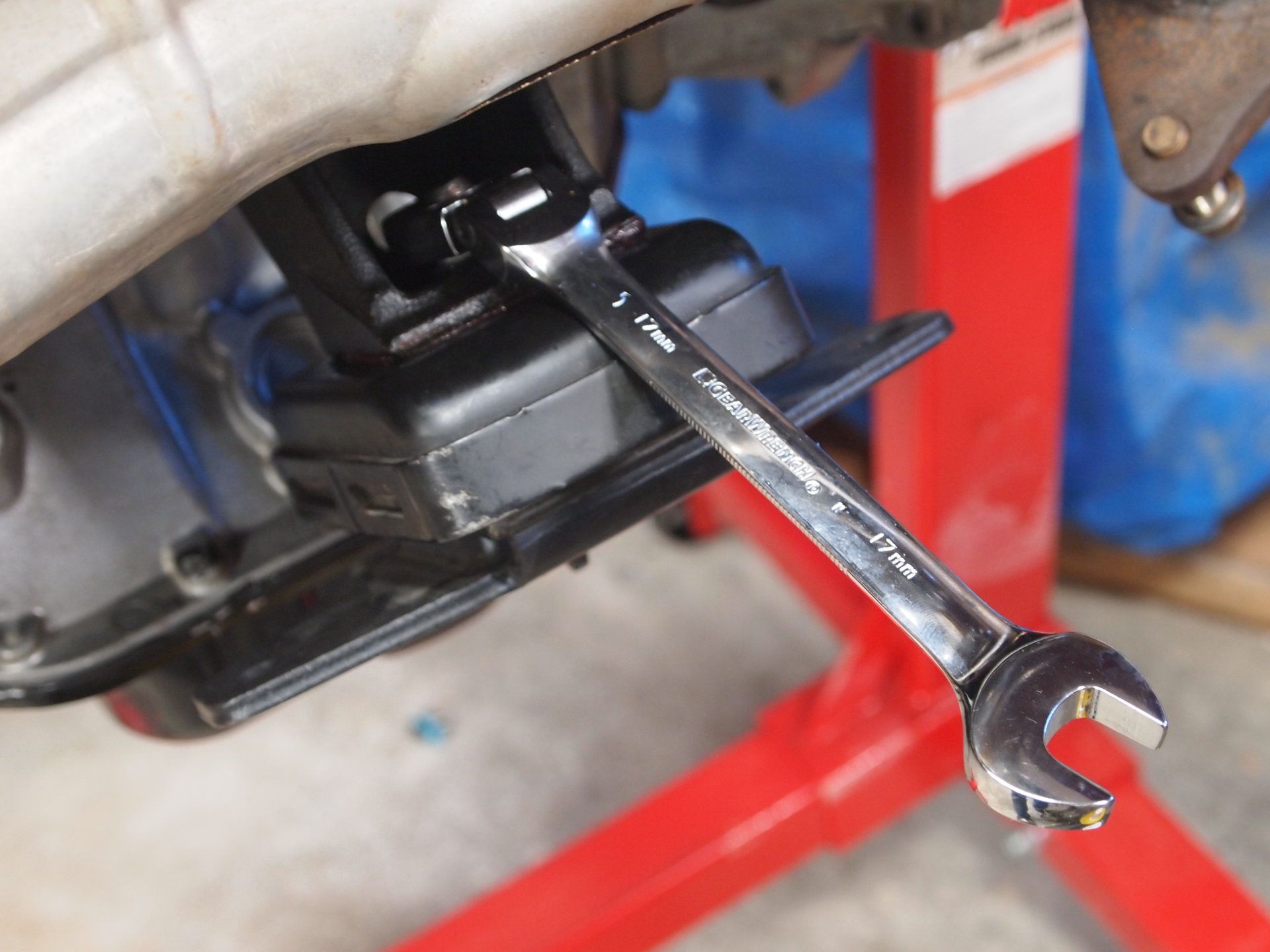

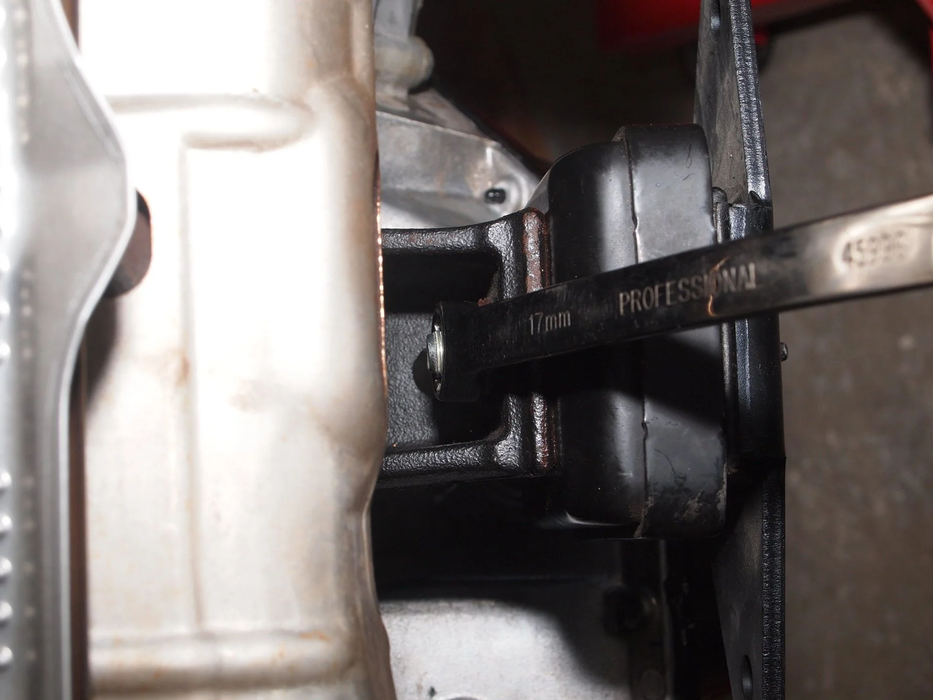

I found the standard crowsfoot pictured above, was limited in it's bit. Once turned couldn't get back on. But with a thin boxed crowsfoot maybe!

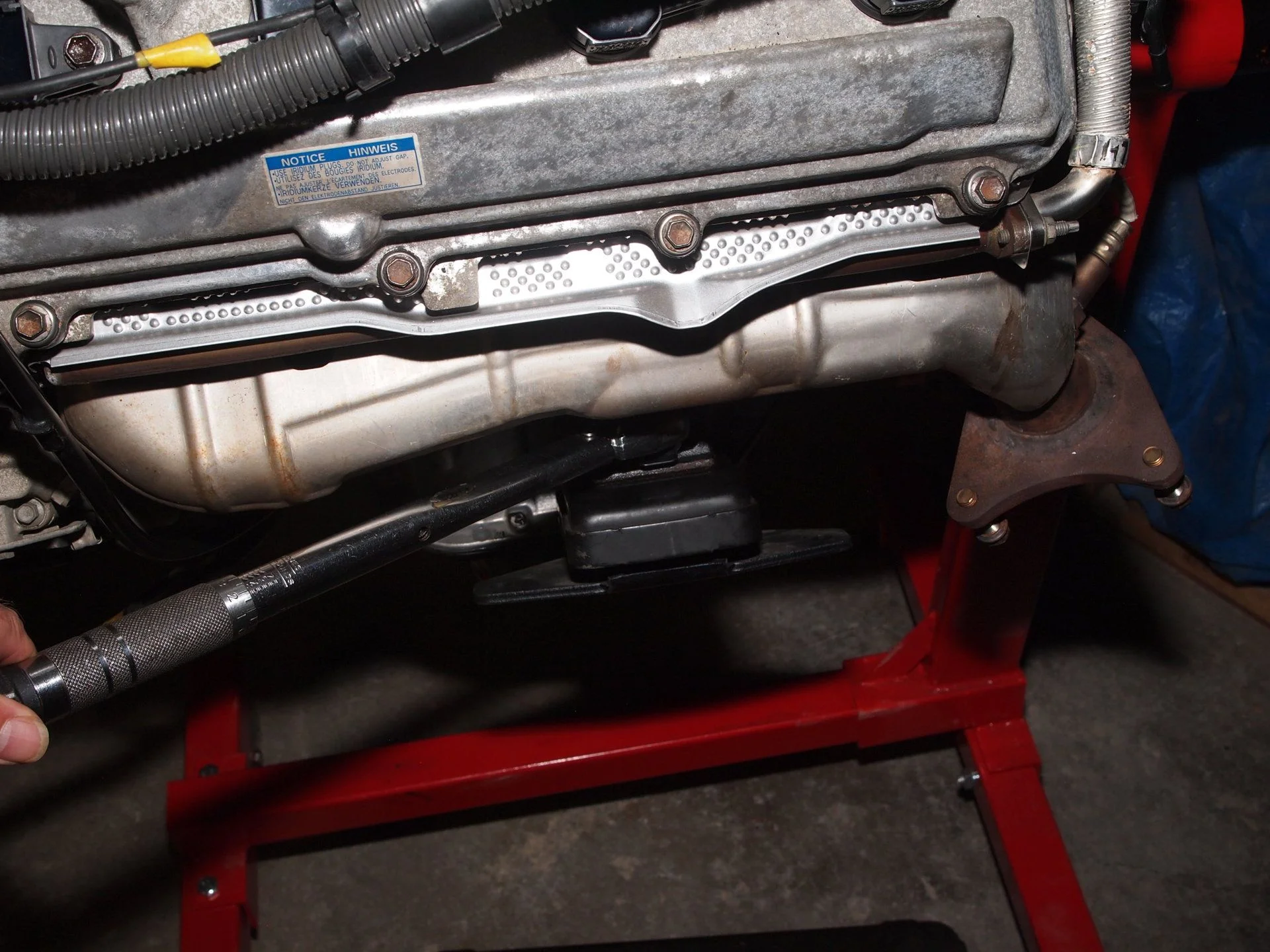

The boxes wrench flipped down like in above picture, has been best bit. With second box wrench hooked into open end to gain leavege with length.
A 3/8" breaker bar with short 17mm socket fit nicely. Use this set up to break loose.
Then slip on a ratcheted boxed end wrench, if you can't spin off by hand.

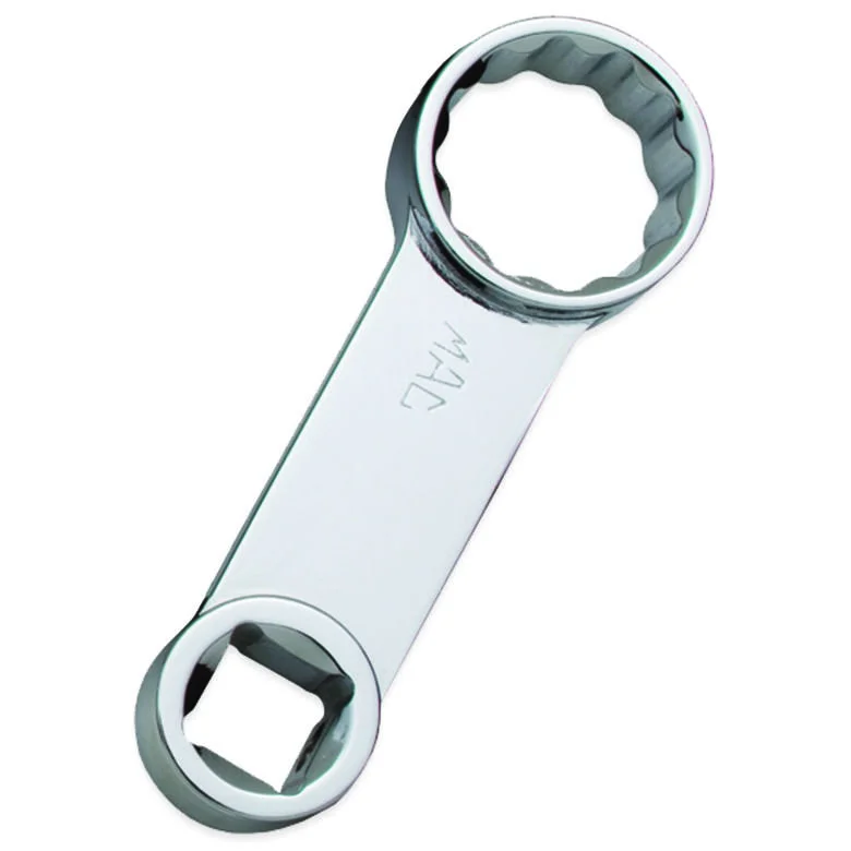

Keep in mind a ratchet wrench will be broken if used to break nuts & bolts loose. Use a breaker bar or box end wrench for that.

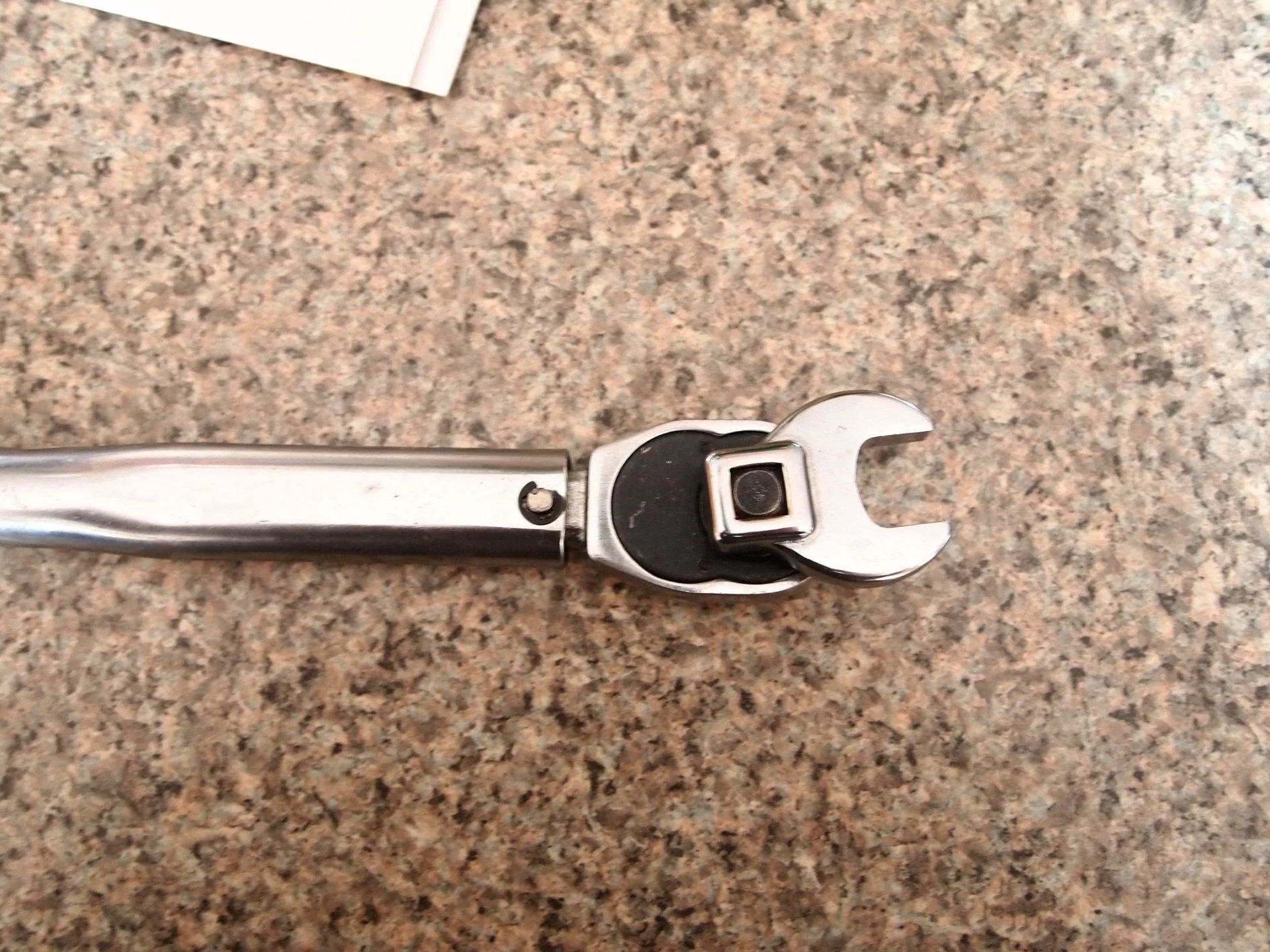

I found some other tools that may be helpful.

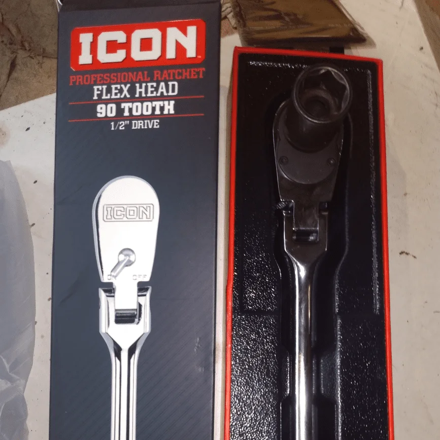

After giving my problem some thought , I realized my standard 72 tooth swivel head ratchet would not allow a small degree movement that I needed to break the mount nut loose in such a tight area. So this afternoon, I decided to visit my local Harbor Freight and go looking for different types of swivel head ratchets.
Since my list visit to HF, they started selling a new tool brand named ICON. These ICON tools are more expensive than the Pittsburgh tools that I have purchased in the past. I found this 90 tooth 1/2 drive flex head ratchet and decided to give it a try with my existing 6 point impact 17mm socket.
The fit was tight and I had to jam the head into the mount area so the socket would properly seat on the 17mm nut.
The 90 tooth ratchet provided just enough swing to break the 17mm nut loose.

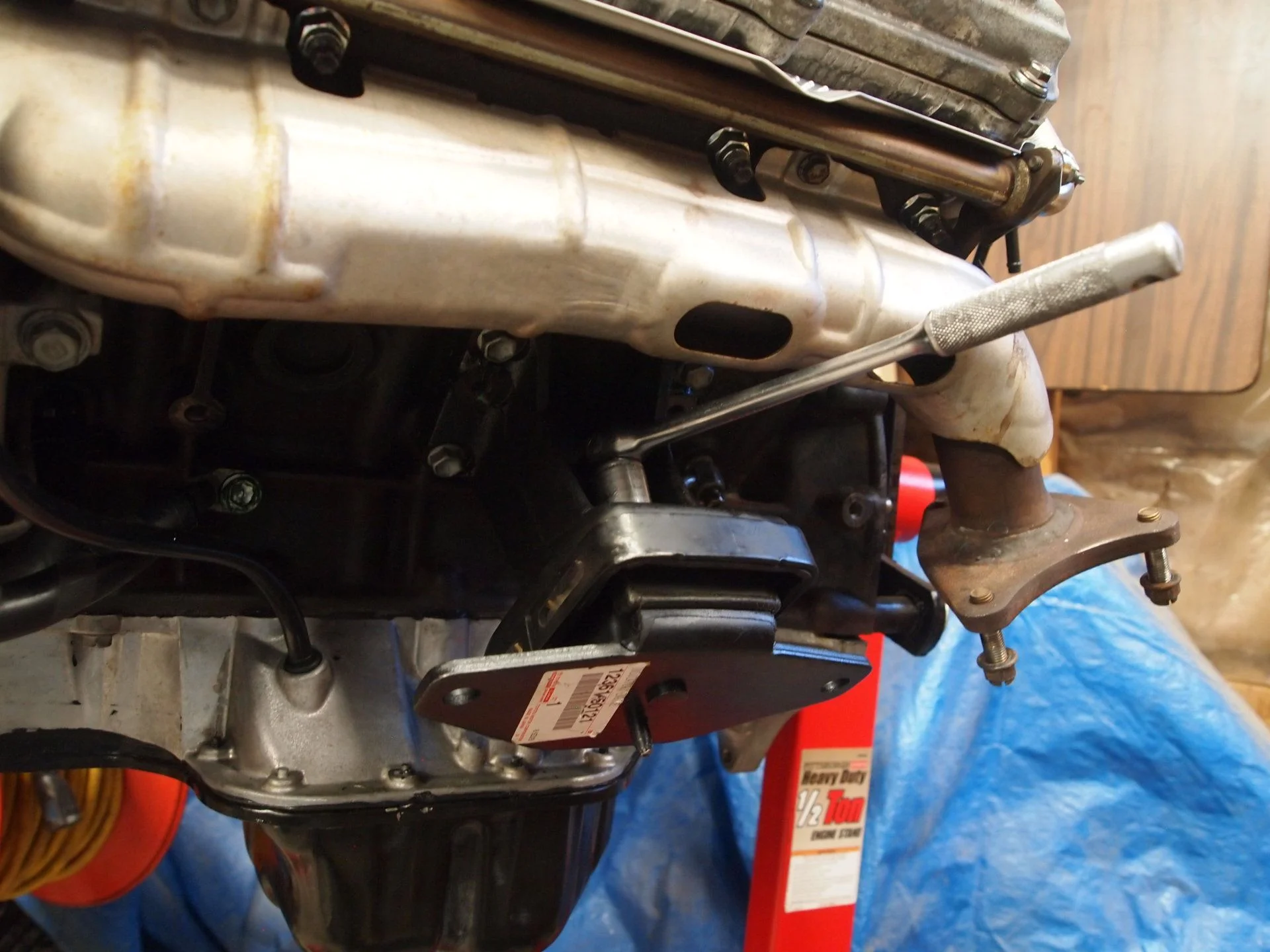

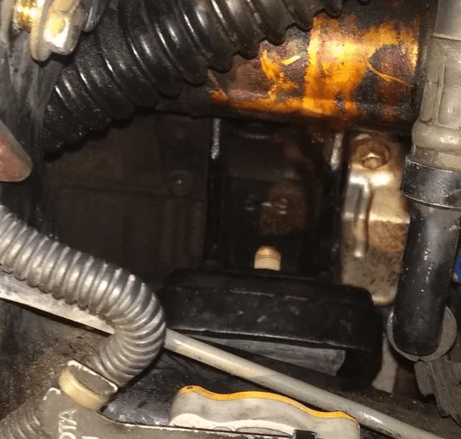

Here's a picture with the upper nut removed on the driver side.

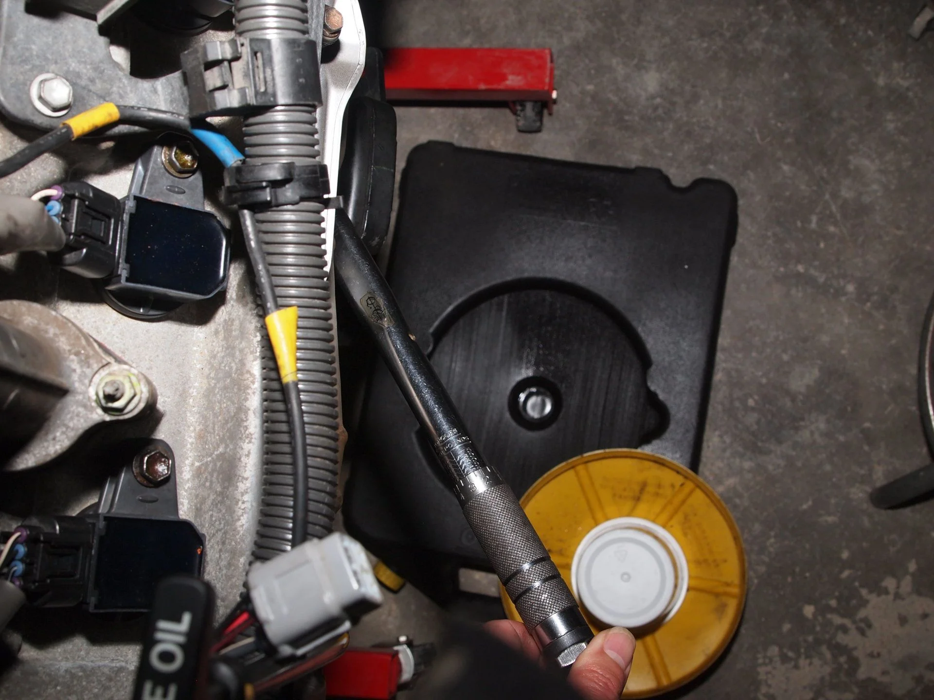

Replaced my engine and transmission mounts the other day. 2004 LX with 160k miles. It's an NM/AZ car and they were pretty far gone.
I used a flex head ratchet similar to @OwnerCS for the top nuts. I tried some crowfoot wrenches but could not for the life of me get them to work.
The biggest problem I had was lining up the two bottom bolts on the driver's side. I think it was because the old mounts had compressed so far that when I put in the new mount, the engine was off-kilter a bit. The passenger side slide in perfectly. In hindsight, I think loosening, but not removing the passenger side while replacing the driver's side might have made the job easier.
The transmission mount was much easier. Overall, not a difficult job, just hard as heck to access.
