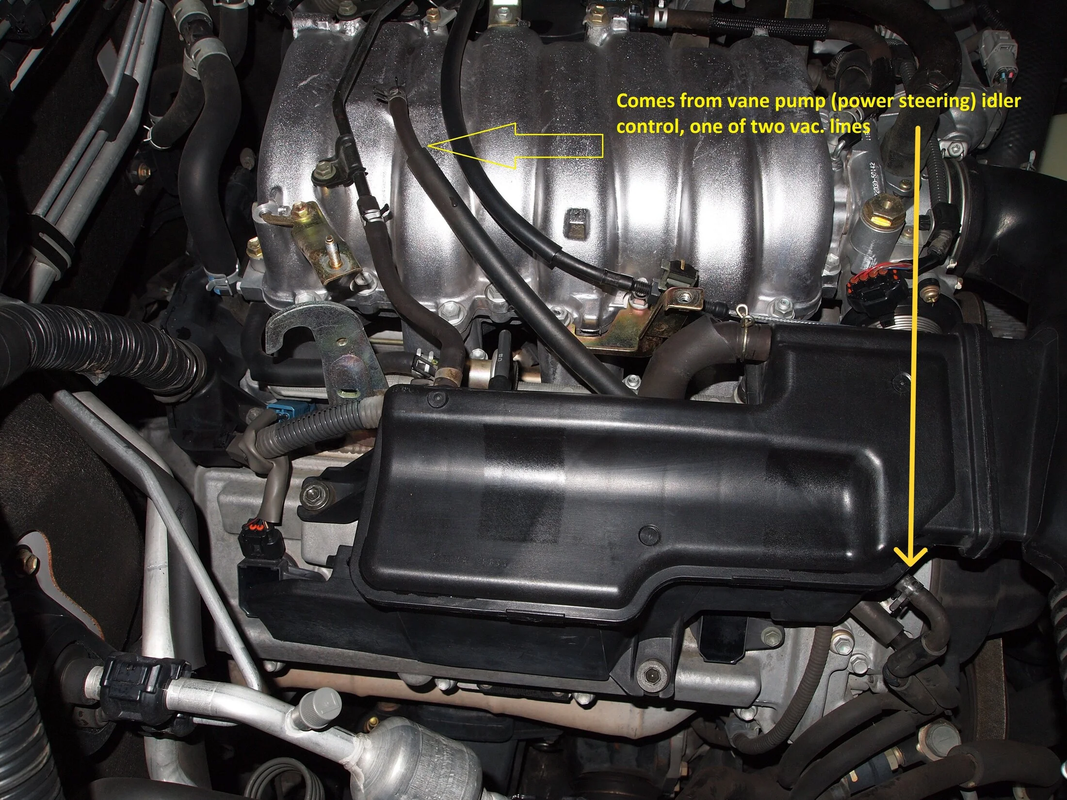

My first though: Idle up (@Bisho suggested) or vacuum lines from/to it. But if engine dies that easy. You also have, more going on that needs servicing.
You also have warring VSC off warning lights. In some cases. When idle up vacuum line off. We do get a check engine light (CEL). Which would shut down ABS, We then see waring VSC OFF.
You can check the vacuum lines. Just remove the engine cover and look. One that is very often left off. Is one from idle up to air pipe.

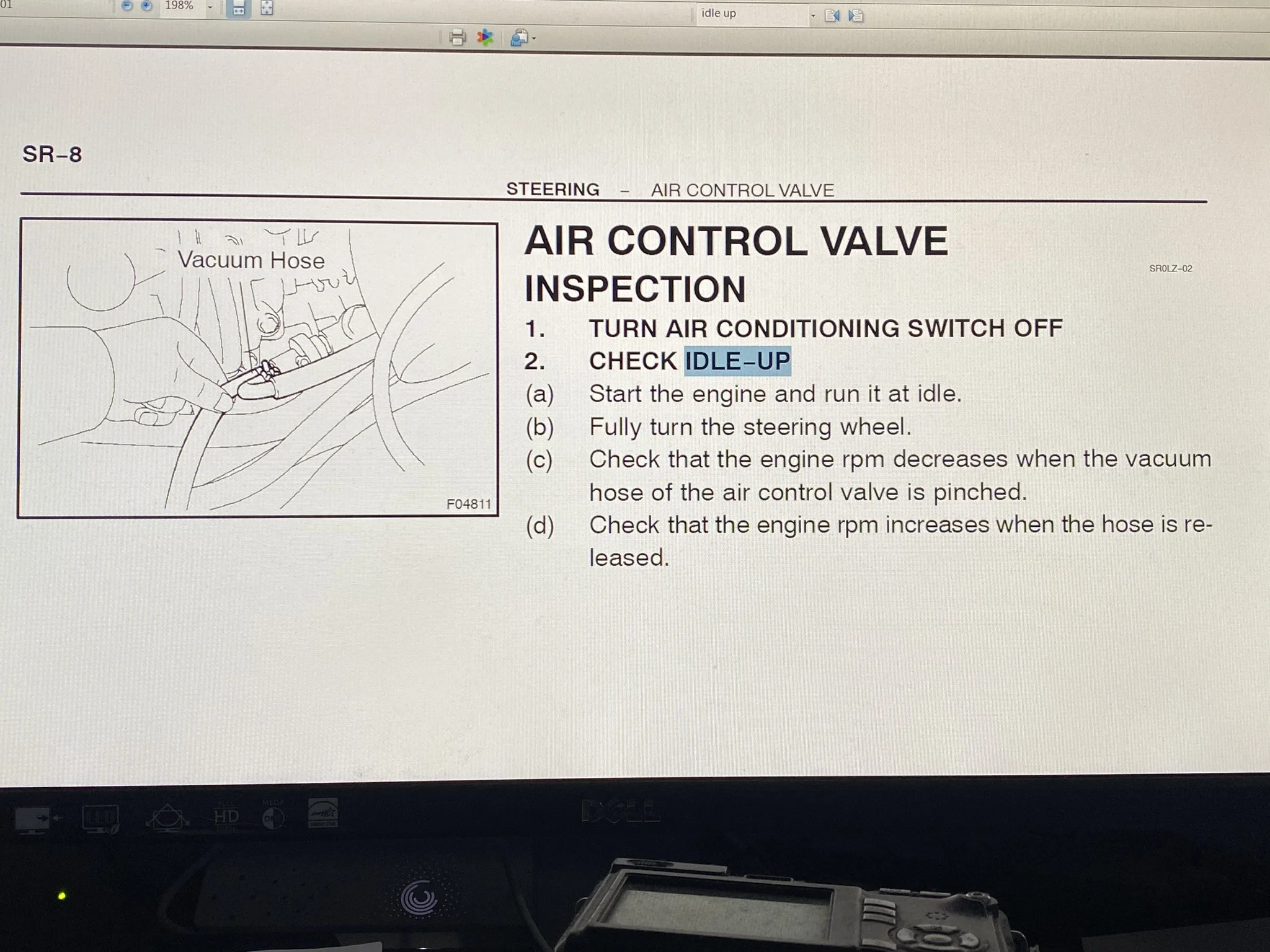

Two vacuum lines are attached to the Idle up control valve on/attached to power steering (PS) pump (AKA vane pump).
If all vacuum lines connected and good sung fit. Here's, idle up tested.

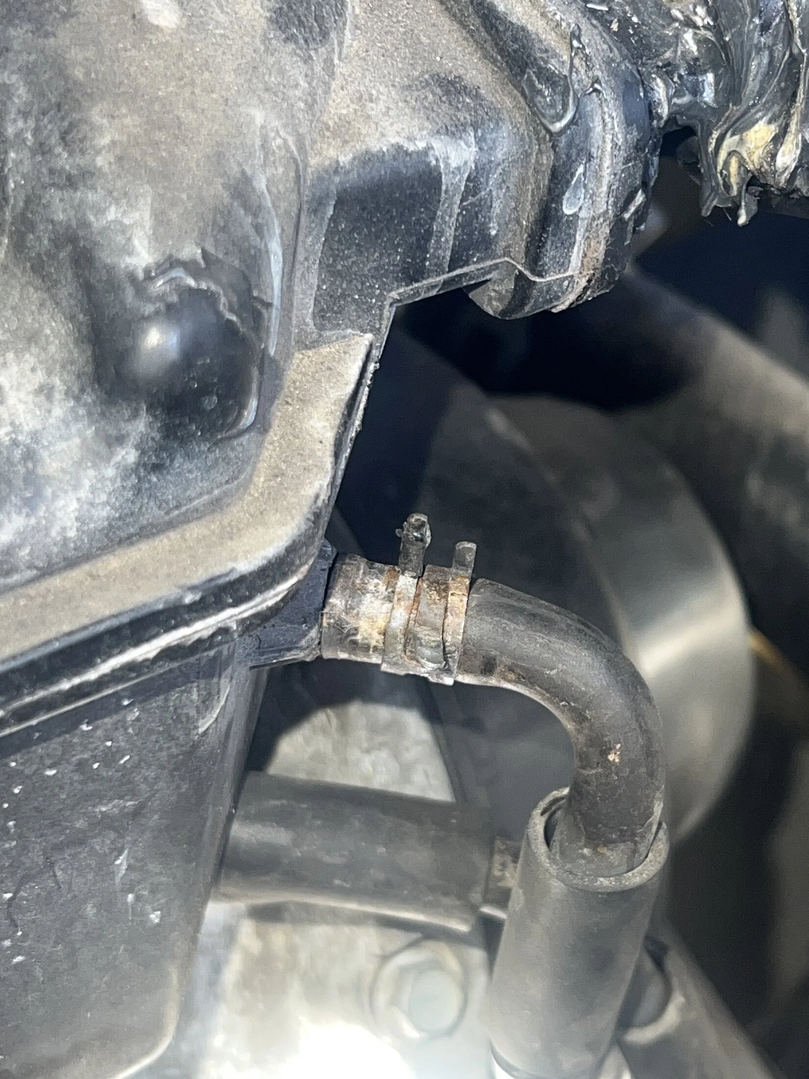

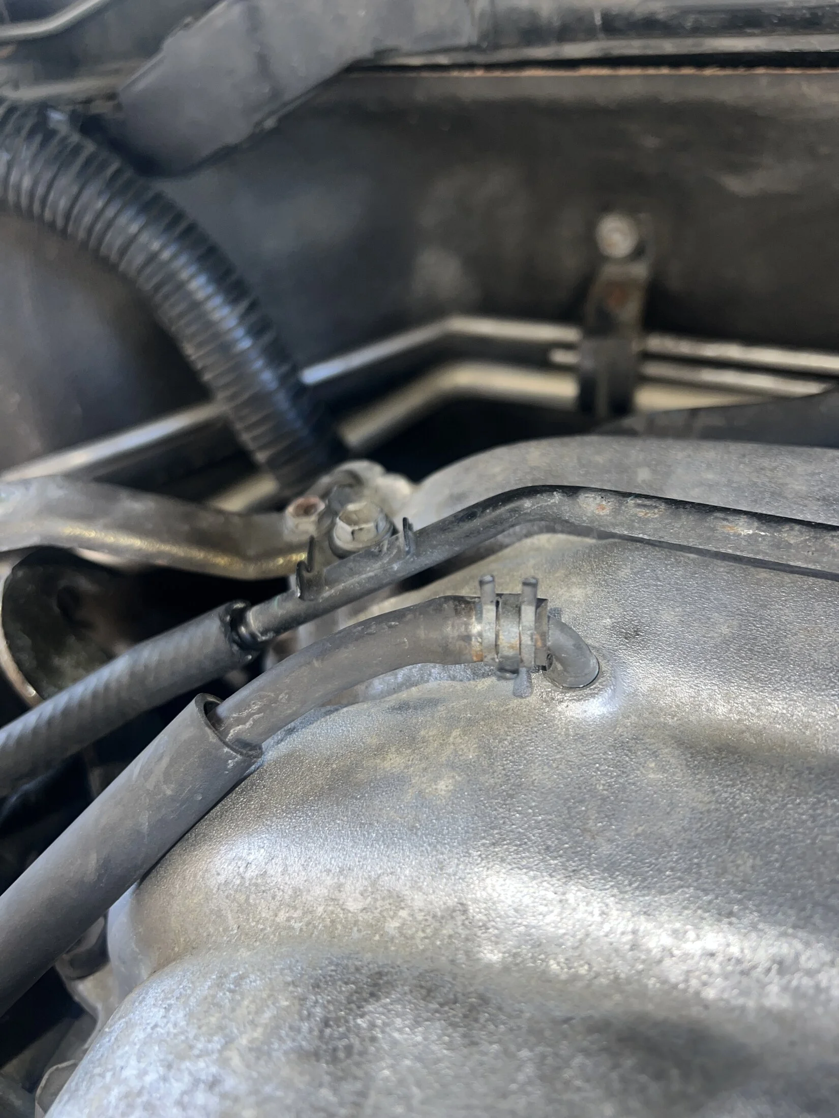

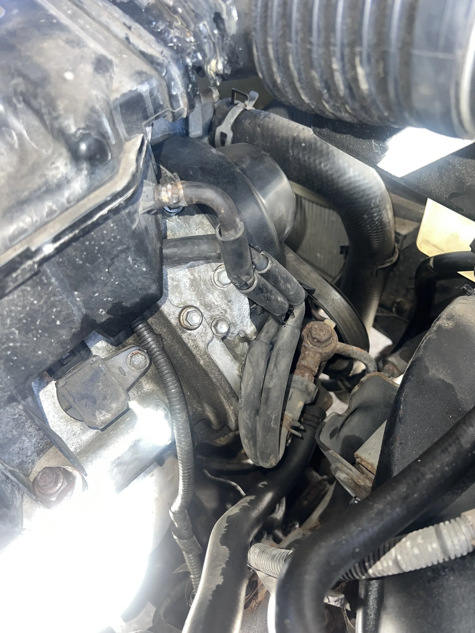

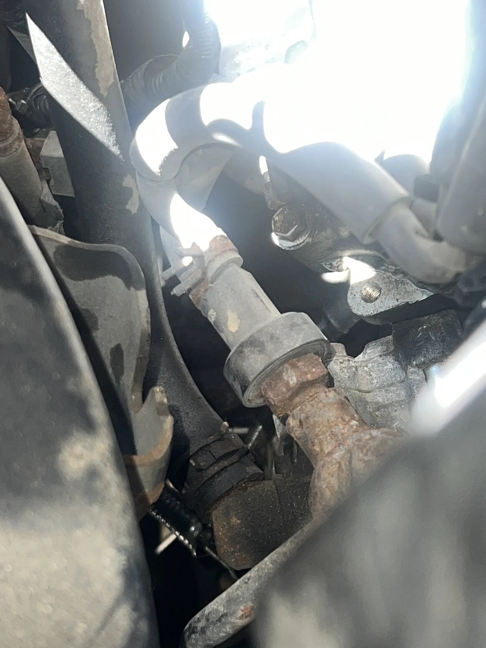

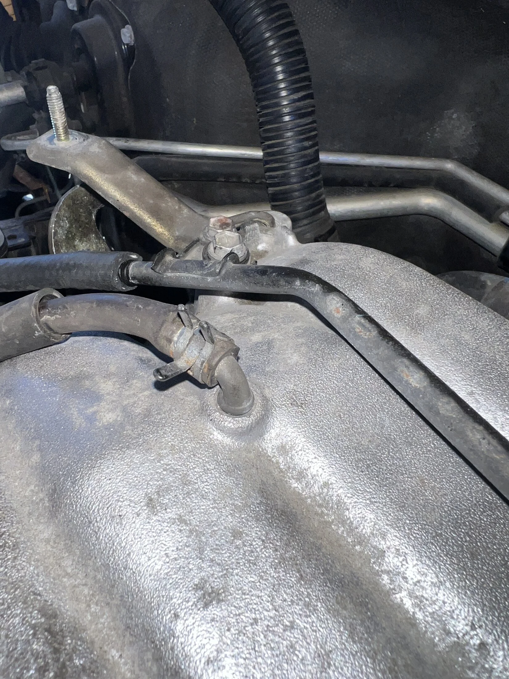

Hoses and connections look pretty decent to me, although the throttle up valve doesn't look great:
