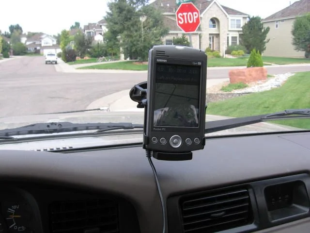

I bought my GPS last Summer and it was well worth it. It paid off on my recent trip to South Dakota during the Fog and when I took an impromptu trip to Mt Rushmore.
I selected the PDA style because of its multiple capabilities. It is a PowerPC with the MS Office suite. It is an MP3 Player. With the wifi SD Mem card it is a wireless Internet computer (Small screen though). It is portable and can fit in my coat pocket. Compared to other GPS units, it's memory is not limited and is dependent on the installed SD card (up to 2GB) now.
The main downfall with the PDA is it is not rugged like a GPS60 or other similar units. But for my use, I did not feel rugged was a requirement. That should not be an issue for off road, but more so hiking.
There have been two things that bugged me about the Garmin M3 GPS PDA. The first is the suction cup mounting on the window. It holds fine for a few days and comes off after a while (Fortunately when the GPS has not been in it). Second, being above the dash, the screen gets blanked out by bright sunlight and is hard to read. No issues at night though.
attachment.php
So I fixed both issues..
Figured out in my drive to Rapid City, that if I held the GPS unit down in front of the CB, I could see the screen with no issues.
First I bought a 1.5 inch wide and 12 inch long bracket from Home Depot. I found it in the lumber section. They call it a Strap Tie.
I then cut it down to a 6 inch long bracket and painted it black.
I disconnected the PDA holder from the Suction portion of the bracket PDA. My bracket has two points were the entire bracket can be broken down. I removed the long screw to separate the suction assembly.
I then glued to bracket base to the 6 inch Strap Tie and placed a C clamp on it until it is fully dry.
Next, shoved the bracket under the CB in the ash tray slot. I put it below so I could see the CB easier and the leverage point favored it being under as the in dash part would push up and have no were to go.
Left the C Clamp on for 36 hours and is holding tight.

Final Product in the daylight.

There are probably some situations that looking down isn't the best. However, in the sunligt, I had to find a paper and shade the GPS at times to read the small info at the top like distance to turn.
No external antenna. I have it setup to WASS and it does take a little longer down lower to acquire the 12 satellites required. I drove around the last two days testing it and had no lock issues after it found all 12. If there was an issue I could limit it to a non WASS (3 satellite) acquisition.
The real test will be in Moab though.
Based on how much distraction I get from my XM radio, which is mounted beneath the ashtray, there is no way in hell I'd put a PDA below line of sight. I'd be slamming into......wood chippers.
Very ingenious though.
The nice thing about the PDA is you can easily slide it out of it's carrier. I don't see me fiddling with it enough to be a distraction. But then . . . .
If it does, I have a second mount I can put on the windsheild for those times I need it in line of sight. It's in about the same position I see people putting their laptop in.
Driving to south Dakota I had real problems seeing some of the display during the day. Rather than a quick look, I had to find paper and cover the unit and spend a lot of time trying to ferret out what I needed. Now, it's just a glance down unless I am going to change some settings.
