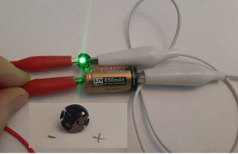

To identify the polarity of the LEDs I used a camera battery and marked the positive side of the bulbs:
The next photos shows which side is positive and which is negative. Use this to save yourself some trial and error as it is quite a pain to constantly take apart the unit:

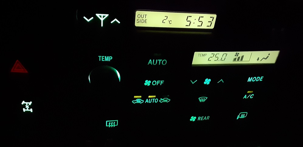

Final result:
The fit of these bulbs was so so - I damaged two bulbs inserting them as they were hard to turn without applying quite a bit of downward pressure. Delivery was quick and I am happy with the brightness so I won't complain too much.
