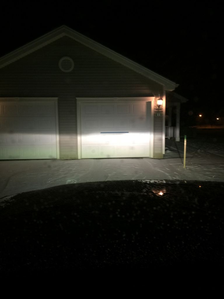

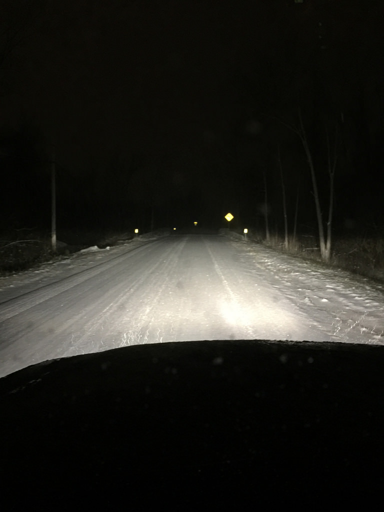

Alright guys I need some ideas for my high beams. So far here are the different options I'm considering:
1. Bi-xenon retrofit into the high beam location. Use the lows as a quad setup and then bixenon as high beam.
2. Run another HID projector and cut the shield out. Use as high beam only. (concern is constant on/off of the HID bulb and burning it up)
3. HID PNP into stock halogen projector (probably won't give me the distance I want)
4. LED bar (spot pattern) to supplement stock high beams (42-50" in front of the first roof rack cross bar)
My low beam retrofit with the Acura TSX projectors and HIDs provide a TON of light currently but I'm really looking to throw light further which makes me think either a bi-xenon or light bar may be my best bets.
I've considered driving lights but I really don't like the look of them on a stock bumper and I don't plan on buying a front bumper in the near future. I may upgrade to driving lights when I do get a bumper though.
Any ideas/thoughts/suggestions? I'm open to ideas
