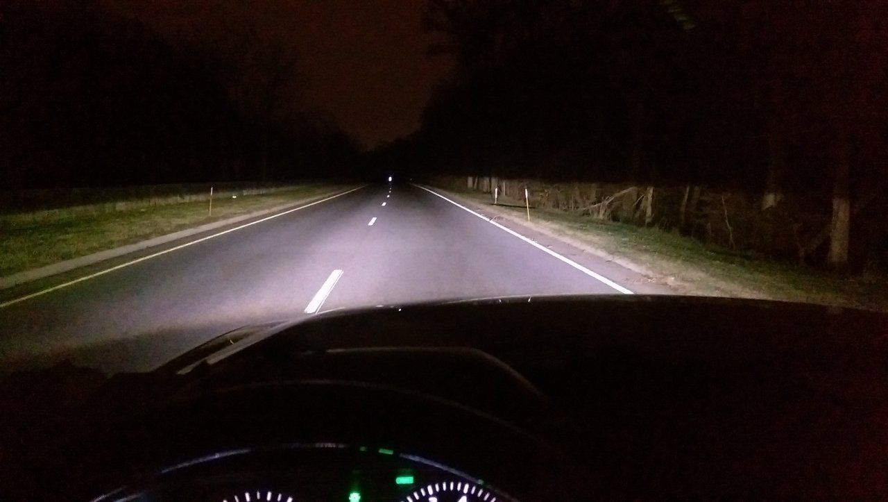

That's why I did a total retrofit. I use OEM projectors instead of aftermarket. Excellent wide 7-8 lane output with razor sharp cutoff. No blinding oncoming traffic. Less strain on my eyes @ night & the rain doesn't wash away my light output compared to aftermarket hid kits. Here's a pic
Looks great
What projector did you use?
Do you have a Link to your setup in the event my cheap solution is not good enough?
I use OEM SC430 projectors with CBI 5500K bulbs & tsx-r clear lens. I've built a thread on here about my work called : LX470 retrofitted with SC430 projectors. Awesome results.

Well, I did my retrofit twice to my vehicle. I gotten tired of buying standard or long life H1 halogen bulbs. My driverside wires kept overheating and burning my bulb out. For some reason I measured the voltage & was getting 16v. Bulbs are 12v. So I decided to go with the morimoto H1 4300K hid kit with the tsx-r clear lens. Used that setup for 3yrs. Output was way better than OEM. Just that the light would get lost when it rains. Gotten tired of buying bulbs to get me as close to OEM as possible. Finally I caught a seller selling SC430 projectors with CBI bulbs @ a deal I couldn't refuse. All I can tell y'all is I won't have to touch this setup for yrs because the bulbs, OEM ballast were new. Now I look OEM & easily light up 8 lanes with razor sharp cutoff. No blinding oncoming traffic

Just know the LX has 2 small holes that's inside both projectors. Output will increase. Sidenote: use double-sided tape to mount your ballast inside the fender behind the turn signal light. Then fish your wires thru the hole on the side and just hook up the kit. 35 - 40min job
Thanks for the tips but Im confused, what do you mean by Just know the LX has 2 small holes that's inside both projectors. Output will increase.
I was actually doing something when I read your message. Actually the factory headlights has 2 little holes inside each projectors. Don't know what the output of the aftermarket headlights. I'm waiting on your pics to get a first hand look. My 1st retrofit I opened my headlights up & covered the 2 holes on both projectors with foil tape. Then installed a clear tsx-r lens. This how it looked then.
