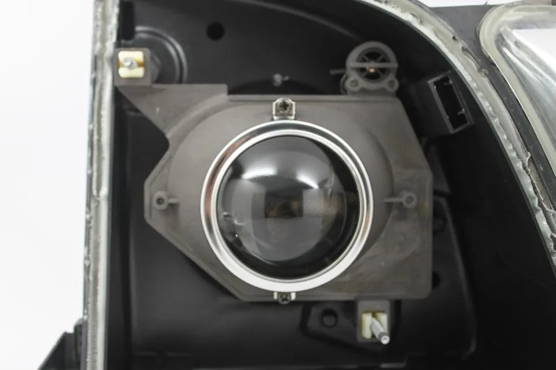

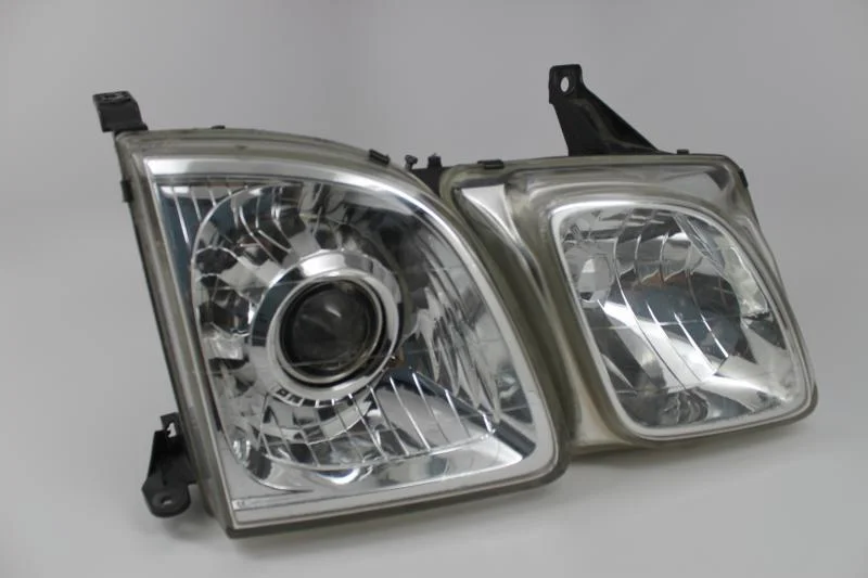

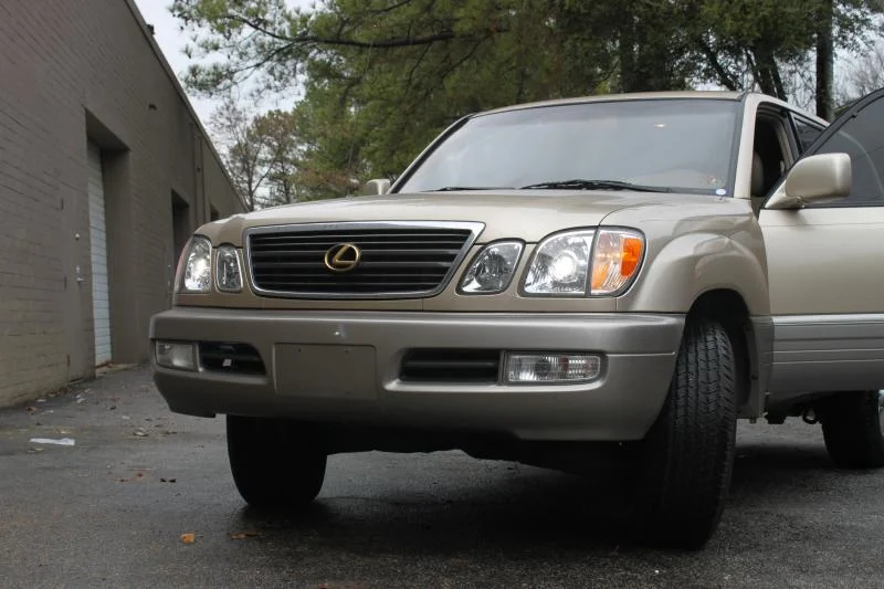

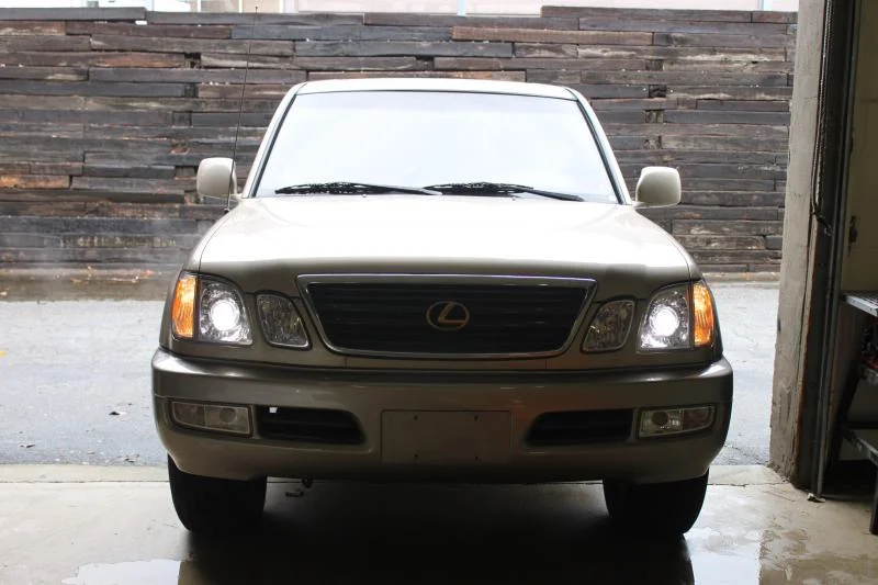

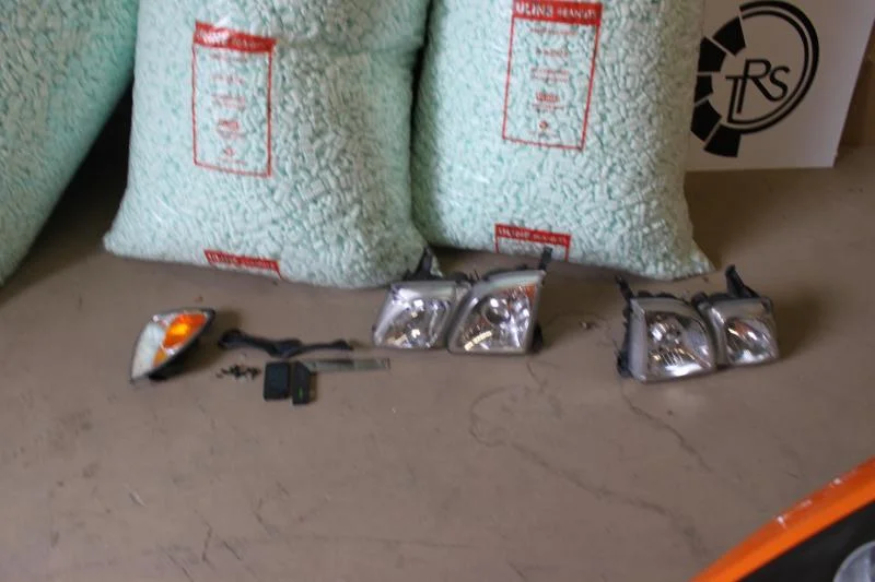

So what? Well, the S2K with a clear lens swap is one of the best OEM HID projectors available on the market (if you can find them). The LX470 could possibly have a projector that offers a near perfect cutoff and beam pattern with the correct lens. I picked up the LX470 today and took it into the shop where removed the headlights to perform a lens swap with a TSX-R lens and a 35W Morimoto 5K HID kit. All went well. Here are some photo's of the process, I would highly recommend this to anybody who is considering adding HID's to there LX470. It's night and day difference. I drove the truck in the evening but have not gotten a chance to see it on a dark road. I am hoping the owner of the vehicle can chime in since he took the keys from me after we talked cruisers for a hour.
1: Stock
2: Both headlights waiting for baking (275*F for 8 minutes. Remove all clips and lens retainers.
3: Lens off with shroud and projector lens exposed.

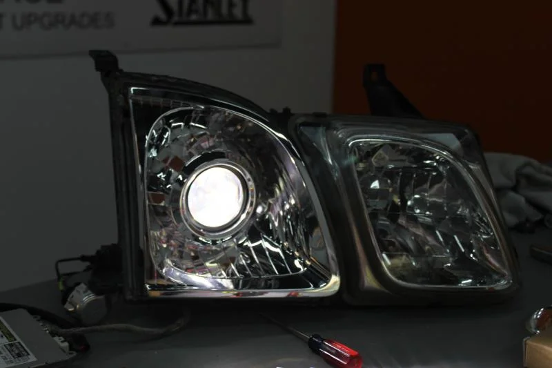

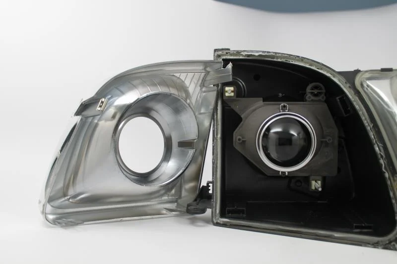

Next up was removing the stock shroud (2 clips and 2 guides. Pretty simple). After that I took it over to my desk and started doing some testing with spacers and different lens's to achieve the best beam pattern and output. I found that 2 bulb spacers and a TSX-R clear lens provided the sharpest cutoff, with best beam pattern. Here are a few photos of the projector and testing/tuning.
1: Shroud off
2: LX470 projector (stock lens)
3: Backside of the shroud (you can see clips and locations here)
Some of testing.

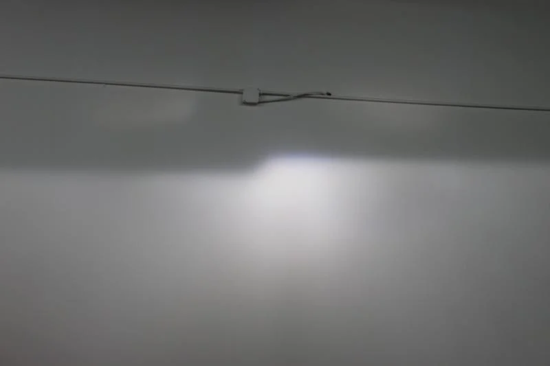

1: Stock fresnel lens with Phillips 4300K H1
2: Blocking the "squirrel finders" with foil tape (placed on lens side of shield to avoid direct heat from HID bulb)

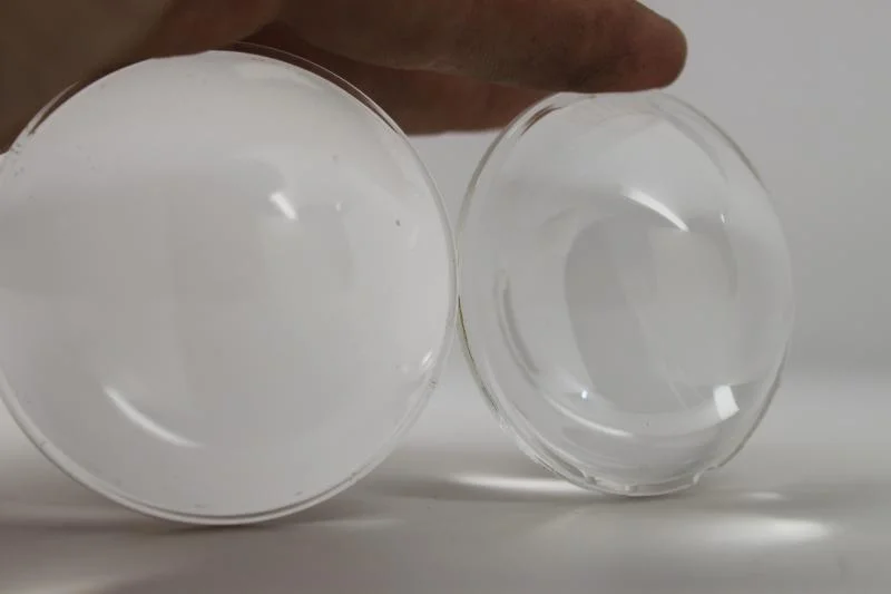

3: Stock lens vs TSX-R Clear Lens (hard to see, but the TSX-R is much clearer than the stock LX lens)

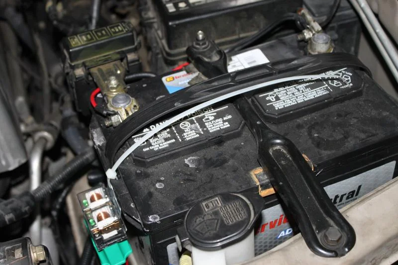

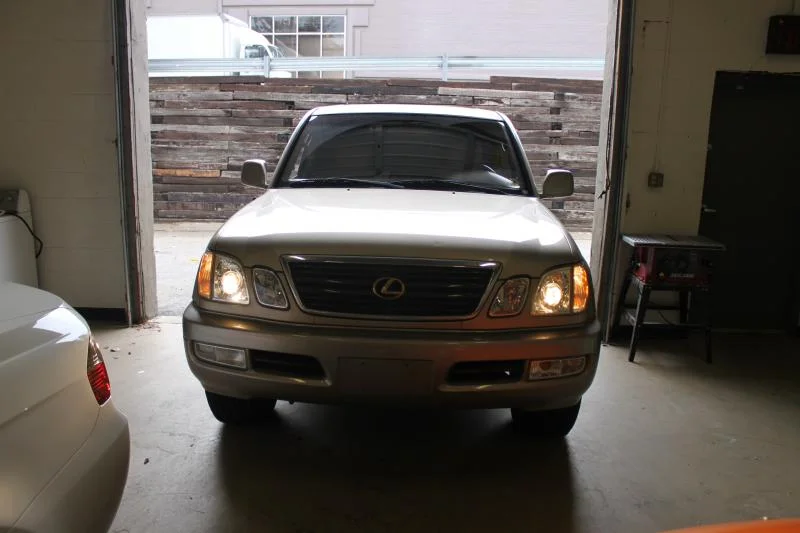

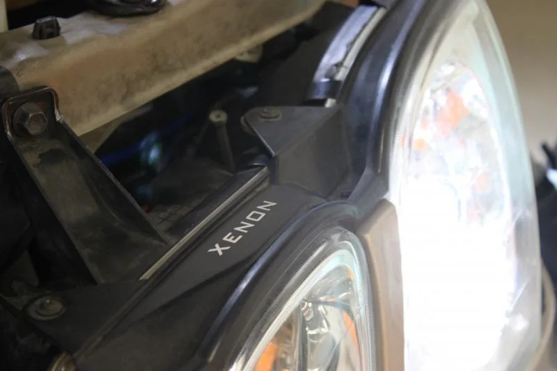

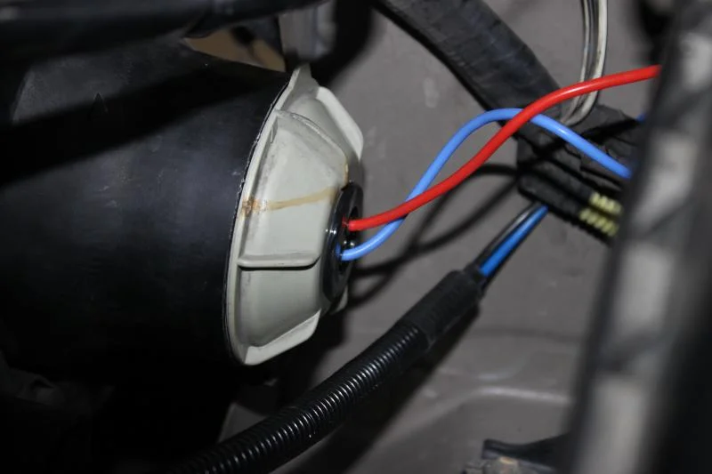

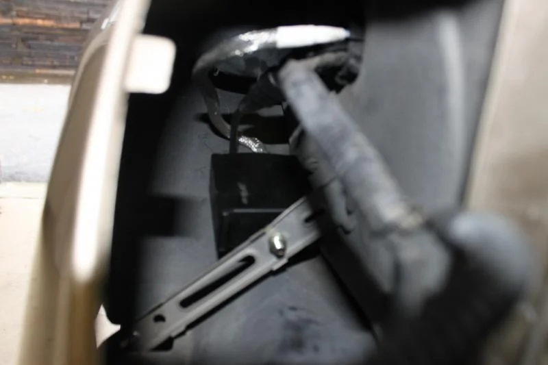

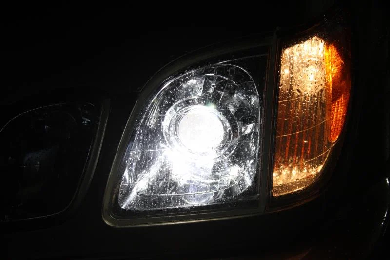

headlights reassembled with a nifty Xenon sticker for kicks. I mounted the ballasts in the fenders, nice and secure. Ran the harness through the fender and converted the LX's incredibly strange low beam H1 connectors to a 9006. Also, I drilled a 7/8's " hole in the LX headlight cap and ran the wires through the grommet I fitted. Retains water tight seal and stock look (besides the colors).

Very nice work!
Without sounding like a cliche, I can tell you that its a night and day difference between the old setup and the new one.
There is a small stretch of dark winding road that goes into my neighborhood and it was there that I could see the real difference. Sharp beam and the reach. Pictures don't do justice. If you are on the fence for getting this, I would strongly recommend it.
It was fun talking to Nick and I am so very happy with the final outcome of this conversion. The icing on the cake: I got to drive the bad ass truck that he has.:cheers:

Yes, you can replace the lens. I believe some 100's came factory with HID high beams. Can you see the ballast? Should be mounted on the underside of the headlight.
FYI- there are internal ballast mounts on US spec LX's.
Where are the internal ballast mounts ? I've never noticed them...
I don't know much about optics but I would think the TSX-R lens would've been designed for a certain focal length. Unless they were designed for the exact same length as the OEM halogen projectors, wouldn't the results be less than optimal?
They are on the bottom of the housings. There are 3 bolt locations that we never drilled out to mount a ballast.
The OEM lens required 1MM spacing. The TSX-R requires 2MM spacing for proper focal length and a rubber gasket between the lens and lens retainer. If I were to do this again I could do both headlights in under an hour. It's a very simple modification...then again I do this 5 days a week so lens swaps are :meh:
