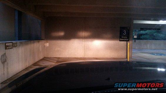

Thought I would share this quick upgrade to the low beams. I bought this 1999 LX a couple months ago and have been disappointed with the low beam headlight output. The high beams are fine, but the lows suck. I have terrible night vision so I needed a quick upgrade. I did a lot of research and went with the Philips Xtreme Vision.
I installed one Xtreme in the Pass side headlight for comparison and took pics from different distances. It is a def improvement.
2 Car lengths:
Four car lengths:
hey any idea what those 4 orbs are?
i bought a used 2000 off someone who did a HID retrofit and im having the same thing, it's pretty annoying and im trying to figure out how to fix it.
They're referenced as "squirrel finders" here on mud the most, and were used to help disperse the factory halogen light better. Pretty annoying once you put an HID bulb in. Many people cover them up or just do a complete retrofit. Everything you need to know about upgrading LX lights: LX Headlight Upgrade Database
