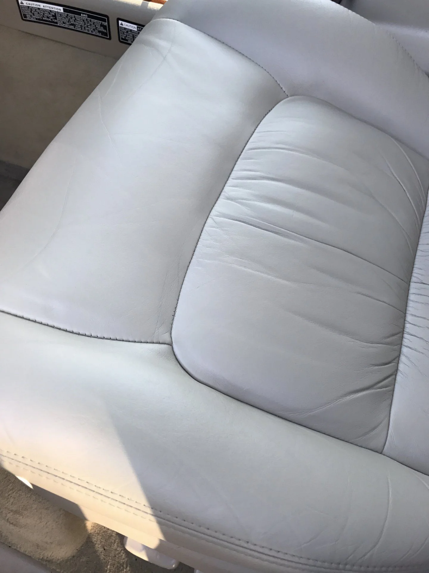

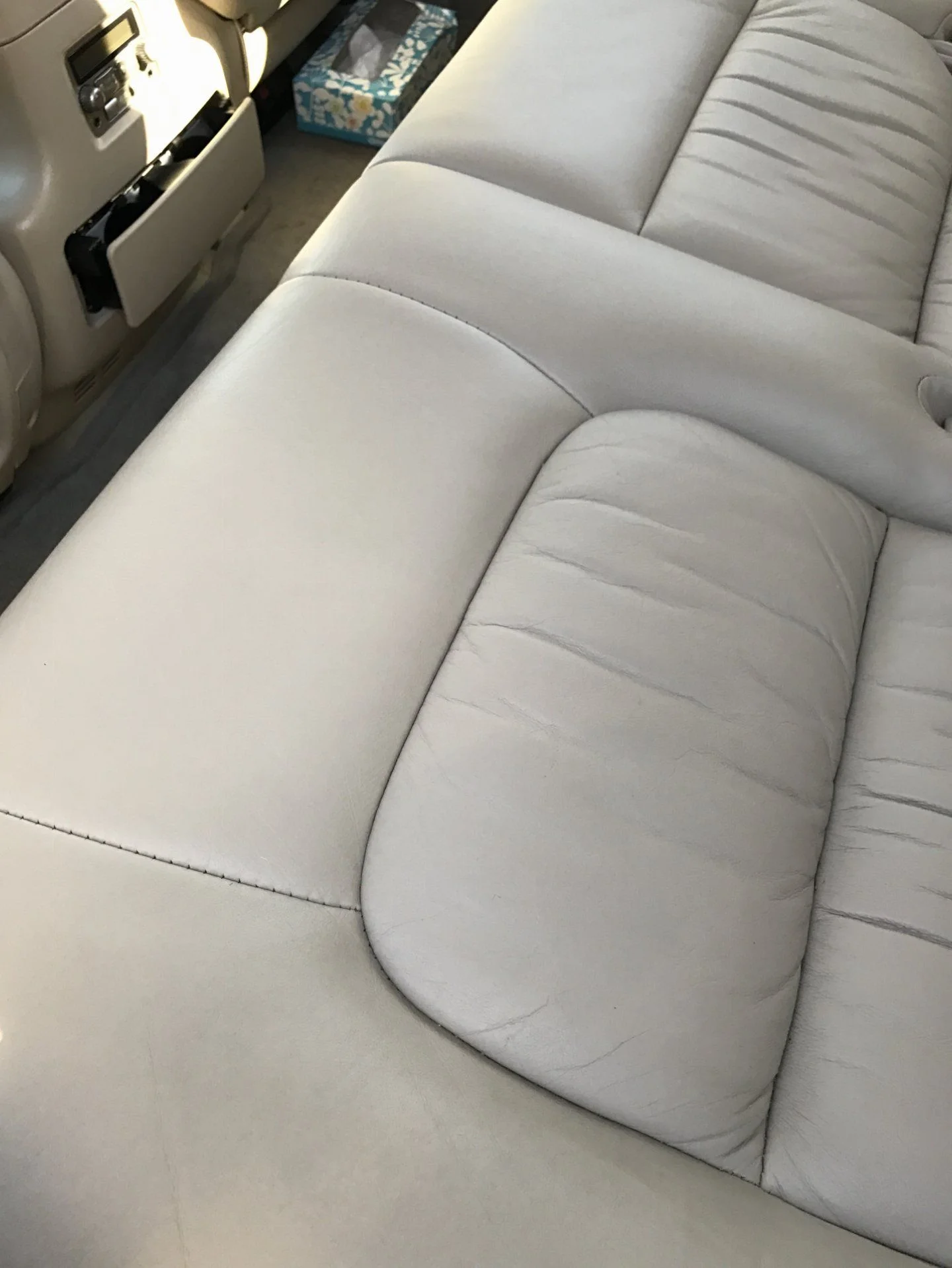

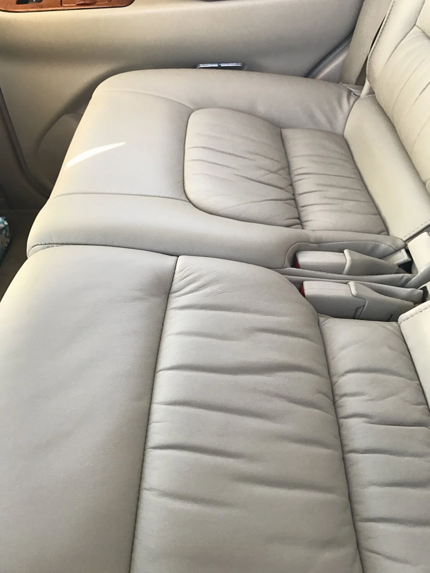

We have a leather specialist at work who cleans, dyes and repairs leather for our Pre-Owned cars and service clients. As clean as my truck was when I bought it the fronts seats were a little dirty and the fronts passenger seat had a small area that look like something had spilled on the seat left a light stain. One hour later he dropped off my truck and here's the results two front seats were re-dyed backseat was steam cleaned only.

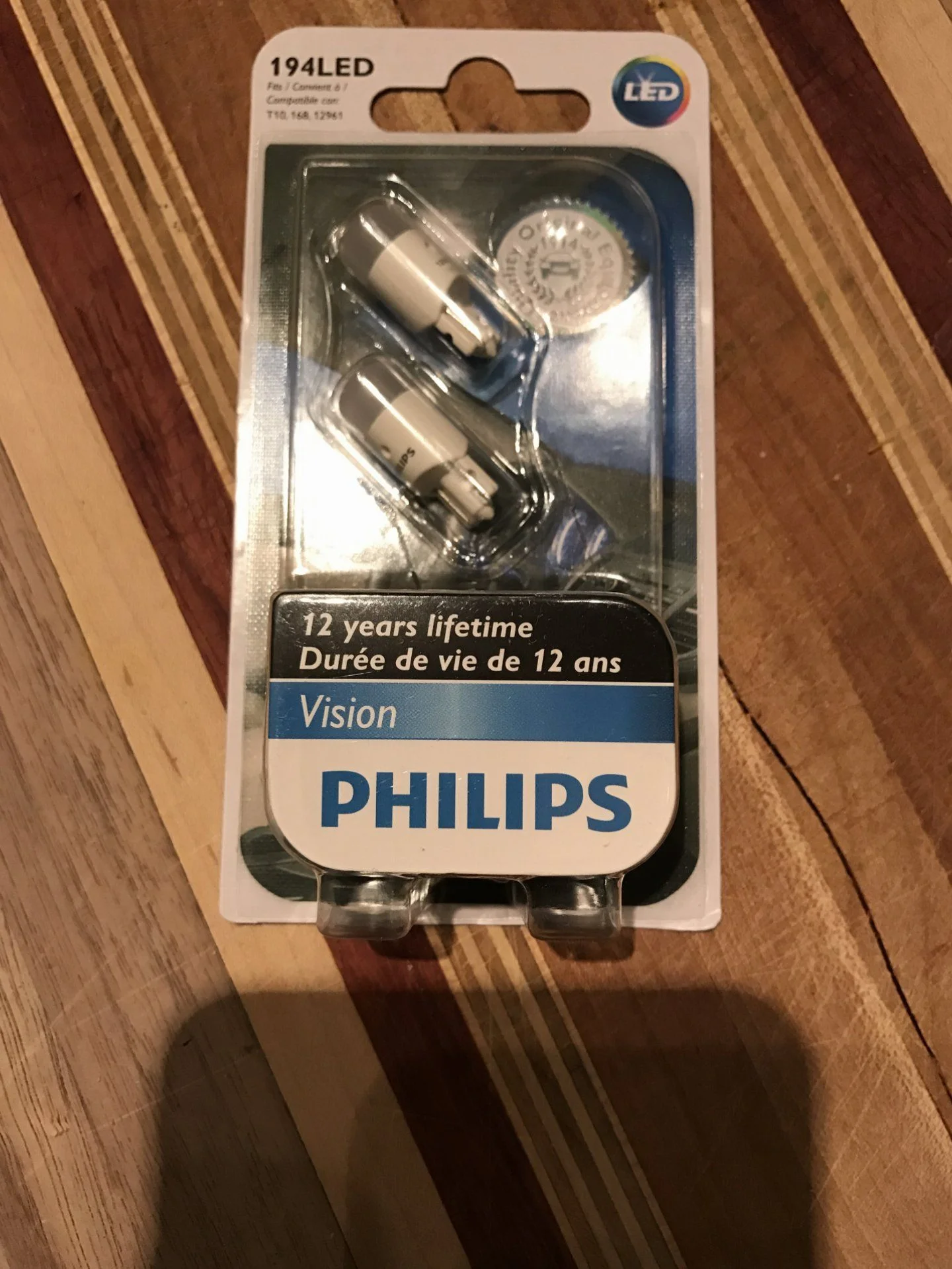

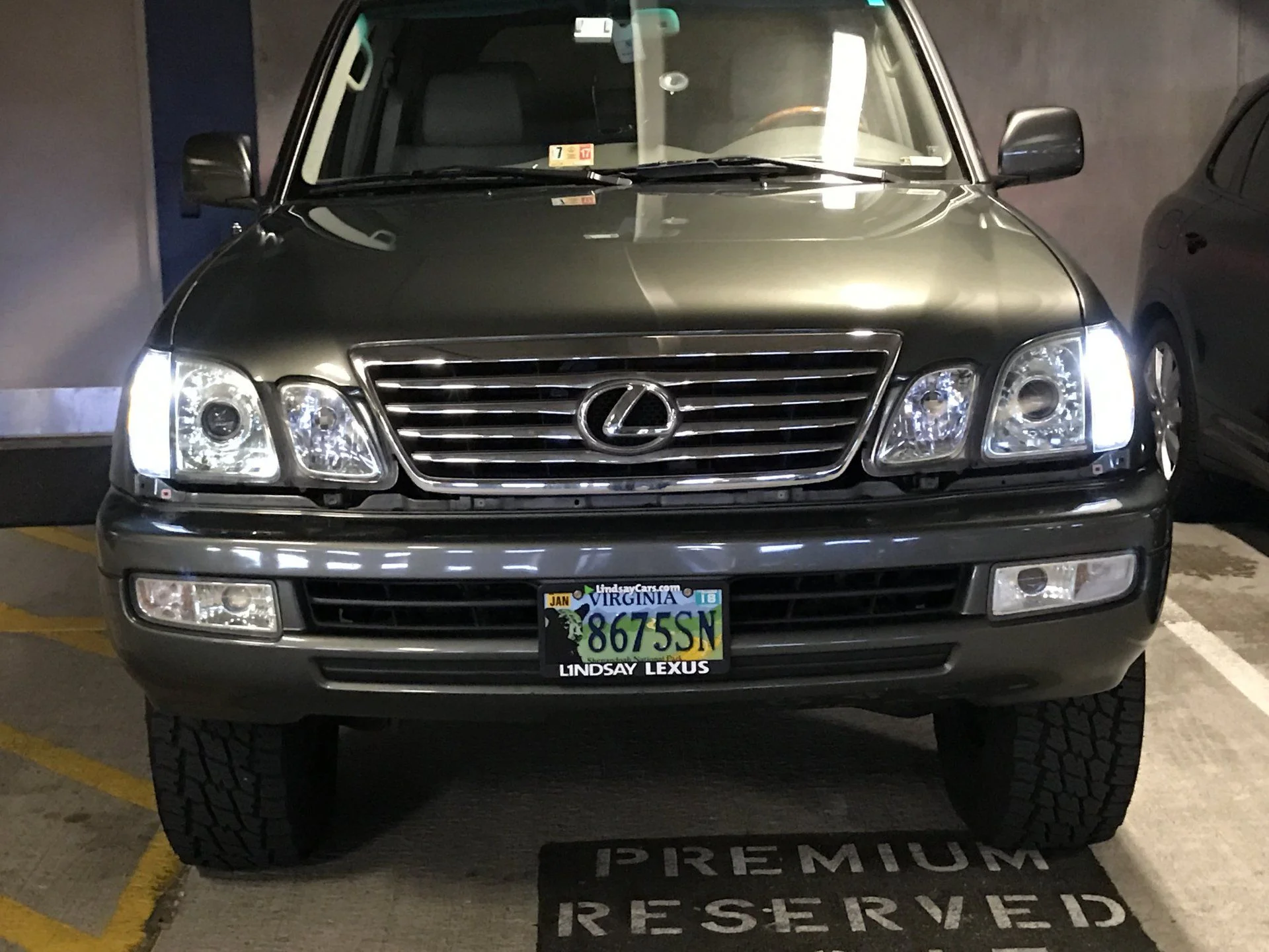

The HID retrofit headlights are completed and should be installed tomorrow and since all the lights up front will be white I swapped out my side marker lights to LED. I purchased the JDMaster and the Philips
The JDM is on the left and is bighter then the halogen headlights... the Philips is toned down and looks great. Pretty nice $15.00 upgrade

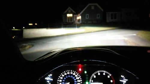

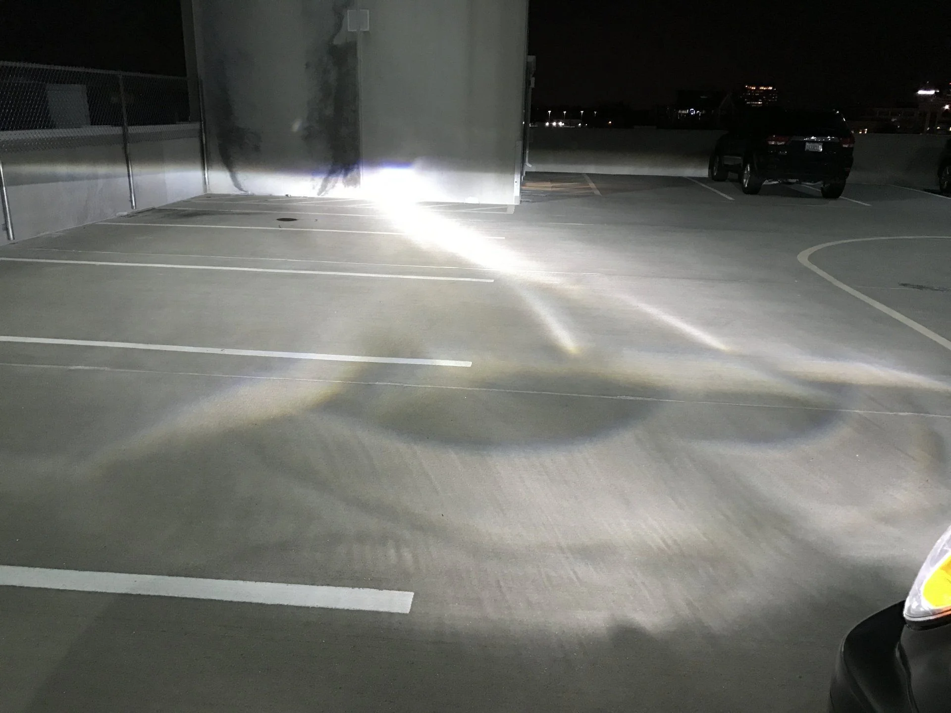

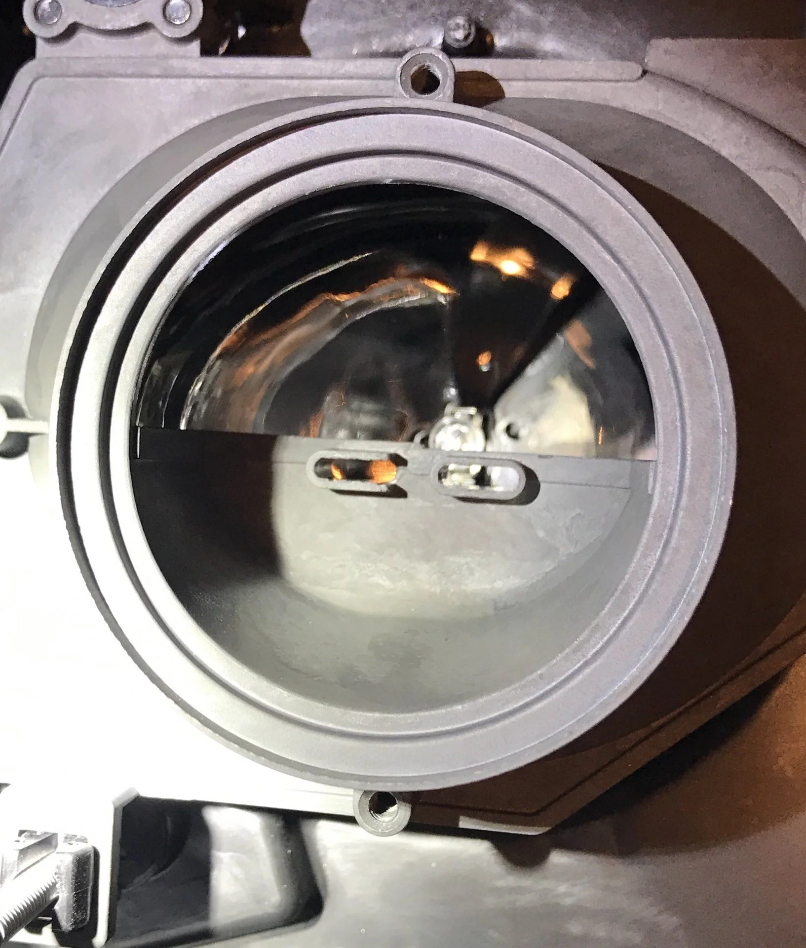

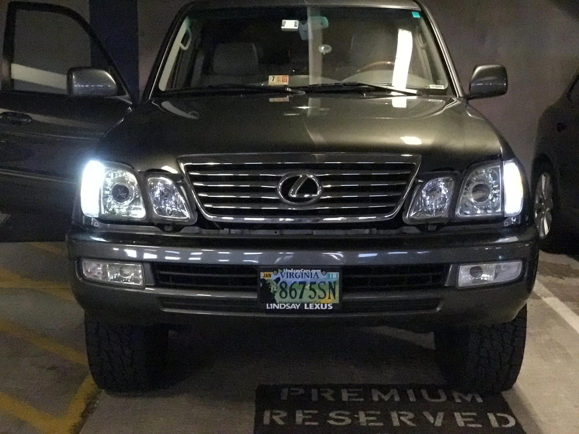

So I got the lights installed but they are coming out . The light throw is splotchy....talking to Charles who did SC430 projectors...he thinks i need to grind down the squirrel holes flush...i simply covered them with JB weld and I also noticed finger prints on the lens which is also contributing to the splotchy light that you can see in the first picture vs my 80 in the 2nd and Charles LX with SC430 projectors.. Something is up with those holes and I'm determined to figuring it out

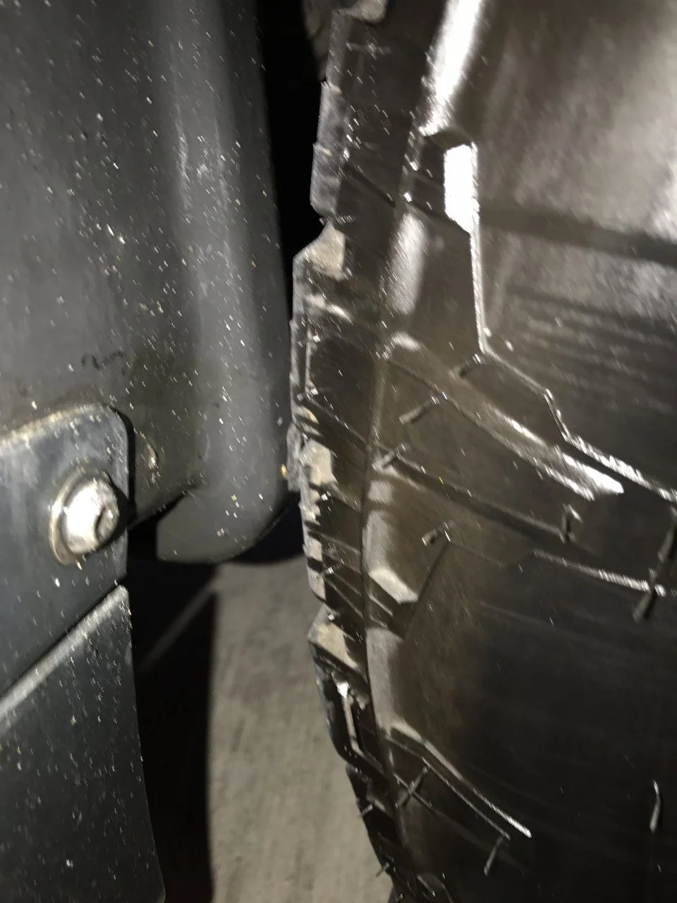

I called a fellow Mudder who's local to me regarding tire size for my LX because he has a 100 series and 80 series. I asked him specifically about 295 70/18 tires and to my surprise he had 5 Nitto Terra Grappler G2 with 4000 miles on them sitting in his basement that he was to selling... mounted and balanced today and will have to breakout the heat gun as they just touch while turning

I noticed you're running spacers? if you are still rubbing the area in the photo below, which is plastic. Simply heat it up really good and flatten it a bit and you'll get clearance

awesome, Ill give it a go. If your ever down in Hampton Roads, Let me know!

This a pic of my 1st retrofit with the squirrel holes grinded down before I retrofitted with SC430 projectors. This the output you'll get. The light more evenly distributed. The hole leaves shadows & + the hid bulb is closer to the projector.

I hope you understand that the Mini D2s 4.0 is a 3" projector and our stock LXs have a 2.5" projector. Meaning you will need to modify the shroud to get that projector to fit.
I have created a LX headlight upgrade database in the FAQs that lists all current retrofits for the LX. Me and many others went with the TSX projector because it has proven output and is a very simple retrofit. It also could have shown you that the HID retrofit into the stock setup was less than adequate.
