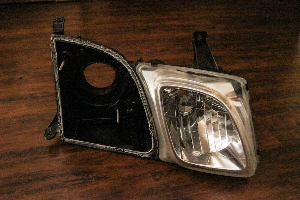

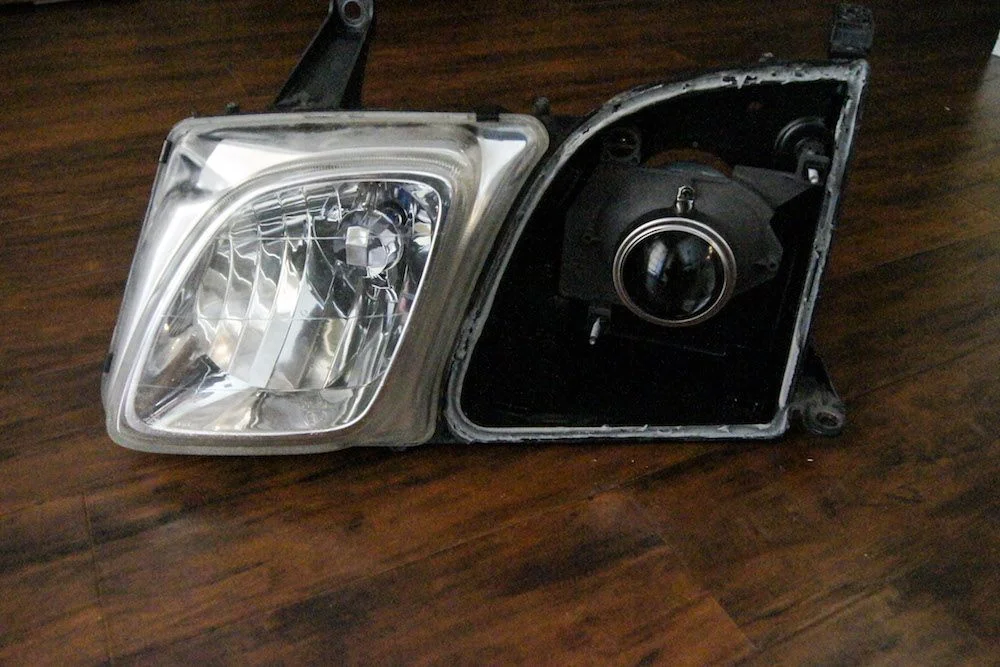

Performed a retrofit for @Wte2006 on Sunday. He drove up from Texas and I performed the retro in one day - my fastest turnaround Ive ever had on a set. Record breaking, but it won't happen again lol. Needless to say, I was great meeting ya B and I hope the lights serve you well. I snapped a couple photos during teardown, but due to time constraints I wasn't focused enough on getting more. Hopefully he can post up some final install shots and output shots sometime.
full
full
I couldn't be happier with the install. Conservatively, the light output & beam dispersion are at least 30% greater. Dawg, it was great to meet you as well, & it was a really long day;)
