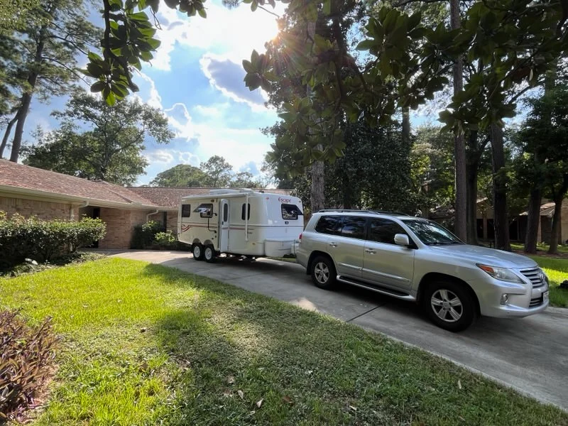

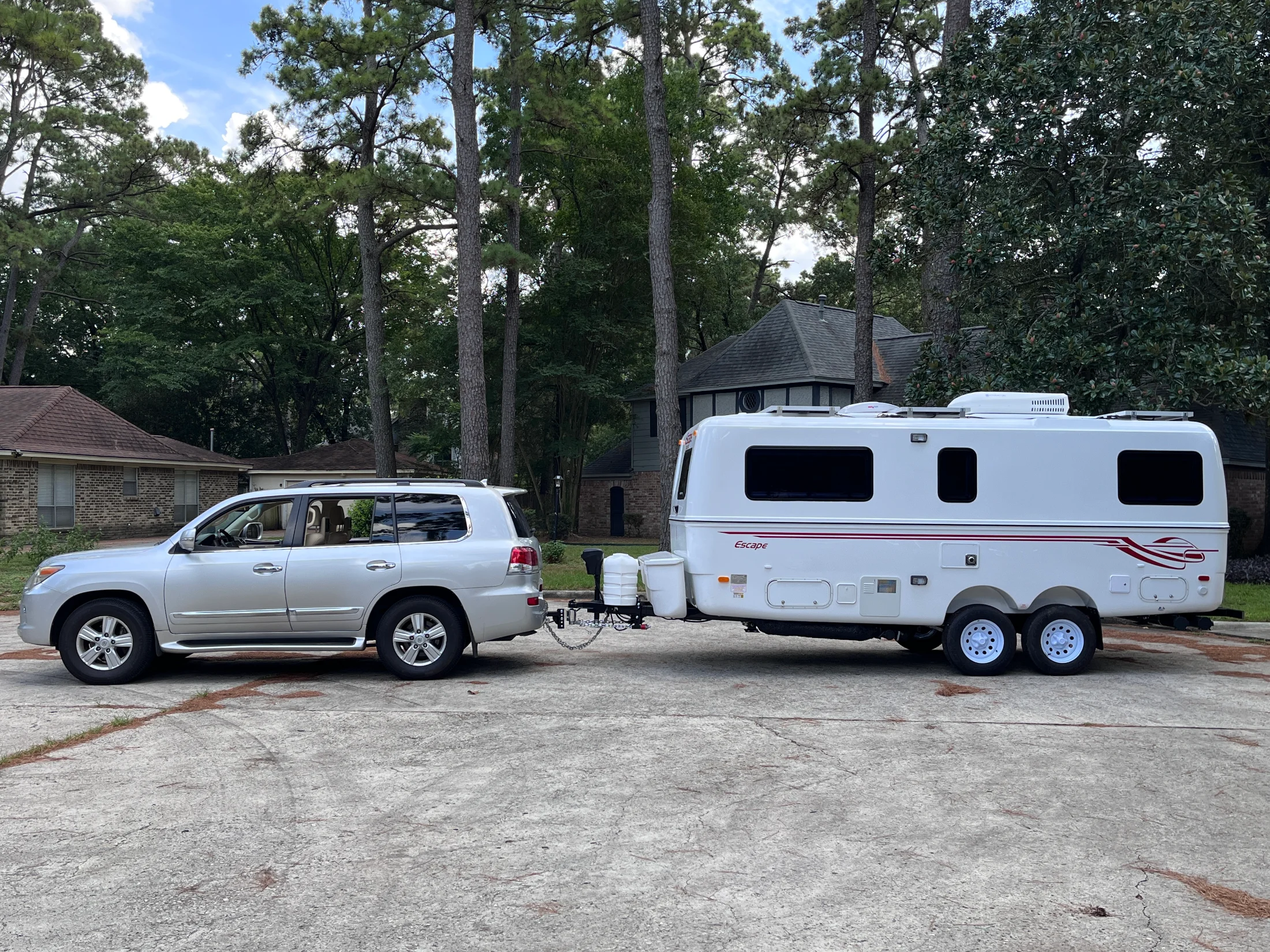

Our Escape 21C was delivered from Canada a few weeks ago! I'd appreciate feedback on how the trailer sits and how the WDH is setup. This is with the AHC in Neutral. The cul-de-sac has a bit of a peak in elevation where the hitch is, so there is a tiny bit of slope to both the trailer and LX. The trailer has a 3 inch lift.
Tires are Michelin Defender LTX M/S 2 285/65 R18 XL.
Any thoughts on tire pressure loaded up? I'm anticipating a 600 lb tongue weight (5,000 lb trailer GVWR) and maxing the LX's payload (1,200 lbs or so). Normal RCTP from @gaijin is 34 psi. I tried 40 psi and it felt a bit bouncy/stiff so was thinking either stick with 34 or try 37-38.
Thanks!

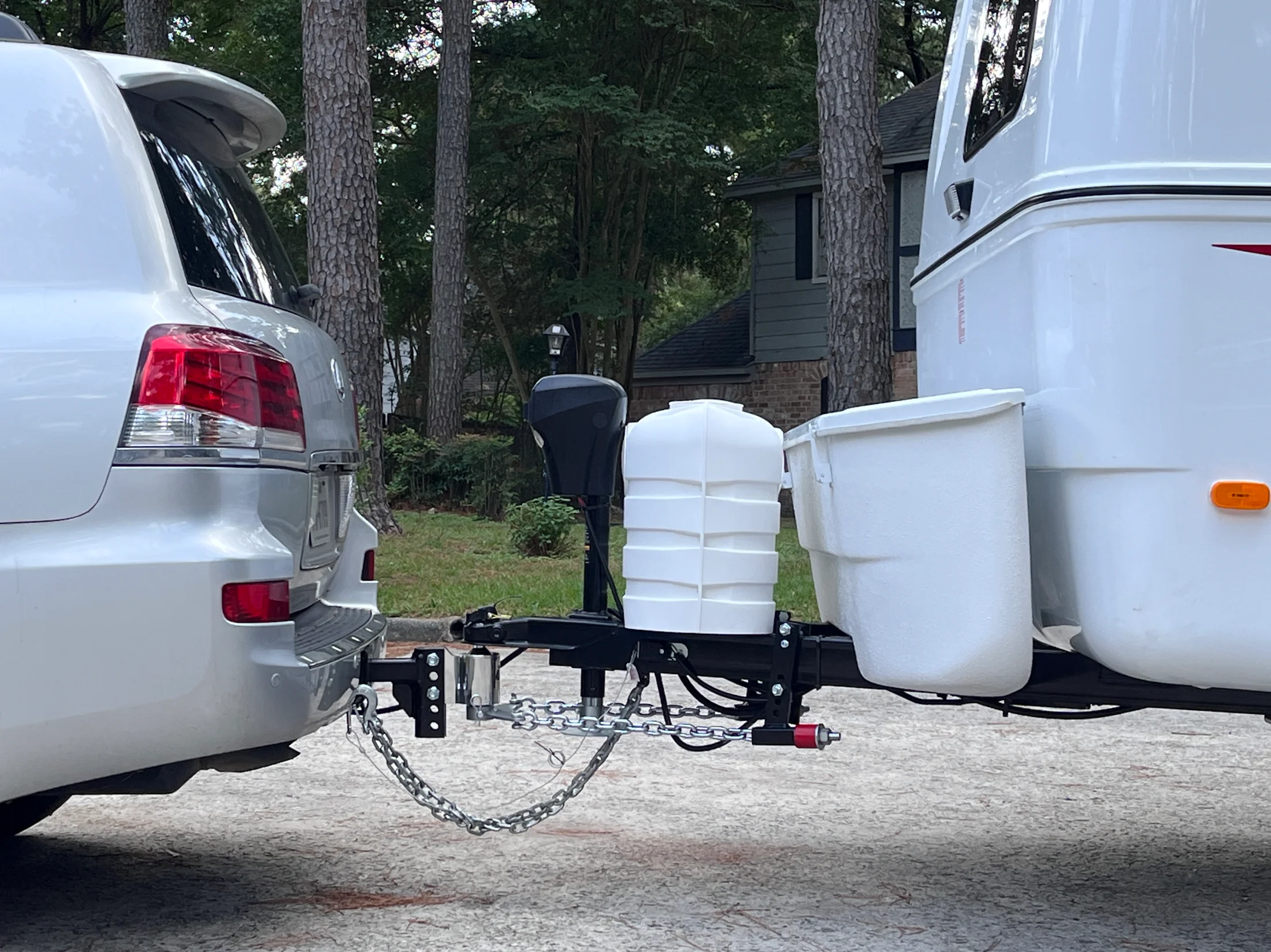

You're good to go. Great looking setup btw and I'm always excited to see Escapes as they're great robust all season campers.
Yes, I would raise tire pressure on the rear axle. For more stability, better tire life, and MPG. 37-38 sounds perfect.
Couple minor things if you're looking to optimize
1. Breakaway chain hooks should be latched with open end facing backwards. Said another way, hook from below upwards. This is regarded as the safer / more secure orientation
2. Completely optional for this weight of trailer, but if you find you want more stability into high speed and less porpoising, you can cut the hitch stinger so it sits deeper in the receiver. This will bring the ball closer to the bumper to give less leverage to the trailer (and more control from the tow vehicle). Even 1-2" can make a pretty big difference.

Thanks a lot. I was planning on moving the ball closer, though i wasn't sure if 1 inch would really matter...
I didn't know that about the hooks! I know to cross them but not the direction of clipping them on. Thanks.

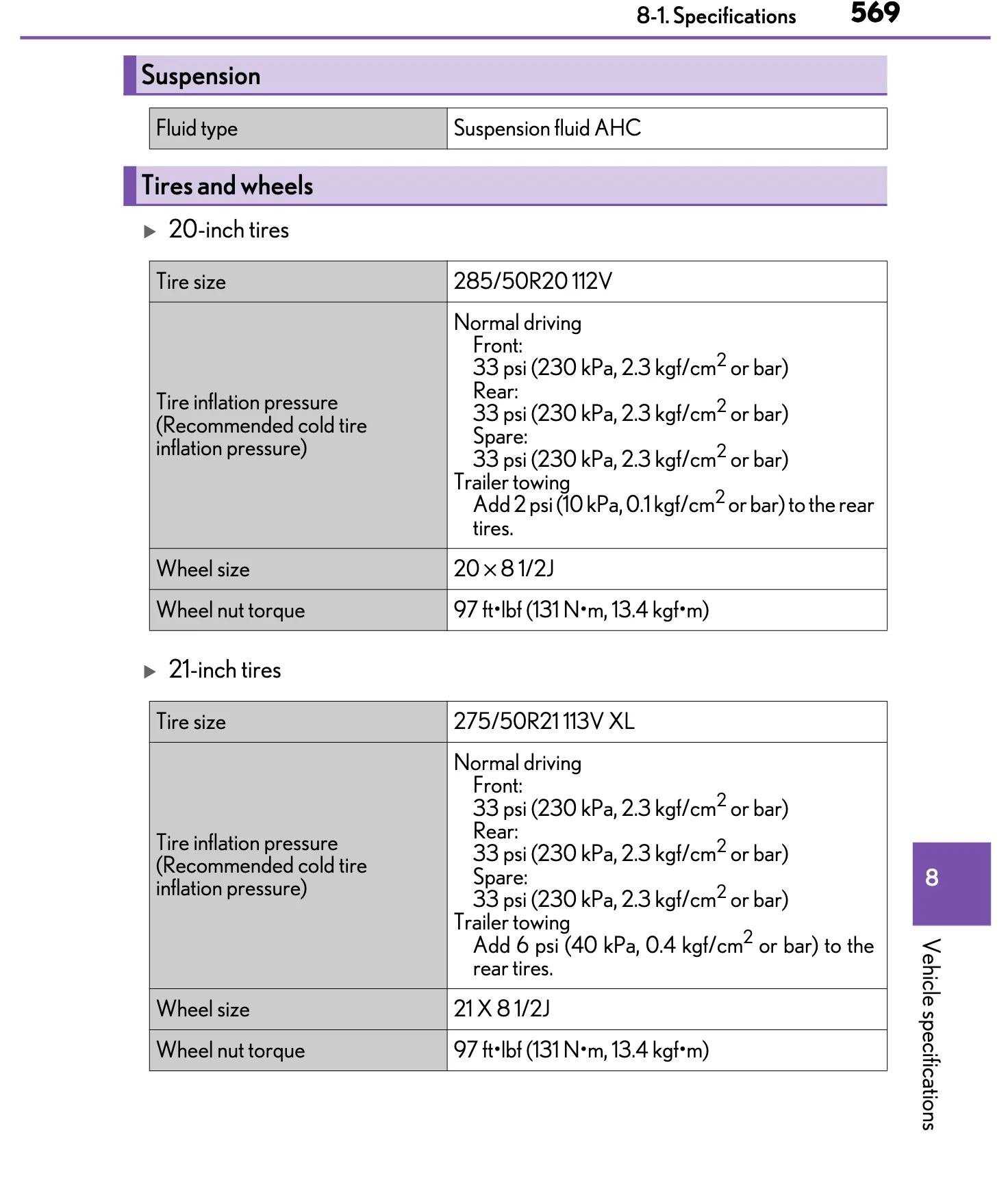

Thanks!
Obviously, you're on 18" wheels but a bump of a couple PSI should feel good for towing.

I agree with @smeagol that you do not have enough WD tension. On any WD hitch, there's significant tension necessary for it to do it's job of transferring hundreds of pounds across the length of the car. On the Anderson, there will be more tension still because of its horizontal tensioned architecture.
There isn't a thread count to shoot for as every setup will be different. I remember i had 7 threads showing on my previous setup.
Go up 2-3 more threads. If it's working, go one more still, and one more again, until you find diminishing returns as you can always back off easily enough.
To hitch, you should be in AHC High and/or use the tongue jack to lift the ball up higher than ride height. At that point, you should tension the chains to be rather tight. Then lower AHC to Normal and/or full retract the tongue jack. There should be no slack and significant tension in the weight distribution chains.
The red bushings should show some good compression/bulge (image from Andersen's media).
AHC should not be a compromise with bounce unless there is a mechanical issue.. Static suspensions aren't a band aid either for not enough WD tension, as there you'll be dealing with the same seesaw, but with more squat, and a less comfortable ride.
Depending on your tongue weight, it is wholly possible the Andersen doesn't provide sufficient weight transfer. Without that, the rig works as a seesaw about the rear axle. You need enough weight transfer to the front axle to get out of this seesaw equilibrium where it can't decide which way to take a set hence the bounce.
As mentioned earlier, you might want to modify the drop hitch to bring the ball in closer. As that gives the tow vehicle more leverage (weight on one side of the seesaw), requiring less WD tension for it to find its happy place.
Maybe take a picture of your tensioned setup at ride height, particularly of the red bushing. What is its free length versus tensioned length?

Thanks for the information and advice. Pretty sure we were not tight enough. I also now understand that you should be measuring the drop in the height across all wheels once hooked up and tightened to confirm how weight is distributing.
To confirm distribution is ideal and thus tightness is ideal, my plan is to:
1. Set AHC to Neutral and measure ground to fender (tape a mark) to document normal height
2. Turn OFF AHC
3. Hook it up, tighten it, and measure reduction in height across all tires
4. Modify tightness if not balanced front to back
5. Turn on AHC and confirm AHC re-levels to Step 1 heights (the system should do this when turning back on, correct?)
I also think our ball could be dropped one setting/level, so I'm going to measure tongue height at various points and confirm we are getting the trailer as level as possible. We will probably keep to 65 mph most of the time, so I'm going to focus on level without the additional AHC drop at 66 mph. Although traveling at 65 mph is kind of a PITA with AHC b/c inevitably I'm hitting 66 mph so AHC is raising/lowering frequently. Not really ideal... So I'm debating sticking to 67-70 mph vs 65 mph... That's something we can always adjust later though - i want to first deal with the bounciness and then we can adjust based on speed preferences.
