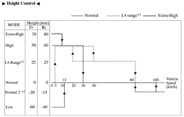

For AHC at speed, it lowers at 100 km/h (62mph), but it won't raise again until speed goes below 80 km/h (50 mph).

I swear my AHC is lowering at 66-67 mph but you're right that is should be 62 mph. I'll double check next time I'm on the highway. BTW - I've remade that graphic for MPH and to include tire size. Going to post it on here at some point...

I'm confused about the speed... My tires are around an inch greater diameter than stock - not much difference. So the vehicle moves faster than the speedometer shows but Google Maps is generally pretty close, maybe 1-2 mph. The AHC should be based on the speedometer, so shouldn't it lower when the speedometer shows 62 mph instead of 66-67 mph??
@TeCKis300 I confirmed that the AHC drops at 66-67 mph (as shown on the speedometer). Even with my 275/65R18 tires, shouldn't it still drop at 62 mph per the speedometer?

We definitely didn't have the WDH tightened enough! It was practically NOT tightened. We had 4-5 threads and have since tightened to 8 threads. It is MUCH better. We may also drop the ball one hole (an inch or so) and see if that improves things since it points up a bit. Going to measure the vertical drop to level and compare it to 0.6 inch drop in AHC at 62 mph. We also weighed it with the tanks partially full and were around 4,500 lbs. So the trailer weight is right where I expected. Total payload is around max, also as expected. So that's all good. Unfortunately I didn't have a tongue scale but will also confirm our tongue % is reasonable (should be).

IIRC, the speedo is optimistic. Even as internally, the CANBUS reported speed is accurate.
