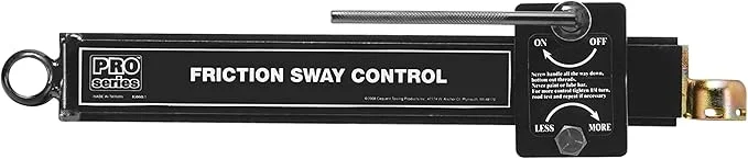

I always recommend an anti-sway device and a proper brake controller too.

Thanks. I like the idea of a combined WDH and anti-sway device.
I just added one of these on, but there are many options out there. The Anderson hitch has anti-sway functionality "built in" apparently, but again, I should mention that I've got no experience with it.

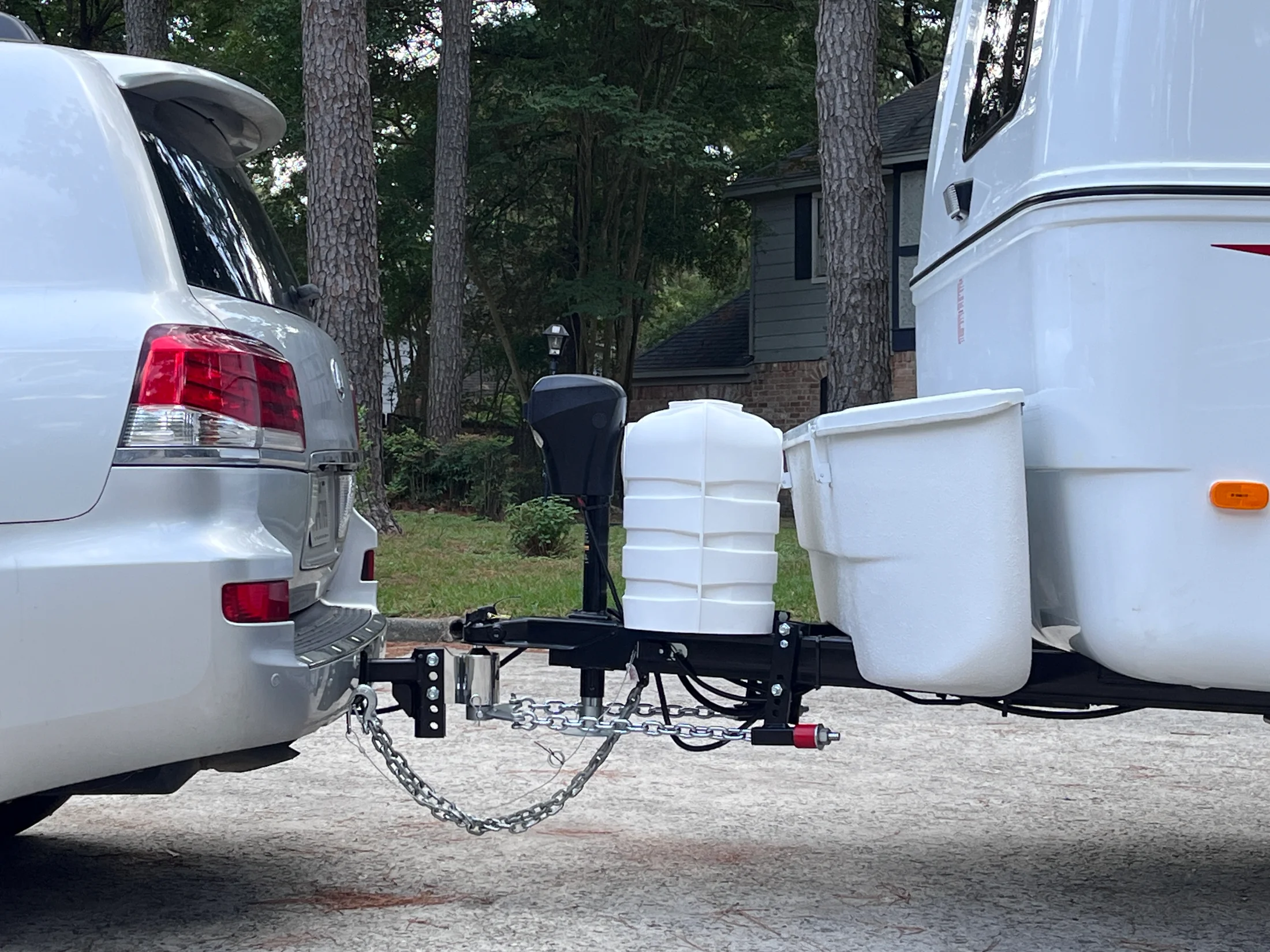

Our Escape 21C was delivered from Canada a few weeks ago! I'd appreciate feedback on how the trailer sits and how the WDH is setup. This is with the AHC in Neutral. The cul-de-sac has a bit of a peak in elevation where the hitch is, so there is a tiny bit of slope to both the trailer and LX. The trailer has a 3 inch lift.
Tires are Michelin Defender LTX M/S 2 285/65 R18 XL.
Any thoughts on tire pressure loaded up? I'm anticipating a 600 lb tongue weight (5,000 lb trailer GVWR) and maxing the LX's payload (1,200 lbs or so). Normal RCTP from @gaijin is 34 psi. I tried 40 psi and it felt a bit bouncy/stiff so was thinking either stick with 34 or try 37-38.
Thanks!
