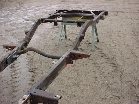

Guys I am planning on painting my frame this weekend and I need a measurement for an exhuast bracket that was cut off my frame. I believe these were found only on the '64-'65 LV's drivers side, if you've got one can you take some rough measurements for me?
Thanks in advance!
this is the bracket.......
you can barely make out mine here, where it was cut-off...

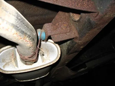

If anyone wants to go the extra mile I could also use the measurements for this little accessory bracket that attaches to the frame:beer:

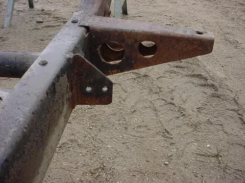

Here's the location pix. You need the dimensions of the actual bracket too? Do you have the front hanger too?
Jack, man that was quick.... I really appreciate it!!
And yes I do need the dimensions of the bracket itself as mine was cut-off at the frame. Also I do not have the front bracket either.
thanks aton:cheers:
No problem. I got a picture and some dimensions. It's a bent peice with a flat surface against the frame about 5/8 wide. It sticks out 2 3/4 is 4 1/4 tall and the one side is 2 tall the top is 3/4 wide. The corner is angled. Hope that makes sense.;)

Jack again you are the man, thanks for the help that is just what I needed....also I just checked my frame and found out that I do have the front bracket so you can hold onto yours, thanks for the offer though :cheers:
