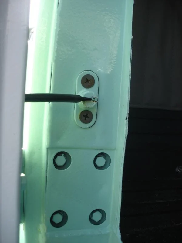

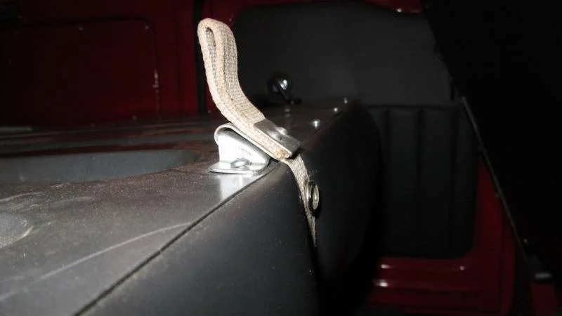

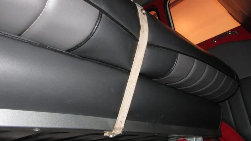

1) I have the tiebacks that I believe are for the rear seat. I have recovered them and cant see how they attach. Anyone know how they go on the seat and what their function is?
2) Since my lv is back together, I have no door "stops" in any of the doors. I do have these two...and they are different styles. Is one for the front door and one the back? I do need two more depending on which doors these are for. Fortunately, I do have four of the rubber stops that go with them.

  • Dukes, the truck looks awesome, I have had a lot of cool cars over the years and my first cruiser was a 64 lv. I have never had a vehicle turn heads as much as any 45 truck or wagon! Your parts are not original in your pics,they look homemade, THE ORIGINAL SEATBACK STAYS WERE CAST ALUMINUM ,the two door stops look correct!

I do have the metal seat stays attached to the side of the lv. I just thought maybe these held the seat when it gets folded forward...guess not.
The Door hold backs are two different styles. If you look, the two screw down plates face different directions. Is one style for the front and the other for the back? Does anybody have any of these around?

Yes, it does hold the seat down when its folded forward. This is on my late 1967, I had a early 67 that still had the canvas strap but the connection part was a little different. There was only one strap on my seats, and they just screwed into the seat as you can see in the photos.
