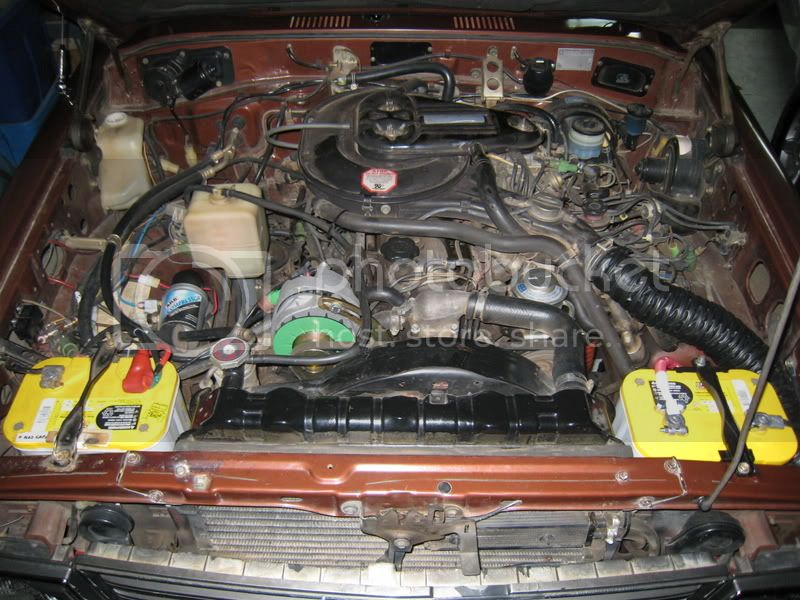

hey, how did you do the dual battery set up?
is it all powered by the Mean Green? is there another voltage regulator in there somewhere?

It's all powered by the Mean Green. I simply connected the batts in parallel so the electrical system see's it as one very powerful battery. I also fabbed an 8 guage wire from the alternator directly to the batteries. I didn't want the factory 12 guage wire turning into a fusable link when I install my winch soon. No other voltage regulators other then the one on the alternator itself.

as far as the dual battery setup, do you have any extra fuseable links, or an extra fuse box, to run all of the extra accessories?
or do you just run all the accessories out of the regular fuse box? are some connected directly to the second battery?
i want to do this dual setup, but am also considering using the smog pump location after desmog to add a second Hilux alternator/volt reg and battery setup...
does the Mean Green charge at 13.8 volts with a bunch of accessories running? i have heard good things about their alts...
if you feel like it, could you get some photos of your alt fab/dual setup?
-andy g.
I have one extra fusable link in the jumper wire I put directly from the alt to the battries. There are only two wires feeding from the alt, the factory one which already has a fusable link in it, then the one I made to the batts for high draw items.
The high draw items such as lights, amplifiers, and soon to be winch are connected straight to the battries. Other items like the deck, ipod, and CB, are low draw items and connected to the factory accessory wires. I ran my own constant power to the GPS's as I didnt want them turning off with the key. I installed a switch in the little plug on the dash underneith the keys for those.
I didn't take any pics of the instalation as it really wasn't that complex. Had a friend (same guy who did the belly pan) fab me up a tray. Then relocated the radiator overflow bottle above the charcoal can using a simple L shaped peice of aluminum stock. I used factory Toyota batt tiedowns out of a totaled 4runner to hold it in place. The nuts are already welded in place from Toyota on the other side of the radiator for the tie down.
I don't know much about a duel alternator set up. But the Mean Green puts out 14.4V when cold and 13.6V when warmed up according to my Lowrance GPS. The lowest I ever recall seeing it read was 13.1. That was at idle with all four 55watt Hella lights on, high beams, and 800watts of amplifiers at close to max.
