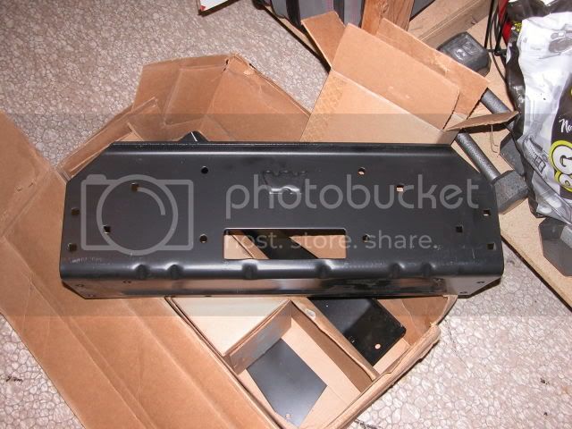

The came from the factory with 30 wt oil. I picked up a 'new' 1986-87 vintage 8274 a few years back still in the original shipping box along with a factory mount:
I cracked it open and that's what I found. No moisture, so I resealed it.
