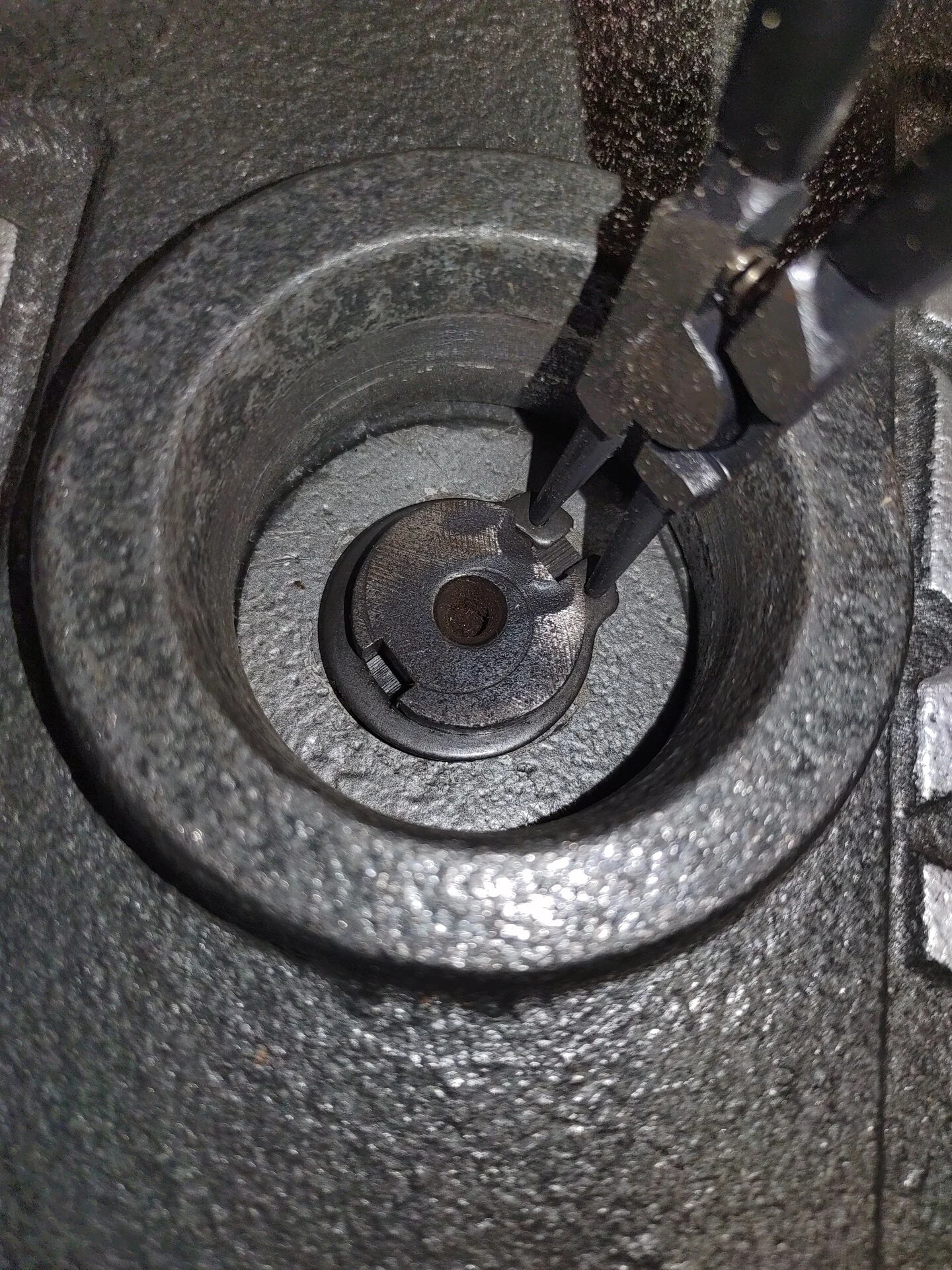

The Nova Scrotan One Person No Fail Brake Assembly Method for Warn 8274
Oct 4, 2018
14
648
Nova Scrota

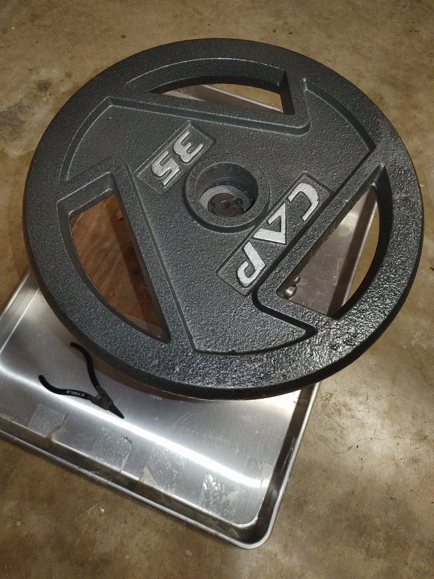

I didn't have camera during the job, so pics are all post -application of the Nova Scrotan method. But you see what I did there
Is your weight plate for an olympic bar? 'Cause I have whole stacks of those.
Great idea!
Great idea!
@1911 Yep - olympic plates. The 35# weight is enough so you can compress the spring and set the keys into the shaft with just a slight push: pressure can be applied slowly and evenly. Then, once everything is down, the weight of the plate is enough to hold it there, giving you 2 free hands for maneuvering the lock ring into position.
