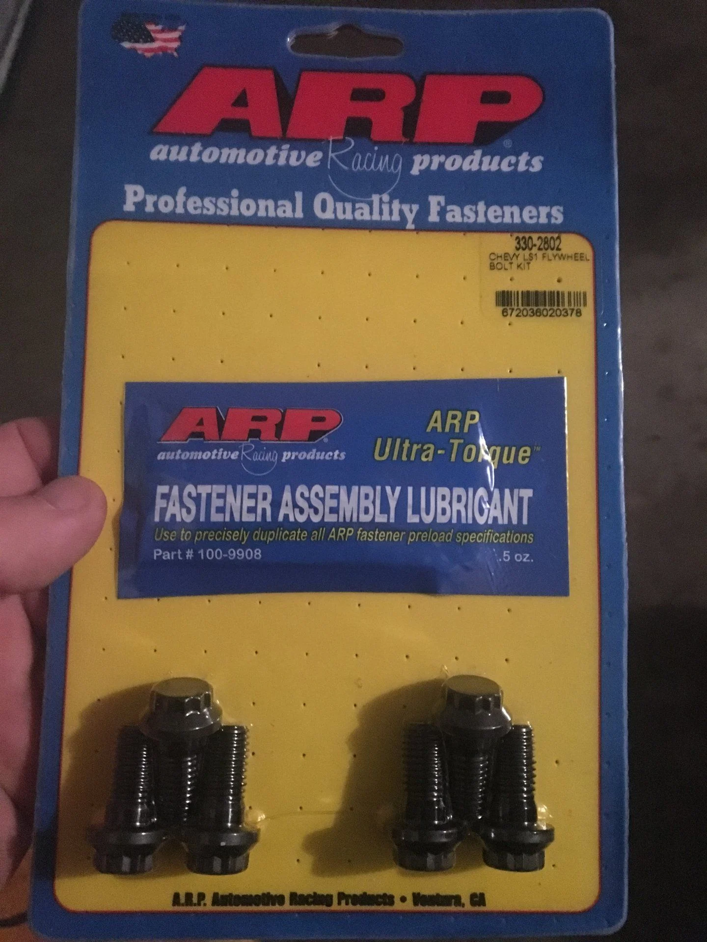

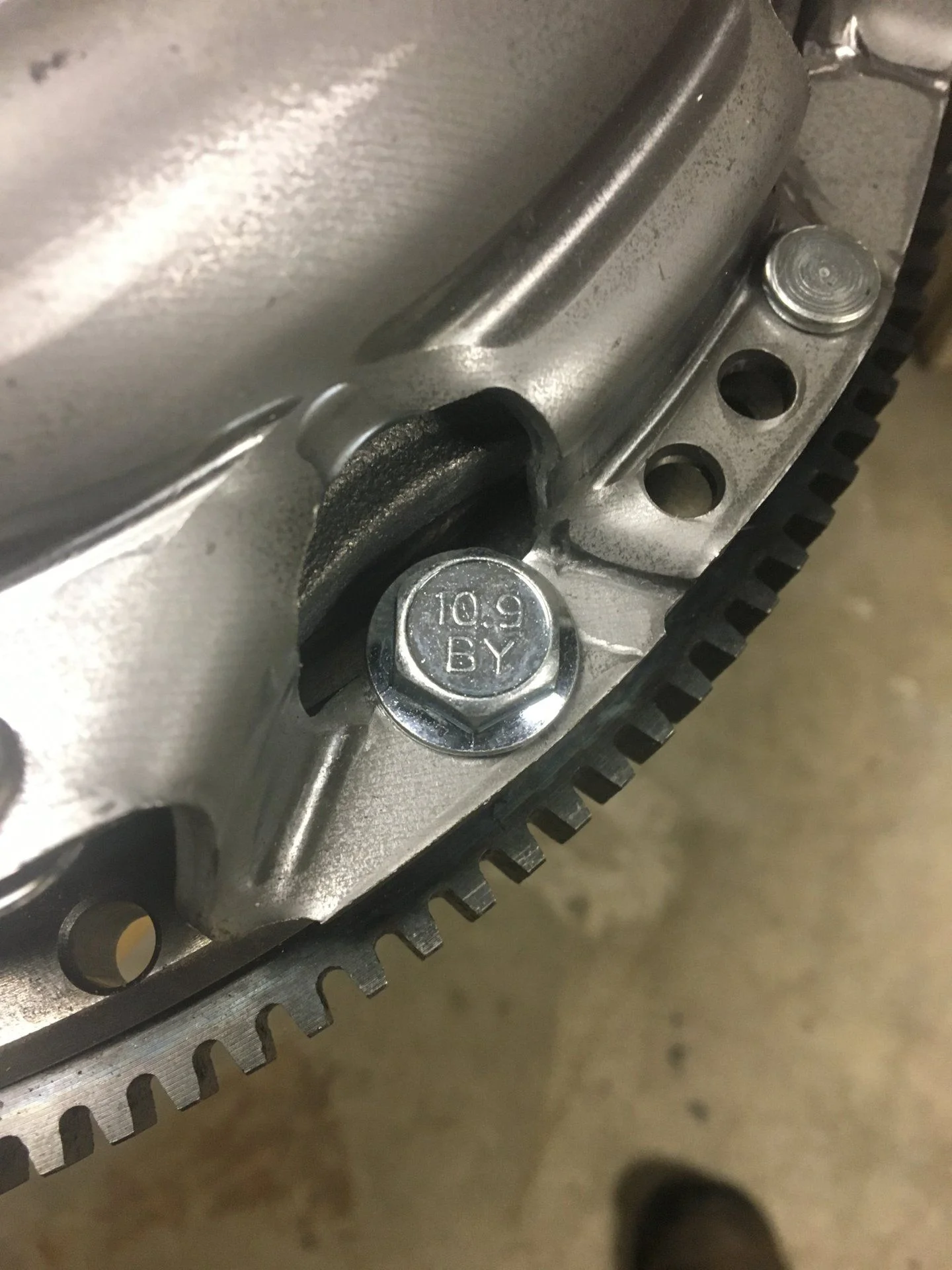

So I finally found my flywheel (2000 camaro LS1) and clutch (sm465)combo, but nothing came with bolts to fasten the clutch to the flywheel.
I found class 10.9 10x1.5 bolts at my local hardware store, but don’t want to use them if there is something better.
Anyone have any suggestions for bolts?
You don't want to scrimp on quality here as well as the bolts for the flywheel to crank. ARP are the best bolts you can buy.
They may be too short due to the different thickness of the flexplate vs. a flywheel. Cheap insurance to buy new bolts.
When I did my conversion I used all ARP bolts. No problems then or now. Summit is great and if you have questions tech support is good.
ARP fasteners are pretty much used by all the major engine builders.

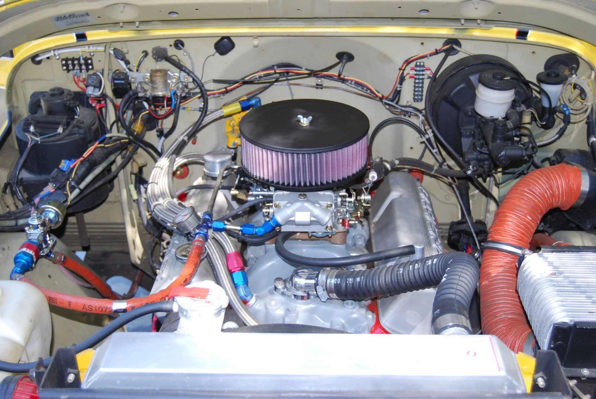

SBC 350, NV4500 trans, centerforce flywheel, pressure plate and disc. If I remember correctly the flywheel is 168 tooth.
Not bad. Unfortunately some sources have "special" price sheets for people doing conversions.
