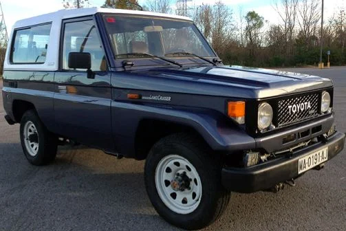

I am accumulating parts for my LS swap into a 73 series with h55 tranny....
