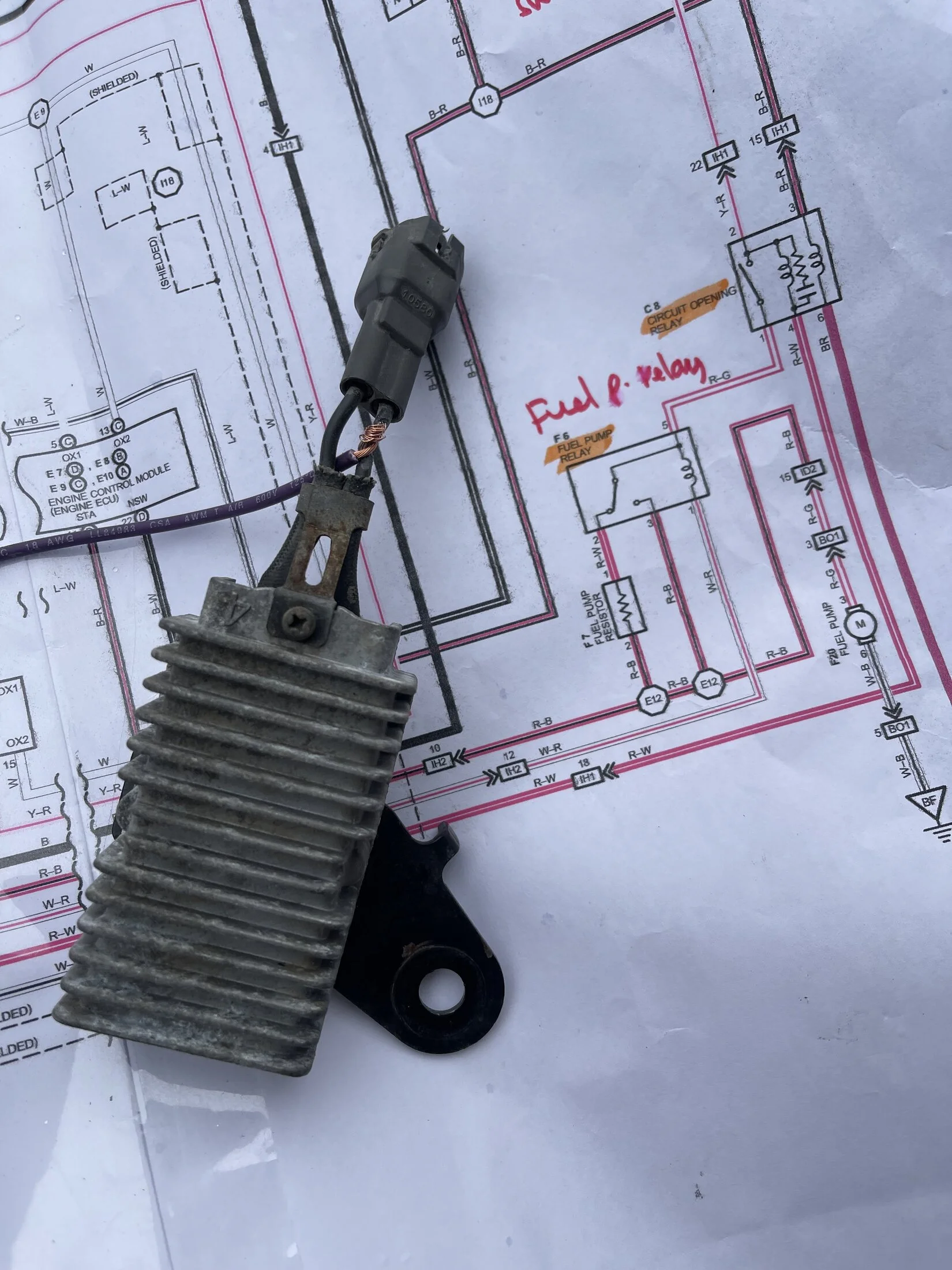

Spent all day to diagnose the issue. Computer seems fine. We tested it out with a scanner. Shows signal when you crank such as rpm. There is just no fuel going into the engine. Believe I got the wiring to the fuel pump incorrectly

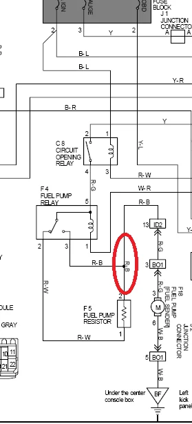

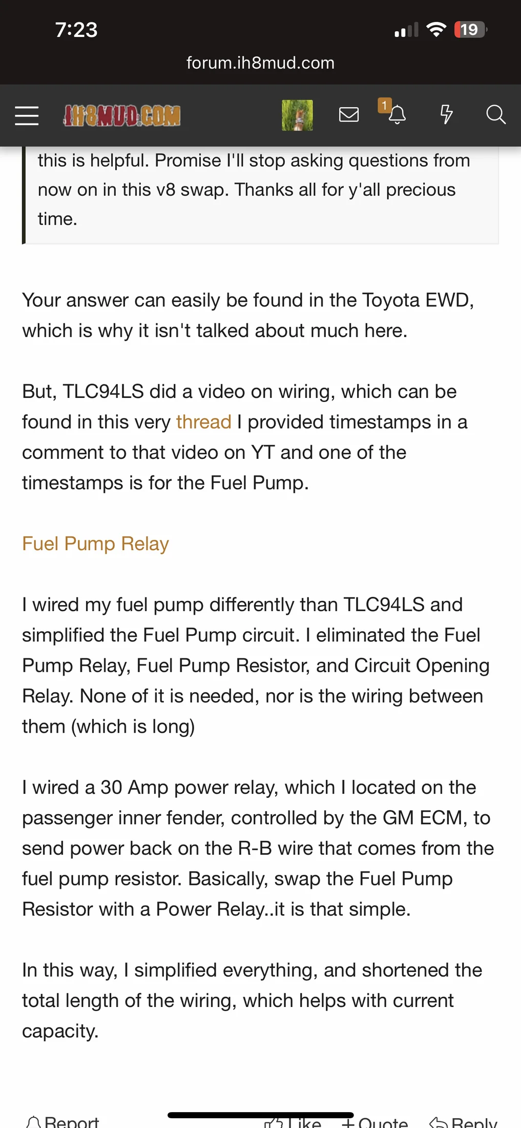

Thank you very much for your time NeverFinis. I appreciate you. Most probable cause of no fuel is no fuel going into the engine. I’m going to use your method on wiring the fuel pump. Simplifying it. You have wealth of information on the 80s we are fortunate.
To be clear..you want a relay to power the R-B wire coming from the Fuel Pump Resistor on the passenger inner fender. It is a straight shot to the fuel pump from there. I mean, as a test you can just add +12V there to see if the fuel pump runs.
Just a note, if you do use the GM to activate the fuel pump, you might need to disable Starter Diagnostics in the ECM (see my post Builds - LX450 "Rex" Build - https://forum.ih8mud.com/threads/lx450-rex-build.1254004/post-15202414)
Fuel Pump Relay:
Relay Pin 87: +12V from Battery, use an appropriate Fuse (GM uses 30 Amp)
Relay Pin 86: +12V from GM Circuit 465 (Fuel Pump Relay Control). This could be different depending on GM ECM
Relay Pin 85: GND
Relay Pin 30: R-B wire found at Toyota Fuel Pump Resistor
I circled it.
Fuel Pump Relay:
Relay Pin 85: GND
I circled it.

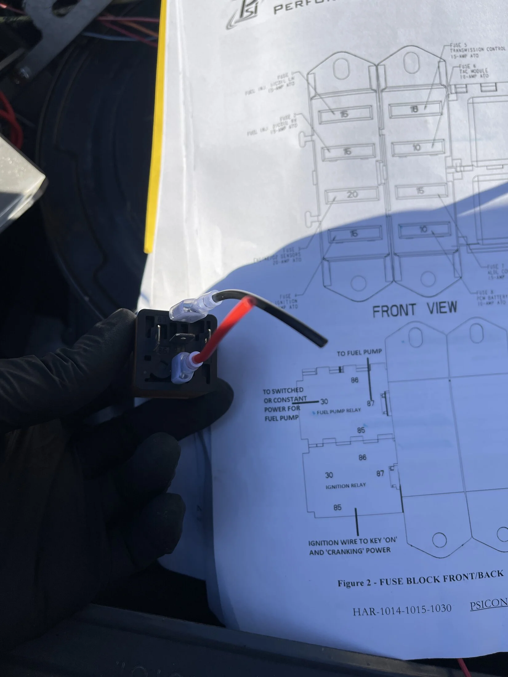

I tapped the wires into the psi relay. Stopped working so got a new relay. Neverfinis suggestion, tapping into the LC resistor makes a lot of sense. Won’t have to run a wire directly into the fuel pump, which may cause a bad ground. By the way, psi said you don’t need to connect anything to the ls park/neural switch. Car still start without.
