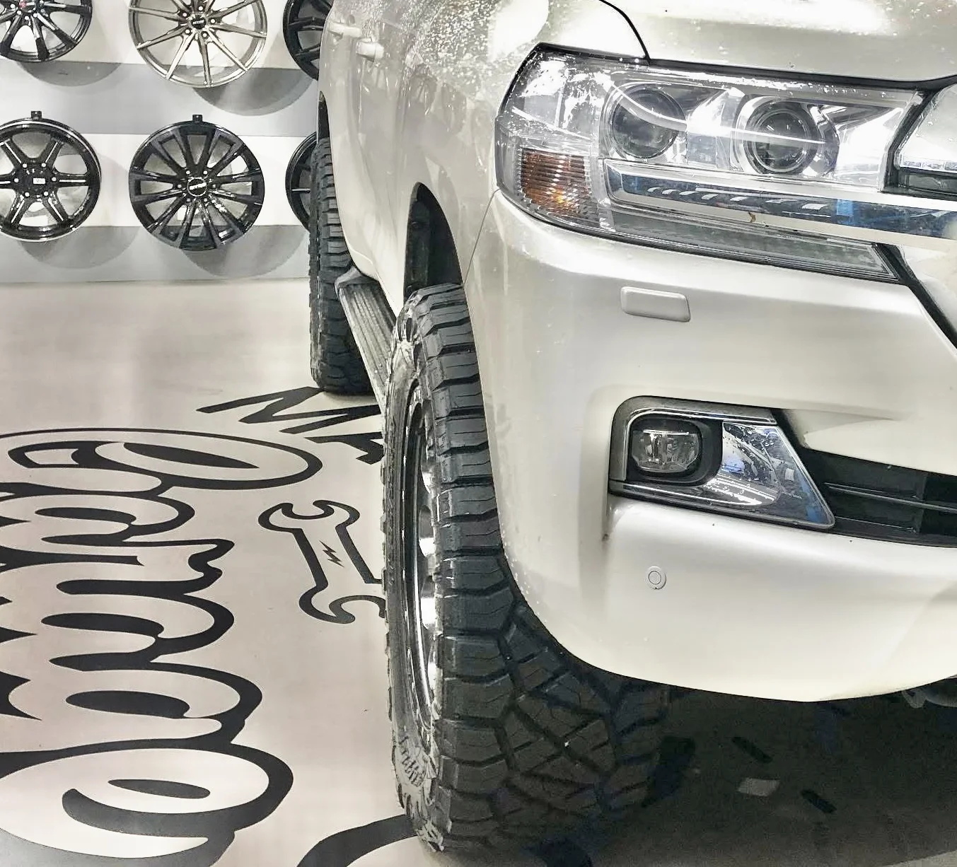

Im running 305 32.8” Terra G2 tires
+25 offset
Currently no rubbing as the inner wheel well already pushed back
But Id like to widen the stance little bit more to have a wider look

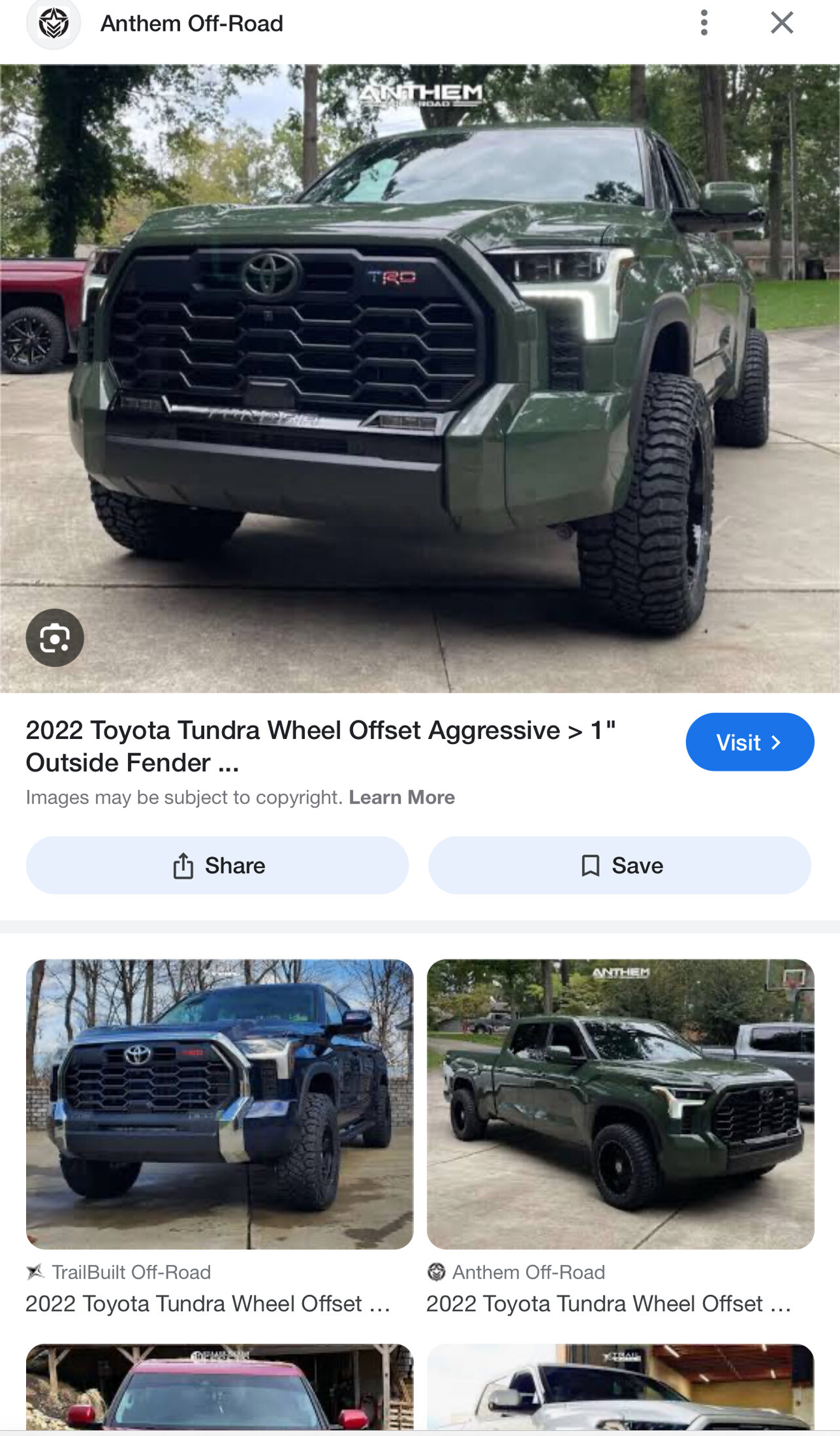

Similar to this photo I saw online, I think it looks really good
Im planning to add 25mm spacers
Or buy wheels that have lower offset
(Besides scrub radius) Would that be a good idea?
and under suspension articulation, will the tires hit the fenders?

Similar to this photo, I think it looks really good

It’s a bad idea for any reason except looks
Lower offset means a wider arc which means more fender liner contact. More risk of hitting a fender on full compression. Worse scrub radius and thus more toe in and out on hard acceleration and braking. More torque steer.
It'll also wipe out the fender unless you aggressively limit uptravel. It'll make the rig tiring the drive, lose corning traction, and have more wear and tear of the steering rack which might cause a premature replacement.
