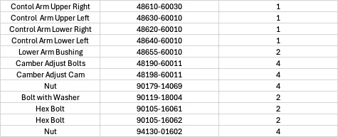

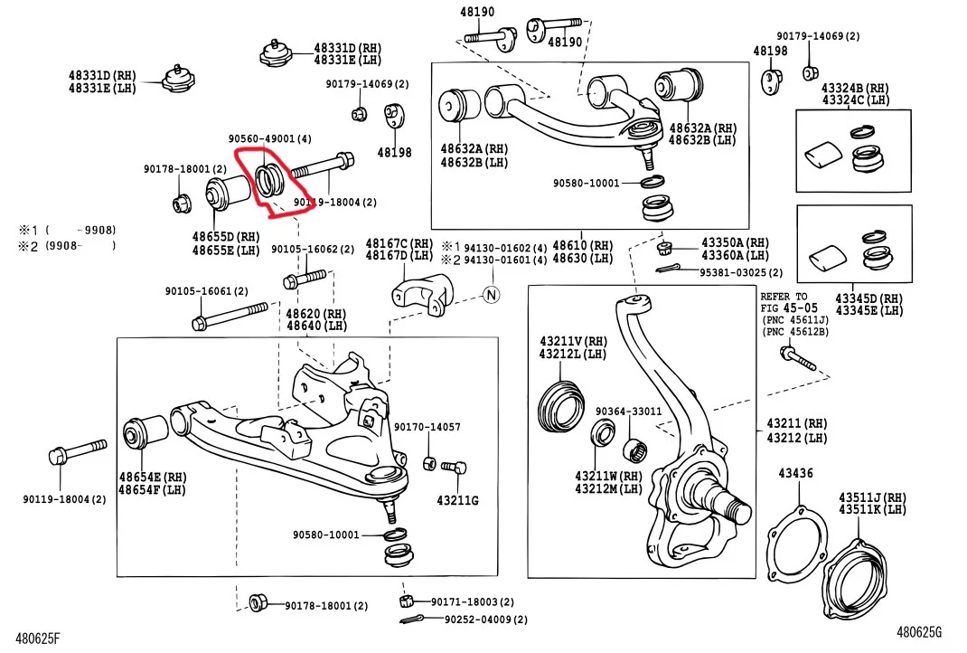

So I am diving in and replacing the upper and lower control arms on my 2000 LX470 and was wondering if I could get some part number help with the connecting hardware. I am going a bit cross eyed looking at the part diagrams and want to make sure I am on target. Here is what I have so far.
Are the last four items correct for the lower control arms? Additionally is part number 90179-14069 the correct nut for the cam adjusting bolt for the upper control arm?

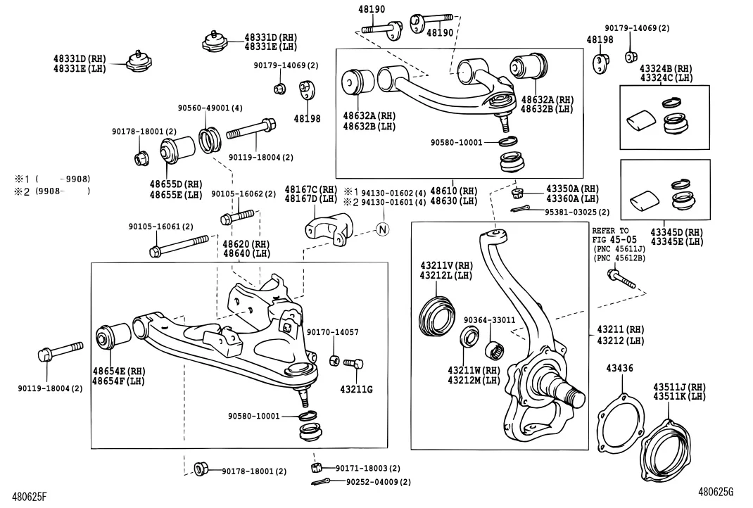

Here is the diagram I have been using.
Much appreciated
Correct on all counts. This is on my list of things to do this weekend. Feel free to contact me if you need any help (-ful hints).

Best to have at least 4 spacers on hand.
4Spacer #2 bushing90560-49001 spacer
I've found over the years, two: That new OEM LCA, didn't fit back in bushing relaxed. By adding space to #2 bushing, they did then fit relaxed. Adding spacer seem to correct, a pull in steering, alignment shops couldn't. I could see witness marks from frontal impact. It seems impact bent frame just a tad, which spacer corrected.

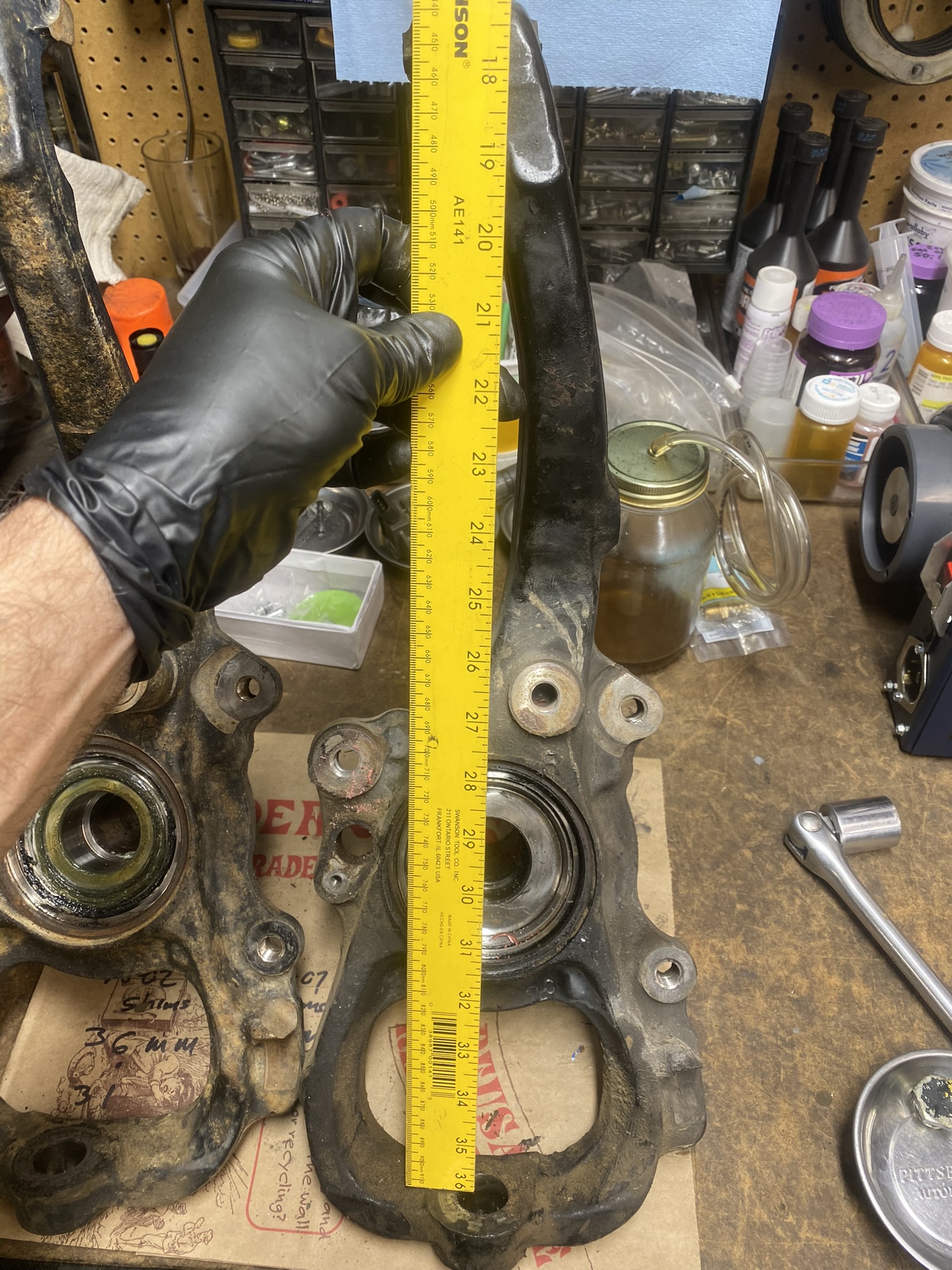

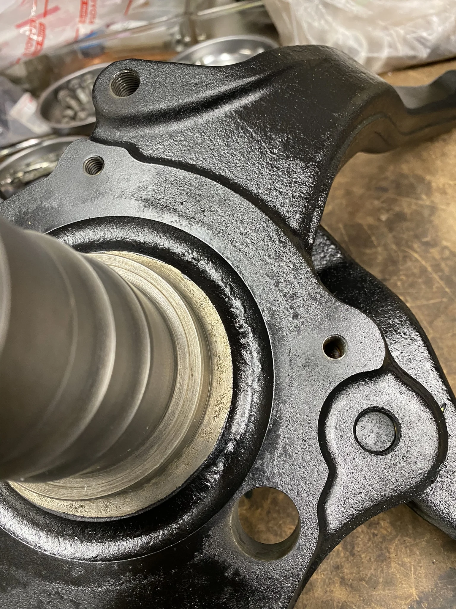

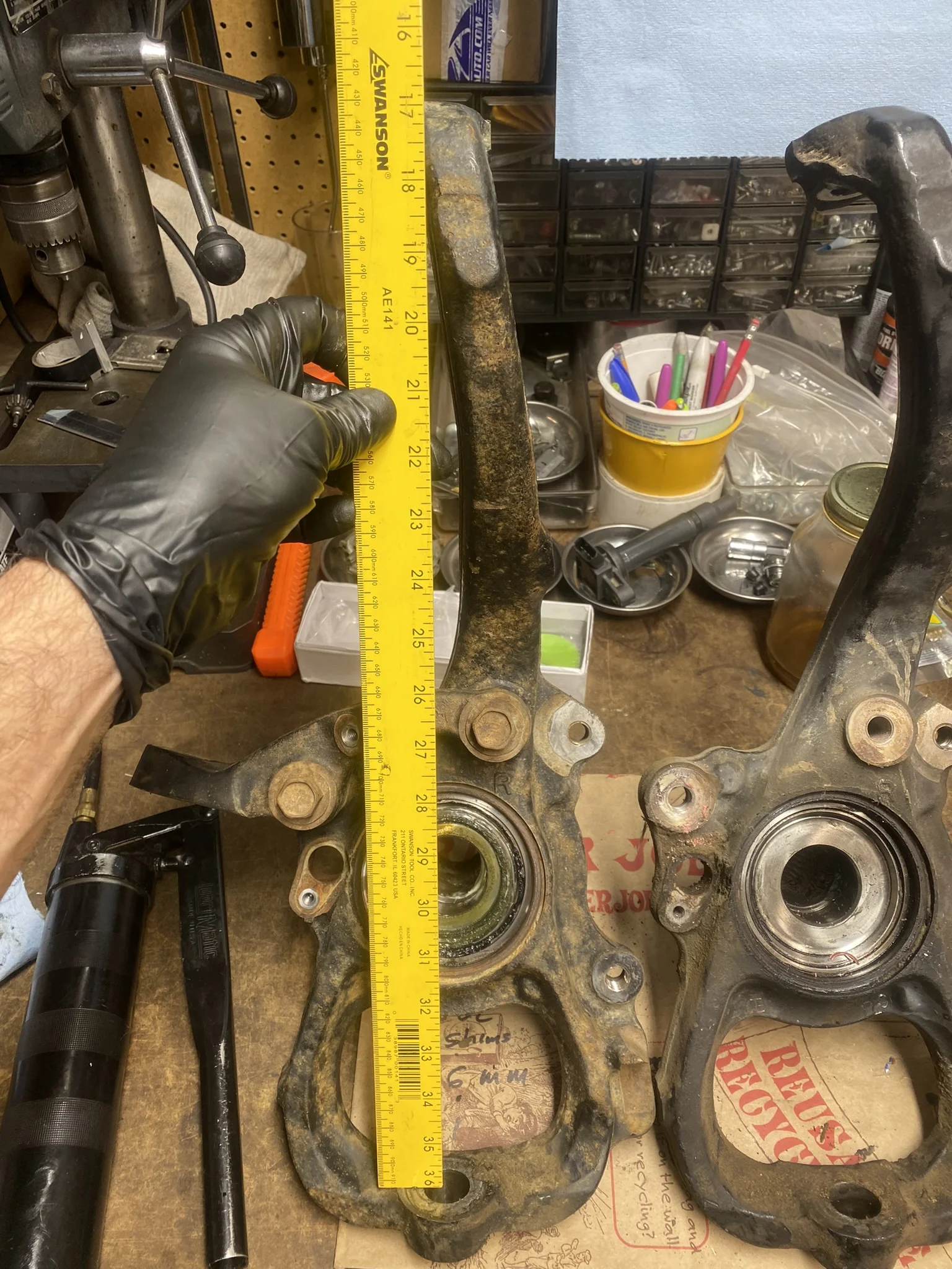

I typically restore knuckle's while in there.
  1. Check if bent.
  2. Flatten surface shops where boot seals. From shops, using BFH to beat off ball joint, warp.
  3. De-rust.
  4. Paint.
  5. Needle bearing brass bushing and seal
Good
Bent

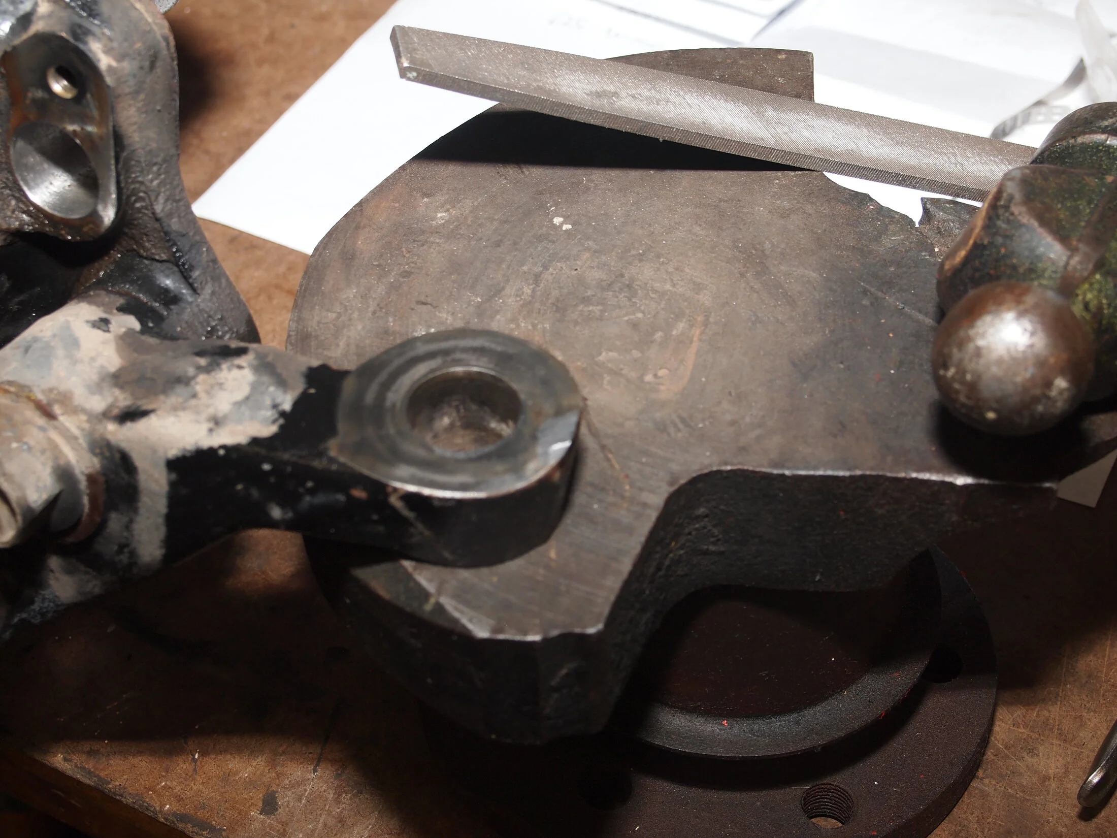

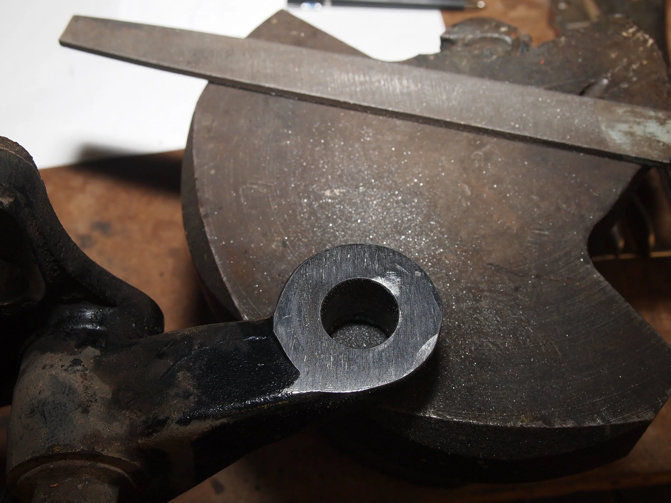

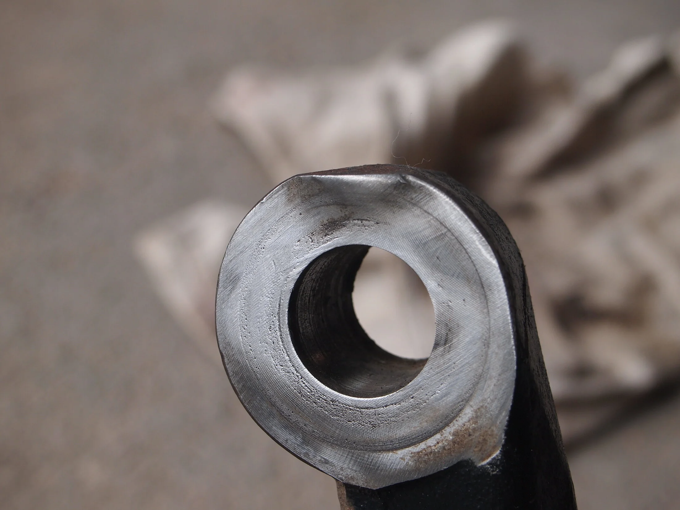

BFH, used to beat off ball joint, is such a bad idea. Often warpage form BFH, result in water entry, due to bootl not sealing, where boot should have flat surface to seal on.
Pound flat best one can, then flat file.
Boot will now seal again, saving ball joint from contamination.

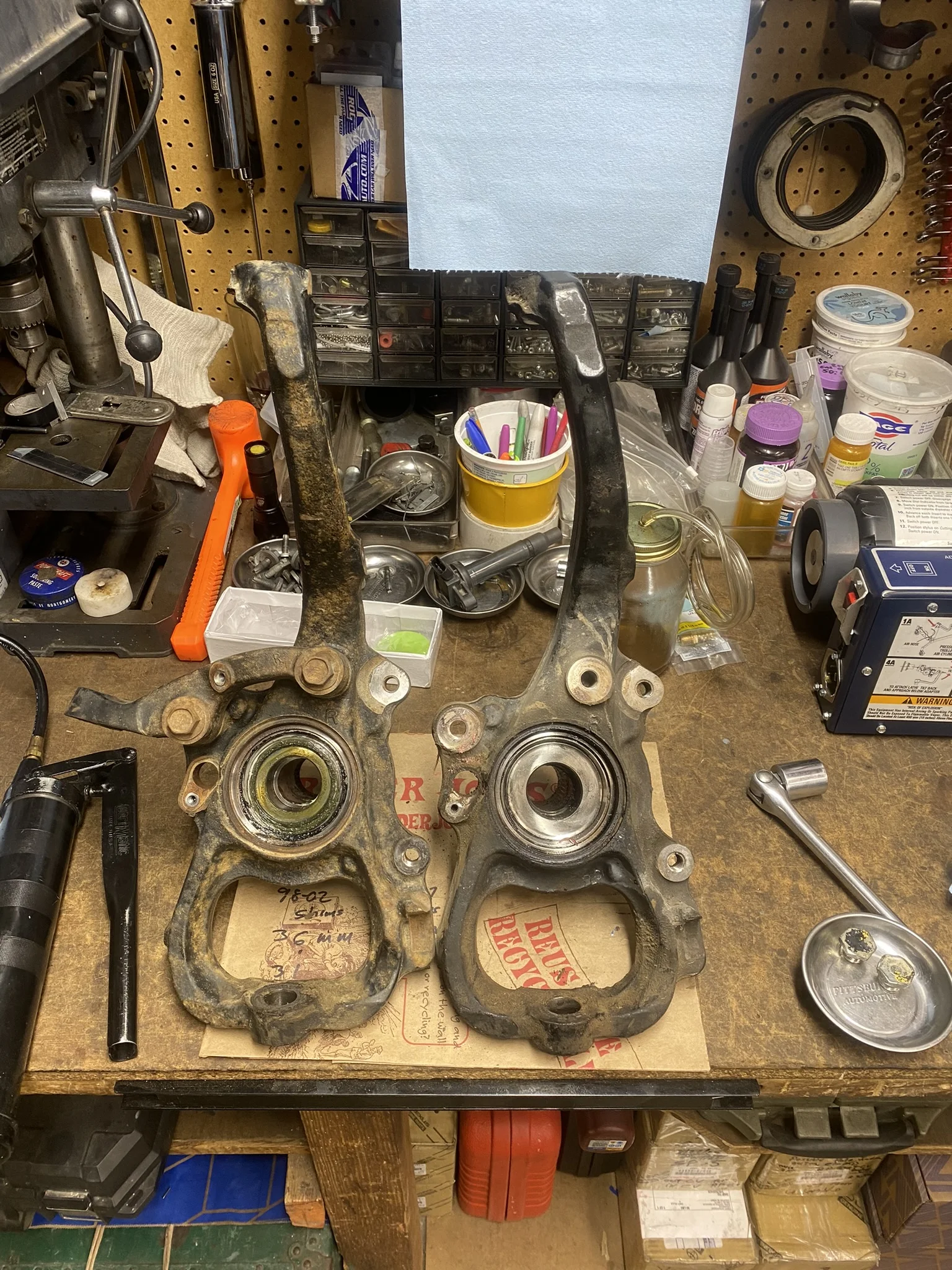

All knuckles have rust under brake dust shield. They're designed to last 25 years. We're now going beyond design life. De-rusting and setup to never rust again, is best practice.

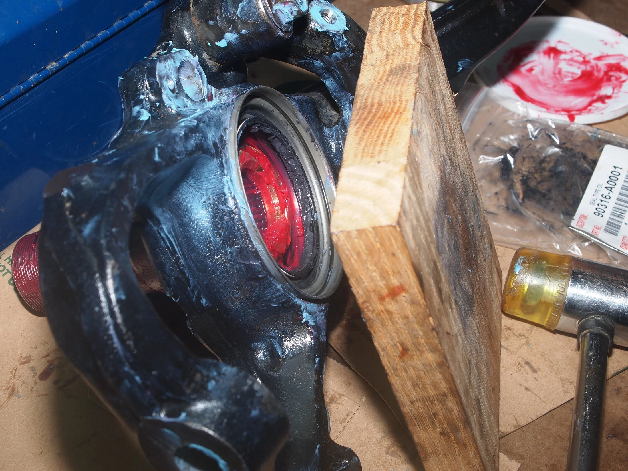

I tap out wheel speed sensors, with soft wood (a 3/4" round pine). I never pry out.

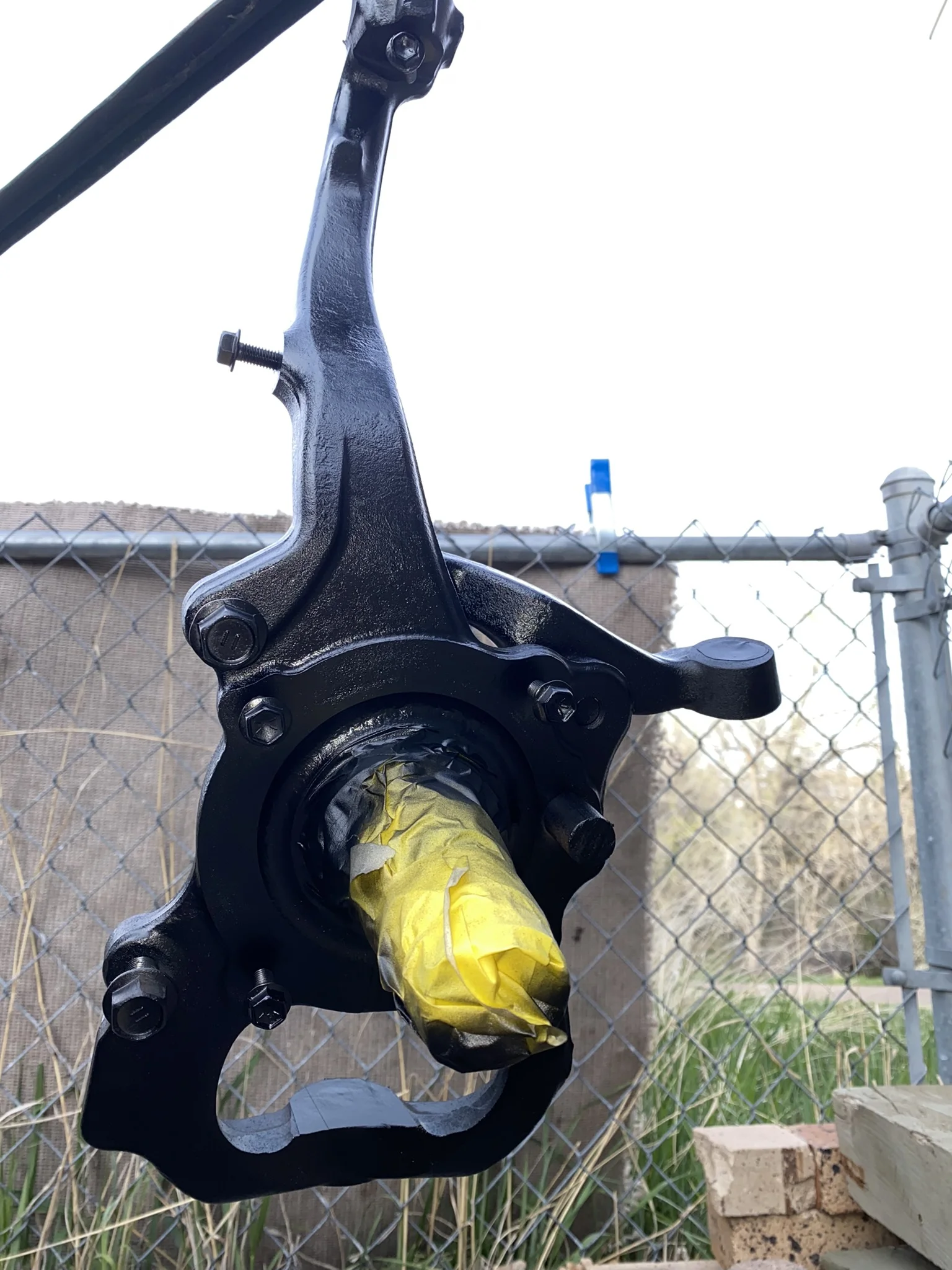

Restore, De-rust, Prep & Painted
Next will be to wire brush threads (round bush on drill) and polish spindle (scotch pad) and back side.
New axle needle bearing, brass bushing and seal, greased and ready.
