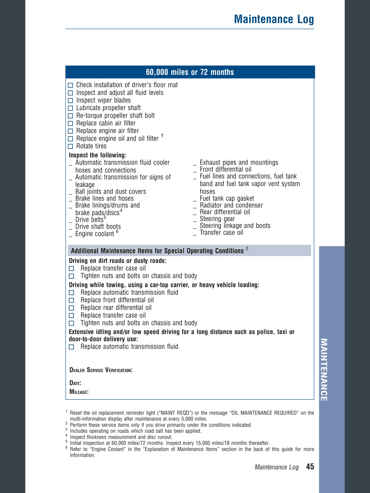

In my 2017, there is a section in the Warranty & Maintenance Guide for "Special Operating Conditions" such as towing, heavy vehicle loading, etc. The first appearance of transmission fluid flush appears at 60k Mi / 72 Mos. in that section, while it never appears under the normal operation maintenance recommendations. Of course, this is applies to the 8-speed transmission, but likely the 6-speed recommendations are similar.

I did my first change at 60k. Transmission (full 12 quart flush), transfer case, front and rear diffs. I only had 11k on the truck though.
About half my mileage is towing 5000#+ in 4th gear at 70-75 on the highway. Some of it is flat lands, some of it is out west. I will probably do mine again after another 60k. I think it's fine to do it every 60k if you tow, provided you do a full trans fluid flush, not just a pan exchange. I'd only do it sooner if you set off the A/T temp light, or if like me you use an OBD2 reader to get your temps and notice that you've been running exceptionally hot.
