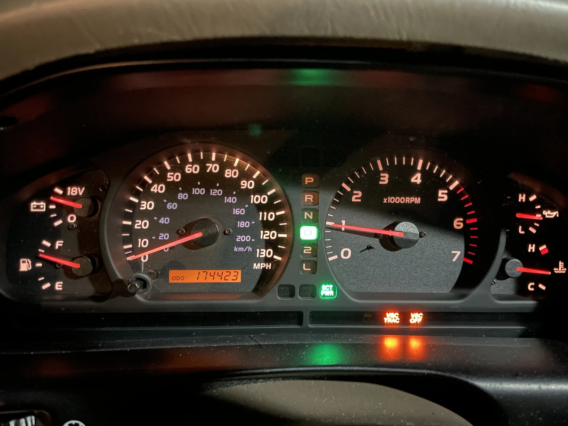

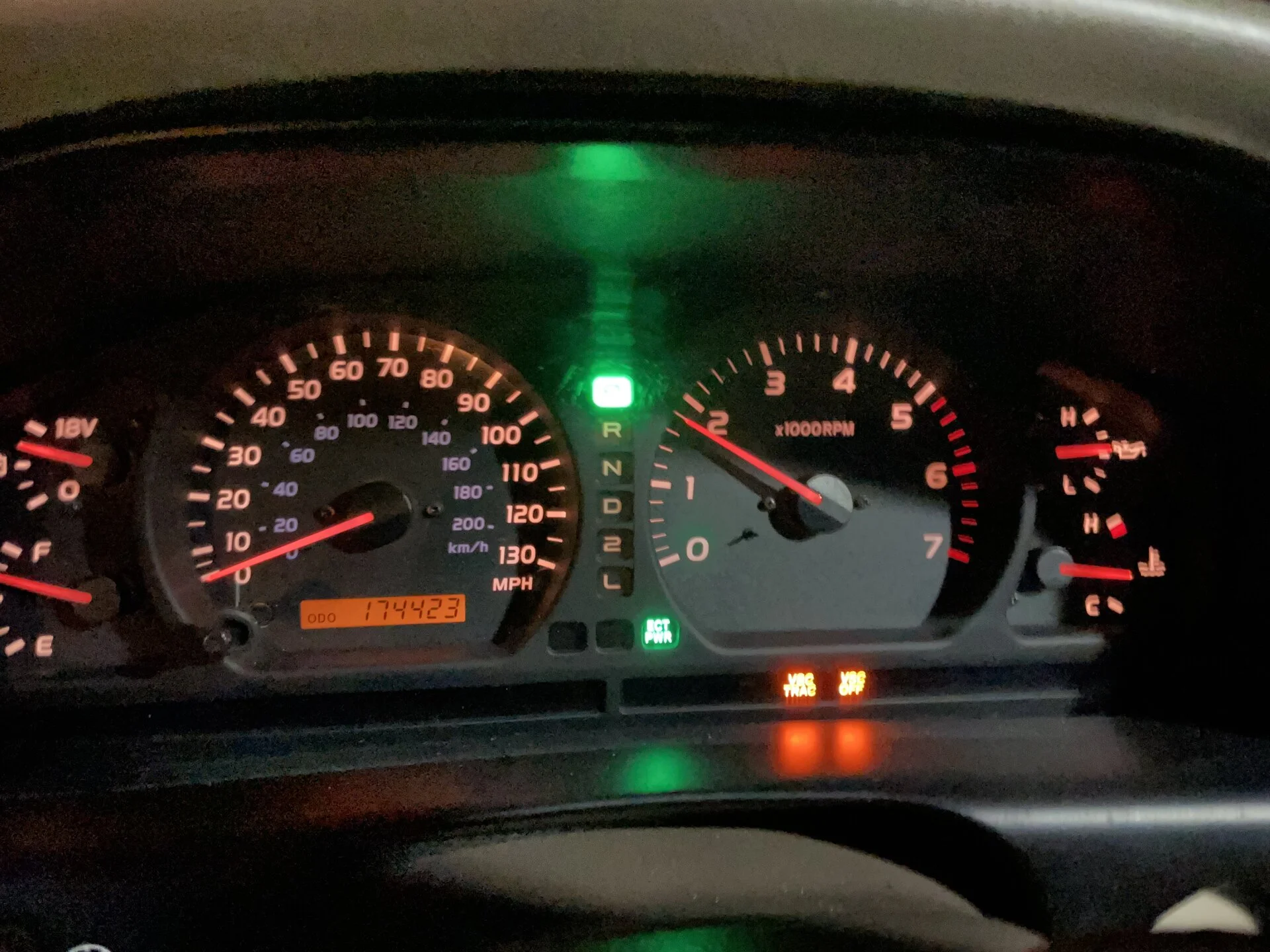

First photo was RPM in park, 2nd was RPM in Drive.

Ok. Noted. No. I’m on a hot country. Dubai. I think mine is an throttle sensor. I just removed and changed. Let’s see. I will keep posted.
Update 3: I changed:
1..throttle position sensor (no luck)
2. MAF sensor (no luck )
Weird thing is when I press the brake and press the gas there is no acceleration.
