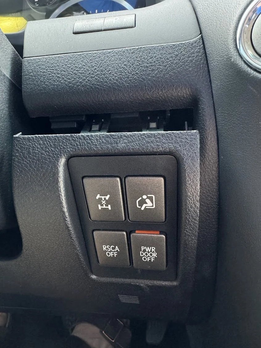

The switch bezel on the right hand side of the driver has always been loose on my lx. I push it back in and it falls back out over time. The clips don't seem to snap in. Has anyone dealt with this before? There's gotta be something simple that I'm missing but I haven't found it yet.

Is there any clips folded over not going into the slots? May be worth to pull it further out to examine before pushing it back in. I usually find that it's due to a single clip not in position, and it's actually pushing out against the others holding in.
You can also put some gaffers tape over the tabs/clips which helps them hold tighter.

From what I can tell both clips are aligned just not engaging. I've messed with it quite a bit, tweaking the clips up, down, etc. Will try to tape those up and see if that helps them hold better.
